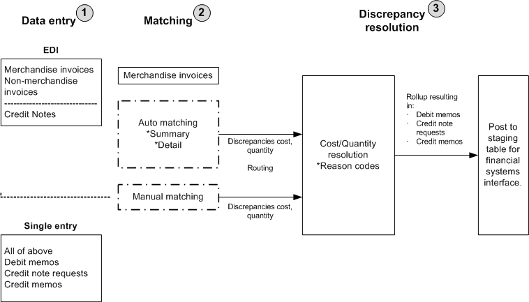

Figure 1-1 Invoice and Credit Note Matching Process Flow
Documents drop out of the flow when they require no further processing. For example, if an invoice is matched in Step 2, Matching, the document would not continue to Step 3, Discrepancy Resolution. The document would be posted directly to the financial (AP/GL) staging table after Step 2.
  1. Data Entry
    There are three ways in which invoices and other documents enter the ReIM system:
    • Electronic Data Interchange (EDI)

  2. Matching
    • Auto-Matching
      Merchandise invoices are grouped by match key. Match keys are defined at the supplier or supplier group level. Possible match keys include; PO/location, PO, Supplier Site/Location, Supplier/Location, and Supplier Group/Location. ReIM requires these attributes in all merchandise invoices. ReIM accesses the merchandising system to determine what shipments (receipts) were created for the match key. The auto-matching process attempts to match invoice cost and quantities against receipt quantities at PO cost within user defined tolerances.
      If the auto-matching process identifies cost or quantity differences outside of the pre-established tolerance range, the system creates corresponding discrepancies (cost or quantity). Otherwise, matched invoices are posted to the financial staging table.

  3. Discrepancy Resolution
    Users assign pre-defined reason codes against cost and quantity discrepancies to support resolutions. The reason codes direct the system to take a specific action.
    Cost and quantity discrepancies are sent to the Discrepancy Review list by the automatch program if discrepancies exist after a routing date is past (routing date is typically a date after the invoice date but before the due date. It is calculated based on system or supplier options). Users can then access the discrepancy review list to resolve outstanding discrepancies.
    Once all discrepancies are resolved for the document, it is posted to the financial staging table along with any corresponding adjustment documents, for posting to the retailer's accounts payable solution.
