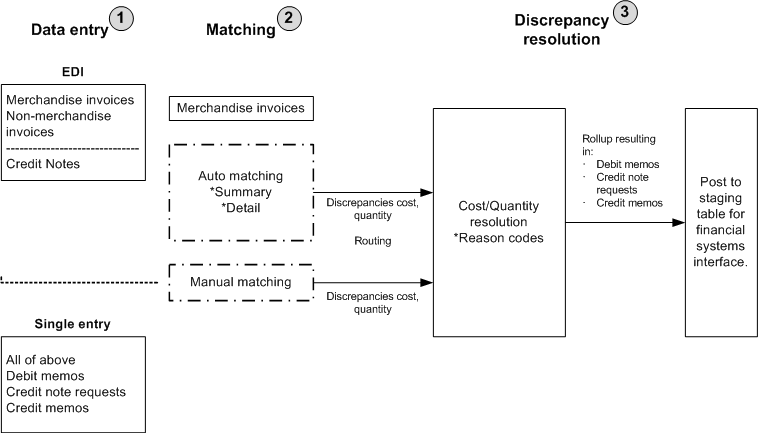

ReIM Process Flow
This section provides a diagram and description of the invoice matching process flow. It also describes the auto-match process through a series of detailed examples. The various levels of auto-matching are explained, including one-to-one invoice matching and line-level matching. The section concludes with a discussion of best terms calculations.
Invoice and Credit Note Matching Process Flow
This section provides a high-level explanation of the process flow in ReIM for each of the following areas:
  • Data entry
  • Matching
  • Discrepancy resolution
Figure 1-1 Invoice and Credit Note Matching Process Flow
Surrounding text describes Figure 1-1 .
Documents drop out of the flow when they require no further processing. For example, if an invoice is matched in Step 2, Matching, the document would not continue to Step 3, Discrepancy Resolution. The document would be posted directly to the financial (AP/GL) staging table after Step 2.
