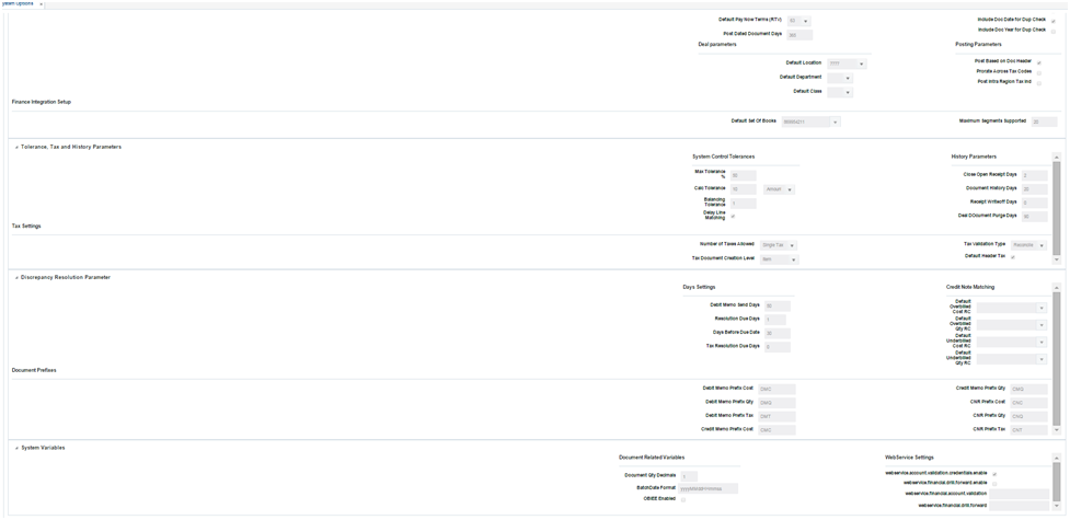

Out of the box some of the system options have been set to default values. You need to verify that the values meet your business requirements. Some of the attributes that would need to reference identifiers for the existing entities could not be defaulted and would need to be set explicitly. Such attributes are:
Default Pay Now Terms (Deals)
Default Pay Now Terms (RTV)
Default Location
Default Department
Default Class
Default Set Of Books
URL for account validation web service
URL for drill forward web service
Please see the Oracle Retail Invoice Matching User Guide, System Options section for more information.
