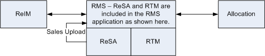

RMS provides essential information to all of the Oracle Retail Merchandising Operations Management applications (ReSA, RTM, ReIM, Allocation), and interacts with all of them. RMS exists on the same database schema as all of the other applications, which provides flexibility in how information is shared between RMS and the other Oracle Retail Merchandising Operations applications.
Information is shared with other Oracle Retail Merchandising Operations Management applications through direct reads from Oracle Retail Merchandising Operations Management application tables, calls to Oracle Retail Merchandising Operations Management application packages, batch processes, and the Oracle Retail Integration Bus (RIB) if the client is using this option.
The following diagram illustrates the RMS location in the merchandising footprint.
Oracle Retail Trade Management (RTM) and RMS share the same database instance. When RTM is enabled in an RMS instance, certain import-specific data maintenance is required for country, supplier, partners and items. These are directly updated into the RMS database and subsequently used in RTM.
Oracle Retail Sales Audit (ReSA) and RMS share the same database. ReSA shares some of its master data with RMS. Foundation data such as stores a company/location close dates, location traits, bank setup and tender types are maintained in RMS and used in ReSA.
Current reference data is retrieved from RMS into ReSA by the batch program SAGETREF. The data is extracted into multiple data files. The data in the files is used by the batch program SAIMPTLOG as reference data for doing validation checks on the POS/OMS transaction data during the data upload to ReSA. Having the reference in data file formats increases the performance of the SAIMPTLOG process. SAGETREF generates the following reference files:

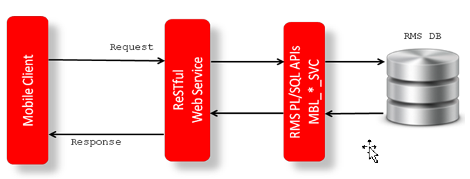

This section gives an overview about the RMS ReSTful Web service Implementation API designs used in the RMS environment and various functional attributes used in the APIs. Retailers can access back end functionality by calling the application's ReSTful Web services. For more information on ReST architectural style applied for building Web services, access the following URL:
http://www.oracle.com/technetwork/articles/javase/index-137171.html.
The RMS ReSTful Web services are based on a mobile application defined by Oracle Retail. The services are designed to support the mobile application functionality.
The main objective of the ReSTful Web service is to support mobile applications, some of the services functionalities may not be useful for general use.The services are used for client's custom mobile application. The ReSTful Web services Java code cannot be customized, but the MBL PL/SQL functions and object types can be customized for a client use. In addition, the client uses the RSE tool to create their own custom services in place of the ReSTful Web services.
RMS packages its ReST services in RmsRestServices.ear as part of the application's Enterprise Archive (EAR) file. Specifically, those services are packaged as a Web Archive (WAR) within the EAR.
See the RMS Installation Guide for instructions on deployment of the ReST web services.
Services are secured using J2EE-based security model.
Realm-based User Authentication: This verifies users through an underlying realm. The username and password is passed using HTTP Basic authentication.

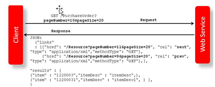

Some of the RMS ReSTful Web services have the potential to bring back a large number of records and therefore these services are equipped to segmenting the result into pages. The page number to retrieve and the size of the page are added as input parameters to all the paged services.
Each paged result includes the following information:
Total Record Count: Displays the number of all records matching the service input criteria.
Next Page URL: Shows the service URL with same input parameters, but with the pageNumber plus 1, when more records exists.
Previous Page URL: Shows the service URL with same input parameters and the pageNumber input value minus 1, when page number is not 1.
Next or previous page URL is not provided when:
No records are returned.
Previous page is not returned, when the page number is 1.
Next page is not returned, when the record reaches the last page.
