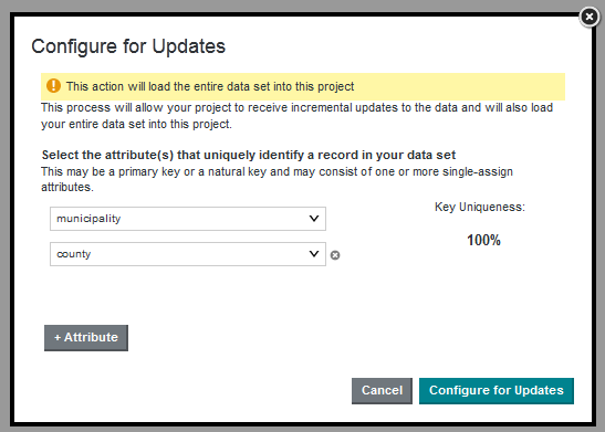

A data set must be configured for Incremental updates before you can run an Incremental update against it. This procedure must be done from the Project Settings > Data Set Manager page in Studio.
The data set must be configured with a record identifier for determining the delta between records in the Hive table and records in the project data set. If columns have been added or removed from the Hive table, you should run a Refresh update to incorporate those column changes in the data set.
When selecting the attributes that uniquely identify a record, the uniqueness score must be 100%. If the record identifier is not 100% unique, the Data Processing workflow will fail and return an exception. In this example, the Key Uniqueness field shows a 100% figure:
Configure for Updates dialog

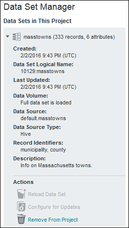

After the data set is configured, its entry in the Data Set Manager page looks like this example:
An example of a data set entry in the Data Set Manager page.
Note that the Record Identifiers field now lists the attributes that were selected in the Configure for Updates dialogue.
