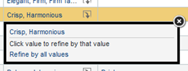

You can also create a list of values to refine by. You can select the values from different attributes and components, including components on different pages. For example, you could refine by a Region value displayed on a Results Table, and a Wine Type value displayed on a Summarization Bar.
To do this, Ctrl-click each value. The values must all be enabled for refinement. When you Ctrl-click a value, it is added to the list of values to refine by. You can also Ctrl-click a Refine by all values link to add all of the values to the list. As you navigate between pages, the list remains displayed until you either confirm or cancel the refinement.

To refine the data using the selected values, click Apply refinements.
To close the list and cancel the refinement, click the close icon.
