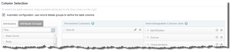

    1. In the Edit view, navigate to the Column Selection tab.
    2. To use the default configuration, leave the Automatic configuration: use record details groups to define the table columns check box selected:
      Results Table Column selection tab with default configuration enabled
    3. To use custom configuration, deselect the Automatic configuration: use record details groups to define the table columns check box.
      The default configuration remains, but the lists are enabled to allow you to change the configuration.
      If you check the check box again, the default configuration is restored, and any customization is lost.
