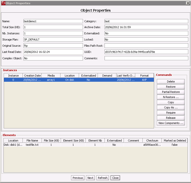

You view checksum verifications and failures through the Control GUI Manage tab in the Archived Objects view. The Archived Objects view shows the Checksum column, indicating the status of the checksum for any particular object in the system. The status is identified by circles (empty, partially filled, or fully filled) and text.
Double-clicking on the resource opens the Object Properties dialog box showing verification or failure messages and checksum information.
The Checksum column displays the following different status values:
  • Not Verified (empty circle)
    • Verification has not been completed for this object.
      • The checksum has never been calculated because the object was archived in a software release before Oracle DIVArchive 6.4, or because it is a complex object.
      • The default checksum was used and the object has not been read-back for verification.
  • Partially Verified (half green and half empty circle)
    • For objects with multiple instances this status appears if both of the following statements are true:
      • Verification succeeded for at least one instance.
      • Verification did not succeed, or has not been performed, for at least one instance.
  • Verified (filled green circle)
    • Verification completed successfully.
Different verification icons.
In the following figure, although the highlighted object has not been verified, a checksum for that object was saved in the database. The Last Verify Date is viewable in the center portion of the screen labeled Instances. The checksum entered into the database is viewable in the bottom portion of the screen labeled Elements.
Object Properties Screen

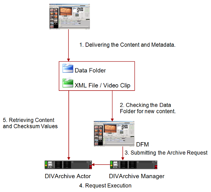

Oracle SAMMAsolo and DIVArchive Integration
Checksum includes support for SAMMAsolo integration with DIVArchive as follows:
  1. SAMMAsolo will drop one video clip and one XML file into the folder monitored by the Drop Folder Monitor (DFM).
  2. DFM picks up the files and analyzes them.
  3. DFM submits an Archive request to the Manager.
  4. The Manager sends the file location information to the Actor.
  5. The Actor reads the files, reads and calculates the associated checksum, and then deletes the video clip.
    SAMMAsolo uses SHA1 as a default checksum rather than the normal MD5 default checksum. However, checksums for both algorithms are generated now so that the MD5 default is available for use in DIVArchive.

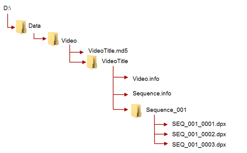

The external checksum file for the TEXT Genuine Checksum mode follows the file format of standardized MD5 Hash File Generators (for example, md5sum). The format of each line in the external file is as follows:
<32-character MD5 hash><2-character whitespace>[relative path/file name]
The relative path/file name must be a path relative to the folder that is being archived. Consider the following sample file tree:
Sample File Tree with Relative Paths
In the previous figure the external checksum file is D:\Data\Video\VideoTitle.md5. The contents to be archived will be every file and folder within D:\Data\Video\VideoTitle. The external checksum file will contain the MD5 hash and the path (relative to D:\Data\Video\VideoTitle) for each file formatted similar to the following:
9400bbcc4b97a40e2679ff1cc6941052     Video.info
237a702a03927458e1a6fc981466adf6     Sequence.info
ff58404ce3a01ca44273c8a619d4284d     Sequence_001/SEQ_001_0001.dpx
a1f1ca44204ca619d4a41273c80bbc47     Sequence_001/SEQ_001_0002.dpx

D:\Data Video\NewTitle *
D:\ Data\ Video\NewTitle\
D:\   Data\Video\NewTitle\
This table describes Root File Paths for FTP.
Source/Destination (Root Path) Archive Request (File Path Root) Archive Request (Files)
/ Data/Video/NewTitle *
/Data Video/NewTitle *
/ Data/ Video/NewTitle/
/   Data/Video/NewTitle/
