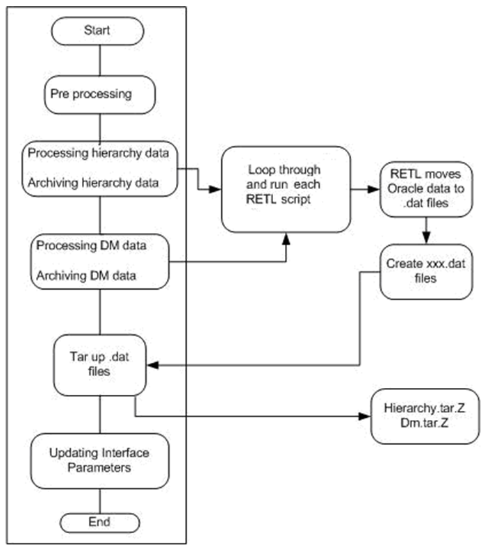

Export Flow Diagram
Table 7-0 shows the flow of data out of the AIP Oracle schema.
Figure 7-1 Export Flow
Script Name: cron_export.sh
This script exports all the DM and hierarchy information from AIP-Oracle to AIP-RPAS. This script prepares Oracle database for next scaling and smoothing runs.
Input Parameters
noTimestamp is an optional parameter that indicates whether to update the INTERFACE_PARAMETER table or not. By default, the table is updated unless the value noTimestamp is entered to prevent the LAST_EXPORT value from being updated.
Requirements
This script requires a configuration file containing a list of export scripts.
Day on Day Processing
The script exports data from the Oracle database to AIP RPAS. The script is designed to execute automatically by a scheduled CRON job every night after the online day and before AIP RPAS Batch is run.
It is assumed that batch lock has been applied and VDATE has been updated as documented earlier before the start of this process.
The script first calls pre_aiponline_extract.sh to perform pre-export updates. Next, each export script is invoked. After the data is successfully extracted, the script updates the timestamp on the INTERFACE_PARAMETERS table.
Processing Steps
Table 7-1 lists the processing steps for cron_export.sh. Details of these steps are described in their corresponding section.
  1. Execute pre-extract setup and maintenance.
    The pre_aiponline_extract.sh script sets up the planning horizon days which are used throughout the extract logic and maintains/decrements the walking order cycle exceptions.
  2. Process hierarchy data.
    Use the process_aiponline_data.sh script with the input parameter as export_ hierarchy.config to process the hierarchy data.

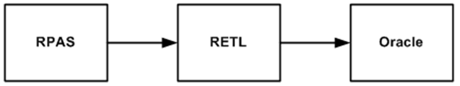

Import Overview
Upon completion of the batch jobs, RPAS generates flat files (.dat data files) that contain the hierarchy and measure data that is required in DM and OM Oracle Online. Data files exported from RPAS should then be retrieved by copy or FTP using a job scheduling application. Once the Oracle import process begins, the data is loaded into the Oracle database by using RETL (Oracle Retail Extract, Transformation, and Load). For this step, only the Load part of RETL is used.
Figure 7-2 Importing Flow
Staging tables, prefaced with INTERFACE_ or i_, temporarily store the records from the .dat file in the Oracle database. RETL then invokes a stored procedure to move the data from the staging table to the base table.
The following two files are needed to move the flat file to the staging table using RETL:
  • Import Script ($INTEGRATION_HOME/scripts/import)
  • Schema File ($INTEGRATION_HOME/schema)

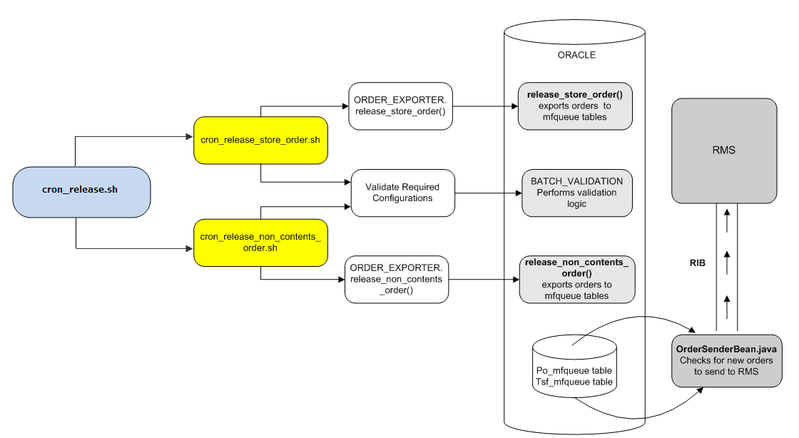

Order Release Overview
After the nightly RPAS batch run, the planned store and warehouse orders are extracted to a set of flat files (.dat data files) that are loaded into AIP Oracle. Similarly after the Intra-day replanned store orders are extracted to a set of .dat files, they are loaded into AIP Oracle. Order Release batch determines which orders must be released to the order execution system (RMS). Overnight orders that are a candidate for release must have a release date of today. Intra-day orders that are candidate for release must have a release date of today and release wave equal to the given release wave that is passed into the batch release script.The release date is determined by the source lead time. Additionally, the destination of a transfer must have a warehouse-chamber status of either Release or Closing Down. Once these conditions are met, the order is assigned either a purchase order number or a transfer number. The purchase order or transfer is then released to RMS where the SKU, destination, and order quantity are communicated to the supplier or warehouse source.
The released orders and forecast purchase orders are also visible from the OM Online screens. You are able to perform an early release or modify the order quantity, the delivery date, and the destination of a purchase order. In case of Intra-day release if a future release wave is manually released, it's release wave is changed to null indicating manual release. These user-entered modifications must also be communicated to RMS to be executed by the sender of the order.
Figure 7-3 Order Release Flow
Release Orders
An overnight batch release of AIP RPAS generated orders and transfers is performed once in the morning before the online users resume their daily screen activity. All orders and transfers scheduled for release today and are not set to be released in any release wave are communicated to RMS. The orders are assigned a purchase order number or transfer number, and the order status are then set to Open.
The Intra-day batch release is kind of delayed release of into-store orders with the option of replanning prior to release. An order for SKU/store set to be released in a selected release wave can be replanned in prior release waves. Functionally each replanned order replaces the previous order. Technically, the orders are not physically deleted just that they are identified and updated as replanned. At the time of release, only those orders that are marked to be release on the given release wave and are not replanned (not deleted) are released.
There are some rules about the order in which release waves can be sequenced. The release wave number denotes a nominal time from 0 to 23 where 0 indicates midnight and 23 indicates night 11:00 PM. When configuring the waves, gaps are allowed. For example, you can set up waves such as 2, 5, 8, and 10. Once configured, the waves must be executed in order of increasing wave numbers. Also a wave execution cannot be jumped over to execute a later wave. Wave execution refers to both loading and releasing orders for a particular wave. Overnight load and overnight release always take place before any Intra-day load or Intra-day release.
Technical Details
This process releases store purchase orders, store transfers, warehouse transfers, and warehouse purchase orders to the merchandising system. The order information is written to a set of staging tables. The records on the staging tables provide detail about the order items and the type of action that must be performed by the RMS message subscription logic so that the RMS order is in sync with the AIP order. An Enterprise Java Bean called OrderSenderBean constantly polls the table to find new records. It then reads the details from the staging tables and the base order tables to generate the messages sent to RMS through the RIB.
Script Name: cron_release.sh
This is a wrapper shell script to batch release Purchase Orders and transfers from AIP Oracle tables.

  • scripts/cron_release_store_order.sh
  • scripts/cron_release_non_contents_order.sh
Release Store Orders
This process is executed by cron_release.sh when the dest_type parameter is store or all. When called for releasing overnight orders, release wave parameter is overnight. When called for releasing Intra-day orders, release wave parameter is a number between 0 and 23. This process releases store transfers and purchase orders to the merchandising system. Order line items are grouped together and assigned a purchase order number or transfer number, and the order status is then set to Open. The order information is written to a set of staging tables. The records on the staging tables provide detail about the order items and the type of action that must be performed by the RMS message subscription logic so that the RMS order is in sync with the AIP order. An Enterprise Java Bean called OrderSenderBean constantly polls the table to find new records. It then reads the details from the staging tables and the base order tables in order to generate the messages sent to RMS through the RIB.
Technically into-store purchase orders and into-store transfers follow the UPDATE model of release process that is based on assigning order_number and changing order_status using an UPDATE or MERGE statement on order lines already present in main table.
Script Name: cron_release_store_order.sh
The script calls the following PL/SQL wrapper procedure in order to perform the release of store purchase orders and/or transfers. Also listed are some of the important pre-release validation checks called from wrapper procedure.
Users should avoid executing this script directly. Instead the wrapper script, cron_release.sh should be executed.

Release Warehouse Orders
This process is executed by cron_release.sh when the dest_type parameter is warehouse or all. A batch release of warehouse orders are performed once in the morning before the online users resume their daily activities. Order line items are grouped together and assigned a purchase order number or transfer number, and the order status is then set to Open. All warehouse orders scheduled for release today are communicated to RMS.
Technically, into-warehouse purchase orders follow the UPDATE model of release process while the into-warehouse transfers follow the INSERT model of release process. The update model of release is based on assigning order_number and changing order_status using an UPDATE or MERGE statement on order lines already present in main table. The insert model is based on assigning order_number as part of INSERT statement when inserting order lines into the main table. Functionally both model of release are equivalent.
Script Name: cron_release_non_contents_order.sh script
The script calls the following PL/SQL wrapper procedure in order to perform the release of warehouse purchase orders and/or transfers. Also listed are some of the important pre-release validation checks called from wrapper procedure.
This script should not be called directly, instead the wrapper script cron_release.sh should be executed.
Procedure of package: Script
ORDER_EXPORTER release_non_contents_order

Post release is a required post-critical process that should be executed after critical overnight release process is over and before online user activity starts.
Script Name: cron_post_release.sh
This is a wrapper shell script for post release activities performed after cron_release is completed.
Input Parameters
Following are the input parameters for the cron_post_release.sh script.
  • Order Type (o): [transfer|purchase|all] This is a required parameter.
    Parameter Action
    -o transfer Executes post-release steps of transfers only.
    -o purchase Executes post-release steps of purchase orders only.
    -o all Executes post-release steps of both purchase orders and transfers.
  • Destination Type (d): [warehouse|store|all]. This is a required parameter.
    Parameter Action
    -d warehouse Executes post-release steps of into-warehouse orders only.
    -d store Executes post-release steps of into-store orders only.
    -d all Executes post-release steps of both into-warehouse and into-store orders.
Processing Steps
This script calls the following scripts depending on the value of the destination type parameter passed into it:
  • scripts/post_release_store_order.sh
  • scripts/post_release_warehouse_order.sh
Restart/Recovery
If this script fails, perform the following steps:
  1. Examine the log files to determine the cause of the failure.
  2. Correct any identified setup or environment issues.
  3. Restart the script.
