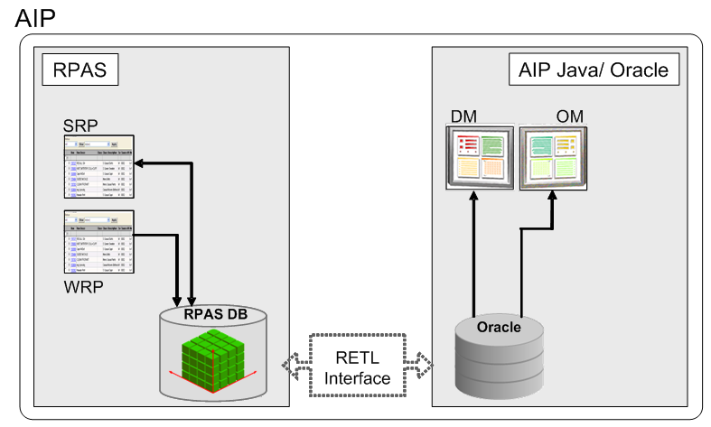

During the online day, AIP users log in to the SRP, WRP, DM, and OM client interfaces to maintain all the parameters and supply chain information for the replenishment and allocation calculations across the stores and warehouses.

The SRP and WRP users log in to the respective workbooks to maintain the parameters for the calculations, and also to resolve the alerts that were raised during the previous nightly batch process.
Data Management users log in to maintain the supply chain across the warehouses and stores. Order Management users log in to work on the orders created during the nightly batch process. Any modifications to the orders are immediately communicated to RMS.
Once these online users are done with their activities, they can submit all the planning parameters to the AIP-RPAS or Oracle database. Later, during the batch execution process, this data is imported for the replenishment and allocation calculations.

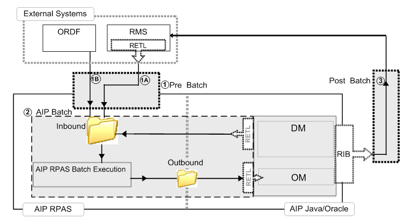

Figure 10-2 AIP Daily Batch Processing Steps
Pre AIP Batch
In the pre AIP batch process, the data for AIP is extracted from the external systems and copied or transferred through FTP into the inbound AIP directory.
The Pre-AIP Batch Process in External Systems
The following table describes this phase of the process as shown in Figure 10-2.
Phase Description
1A During the RMS batch process, RETL scripts extract data from the Oracle database. The files must be copied or transferred through FTP into the Inbound directory.
1B The RDF data for AIP is extracted and loaded into the common directory. During the RDF batch process, the batch scripts are executed to extract information from RDF and place it in the Inbound folder.
AIP Batch
The AIP batch process is executed on both the AIP RPAS and AIP Java/Oracle platforms.
The AIP Batch Process on the RPAS Platform
The following list describes this phase of the process as shown in Figure 10-2.
  1. Transforms the RMS data files into AIP loadable format.
  2. Runs the AIP batch scripts for all daily batch steps:
    • Formats and loads the RMS data files and other externally generated files from a directory (Inbound folder)
    • Merges and loads the DM online files from a directory
    • Loads the forecast data files from a directory
    • Runs the replenishment and reconciliation logic
    • Exports the AIP RPAS batch output data into a directory (Outbound folder)
    • Loads a modified AIP-scaled order plan
    • Generates alerts
    • Builds SRP and WRP workbooks configured for auto-workbook builds
The AIP Batch Process on the Java/Oracle Platform
Time wise the AIP batch processes that run on the Oracle platform straddle the AIP processes that run on the RPAS platform. Before any of the replenishment planning calculation preparation can begin in AIP RPAS the data must be extracted out of the AIP Oracle database. The cron_export script is used to accomplish this.
After the replenishment plan has been generated the plan is exported to an outbound data directory in the form of orders (purchase orders and transfers). The planned orders, along with the RMS enterprise data, and any DM data that was created or modified in the AIP RPAS batch processes is retrieved and loaded by the AIP Oracle batch process. Use of the cron_import and cron_import_order scripts accomplish this process.
An alternate approach to importing DM data into AIP Oracle can be used to maximize CPU utilization and shorten the nightly batch window. DM data can be imported into AIP Oracle immediately after it has been exported from AIP RPAS. Specifically, the cron_import DM step can be executed immediately after the export_dm_data step is complete. For detailed information on these steps, please refer to Chapter 4, "AIP RPAS Batch Processing." This process improves performance by executing the import of DM data at a time when the AIP Oracle server may otherwise be under little or no load.
After the necessary DM data is imported the cron_import script then initiates a number of processes that automatically set up the supply chain for new hierarchy data. These processes also automatically default some supply chain data when missing, and replaces some supply chain data when invalid.
The planned warehouse purchase orders, once loaded, are then passed through a module which pulls-forward future POs in order to achieve supplier minimums and/or container minimums on a particular day.
After the necessary minimums have been applied to the POs all planned orders that have met their lead time are released en mass to RMS for execution. The orders are communicated to RMS by using the RIB integration tool. The cron_release.sh perform the necessary steps to post orders to the appropriate RIB publication tables. The methods of interfacing purchase orders and transfers are dictated by separate system parameters which are stored in the database. In the event that the RIB is not used, AIP Oracle can extract purchase order and transfer data into text files.
The tsf_po_export script is used to accomplish this. However, it is important to note that RMS supports RIB-based purchase order and transfer subscription only.
