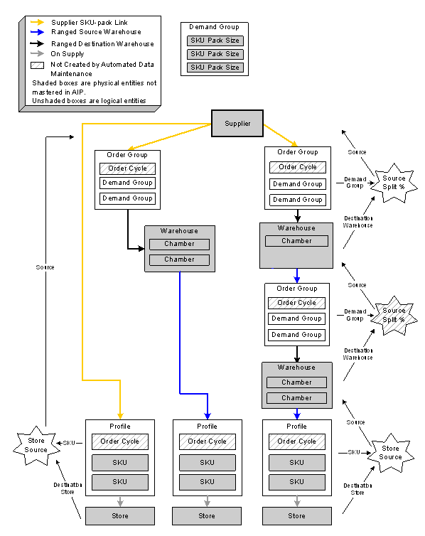

Figure 19-1 AIP Supply Chain Structure Diagram
Surrounding text describes Figure 19-1 .
Figure 19-1 lists the physical as well as logical entities of the supply chain that must be defined within AIP. If configured correctly, all logical entities can be created by the Automated Data Maintenance processes, with the exception of those noted in the diagram and the Supplier SKU pack size links.
The diagram provides an easy-to-discern list of needed supply chain elements. For example, by examining Figure 19-1 from top to bottom it can be seen that:
  • A source must be connected to an Order Group for delivery into warehouses and a Profile for delivery into the store.
  • The Order Group must be associated with an Order Cycle.
  • Demand Groups must be associated with an Order Group for deliveries from a source to a warehouse-chamber destination.
  • Demand Groups must be created for SKU-pack sizes.
Figure 19-1 illustrates what the First Day of AIP needs to accomplish on the Oracle platform. By fully comprehending each element of Figure 19-1, it becomes clear why the first day process should be different for AIP on Oracle and how to maximize the effect of automation while minimizing the amount of extra effort required to enable it.
The full analysis of each element of Figure 19-1 is out of the scope of this document; however, the elements that impact the first day will be examined.
  • Order Cycles are required to create Order Groups and Profiles. Order Cycles are not created by Automated Data Maintenance; however, default Order Cycles are provided as seed data loaded before the Fist Day.
  • Warehouse chambers are required to create Order Groups and ranged warehouse/SKU-pack sizes. Chambers are not created by Automated Data Maintenance since there is not a single rule-set that will work for all businesses. It is maintained as a manual process. Automated Data Maintenance could do very little setup the first day if the First Day process was not altered to accommodate for this fact.

Step 6: First Day of AIP on Oracle Automation
Step Details
When configured and run, Automated Data Maintenance will set up the supply-chain for new Suppliers, new SKU-pack sizes, sister warehouses, and sister stores. On the first day, this pertains to all suppliers and SKU-pack sizes because all data is new to AIP.
None of the maintenance activities will have an effect because all data is new and therefore no invalid relationships exist. Refer to the Oracle Retail Advanced Inventory Planning Operations Guide for a detailed explanation of the processes run to set up and maintain the supply-chain.
Sister store and sister warehouse automation do nothing the first day.
