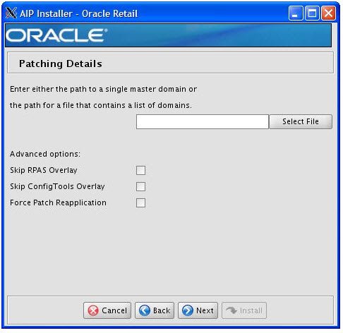

  6. The Patching Details Window opens and allows you to set the path to your domains and select installation options which performs a patch installation over an existing AIP installation and any existing AIP domains.
    Enter the path in the Select File box, select any options as shown in Table 7-1 and click Next to continue to the Installation Progress Window.
    Figure 7-4 Patching Details Window
    Surrounding text describes Figure 7-4 .
    Table 7-1 Patching Details Fields
    Patching Details Fields Description
    Select File box
    Enter the absolute path to a master domain or an absolute path to a file that contains a domain list.
    Skip RPAS Overlay
    When checked, patching skips the RPAS_HOME overlay application.
    Skip ConfigTools Overlay
    When checked, patching skips the RIDE_HOME overlay application.
    Force Patch Reapplication
    Select this check box when you are reapplying this patch.

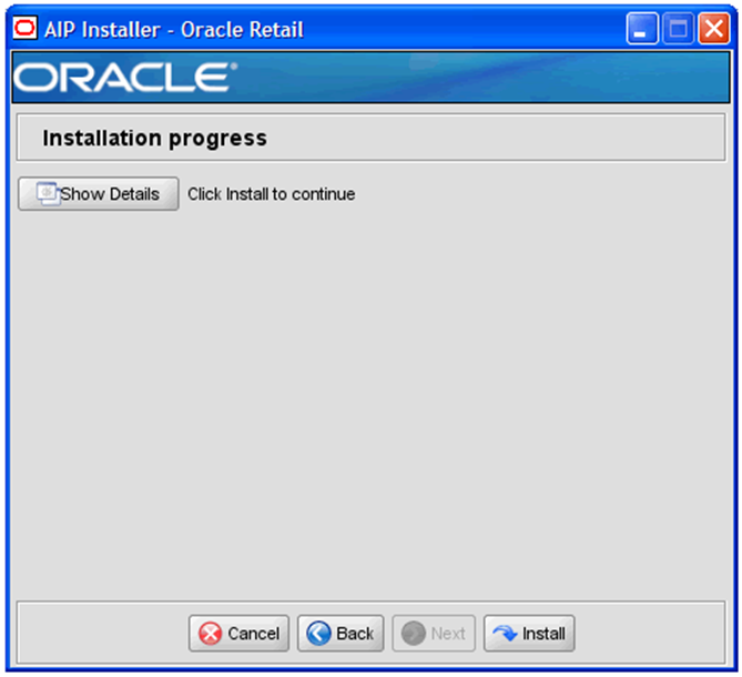

  7. The Installation Progress Window opens.
    To display the progress of the components and tasks being performed by the AIP Installer, click Show Details. Click Install to start the installation process.
    Figure 7-5 Installation Progress Window
