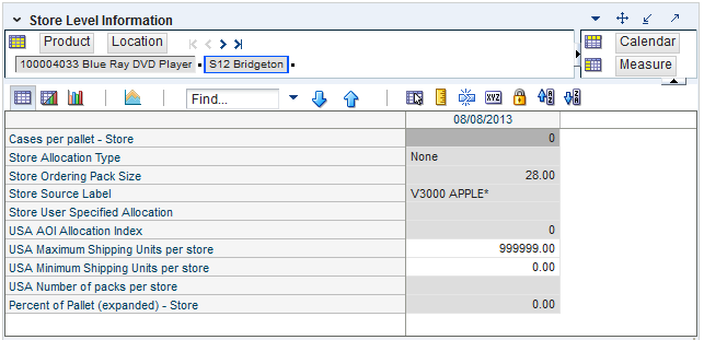

Store Step
This step allows you to specify a quantity from the source stocking point to spread proportionally across a set of stores taking into account the store inventory.
The available view is:

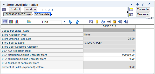

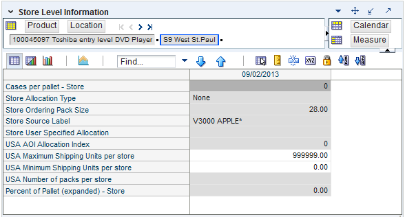

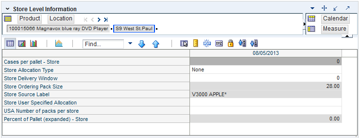

Store Level Information View
This view displays store specific pack-size, cases per pallet, and source level information. This view allows you to create or update USAs at the SKU/Store/Day level. The allocation type is specified and the USA can be entered in units or packs.
Figure 9-1 Store Level Information View
Surrounding text describes Figure 9-1 .
Table 9-1 lists the measures in this view.
Table 9-1 Measures: Store Level Information View
Measure Label Description
Cases Per Pallet-Store
Cases Per Pallet reflects the number of cases on a pallet.
Note: Cases Per Pallet is loaded from Data Management (DM).
(Read only)
Store Allocation Type
The Store Allocation Type indicates whether the allocation should be added to the receipt plan calculation or whether it should act as a replacement of the receipt plan.
Upon opening the workbook, the Store Allocation Type displays unavailable for any invalid combinations (no store source, not on supply, or invalid store ordering pack-size).
If a USA was deleted previously and the date it was deleted is still after today, the workbook displays 0 units for the USA and None as the Allocation Type. This does give you the opportunity to create a USA even though it was deleted previously.
If the Allocation Type is not unavailable, Valid values are:
  • None
  • Add
  • Replace
  • Delivery Window
Note: Delivery Window USAs can only be set up for those SKU/Store combinations sourced by a warehouse.
Store Delivery Window
The Store Delivery Window indicates the time window over which the Delivery Window allocation quantity has to be delivered from the warehouse to the stores.
If the delivery window entered put the release date before today, the delivery window is changed back to its original value and the following alert is issued:
The Release Date is before today. Please refresh the workbook and enter a smaller delivery window.
At this point the workbook is unstable, and must be refreshed before continuing.
The Store Delivery Window is only updated in the database if the Allocation type is Delivery Window.
Store Ordering Pack-size
The Store Ordering Pack-size represents the primary pack-size to be used when ordering a SKU for a store (either from a warehouse or from a supplier).
Note: Store Ordering Pack-size is loaded from Data Management (DM). The allocation must be a multiple of the store ordering pack-size.
(Read only)
Percent of Pallet (expanded)-Store
Percent of pallet is used to determine if the Ideal Receipt Quantity for replenishment should be rounded to a full pallet. It represents the percentage threshold that case demand must exceed in order for pallet rounding to occur.
The expanded version of Store Percent of Pallet displays the actual value used in the calculations. This is the merge of exception level (SKU/Store/Day), default level (Sub-class/Store format), and global level (Dept) values entered.
(Read only)
Store Source Label
The Store Source Label identifies the source from which this store receives inventory.(Read only)
Store User Specified Allocation
The Store User Specified Allocation represents the number of units to replace or add to an unreleased store order.
Any positive integer, including zero, is valid.
If the number entered is not a multiple of the Store Ordering Pack-size, it is rounded to the nearest Store Ordering Pack-size based on the Store Rounding Threshold.
If the Store Allocation Type is Add, the value is added to the store order. If the Store Allocation Type is Replace, the value replaces the store order. If the Store Allocation Type is Delivery Window, the value replaces the store order.
If the USA Number of packs per store changes, the USA is calculated as the USA Number of packs per store multiplied by the Store Ordering Pack-size.
The Store User Specified Allocation is only updated in the database if the Allocation type is Add, Replace or Delivery Window.
The USA Number of packs per store allows you to specify the USA in packs. When the number of packs is specified, the Store User Specified Allocation is updated to reflect the number in units.
If the Store User Specified Allocation changes, the USA Number of packs per store is calculated as the Store User Specified Allocation divided by the USA Number of packs per store.

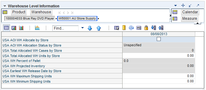

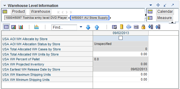

Warehouse Step

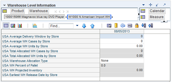

Warehouse Level Information View
This view displays the release date, cases per pallet, and warehouse inventory information. Updates made at the warehouse level are spread back to the store level.
Figure 9-2 Warehouse Level Information View
Surrounding text describes Figure 9-2 .
Table 9-2 lists the measures in this view.
Table 9-2 Measures: Warehouse Level Information View
USA Average Delivery Window by Store
The USA Average Delivery Window by Store is the average of the sum of Store Delivery Window of this SKU for all stores in the workbook sourced by this warehouse.
If the average delivery window is updated, the value entered is replicated for all stores in the workbook sourced by this warehouse.
If the average delivery window entered put the release date before today, the delivery window is changed back to its original value and an alert is issued. At this point the workbook is unstable, and must be refreshed before continuing.
USA Average WH Cases by Store
The USA Average WH Cases by Store is the average of the sum of Average WH Cases by Store of this SKU for all stores in the workbook sourced by this warehouse.
If the average WH cases value is updated, the value entered is replicated for all stores in the workbook sourced by this warehouse.
USA Average WH Units by Store
The USA Average WH Units by Store is the average of the sum of Average WH Units by Store of this SKU for all stores in the workbook sourced by this warehouse.
If the average WH units value is updated, the value entered is replicated for all stores in the workbook sourced by this warehouse.
USA Earliest WH Release Date by Store
The USA Earliest WH Release Date by Store is calculated based on the maximum lead time for the stores sourced by this warehouse.
For Delivery Window USAs, the earliest release date is the greater of the lead time and delivery window for the stores sourced by this warehouse.
If the Release Date is aggregated to a higher level, the value of the earliest release date is displayed.
(Read only)
USA Total Allocated WH Cases by Store
The USA Total Allocated WH Cases by Store is the total of the USA Number of packs per store of this SKU for all stores in the workbook sourced by this warehouse.(Read only)
USA Total Allocated WH Units by Store
The USA Total Allocated WH Units by Store is the total of the Store User Specified Allocation of this SKU for all stores in the workbook sourced by this warehouse.(Read only)
USA Warehouse Allocation Type
The USA Warehouse Allocation Type is the allocation type of this SKU for all stores in the workbook sourced by this warehouse. If the values are different, a question mark (?) is displayed.
  • None
  • Add
  • Replace
  • Delivery Window
If you update the Warehouse Allocation Type of this SKU, it is replicated for all stores in the workbook sourced by this warehouse.
USA WH Percent of Pallet
The USA WH Percent of Pallet is percent of pallet of this SKU for all stores in the workbook sourced by this warehouse. If the values are different, a question mark (?) is displayed.
(Read only)
USA WH Projected Inventory
USA WH Projected Inventory represents the total projected inventory of this SKU shifted by lead time at the source warehouse.
The day the projected inventory is shown for each SKU corresponds to the earliest warehouse release day when there are multiple release days for a single receipt date at any of the stores (in other words, corresponding to the max lead time).
(Read only)

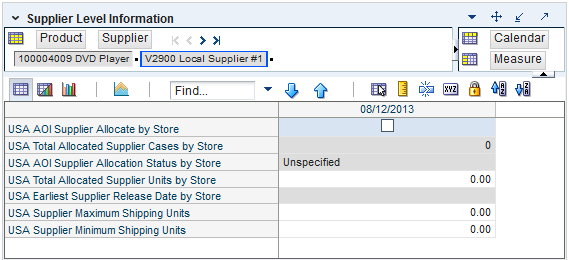

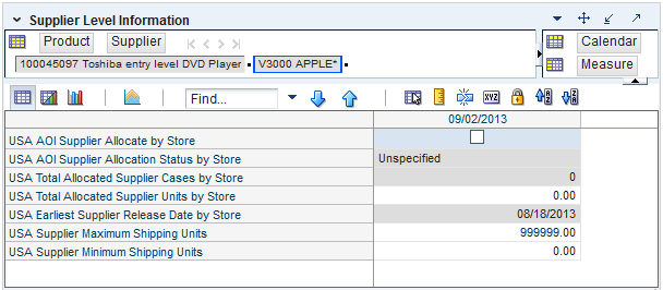

Supplier Step

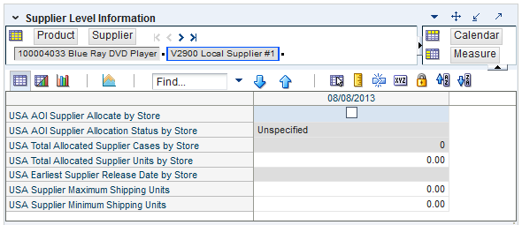

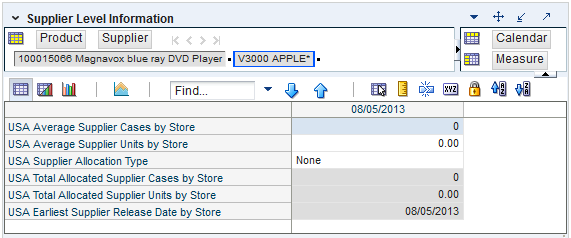

Supplier Level Information View
This view displays the release date, average unit and cases by supplier. Updates made at the supplier level are spread back to the store level.
Figure 9-3 Supplier Level Information View
Surrounding text describes Figure 9-3 .
Table 9-3 lists the measures in this view.
Table 9-3 Measures: Supplier Level Information View
USA Average Supplier Cases by Store
The USA Average Supplier Cases by Store is the average of the sum of Average Supplier Cases by Store of this SKU for all stores in the workbook sourced by this supplier.
If the average Supplier cases value is updated, the value entered is replicated for all stores in the workbook sourced by this supplier.
USA Average Supplier Units by Store
The USA Average Supplier Units by Store is the average of the sum of Average Supplier Units by Store of this SKU for all stores in the workbook sourced by this supplier.
If the average Supplier units is updated, the value entered is replicated for all stores in the workbook sourced by this supplier.
USA Earliest Supplier Release Date by Store
The USA Earliest Supplier Release Date by Store is calculated based on the maximum lead time for the stores sourced by this supplier.
For Delivery Window USAs, the earliest release date is the greater of the lead time and delivery window for the stores sourced by this supplier.
(Read only)
USA Supplier Allocation Type
The USA Supplier Allocation Type is the allocation type of this SKU for all stores in the workbook sourced by this supplier. If the values are different, a question mark (?) is displayed.
  • None
  • Add
  • Replace
  • Delivery Window
If you update the Supplier Allocation Type of this SKU, it is replicated for all stores in the workbook sourced by this supplier.
USA Total Allocated Supplier Cases by Store
The USA Total Allocated Supplier Cases by Store is the total of the USA Number of packs per store of this SKU for all stores in the workbook sourced by this supplier.(Read only)
USA Total Allocated Supplier Units by Store
The USA Total Allocated Supplier Units by Store is the total of the Store User Specified Allocation of this SKU for all stores in the workbook sourced by this supplier.(Read only)

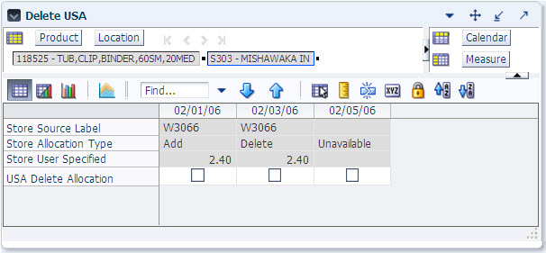

Delete USA (SKU/Store/Day) View
This view allows deletion of USAs at the SKU/Store/Day level. After selecting a range of dates and SKUS in the wizard process, you can view any existing USAs. You can then identify USAs that should be deleted and check the USA Delete Allocation box to delete a USA.
Figure 9-4 Delete USA View (SKU/Store/Day) View
Surrounding text describes Figure 9-4 .
Table 9-4 lists the measures in this view.
Table 9-4 Measures: Delete USA View (SKU/Store/Day)
If USA Delete Allocation is checked, the allocation type is changed to Delete.
(Read only)
Store Source Label
The Store User Specified Allocation represents the number of units to replace or add to an unreleased store order. The allocations displayed in this workbook are available for deletion.
Checking the USA Delete Allocation option causes to store USA quantity to be cleared.
(Read only)
The USA Delete Allocation is checked to delete the USA.
If the delete allocation box is checked for a SKU/Store/Day combination, the Store User Specified Allocation quantity is cleared and the Store Allocation Type is changed to Delete. On the appropriate Source (warehouse or supplier) view, the amount of the USA deleted is reduced from the Source's USAs and the Source's Allocation Combination type is updated.

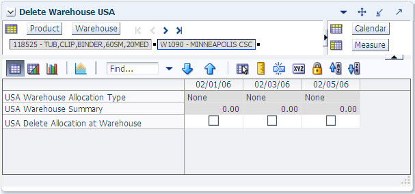

Delete Warehouse USA (SKU/Warehouse/Day) View
The Delete Warehouse USA view can be used to delete USAs at the SKU/Warehouse/Day level or to view the effect of deletions of Store USAs for stores sourced by this warehouse.
Deleting a Warehouse USA deletes all store USAs sourced by this warehouse/Day combination.
When a Store USAs is deleted, the Warehouses USA is updated to reflect the lower level changes.
Figure 9-5 Delete Warehouse USA (SKU/Warehouse/Day) View
Surrounding text describes Figure 9-5 .
Table 9-5 lists the measures in this view.
Table 9-5 Measures: Delete Warehouse USA View (SKU/Warehouse/Day)
USA Delete Allocation at Warehouse
The USA Delete Allocation is checked to delete all store USAs sourced by this warehouse/Day combination. The Store Allocation Type is changed to Delete and the Store User Specified Allocation is cleared for these stores.
  • None
  • Add
  • Replace
  • Delivery Window
The Warehouse Allocation Type may be updated based on deletions of Store User Specified Allocations. (Read only)
USA Warehouse Summary
The USA Warehouse Summary displays the sum of all store USAs sourced by this warehouse/Day combination.
If a store USA sourced by this warehouse is deleted, the warehouse User Specified Allocation Calculation is updated by subtracting the Store USA quantity from the Warehouse USA quantity. (Read only)

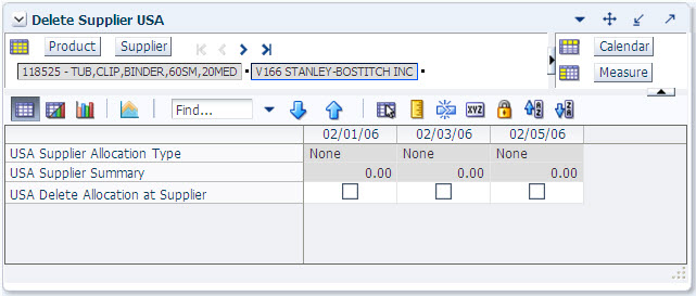

Delete Supplier USA (SKU/Supplier/Day) View
This view can be used to delete USAs at the SKU/Supplier/Day level or to view the effect of deletions of Store USAs for stores sourced by this supplier.
Deleting a Supplier USA deletes all store USAs sourced by this Supplier/Day combination.
When a Store USAs is deleted, the Supplier USA is updated to reflect the lower level changes.
Figure 9-6 Delete Supplier USA (SKU/Supplier/Day) View
Surrounding text describes Figure 9-6 .
Table 9-6 lists the measures in this view.
Table 9-6 Measures: Delete Supplier USA View (SKU/Supplier/Day)
USA Delete Allocation at Supplier
The USA Delete Allocation is checked to delete all store USAs sourced by this Supplier/Day combination. The Store Allocation Type are changed to Delete and the Store User Specified Allocation are cleared for these stores.
  • None
  • Add
  • Replace
  • Delivery Window
The Supplier Allocation Type may be updated based on deletions of Store User Specified Allocations. (Read only)
USA Supplier Summary
The USA Supplier Summary displays the sum of all store USAs sourced by this Supplier/Day combination.
If a store USA sourced by this supplier is deleted, the supplier User Specified Allocation Calculation is updated by subtracting the Store USA quantity from the Supplier USA quantity. (Read only)

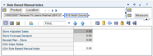

Rule Based Manual Index View
This view allows you to view adjusted sales, demand forecast, or store receipt plan measures that can be used to create the store based index.
Figure 9-7 Rule Based Manual Index View
Surrounding text describes Figure 9-7 .
Table 9-7 lists the measures in this view.
Table 9-7 Measures: Rule Based Manual Index View
Store Adjusted Sales
Store Adjusted Sales represents historical adjusted store sales information used to establish the adjusted sales history for the USA Allocation On Rule Based Index USA workbook.
It is calculated as the sum of adjusted sales for the days selected in the wizard. To use this measure as the rule based manual index, you manually copy the value into the USA Rule Based Manual Index.
(Read only)
Store Forecast Demand
Store Forecast Demand is calculated as the sum of the demand forecast for the days selected in the wizard. To use this measure as the rule based manual index, you manually copy the value into the USA Rule Based Manual Index.(Read only)
Receipt Plan-Store
Store Receipt Plan is calculated as the sum of the store receipts for the days selected in the wizard. To use this measure as the rule based manual index, you manually copy the value into the USA Rule Based Manual Index.(Read only)
USA Index Notes
USA Index Notes allows entry of a note for the rule based manual index.
The USA Rule Based Manual Index is used in the USA Allocation on Rule Based Index workbook as input to the watershed algorithm to determine the ratio for distributing the units across the stores for Store User Specified Allocation.
It is manually entered by you or manually copied from one of the three rules in this view:
  • Store Adjusted Sales
  • Store Forecast Demand
  • Store Receipt Plan
This view displays the calculated USA quantity, AOI Index quantity, store specific pack-size, cases per pallet, and source level information. It also provides the ability to enter maximum and minimum boundaries by store for the AOI quantity that is being pushed from the warehouse.
Figure 9-8 Store Level Information View
Surrounding text describes Figure 9-8 .
Table 9-8 lists the measures in this view.
Table 9-8 Measures: Store Level Information View
(Read only)
The Store Allocation Type is always Replace for AOI.
If the watershed calculation changes the allocation quantity, the Store User Specified Allocation is changed to Replace.
(Read only)
(Read only)
Store Percent of Pallet (Expanded)
(Read only)
Store Source Label
The Store User Specified Allocation represents the number of units to replace an unreleased store order.
When the source stocking point units are allocated to the stores using the watershed, algorithm, the Store User Specified Allocation changes to reflect the number of units each store was allocated. Since the allocations must be rounded to pack-size, the total allocation quantity from the source may not be met.
The Store User Specified Allocation is only updated in the database if the Allocation type is Replace.
(Read only)
USA AOI Allocation Index
The USA AOI Allocation Index represents the value in the USA Rule Based Manual Index and is used in the watershed algorithm to determine the ratio for distributing the units across the stores for Store User Specified Allocation.
Note: The USA Rule Based Manual Index must first be set up in the USA Create Rule Based Index workbook.
(Read only)
USA Maximum Shipping Units per store
The USA Maximum Shipping Units per store represents the maximum quantity that can be shipped to the store for this product. Store User The Specified Allocation cannot exceed this value.
The USA Maximum Shipping Units per store is only updated in the database if the Allocation type is Replace.
USA Minimum Shipping Units per store
The USA Minimum Shipping Units per store represents the minimum quantity that can be shipped to the store for this product. Store User The Specified Allocation must be equal to or greater than this value.
The USA Minimum Shipping Units per store is only updated in the database if the Allocation type is Replace.
When the Store User Specified Allocation value changes, the number of packs is calculated as the Store User Specified Allocation divided by the USA Number of packs per store.
(Read only)
This view provides the ability to push USAs based on an allocation index to stores. This view displays the earliest release date and warehouse inventory information. It also provides the ability to enter warehouse allocation maximum and minimum boundaries and a total allocation quantity to be pushed to stores. This can either be in units or cases.
Figure 9-9 Warehouse Level Information View
Surrounding text describes Figure 9-9 .
Table 9-9 lists the measures in this view.
Table 9-9 Measures: Warehouse Level Information View
USA AOI WH Allocate by Store
USA AOI WH Allocate by Store is a checkbox used to start the watershed algorithm to push the USA Total Allocated WH Units by Store across all stores in the workbook that are sourced by this warehouse.
USA AOI WH Allocation Status by Store
The USA AOI WH Allocation Status by Store indicates the warehouse level status of the algorithm.
  • Solution Found indicates the allocation was successful
  • Invalid Distribute Quantity indicates the allocation quantity was less than the sum of all the store minimums or greater than the sum of all the maximums
  • Invalid Shipping Quantity indicates the maximum and minimum shipping quantities are invalid
(Read only)
(Read only)
You can override this calculated quantity to change the allocation quantity to be pushed down to the stores sourced by this warehouse. The push does not happen until the USA AOI WH Allocate by Store option is checked.
USA WH Maximum Shipping Units
USA WH Maximum Shipping Units represents the average of the USA Maximum Shipping Units per for all stores in the workbook sourced by this warehouse.
You can override this calculated quantity to change the maximum to be pushed down to the stores sourced by this warehouse.
USA WH Minimum Shipping Units
The USA WH Minimum Shipping Units per store represents the minimum quantity that can be shipped to the store for this product.
You can override this calculated quantity to change the minimum to be pushed down to the stores sourced by this warehouse.
(Read only)
(Read only)
This view provides the ability to push USAs based on an allocation index to stores. This view displays the earliest release date and provides the ability to enter supplier allocation maximum and minimum boundaries and a total allocation quantity to be pushed to stores. This can either be in units or cases.
Figure 9-10 Supplier Level Information View
Surrounding text describes Figure 9-10 .
Table 9-10 lists the measures in this view.
Table 9-10 Measures: Supplier Level Information View
USA AOI Supplier Allocate by Store
USA AOI Supplier Allocate by Store is a checkbox used to start the watershed algorithm to push the USA Total Allocated Supplier Units by Store across all stores in the workbook that are sourced by this supplier.
USA AOI Supplier Allocation Status by Store
The USA AOI Supplier Allocation Status by Store indicates the supplier level status of the algorithm.
(Read only)
(Read only)
USA Supplier Maximum Shipping Units
USA Supplier Maximum Shipping Units represents the average of the USA Maximum Shipping Units per for all stores in the workbook sourced by this supplier.
You can override this calculated quantity to change the maximum to be pushed down to the stores sourced by this supplier.
USA Supplier Minimum Shipping Units
The USA Supplier Minimum Shipping Units per store represents the minimum quantity that can be shipped to the store for this product.
You can override this calculated quantity to change the minimum to be pushed down to the stores sourced by this supplier.
Figure 9-11 Store Level Information View
Surrounding text describes Figure 9-11 .
Table 9-11 lists the measures in this view.
Table 9-11 Measures: Store Level Information View
Cases Per Pallet - Store
(Read only)
  • None
  • Add
  • Replace
  • Delivery Window
(Read only)
(Read only)
Store Source Label

Warehouse Step
This step allows you to specify a quantity at the source stocking point to spread proportionally across a set of stores taking into account the store inventory.
Figure 9-12 Warehouse Level Information View
Surrounding text describes Figure 9-12 .
Table 9-12 lists the measures in this view.
Table 9-12 Measures: Warehouse Level Information View
(Read only)
(Read only)
(Read only)
(Read only)
Supplier Step
Figure 9-13 Supplier Level Information View
Surrounding text describes Figure 9-13 .
Table 9-13 lists the measures in this view.
Table 9-13 Measures: Supplier Level Information View
(Read only)
(Read only)

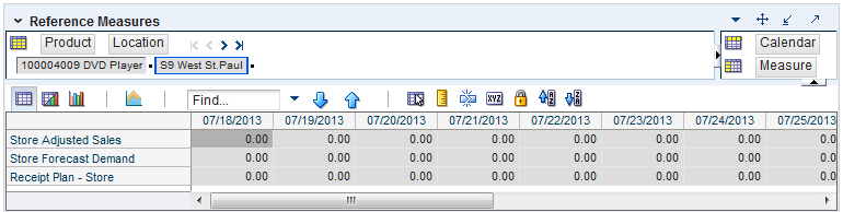

Reference Measures View
Figure 9-14 Reference Measures View
Surrounding text describes Figure 9-14 .
Table 9-14 lists the measures in this view.
Table 9-14 Measures: Reference Measures View
(Read only)
Store Adjusted Sales represents historical adjusted store sales information used to establish the adjusted sales history for the USA Allocation On Store Based Index USA workbook.
(Read only)
Store Receipt Plan (Read only)

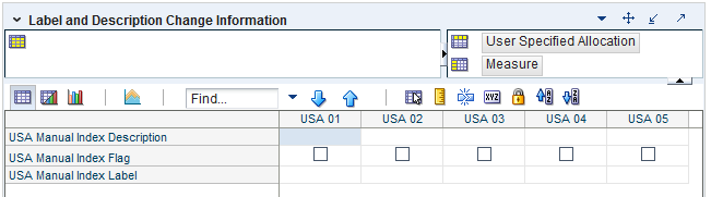

Label and Description Change Information View
This view allows you to create or update USA Manual Index Descriptions and Labels.
Figure 9-15 Label and Description Change Information View
Surrounding text describes Figure 9-15 .
Table 9-15 lists the measures in this view.
Table 9-15 Measures: Label and Description Change Information
The USA Manual Index Description contains a user-entered description of a Store Based Index.
In order to see the description in wizards and other views, right click on the USA, select Select display and sort attributes and click USA Manual Index Description to the right for Display Attributes.
To allow the description to be referenced for future workbook builds, the USA Manual Index Flag must be checked.
The USA Manual Index Flag enables users to create custom labels and descriptions for USA manual indexes.
This flag must be checked in order for label and description to be created in the next AIP batch run.
USA Manual Index Label
The USA Manual Index Label is a user-entered label created by users to identify a USA manual index.
In order to see the index label in wizards and other views, right click on the USA, select Select display and sort attributes and click USA Manual Index Label to the right for Display Attributes.
To allow the index label to be referenced for future workbook builds, the USA Manual Index Flag must be checked.

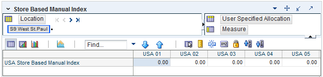

Store Based Manual Index View
This view allows you to create the store based index based on adjusted sales, demand forecast, or store receipt.
Figure 9-16 Store Based Manual Index View
Surrounding text describes Figure 9-16 .
Table 9-16 lists the measure in this view.
Table 9-16 Measures: Store Based Manual Index View
USA Store Based Manual Index
The USA Store Based Manual Index is used in the USA Allocation on Index (AOI) workbooks.
It is manually entered by you or manually copied from one of the three rules in the Reference Measures view:

Store Step
Figure 9-17 Store Level Information View
Surrounding text describes Figure 9-17 .
Table 9-17 lists the measures in this view.
Table 9-17 Measures: Store Level Information View
(Read only)
(Read only)
(Read only)
(Read only)
Store Source Label
(Read only)
The USA AOI Allocation Index represents the value in the USA Store Based Manual Index and is used in the watershed algorithm to determine the ratio for distributing the units across the stores for Store User Specified Allocation.
Note: The USA Rule Based Manual Index must first be set up in the USA Create Store Based Index workbook.
(Read only)
(Read only)
Warehouse Step
Figure 9-18 Warehouse Level Information View
Surrounding text describes Figure 9-18 .
Table 9-18 lists the measures in this view.
Table 9-18 Measures: Warehouse Level Information View
(Read only)
  • None
  • Add
  • Replace
  • Delivery Window
(Read only)
(Read only)
Supplier Step
Figure 9-19 Supplier Level Information View
Surrounding text describes Figure 9-19 .
Table 9-19 lists the measures in this view.
Table 9-19 Measures: Supplier Level Information View
(Read only)
  • None
  • Add
  • Replace
  • Delivery Window
