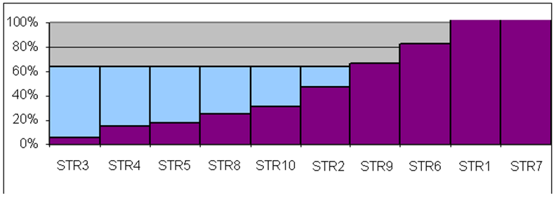

While the watershed algorithm is complex, the basic premise is to bring all destinations in the priority group up to a target ratio. The Target Stock Ratio is calculated by dividing the source's total available by its total need.
One way to think of this procedure is through an analogy of water filling a container. The fill line of the container represents 100% of need for all the locations, and the quantity of water we have represents the stock available. By pouring all of our water into the container the water level naturally reaches our Target Stock Ratio. If we imagine the bottom of the container to be partitioned to represent our different destinations, then the water above each partition represents each location's stock ratio as well. The water naturally levels itself to maintain a consistent stock ratio across all the destinations.
In this example, our target ratio is 64%. The purple bars on the chart represent the amount of inventory available at each store. The blue bars represent available inventory from the source allocated to the stores. In this case, only 6 of the stores are allocated additional inventory.
