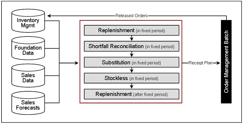

At the core of the AIP batch process are five replenishment subprocesses. These subprocesses perform calculations on a set of loaded static and dynamic data using replenishment parameters to produce a replenishment receipt plan for all locations in the supply chain. This functionality differs from many existing replenishment solutions because it yields an actionable plan across time. This gives retailers the ability to project their demand at all levels of the supply chain and to share these projections with their suppliers whenever it is appropriate.
Key to producing an actionable receipt plan is the inclusion of known inventory constraints. This is achieved by performing the five replenishment subprocesses across all locations in the following order:
The Replenishment process generates an Unconstrained Receipt Plan for the part of the planning horizon over which constraints are subsequently applied. This part of the planning horizon is called the Fixed Period.
The Shortfall Reconciliation process applies inventory limitations over the fixed period, modifying the receipt plan where necessary.
The Substitution process attempts to use product substitutes to satisfy any shortage created by Shortfall Reconciliation within the fixed period.
The Stockless process increases orders within the fixed period where necessary to ensure that no warehouse is left with inventory of a stockless product and contractual obligations to order specific quantities of products from vendors are honored.
Finally, the steps are repeated for a second time for the remaining part of the Planning Horizon after the fixed period.
The resulting receipt plan is then exported to the Order Management module where Order Numbers are produced and the orders released to external systems. Following formal order generation, these quantities are fed back into the system and the plan is updated to account for these orders as expected receipts. This type of planning allows the retailer to identify potential supply chain problems before they arise so that stock-outs and excess inventory problems can be prevented or reduced.
