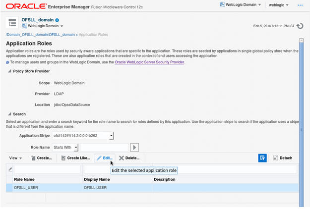

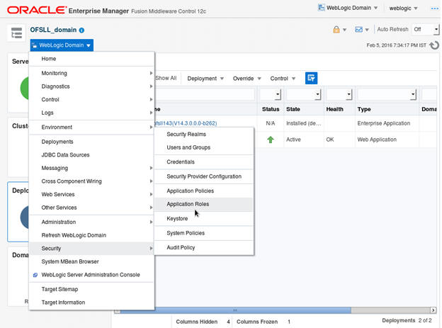

- Login to Oracle Enterprise Manager 12c console (http://hostname:port/em).
- Click WebLogic Domain > Security > Application Roles
on the right panel.
- Select Application
Stripe from the drop-down menu.
- Click the arrow head button. Details of the existing Roles
are displayed below:
- Select the ‘Role
Name’. Membership details of the selected Role Name are displayed
under Membership for "role_name"..

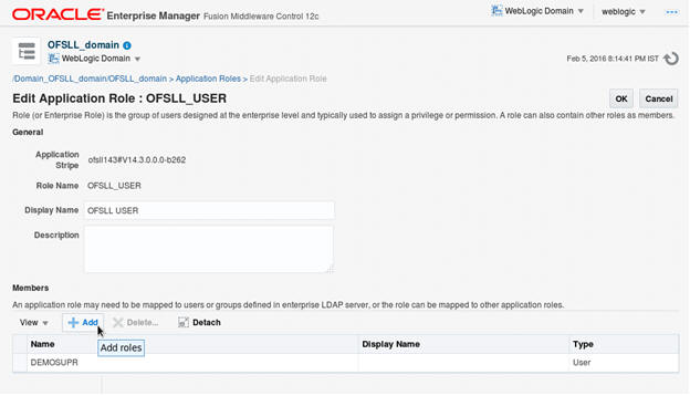

- Click ‘Edit’.
The following window is displayed.

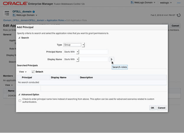

- Click ‘Add”.
Select type as Group. Click on the arrow head button.

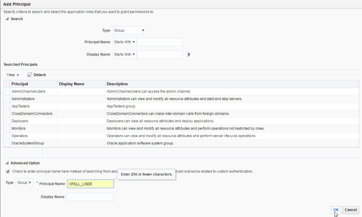

- Follow the given steps to select the Principal ‘OFSLL_USER’
to add and click OK. The following window is displayed.
- Check the check
box in Advanced options. Enter the name of Group manually.
- Click ‘OK’.
- The following
window is displayed with the confirmation message as ‘The Application
role of 'group_name' has been updated’.
