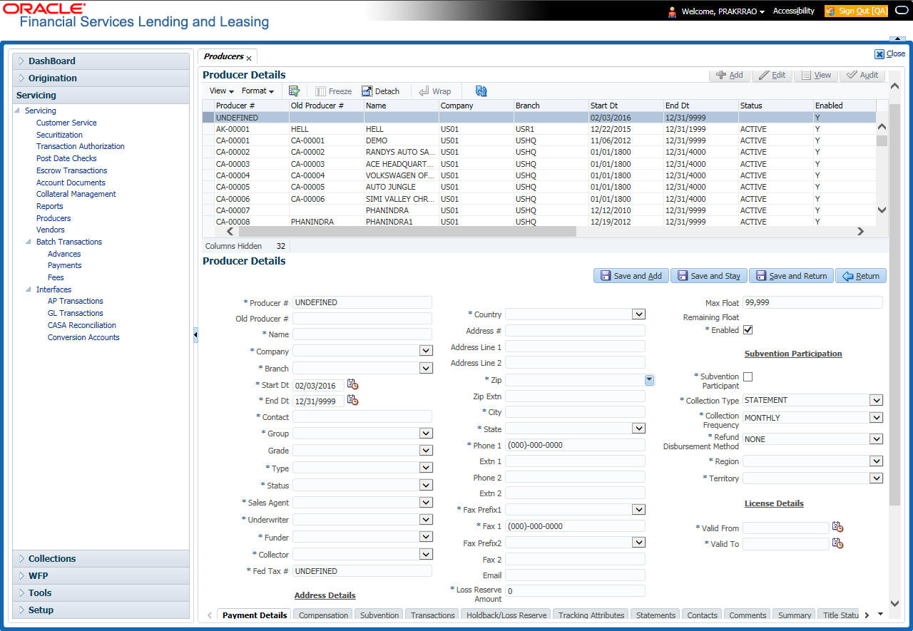

The Producers screen, completed during setup, can be used to view and maintain producer details.
11.1 Producer Details
The Producer details screen allows you to record or edit basic information about the producer. You can set up dealers or producers for a company and branch. You can also set up a default underwriter and a default collector for a producer. The system uses this information in the origination work flow to select a queue.
The producer number, name, contact information, company and branch to which the producer is associated with, federal tax number, status, and license information can be stored in this screen.
Navigating to Producer
  1. On the Oracle Financial Services Lending and Leasing home screen, click Collection > Collections > Producers.
  2. The system displays the Producers setup screen.
To set up the Producer
  1. In the Producer section, perform any of the Basic Operations mentioned in Navigation chapter.
A brief description of the fields is given below:
