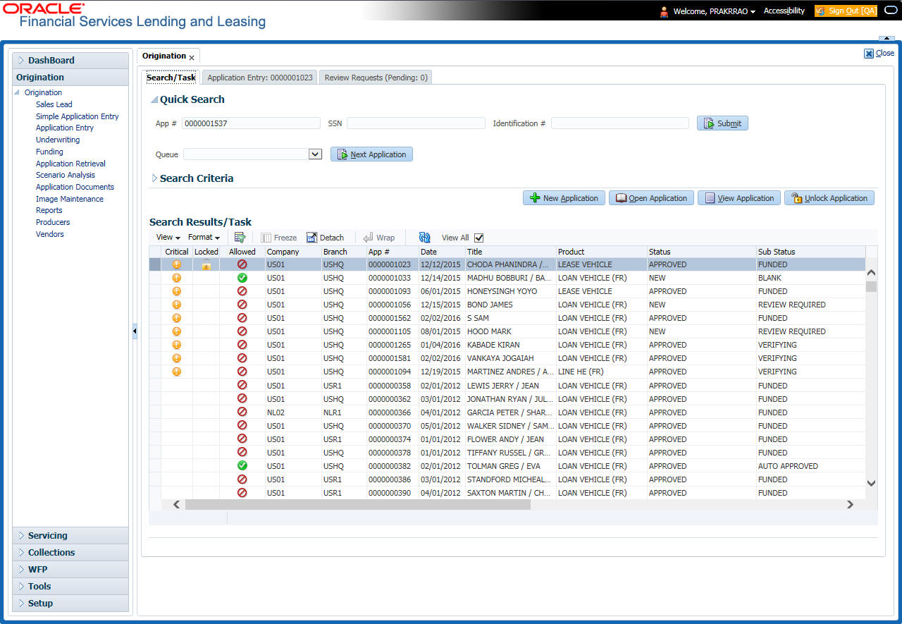

Application Status
While you are searching for an application in the Origination screens, the Search Result/Task tab lists all the available applications and also the status of each application for edits. The following table indicates the application status:
Description
Example Expression
Critical
Whenever any application is updated with dealer comments, a system generated alert will be posted in the application and a critical icon would be displayed in this column against that application. Once User has acted on the critical item, the alert flag should be manually be unchecked by the User to remove the 'Critical' flag on the application.
Locked
An application already opened by another User will have a lock icon in this column against the application. User with appropriate privileges can unlock the application and proceed.
Allowed
This field displays whether you can open the application from the respective Origination Screen or not i.e. if the application is in decision stage, a red flag will be displayed in Application Entry stage indicating that the application can only be viewed and User has to open the appli­cation in Underwriting for actioning. User can also see a green flag in Underwriting against this application indicating that it can be actioned in Underwriting.

2.2.1 Search/Task tab
To view the Search/Task screen during Lease origination
  1. On the Oracle Financial Services Lending and Leasing Application home screen, click the Origination master tab.
Depending on the task to be performed and the link clicked, the respective screen opens in the Search Results/Task screen.
  1. Click the Search Criteria tab.
The search tab enables you to locate an application using a broad range of search criteria.
The Search Results/Task screen.
  1. On the Results screen, select the application you want to load and click Open Application.
The system loads the application on the respective screen.
You are now ready to begin work on the application.
2.2.2 Quick Search section
Quick Search enables to search for an application using any one of the following values - Application Number, SSN, Identification Number or Queue.
To load an application using the Quick Search section:
  2. In the Quick Search section’s App # field, specify the application number you want to load and click Submit.
You can also load the application by specifying the last 4 digits of the SSN Number. System retrieves only those applications where the searched SSN is of the Primary Applicant. If multiple matches are found, system displays an error message as ‘Multiple Matches found for the SSN, Please use normal Search’.
Note
Search cannot be performed using wild card characters in the Quick Search section.
The system loads the selected application.
To load an application from a queue during application entry
  2. In the Quick Search section’s Queue field, select the queue you want to work with and click Next Application.
2.2.2.1 Other Features on the Results screen
The Results screen on the Applications screen has below listed common features (these features are not present on the Result screen on Customer Service screen):
What is it?
What does it do?
View All
If you select View All check box, all applications in the system acces­sible with your user id appear in the Results screen under search sec­tion.
Queue Name field
This display only field indicates the queue in which the selected appli­cation is currently in. (This in normally related to one or more of the following, based on setup: producer, state, or status.)
Secured box
Indicates that the selected application is secured (that is, that the applicant is an employee of the organization) and may only be loaded by authorized users.
Copy Applica­tion button
Creates a copy of the selected application. This feature is usually used when an applicant has submitted a previous application or when an applicant submits a second application and you don’t want to retype the information.
New Applica­tion
Opens a screen where a user can create a new application by provid­ing required details.
Open Applica­tion
Displays the application details for the selected application.
Unlock Appli­cation
Unlocks the selected application locked by another user.

2.3.3 Search Using Account Details
To search for and load an account using the Search screen
On the Oracle Financial Services Lending and Leasing home screen, click Servicing > Servicing > Customer Service > Search Criteria
  1. Select Account as a search option.
  2. On the Criteria screen, use the Comparison Operator and Value columns to create a search criteria to find an account. You can click Reset Criteria at any time to clear the Comparison Operator and Value columns.
  3. Click Search. The system locates and displays all the accounts that meet your search criteria on Results screen.
