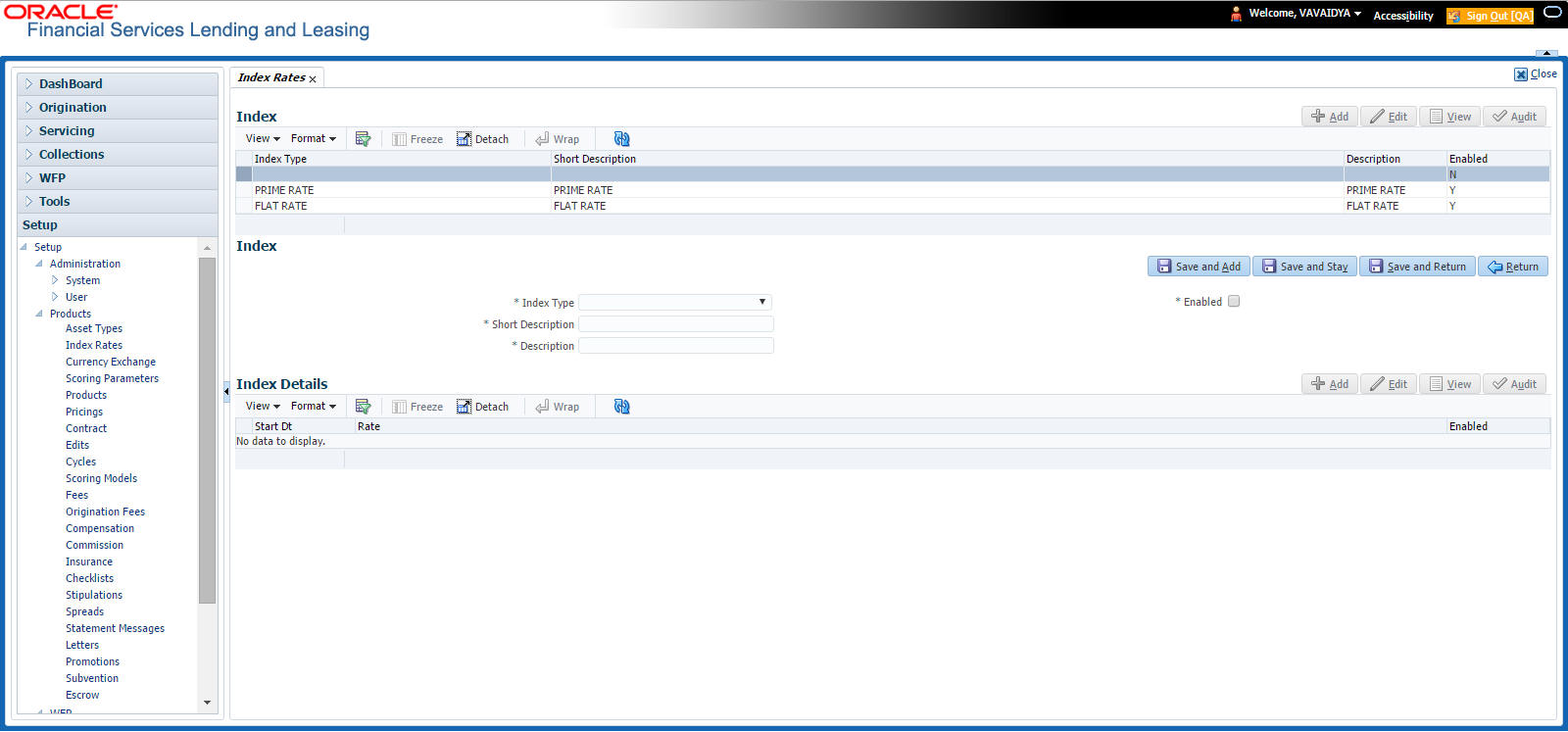

4.2 Index Rates
The Index Rates screen maintains your organization’s history of periodic changes in index rates. It allows you to define index rates to support variable rate lines of credit. The index rate provides the base rate for a credit line where:
interest rate = index rate + margin rate.
The Index section displays the currently defined indexes on the Lookups screen. You may create additional user-defined lookup codes for this lookup type as needed.
Note
You cannot tie an index rate to a product rate.
You can also record any index rate change on the Index Rates screen. During nightly batch processing, all the accounts with that index type are included when posting the RATE CHANGE transaction. After the system processes the batch, the interest rate of the account is changed. The system will use this new interest rate when computing all future interest calculations.
To set up Index Rates
  1. Click Setup > Setup > Products > Index Rates.
  2. In the Index section, perform any of the Basic Operations mentioned in Navigation chapter.:
  3. A brief description of the fields is given below:
    Field:
    Do this:
    Index Type
    Select the type of index from the drop-down list.
    Short Description
    Specify a short description of the index.
    Description
    Specify the index description.
    Enabled
    Check this box to activate the index type.
  4. Perform any of the Basic Actions mentioned in Navigation chapter.
The Index Details section allows you to define multiple index values using the Start Dt and Rate fields.
Note
The history appears in descending order, with the most current record at the top.
  1. In the Index Details section, perform any of the Basic Operations mentioned in Navigation chapter.
Field:
Do this:
Start Dt
Specify the effective start date for the index rate. You can even select the date from the adjoining Calendar icon.
Rate
Specify the new index rate effective from above mentioned date as a percentage.
Note: For the FLAT RATE index there should be only one entry with a Start Dt. = 01/01/1900 and a RATE = 0.0000.
Enabled
Check this box to activate the index rate effective from start date men­tioned above.
  1. Perform any of the Basic Actions mentioned in Navigation chapter.
Note
Variable rate functionality is not extended to pre-compute accounts.

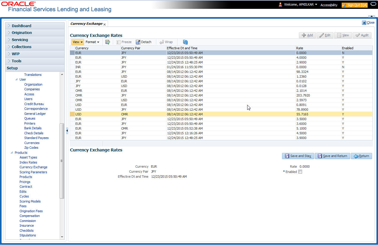

4.3 Currency Exchange
The Currency Exchange screen maintains currency exchange rates. You can define the currency exchange details and schedule a batch job (SET-IFP- ICEPRC_BJ_100_01 - CURRENCY EXCHANGE RATE FILE UPLOAD) which in-turn pulls the currency exchange rates from desired source at scheduled intervals through input file processing.
To set up the Currency Exchange
  1. Click Setup > Setup > Products > Currency Exchange.
  2. In the Currency Exchange Rates section, perform any of the Basic Operations mentioned in Navigation chapter.
Field:
Do this:
Currency
Select the currency being exchanged from the drop-down list.
Currency Pair
Select the currency to be paired with from the drop-down list.
Effective Date and Time
Specify date and time of the exchange rate. You can even select the date from the adjoining Calendar icon.
Rate
Specify the exchange rate (required).
Enabled
Check this box to activate the currency exchange rate.
