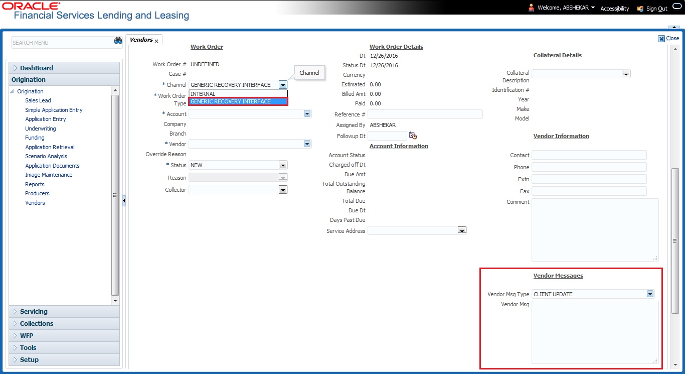

When the 'Channel' is selected as GENERIC RECOVERY INTERFACE, the Work Orders tab enables 'Vendor Messages' section to specify additional details that are required by the third party vendors to act upon the case. For more information, refer to ‘Case Comments’ section.

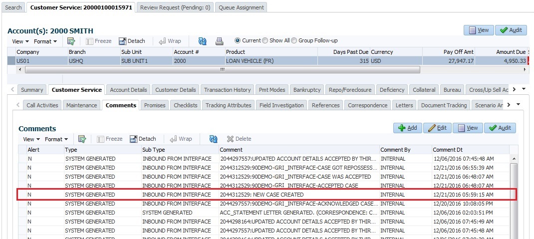

The 'add Case()' web service request consists of the following Case details to be registered in third party system:
When the web service request is successful, the response would contain the new case number created in third party system. The case # is then appended to the work order and the status is changed from 'SEND TO GRI' to 'ASSIGNED'. Also a comment is posted on the corresponding account in Customer Service > Comments tab, with the following details:

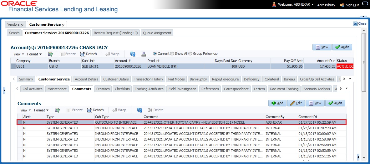

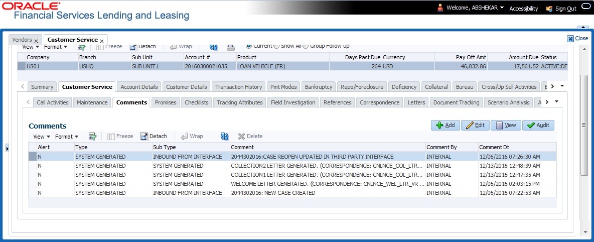

Case comments refers to additional details provided in the 'Vendor Messages' section of Work Orders tab that are required by the third party vendors to act upon the case.
The ‘Vendor Messages’ section can be updated after the case has been created in third party system and serves as a communication channel between the integrated system.
'Vendor Messages' section is available in the Work Orders tab only when the 'Channel' is selected as GENERIC RECOVERY INTERFACE and by default, the Vendor Message Type is selected as ‘CLIENT UPDATE’.
Accordingly, in the ‘Vendor Messages’ section when the details of Vendor Message Type and Vendor Message are updated for a work order, system triggers ‘addCaseUpdate()’ to update the same details in the third party system.
An outbound comment is posted on the corresponding account in Customer Service > Comments tab, with the following details and the update details are also captured as a record in Work Order History tab.

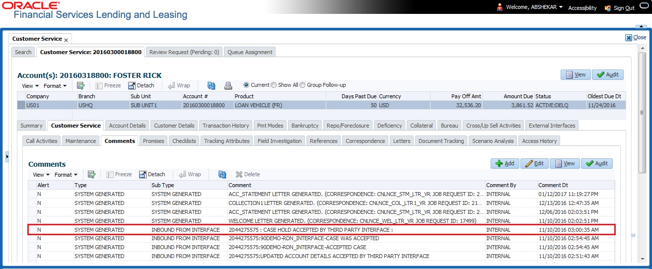

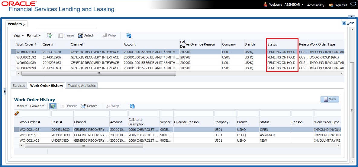

A particular work order or case which is already scheduled for repossession can undergo a status change when a payment is received (either full outstanding due or partial) on the non-performing account associated with the work order.
Also, an automatic case status change can happen on work order for an account based on Delinquency Days. Whenever the delinquency days falls below certain number of days as defined in system parameter “GRI_DLQ_DAYS_AUTO_STATUS_CHG” (DELINQUENCY DAYS FOR AUTOMATIC CASE STATUS CHANGE), system auto updates the case status as ‘PENDING ON HOLD/ON HOLD’ on running the batch job SET-GRI (RDNDLQ_BJ_100_01-AUTOMATIC CASE STATUS CHANGE).
Accordingly, when the status of a work order is changed to ‘PENDING ON HOLD’ in Work Orders screen, system triggers ‘holdCase()’ web service request to update the status of corresponding mapped case in third party system. This ensures that a work order in hold status is not processed further with third party vendor managed systems.
For information on updating the work order details, refer to section Vendors > Work Orders tab.
If the web service request is successful, a comment is posted on the corresponding account in Customer Service > Comments tab, with the following details:

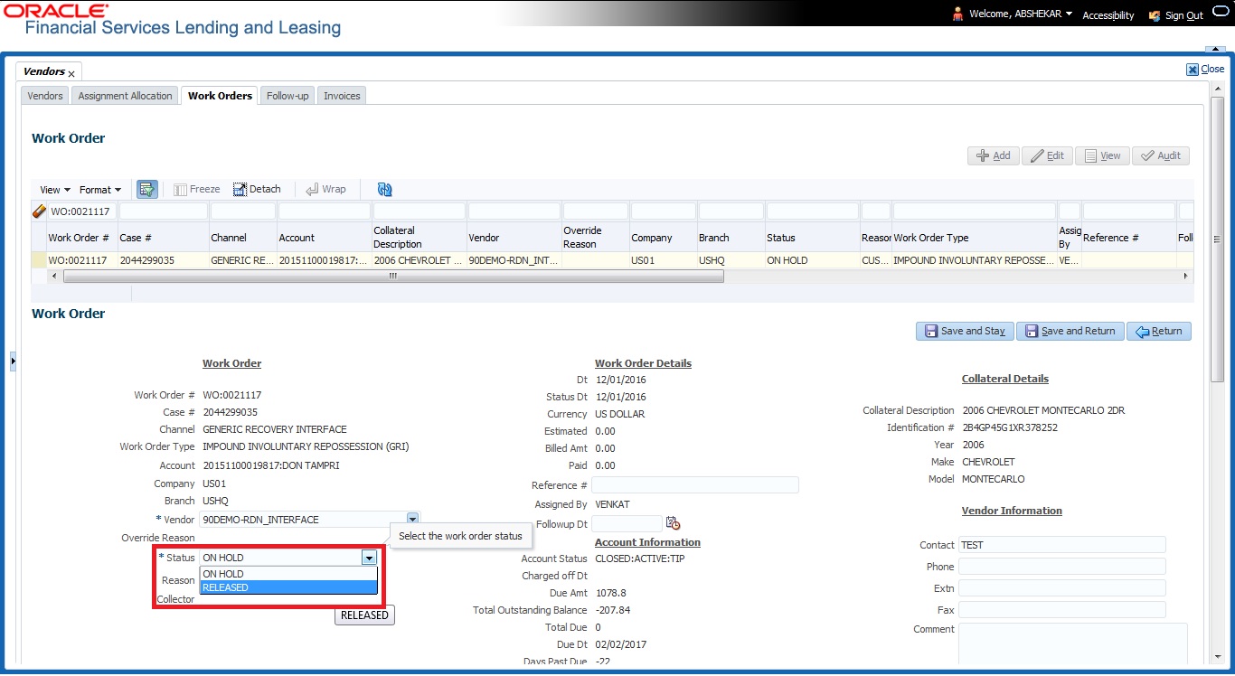

When the status of a work order is updated from ‘ON HOLD’ to ‘RELEASED’ in Work Orders screen, system triggers ‘reopenCase()’ web service request to update the status of corresponding mapped case in third party system.
This ensures that a work order in hold status is processed further with third party vendor managed systems.

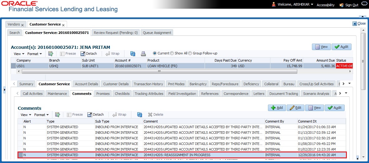

A particular work order or case which is already scheduled for repossession in third party system can be reassigned to a different vendor due to delay in action, response, status updates or any such conditions.
Accordingly, when a case is reassigned to a different vendor, the change is processed for update in third party system depending on the current case status maintained across systems as indicated below:
Scenario |
OFSLL Work Order Status |
GRI Case Status |
Case Reassignment Update |
1 |
Send to GRI |
NEW FROM CLIENT |
Case is assigned to new Vendor. |
2 |
Open |
Open |
Existing case is closed (i.e. status is updated as ‘PENDING REASSIGN/CLOSE’) and new case is created and assigned to new Vendor. |
Also, system automatically updates the work order status to ‘PENDING REASSIGN/CLOSE’ based on a system parameter. If the case status is OPEN for specific number of days as maintained in the system parameter “VEN_REASSIGNMENT_DAYS” (VENDOR REASSIGNMENT DAYS), system auto updates the case status as ‘PENDING REASSIGN/CLOSE’ on running the batch job SET-GRI (RDNVNA_BJ_100_01 - AUTOMATIC VENDOR REASSIGNMENT).
Accordingly, when a case is reassigned, system triggers ‘reassignCase()’ web service request for reassigning the case to new vendor in third party system. Depending on the case status, the case is either directly assigned to new vendor, or a new case is created with new vendor by closing the existing case.
If a new case is created in third party system due to vendor reassignment, then the web service response will include the new case number. Subsequently, when a close confirmation is received on the existing case as part of case status update from FIREHOSE web service response, the work order in OFSLL is closed (status = ‘CLOSE’) and new work order is created with new case number, new assigned vendor and previous work order account details.
Note the following:
A comment is posted on the corresponding account in Customer Service > Comments tab, with the following details:

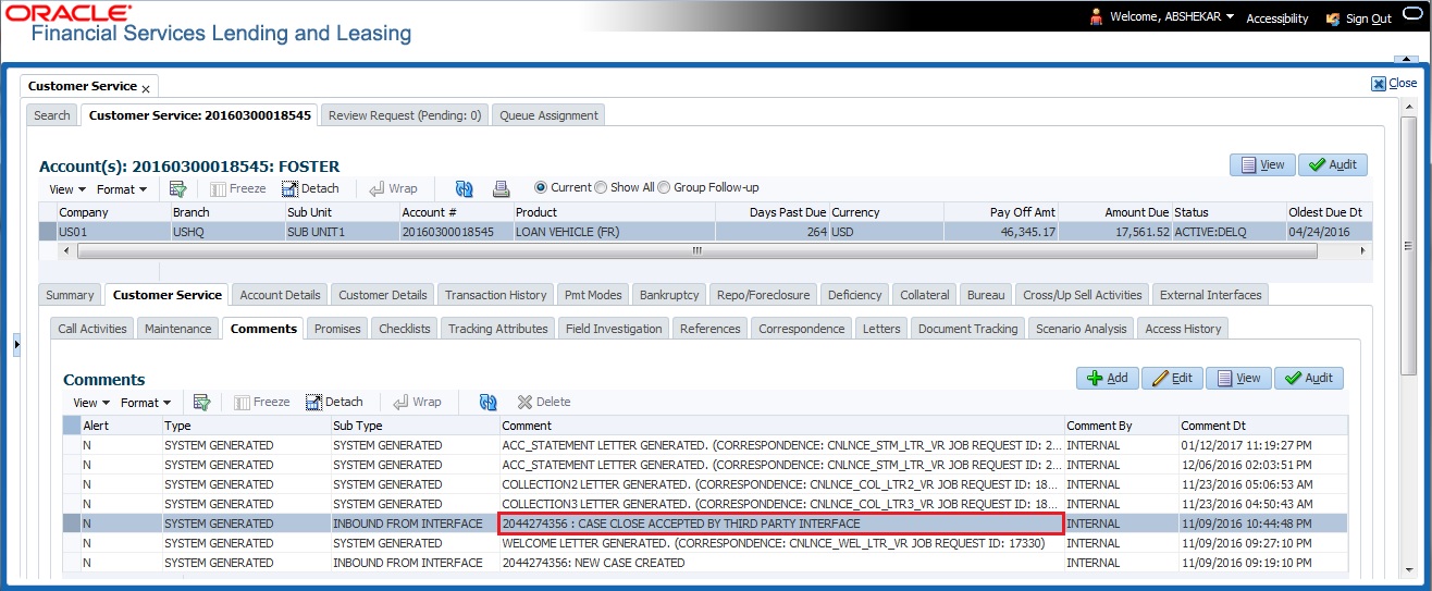

A particular work order or case which is already scheduled for repossession can be closed after validating the preceding status and subsequently a repossession may not be required on the account mapped to the work order.
Accordingly, when the status of a work order is changed to ‘PENDING CLOSE’ in Work Orders screen, system triggers ‘closeCase()’ web service request to update the status of corresponding mapped case in third party system. This ensures that the work order is not processed further with third party vendor managed systems.

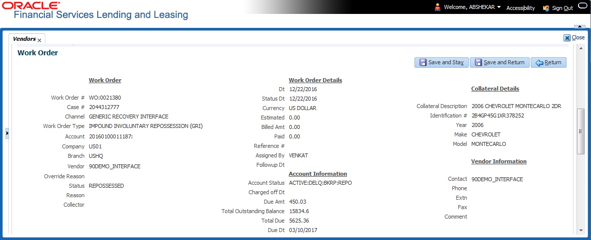

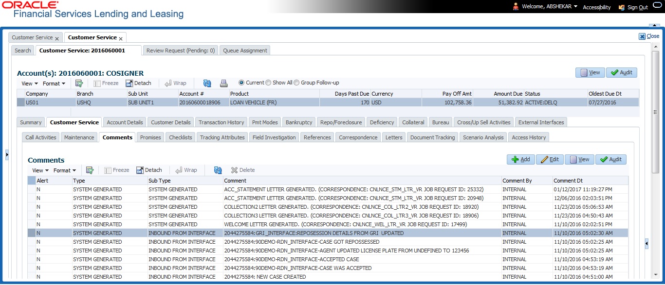

When a case has been repossessed, the status of the case is updated by the assigned vendor in third party system. The case status is then retrieved through a FIREHOSE web service scheduled at specific interval using a batch process.
On receiving the case status update as ‘REPOSSESSED’ (i.e. Event Type 300) from FIREHOSE web service response, system triggers ‘getRepossessionDetails()’ web service request to fetch the repossession details and update the status of corresponding mapped work order and account in OFSLL.

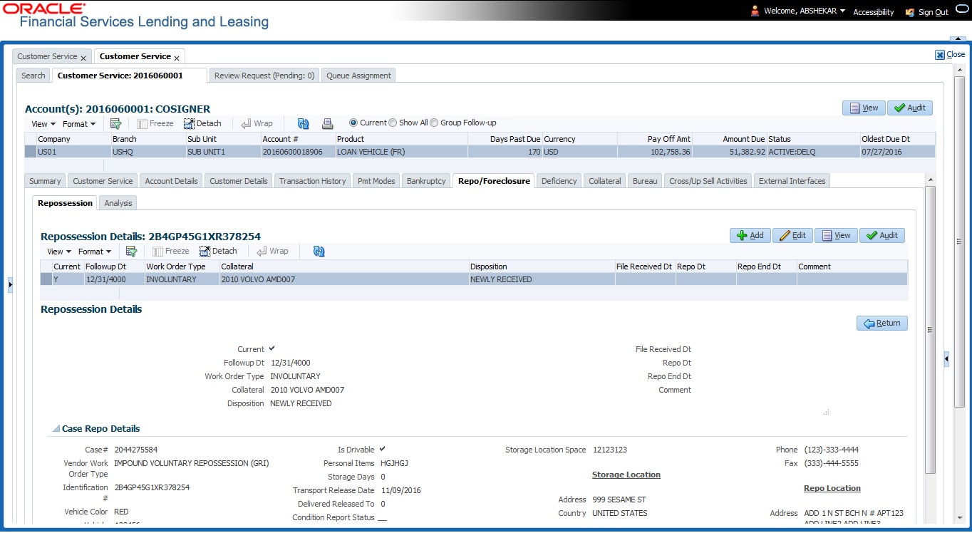

If the web service request is successful and repossession details are received as part of the response, the status of the work order is updated in Work Orders tab and a comment is posted on the corresponding account in Customer Service > Comments tab, with the following details:
The Repossession details are also updated in Repo/Foreclosure tab of Customer Service screen.

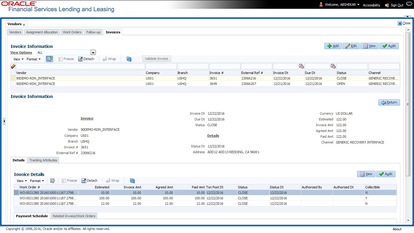

When a case has been repossessed, an invoice with the actual cost incurred for repossession and the details of the asset repossessed are updated in the third party system by the assigned vendor.
Subsequently, when the case status update is received as ‘REPOSSESSED’ (i.e. Event Type 300) from FIREHOSE web service response, system triggers ‘getCaseInvoiceData()’ web service request to retrieve the invoice and asset details from the third party system.
If the web service request is successful and repossession details are received as part of the response, the details are updated in Vendors > Invoices tab and a comment is posted on the corresponding account in Customer Service > Comments tab, with the following details:
The details of the invoice in the web service response are captured in Vendors > Invoice Information tab with invoice details and Payment Schedule. By default, the status of the invoice is ‘OPEN’ to update the payment details.
System auto validates the invoice details which are received from third party system with specific business rules before creating a record in the Invoice Information tab. Hence the ‘Validate Invoice’ button in the Information tab is disabled for invoice records from external channel (Generic Recovery Interface) and the details are marked as view only.
