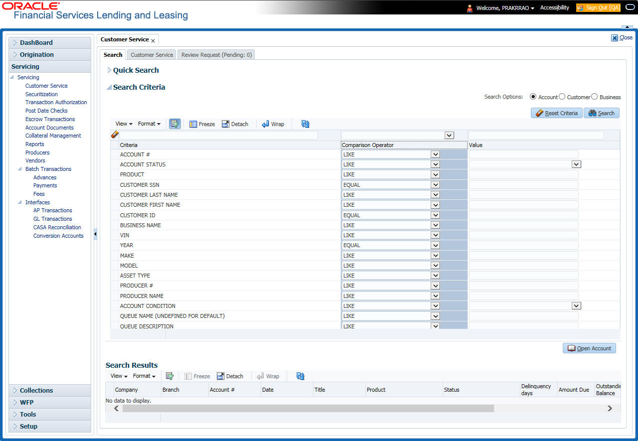

You can search or retrieve a particular account or customer through Customer Service screen. The search tab available in the screen enables you to locate an account or customer using a broad range of search criteria.
To view the Search screen during Line of credit servicing
Depending on the link clicked, Customer Service screen appears, opening at Results screen.
Note
Oracle Financial Services Lending and Leasing does not display the financial details of secured accounts if the logged-in user is not authorized. Though the search display the results, the fields such as Status, Delinquency Days, Amount Due, and Outstanding Balance are masked with ‘xxxxx’ and clicking on the same displays an error message indicating ‘Cannot open secured account’.
The system loads account on Customer Service screen.
The Quick Search section in Customer Service screen enables you to load accounts using any one of the fields Account Number, Customer Id, SSN, Identification #, or Queue/Condition.
To load an account using the Quick Search section
To load an account from a queue
In the Quick Search section’s Queue field, select the queue you want to work with and click Next Account.
There are different ways to search a customer account using the customer details.
To search for and load the customer details with the Search screen
On the Oracle Financial Services Lending and Leasing home screen, click Servicing > Servicing > Customer Service > Search Criteria
Select Customer as a search option.
The system locates and displays all the accounts that meet your search criteria on Search Results screen.

To search for and load an account using the Search screen
In this field: |
View this: |
Company |
The company of the account. |
Branch |
The branch of the account |
Account # |
The account number |
Date |
The date the account was created. |
Title |
The primary and other applicant(s) attached to the account. |
Product |
The Line of credit product of the account. |
Status |
The status of the account. |
Delinquency days |
The number of days the account has been delinquent. |
Amount Due |
The total amount due for the account. |
Outstanding Balance |
The total outstanding balance for the account. |
Producer |
The producer of the account. |
Secured |
If selected, indicates the account is secured and may only be loaded by authorized users. |
The system loads the account under the tab
You are now ready to begin work on the account.
