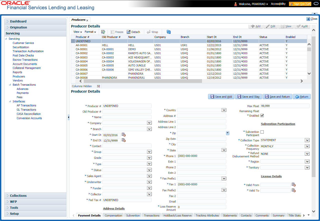

The Producers screen, completed during setup, can be used to view and maintain producer details.
12.1 Producer Details
The Producer details screen allows you to record or edit basic information about the producer. You can set up dealers or producers for a company and branch. You can also set up a default underwriter and a default collector for a producer. The system uses this information in the origination work flow to select a queue.
The producer number, name, contact information, company and branch to which the producer is associated with, federal tax number, status, and license information can be stored in this screen.
Navigating to Producer
  1. On the Oracle Financial Services Lending and Leasing home screen, click Servicing > Servicing > Producers.
  2. The system displays the Producers setup screen.
To set up the Producer
  1. In the Producer section, perform any of the Basic Operations mentioned in Navigation chapter.
A brief description of the fields is given below:

To view Title Status Summary on the Summary
  1. Click Servicing > Servicing > Producers > Summary sub tab.
  2. On the Title Status Summary screen, perform any of the Basic Operations mentioned in Navigation chapter.
  3. Select the Title Status Summary period as 1 day/2 days/5 days/7 days/All.
A brief description of the fields are given below:
Field:
View this:
New Status
Displays lien status as 'New'
Perfection Pro­cessing Status
Displays lien status as either Sent for Perfection/ Sent for Re-per­fection
Perfected Status
Displays if lien status has 'Perfected Title'
Release Process­ing Status
Displays lien status as either Sent for Title Release/Re-sent for Title Release
Released Status
Displays lien status as either Service Requested/Pending Delete
Hold Release
Displays lien Hold Release status
To be Released
Displays lien status if ‘To be released’
Closed Status
Displays lien status if ‘Deleted’
Exception Status
Displays lien status as either Pending Lien Holder/ Pending DMV
Lien Event Date
Displays lien Event Date attached against each status.
