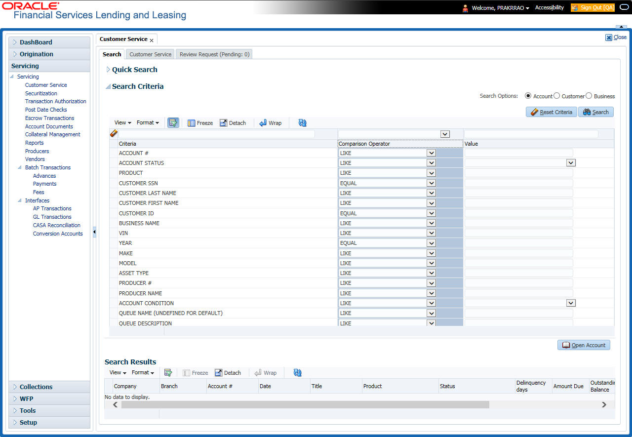

2.3 Searching for an Account and Customer
You can search or retrieve a particular account or customer through Customer Service screen. The search tab available in the screen enables you to locate an account or customer using a broad range of search criteria.
To view the Search screen during Line of credit servicing
  1. On the Oracle Financial Services Lending and Leasing Application home screen, click the Servicing master tab.
  2. If you want to perform a customer service task on the application, click Customer Service link.
Depending on the link clicked, Customer Service screen appears, opening at Results screen.
Note
Oracle Financial Services Lending and Leasing does not display the financial details of se­cured accounts if the logged-in user is not authorized. Though the search display the re­sults, the fields such as Status, Delinquency Days, Amount Due, and Outstanding Balance are masked with ‘xxxxx’ and clicking on the same displays an error message indicating ‘Cannot open secured account’.
  1. Click the Search Criteria tab.
Using the Search tab
  1. Create a search criteria by specifying the required details in Comparison Operator and Value columns.
  2. Click Search. System displays all accounts that meet the search criteria in the Results tab.
  3. On the Search Results/Task screen, select the account you want to load and click Open Account.
The system loads account on Customer Service screen.

2.3.3 Search Using Account Details
To search for and load an account using the Search screen
On the Oracle Financial Services Lending and Leasing home screen, click Servicing > Servicing > Customer Service > Search Criteria
  1. Select Account as a search option.
  2. On the Criteria screen, use the Comparison Operator and Value columns to create a search criteria to find an account. You can click Reset Criteria at any time to clear the Comparison Operator and Value columns.
  3. Click Search. The system locates and displays all the accounts that meet your search criteria on Results screen.
  4. On the Search Results screen, view the following information for each account:
    In this field:
    View this:
    Company
    The company of the account.
    Branch
    The branch of the account
    Account #
    The account number
    Date
    The date the account was created.
    Title
    The primary and other applicant(s) attached to the account.
    Product
    The Line of credit product of the account.
    Status
    The status of the account.
    Delinquency days
    The number of days the account has been delinquent.
    Amount Due
    The total amount due for the account.
    Outstanding Balance
    The total outstanding balance for the account.
    Producer
    The producer of the account.
    Secured
    If selected, indicates the account is secured and may only be loaded by authorized users.
  5. On the Results screen, select the application you want to retrieve and click Open Account.
The system loads the account under the Customer Service tab
You are now ready to begin work on the account.
