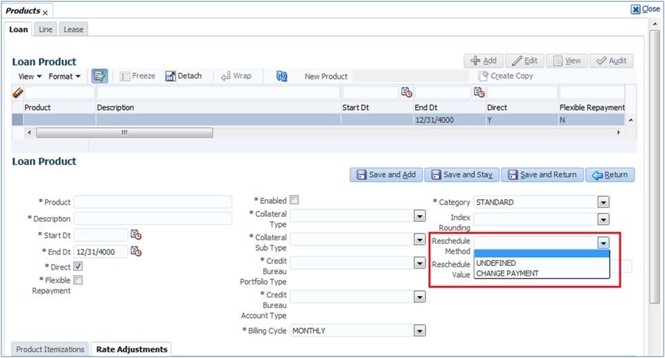

During the Product setup, you can define and control the changes in loan payment amount using 'Reschedule Method' and 'Reschedule Value' fields.
Hence the impact of variable rates on loan payment amount can be controlled to stop negative amortization.

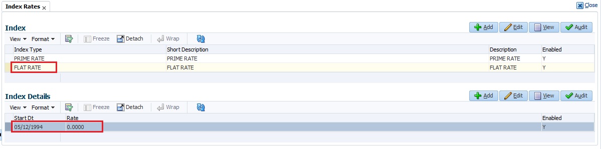

Fixed interest rate loan is one in which the rate of interest remains fixed from funding till the loan's entire term. Hence, the loan payment amount does not change with fluctuations in index rate or market rates.
In Oracle Financial Services Lending and Leasing, fixed interest rate loans can be defined in the following way:
Since the index rate is always zero for this Index Type, the loan interest rate will always be the Margin rate (i.e. contract rate) which does not change during life of the loan.
