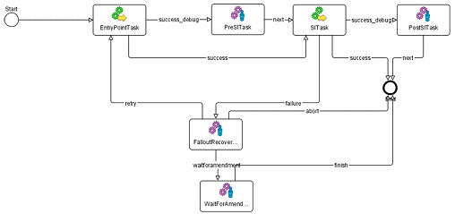

SUBPROCESS/YourFunctionNameSubProcess |
Process |
See "About Subprocesses." |
TASK/YourFunctionNameEntryPointTask TASK/YourFunctionNameSITask |
Automated Task |
See "About Subprocesses" for automated tasks to be created for the new subprocess for the new fulfillment function. |
TASK/YourFunctionNamePreSITask TASK/YourFunctionNamePostSITask TASK/YourFunctionNameFalloutRecoverTask TASK/YourFunctionNameWaitForAmendmentTask TASK/YourFunctionNameEPQTask extends TASK/YourFunctionNameEntryPointTask TASK/YourFunctionNameSIQTask extends TASK/YourFunctionNameSITask |
Manual Task |
See "About Subprocesses" for manual tasks to be created for the new subprocess for the new fulfillment function. |

Model the subprocess following the pattern established for the existing fulfillment functions as depicted in Figure 5-1. Prefix task names with YourFunctionName. The flow of the process is described in Table 5-3.
The manual tasks YourFunctionNamePreSITask, and YourFunctionNamePostSITask are optional. They are useful as cartridge breakpoints for a number of purposes including providing the user the ability to control process flow before and after functions and to examine data in the process flow for revision testing. Cartridge breakpoints stop at manual tasks in subprocess flows for system interactions. In a success flow, the process flows distinguish whether to exit with 'success_debug' status (to include manual tasks in the subprocess flow) or success status (to skip the manual tasks in the subprocess flow).
Table 5-3 lists the tasks and flows associated with subprocess.
| Flow patterns | Tasks associated |
Success flow without debug breakpoints |
Start --> YourFunctionNameEntryPointTask --> YourFunctionNameSITask --> End |
Success flow with debug breakpoints |
Start --> YourFunctionNameEntryPointTask --> YourFunctionNamePreSITask (manual) --> YourFunctionNameSITask --> YourFunctionNamePostSITask (manual) --> End |
Failure flows |
Start --> YourFunctionNameEntryPointTask --> YourFunctionNameSITask -->YourFunctionNameFalloutRecoverTask (manual) -->
Significance must be set in the task data for the nodes in CreateCommunicationsSalesOrderTask and the tasks in the subprocess for the fulfillment function YourFunctionName.
