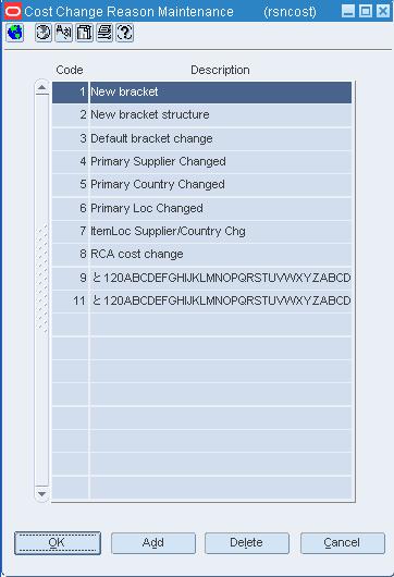

Add a Cost Change Reason
Navigate: From the main menu, select Control > Setup > Cost Change Reason > Edit. The Cost Change Reason Maintenance window opens.
Figure 8-1 Cost Change Reason Maintenance Window
  1. Click Add. The next available line is enabled.
  2. In the Code field, enter an ID for the reason.
  3. In the Description field, enter a description for the reason.
  4. Click OK to save your changes and close the window.

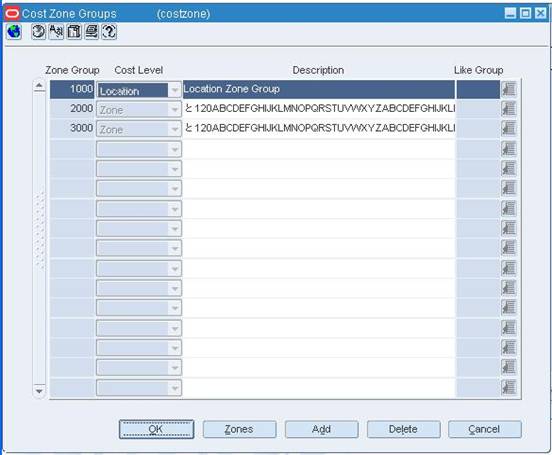

Add a Cost Zone Group
Navigate: From the main menu, select Control > Setup > Cost Zone Group > Edit. The Cost Zone Groups window opens.
Figure 8-2 Cost Zone Groups Window
  1. Click Add. The next line on the table is enabled.
  2. In the Zone Group field, enter a unique ID.
  3. In the Cost Level field, select Zone.
    If a location cost level is not set up, you may select Location in the Cost Level field. You can create only one cost zone group at the location cost level
  4. In the Description field, enter the description of the cost zone group.
  5. To copy the zones and locations from an existing cost zone group, in the Like Group field enter the ID of the cost zone group or click the LOV button and select a cost zone group.

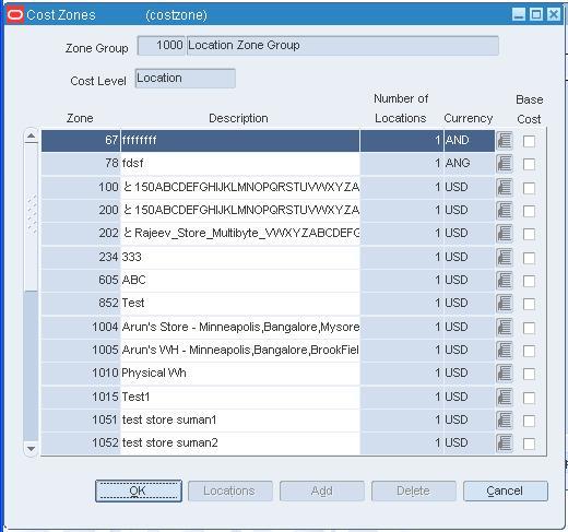

Add Cost Zones to a Cost Zone Group
  1. On the Cost Zone Groups window, click Zones to add zones to the new cost zone group. The Cost Zones window opens.
    Figure 8-3 Cost Zones Window
    Cost Zones Window
  2. Click Add. The next line on the table is enabled.
  3. In the Zone field, enter a unique zone ID.
  4. In the Description field, enter a cost zone description.
  5. In the Currency field, enter the code for the currency to be used in the cost zone or click the LOV button and select the currency.

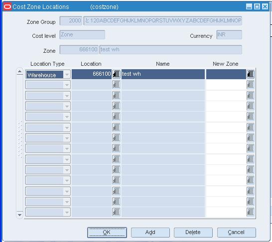

Add Locations to a Cost Zone
  1. On the Cost Zone Groups window, click Zones. The Cost Zones window opens.
  2. On the Cost Zones window, click Locations. The Cost Zone Locations window opens.
    Figure 8-4 Cost Zone Locations Window
  3. To add a location that has not been assigned to a cost zone group, click Add.
    • In the Location Type field, select store or warehouse.
    • In the Location field, enter the location ID, or click the LOV button and select the location.
  4. To add a location to a cost zone that is currently in a different cost zone:
    • On the Cost Zones window, select the Zone that contains the location you want to put in the new zone.
    • Click Locations. The Cost Zone Locations window opens.
    • In the New Zone field, enter the zone ID of the cost zone that you would like the location to appear in, or click the LOV button and select the new cost zone.

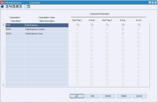

Define a Computation Value Base
Navigate: From the main menu, select Control > Landed Cost > CVB Maintenance > New.
The CVB Maintenance window opens.
Figure 8-5 CVB Maintenance Window
  2. Enter an ID and description for the Computation Value Base (CVB).
  3. Select the types of calculations that will use the CVB.
  4. Click OK to exit, or continue to select CVB components.
Select CVB Components
  1. Click Details. The CVB Details window opens.
    Figure 8-6 CVB Details Window
    CVB Details Window
  2. Click Add.
  3. In the Component field, enter the ID of the component, or click the LOV button and select the component.
  4. In the Combination Operator field, select:
    • + (plus sign) to add the component.
    • - (minus sign) to subtract the component in the CVB.
  5. Click OK to save your changes and close the window.

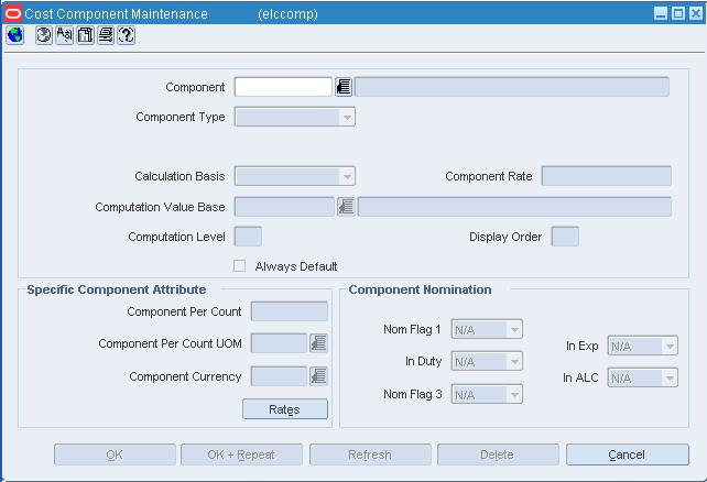

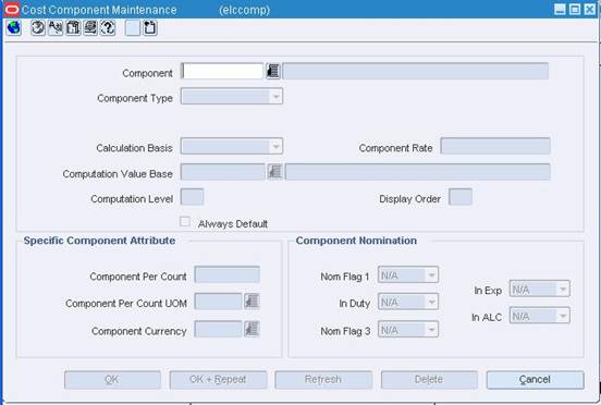

Define an Assessment
Navigate: From the main menu, select Control > Landed Cost > Cost Component Maintenance > New. The Cost Component Maintenance window opens.
Figure 8-7 Cost Component Maintenance Window
  1. In the Component fields, enter an ID and description of the component.
  2. In the Component Type field, select Assessment.
  3. In the Assessment Type field, enter the ID of the tax or fee, or click the LOV button and select the tax or fee as necessary.
  4. In the Import Country field, enter the code for the country importing the goods, or click the LOV button and select the import country.
    When creating an import order, make sure that the import country and the import location are the same.
Define Assessments Based on the Quantity or Dimensions of the Goods
  1. In the Calculation Basis field, select Specific.
  2. In the Component Rate field, enter the monetary amount per unit.
  3. In the Component Per Count field, enter the number of units to which the rate applies.
  4. In the Component Per Count UOM, enter the abbreviation for the unit of measure to which the rate applies, or click the LOV button and select the unit of measure.

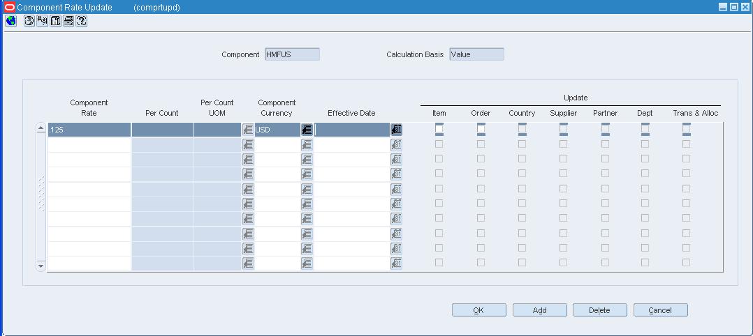

Component Rate Update Window [comprtupd]
The Component Rate Update window allows the user to change the component rate information, as well as add or delete a component.
Edit the Component Rate
Navigate: From the main menu, select Control > Landed Cost > Cost Component Maintenance > Edit. The Cost Component Maintenance window opens.
Figure 8-8 Cost Component Maintenance Window
  1. In the Component field select a component, or select the LOV button and select a component.
  2. Click Rates. The Component Rate Update window opens.
    Figure 8-9 Component Rate Update Window
  3. Update any pertinent information.
  4. In the Effective Date field, enter the date or select the calendar button and select a date.

Figure 8-10 Cost Component Maintenance Window
    Figure 8-11 Component Rate Update Window
  3. Click Add.
  4. In the Component Rate field enter the rate.
  5. In the Per Count field, enter the count.
  6. In the Per Count UOM field, enter the per count, or select the LOV button and select the per count.
  7. In the Component Currency field enter the currency, or select the LOV button and select the currency.
  8. In the Effective Date field, enter the date or select the calendar button and select a date.
  9. Select any of the appropriate check boxes.
  10. Click OK to save your changes and close the window.
Define an Expense
Figure 8-12 Cost Component Maintenance Window
  2. In the Component Type field, select Expense.
  3. In the Expense Type field, select either Zone or Country.
  4. For expenses based on the quantity or dimensions of the goods:
    4. In the Component Per Count UOM, enter the code for the unit of measure to which the rate applies, or click the LOV button and select the unit of measure.
  5. For expenses based on a percentage of the value of the goods:
    1. In the Calculation Basis field, select Value.
    2. In the Order Cost Basis field, select the base for calculating the Expense.
    3. In the Component Rate field, enter the percentage per unit.
    4. In the Computation Value Base, enter the ID of the CVB to which you want to attach the expense, or click the LOV button and select the CVB.
  6. In the Component Currency field, enter the ID of the currency in which the expense is denominated, or click the LOV button and select the currency.
  7. In the Component Nomination fields, select the status of the expense in relation to the other components in a CVB:
  8. Select N/A if the expense is not included in a calculation.
  9. Select + (plus sign) to add the expense.
  10. Select - (minus sign) to subtract the expense.
  11. Click OK to save your changes and close the window.

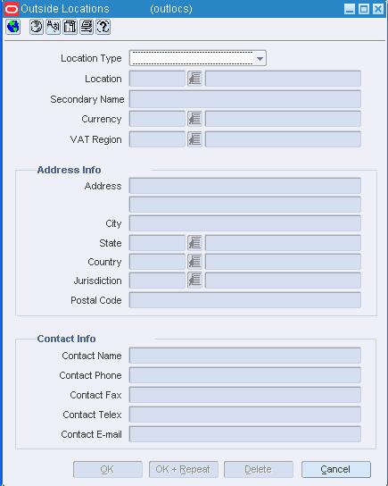

Set Up Outside Locations
Outside locations are those locations that are not part of the organizational hierarchy. Some examples of outside locations are entry ports, discharge ports, lading ports, return centers, bill-to locations, and destination locations.
Maintain an Outside Location
Navigate: From the main menu, select Control > Setup > Outside Locations > Edit. The Outside Locations window opens.
Figure 8-13 Outside Locations Window
Edit an Outside Location
  1. In the Location Type field, select the type of outside location that you want to edit.
  2. In the Location field, enter the ID of the outside location, or click the LOV button and select the outside location.
  3. Edit the currency, VAT region, address, and contact information as necessary.
Delete an Outside Location
  3. Click Delete.
  4. When prompted to delete the record, click Yes.
View an Outside Location
Navigate: From the main menu, select Control > Setup > Outside Locations > View. The Outside Locations window opens.
Figure 8-14 Outside Locations Window
  1. In the Location Type field, select the type of outside location that you want to view.
  3. Enter the jurisdiction information. This further breaks down the tax rate if different than the transaction location.
  4. Click OK to close the window.
Create an Outside Location
Navigate: From the main menu, select Control > Setup > Outside Locations > New. The Outside Locations window opens.
Figure 8-15 Outside Locations Window
  1. In the Location Type field, select the type of location that you want to create.
  2. In the Location field, enter a unique ID and description for the outside location.
  3. In the Currency field, enter the currency code for the location, or click the LOV button and select the currency.
  4. In the Country field, enter the ID of the country in which the outside location is located.
  5. Enter the jurisdiction information. This further breaks down the tax rate if different than the transaction location.
  6. Enter optional information in the remaining fields as necessary.
  7. Click OK to save your changes and close the window.

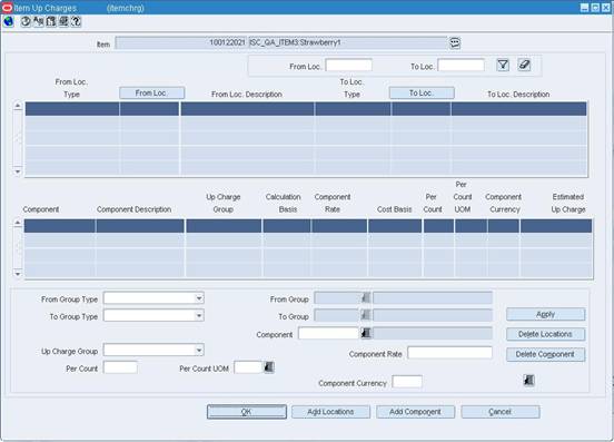

Add an Up Charge to an Item
Navigate: From the Main menu, select Items> Items. The Item Search window opens. Search for and retrieve an item in edit mode. The Item Maintenance window opens. From the Options list, select Item Up Charges. The Item Up Charges window opens.
Figure 8-16 Item Up Charges Window
  1. In the From Group Type field of the Apply block, select the locations from which the items originate.
  2. If available, enter a From Group value, or click the LOV button and select a value.
  3. Select a value in the To Group Type field.
  4. If available, enter a To Group value, or click the LOV button and select a value.
  5. In the Component field, enter an up charge component ID or click the LOV button and select an up charge component.
  6. Update the following fields as necessary:
    • Up Charge Group: Used to group up charges together on the Transfer Up Charge window. All up charge components with the same up charge group are summed together.
    • Component Rate: The rate to be charged against the weighted average cost of the Item/To Location combinations within the department. The value in this field is a percentage if the calculation basis is Value, and a monetary amount if the calculation basis is Specific.
    • Per Count: The amount of the Per Count Unit of Measure to which the rate applies. For example, when creating an up charge that is defined as $.20 for every 10 kilograms of an item, the Per Count would be 10. This field is enabled if the calculation basis is Specific.
    • Per Count UOM: Displays the unit of measure in which the Per Count is specified. This field is enabled if the calculation basis is Specific
  7. Click Apply. The Component table is updated.
  8. Click OK to save your changes and close the window.

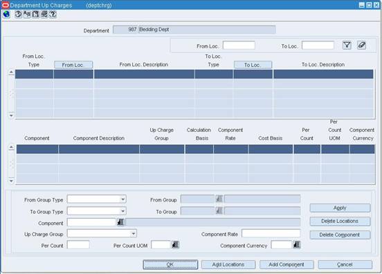

Add Up Charges to Items in a Department
Navigate: From the Main menu, select Action > Merchandise Hierarchy. The Merchandise Hierarchy Main Form window opens. Search for and retrieve a department in edit mode. The Department Maintenance window opens. From the Options menu, select Up Charges. The Department Up Charges window opens.
Figure 8-18 Department Up Charges Window

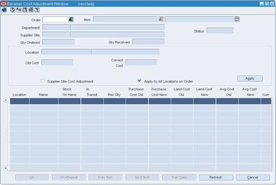

Adjust the Unit Costs of an Item Received by Order
Navigate: From the main menu, select Finance > Receiver Cost Adjustment. The Receiver Cost Adjustment window opens.
Figure 8-19 Receiver Cost Adjustment Window
Surrounding text describes Figure 8-19 .
  1. In the Order field, enter the number of the purchase order, or click the LOV button and select the purchase order.
  2. In the Item field, enter the item number, or click the LOV button and select the item. The cost details for the purchase order/item appear by location.
  3. Select a location. The details appear in the Apply area.
  4. In the Correct Cost field, enter the new cost per unit.
  5. Select the Supplier Cost Adjustment check box to apply the cost change for the item at the location/supplier level.
  6. Select the Apply To All Locations On Order check box to apply the cost change to the items at the order level.
  7. Click Apply.
  8. You may be prompted to enter a new average cost. Enter the average cost in the Avg Cost New field.
  9. Click Apply. The unit costs are updated for the selected location.
  10. Click Next Item or Prev Item to edit unit costs for another item on the current purchase order.

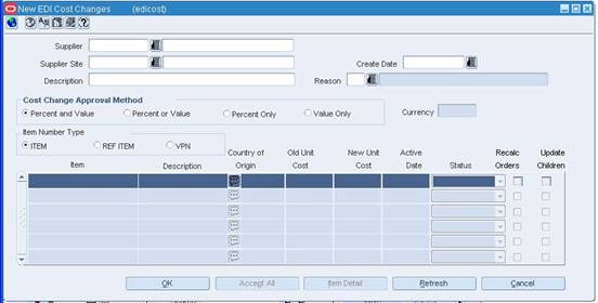

Create a Cost Change
The initial cost of an item is established at item set-up. The cost of the item can be adjusted in the item record until the status of the item is Approved or Unapproved. Any cost changes will need to be handled through the cost change windows.
When submitted through EDI, you review the cost change, then submit the cost change for approval.
When entered manually, you enter the cost change, an event description, an effective date, and a reason code. Then submit the cost change for approval.
You cannot create a cost changes for a transformed sellable item.

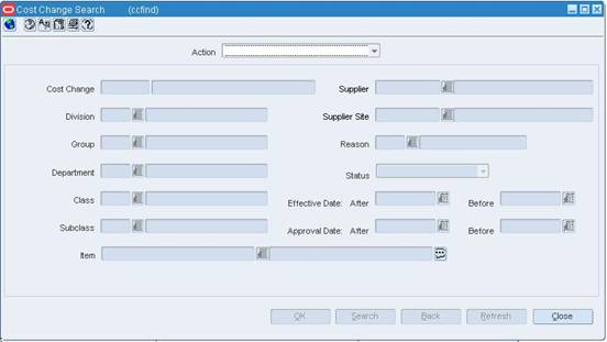

Navigate: From the main menu, select Costing > Cost Change. The Cost Change Search window opens.
Figure 8-20 Cost Change Search Window
There are two additional ways in which to access the Cost Change by Supplier window: - From the main menu, select Items > Items. In the Item Search window, select New Cost Change in the Action field and search for the item to be edited; - From the main menu, select Items > Item List. In the Item List Search window, select Use in the Action field and search for an item list to be edited. Select Create Cost Change from the Options menu.
  1. In the Action field, select New.
  2. Click OK. The Cost Change by Supplier window opens.
    Figure 8-21 Cost Change by Supplier Window
  3. In the Cost Change field, enter a description for the cost change.
  4. In the Item, Supplier, and Country field, enter the item number or ID of each as necessary, or click the LOV button and select the item, supplier, or country.
  5. In the Reason field, enter the ID of the reason for the cost change, or click the LOV button and select the reason.
  6. In the Effective Date field, enter the date on which the cost changes become effective.
  7. Click Search. The records that match the search criteria appear.

Cost Change Search Window [ccfind]
The Cost Change Search window allows you to enter criteria in order to search for cost change events and view the results of the search.
The default view for the Cost Change Search window opens when you open the window for the first time. You can also create a custom view.
Search for a Cost Change
  1. In the Action field, select either Edit or View.
  2. In the Origin field, select Cost.
  3. Enter additional criteria as desired to make the search more restrictive.
  4. Click Search. The Price Change Search window displays the cost changes that match the search criteria.
  5. Select a task:
    1. To perform another search, click Refresh.
    2. To display the details of a cost change, select a record and click OK. The details appear in the Cost Change by Supplier window.
  6. Click Close to close the window.

Edit a Cost Change Reason
Figure 8-28 Cost Change Reason Maintenance Window
  1. Edit the description as necessary.
  2. To delete a cost change reason:
    • Select a reason.
    • Click Delete. You are prompted to delete the record.
    • Click Yes.
  3. Click OK to save your changes and close the window.
Accept Cost Changes Received Through EDI
Navigate: From the main menu, select Items > EDI Cost Changes. The New EDI Cost Changes window opens.
Figure 8-29 New EDI Cost Changes Window
  1. In the Supplier field, enter the ID of the supplier, or click the LOV button and select the supplier.
  2. In the Create Date field, enter the date on which the cost changes were received, or click the LOV button and select the date. The items that match the criteria appear.
  3. In the Description field, enter a description for the cost change event.
  4. In the Reason field, enter the ID of the reason for the cost change, or click the LOV button and select the reason.
  5. In the Cost Change Approval Method area, select an approval method.
  6. In the Status field, select either Accepted or Rejected for each cost change.
    To accept all the cost changes, click Accept All.
  7. Select the Recalc Orders check box next to each cost change if you want to update the cost on unapproved purchase orders.
  8. Select the Update Children check box next to each cost change if you want to apply the change to subordinate items.
  9. Click OK to save your changes and close the window.

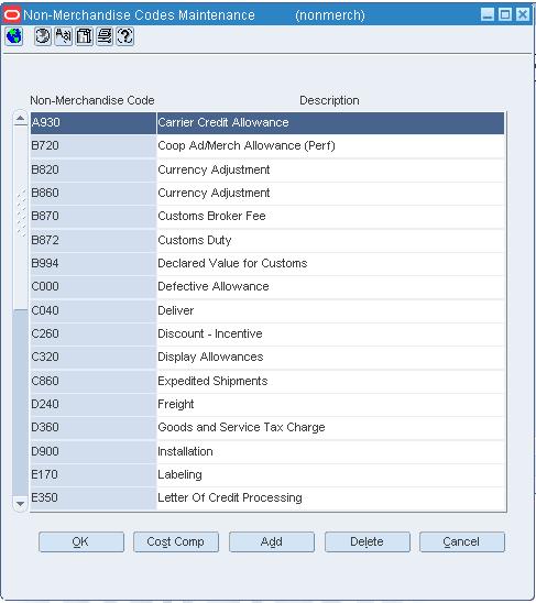

Delete a Cost Component from a Non-Merchandise Code
Navigate: From the main menu, select Control > Setup > Non-Merchandise Codes > Edit. The Non-Merchandise Codes Maintenance window opens.
Figure 8-30 Non-Merchandise Codes Maintenance Window
This window is only available when you are using Oracle Retail Trade Management (RTM) with RMS. If simplified RTM is used, the functionality may differ.
  1. Select a non-merchandise code in the table.
  2. Click Cost Comp. The Non-Merchandise Cost Components window opens.
  3. Select a cost component in the table.
  4. Click Delete. You are prompted to delete the component.
  5. Click Yes.
  6. Click OK to close the window and save your changes.
Add a Cost Component for a Non-Merchandise Code
  3. Click Add.
  4. On the next available line, enter the ID of the cost component in the Component ID field, or click the LOV button and select a cost component.
