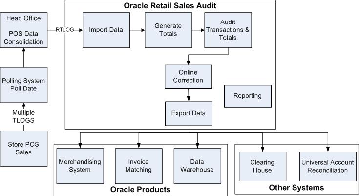

Oracle Retail Sales Audit interfaces with the following Oracle products:
Oracle Retail Merchandise System
Store Inventory Management
Oracle Retail Invoice Matching System
Retail Analytics
This figure displays the ReSA interfacing products:
Oracle Retail Sales Audit also interfaces with the following third-party applications:
Automated Clearing House.
Universal Account Reconciliation System.
