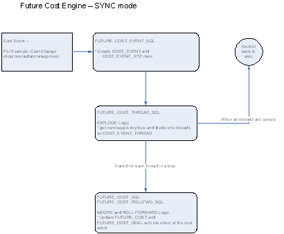

The Future Cost Engine can be configured by cost event type in one of three ways:
Synchronous
Asynchronous
Batch
The method to be used by each cost event type is controlled by the configuration defined in the COST_EVENT_RUN_TYPE_CONFIG table.
When running in synchronous mode, the Future Cost Engine is run in the same transaction as the client that calls it. For example if the cost change event is configured to run in synchronous mode, the work done in the Future Cost Engine for the approval of a cost change runs in the same transaction as the flipping of the status of the cost change to ’A' status. That means the user in the form will have a busy cursor until the Future Cost Engine completes.
Cost event types with an EVENT_RUN_TYPE set to ’SYNC' on COST_EVENT_RUN_TYPE_CONFIG will run in synchronous mode.

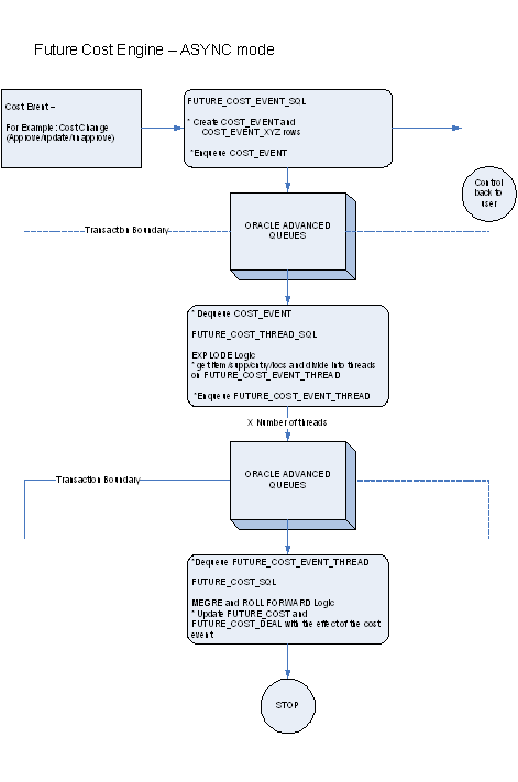

When running in asynchronous mode, the Future Cost Engine is run in a separate transaction than the client that calls it. For example if the cost change event is configured to run in asynchronous mode, the work done in the Future Cost Engine for the approval of a cost change runs in a different transaction as the flipping of the status of the cost change to ’A' status. This means that control returns to the user in the form while the Future Cost Engine runs in the background.
This is accomplished by using Oracle Advanced Queuing.
Cost event types with an EVENT_RUN_TYPE set to ’ASYNC' on COST_EVENT_RUN_TYPE_CONFIG runs in asynchronous mode.
