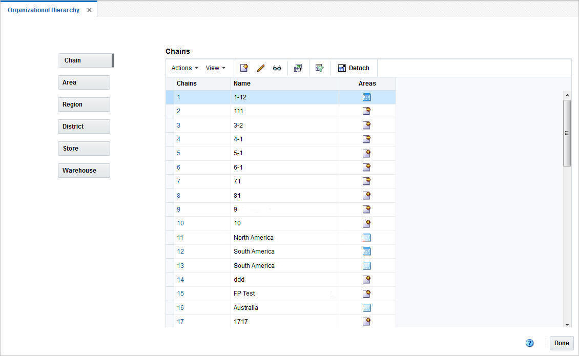

The Organizational Hierarchy window allows you to create, edit and view the organizational hierarchy of the company.
To access the Organizational Hierarchy window from the Task menu, select Foundation Data > Locations > Organizational Hierarchy.
The Organizational Hierarchy window contains the following sections.
The Organizational Hierarchy structure on the left side of the window contains the following buttons.
Table 2-1 Hierarchy Structure - Buttons and Description
| Buttons | Description |
Chain |
Displays the available chains in the table. |
Area |
Displays the available areas in the table. |
Region |
Displays the available regions in the table. |
District |
Displays the available districts in the table. |
Store |
Displays the available stores in the table. |
Warehouse |
Displays the available warehouse in the table. |
The Hierarchy table displays the available entries of the selected hierarchy level. For example, if you select the Chain button, all available chains are displayed in this table.
The table displays the following columns by default.
Hierarchy ID, depending on the selected hierarchy button.
Name of the hierarchy level, for example, the name of the chain.
Next hierarchy level, for example, Area.
This column contains either the Create or the Details icon.
If the next level has been created, the Detail icon is displayed. Use the icon to maintain or view the details of the next level.
If the next level has not been created, the Create icon is displayed. Use the icon to create the next level.
This column is not available for stores and warehouses.
Use the Actions menu and icons to apply actions to the table. You can perform the actions listed below.
Table 2-2 Hierarchy Table - Actions Menu/Icons and Description
| Actions Menu/Icons | Description |
Create and Create icon |
You can create a new hierarchy level by selecting Actions > Create or by using the Create icon. For more information about how to create the individual hierarchy levels, see the following sections: |
Edit and Edit icon |
Select Actions > Edit or use the Edit icon to edit the selected hierarchy level. |
View and View icon |
To view a hierarchy level:
Export to Excel and Export to Excel icon |
You can export the records in the table to a Microsoft Excel spreadsheet by selecting Actions > Export to Excel or by using the Export to Excel icon. |
You can customize the view of the table. Use the View Menu and icons to customize the view as listed below.
Table 2-3 Hierarchy Table - View Menu/Icons and Description
| View Menu/Icons | Description |
Columns |
You can manage which of the columns will be shown in the table by clicking the Show All and Manage Columns options. |
Detach and Detach icon |
You can view the tables in the application in a separate window by clicking Detach or by using the Detach icon. |
Sort |
You can sort columns by the following options:
Reorder Columns |
You can reorder columns by clicking the Reorder Columns option. |
Query by Example and Query by Example icon |
You can filter the items by one or multiple column values by clicking the Query by Example option or by using the Query by Example icon. |

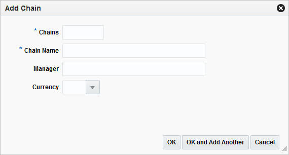

Then select Actions > Add, or use the Add icon. The Add Chain window appears.
In the Chains field, enter a unique number. This field is a required field.
In the Chain Name field, enter the name of the chain. This field is a required field.
In the Manager field, enter the name of the manager who is responsible for the chain.
In the Currency field, enter, select or search for the chain's currency code.
Then choose one of the following options.
Click OK to save the chain and close the window.
Click OK and Add Another to save the current chain and add additional entries.
Click Cancel to reject all entries and close the window.

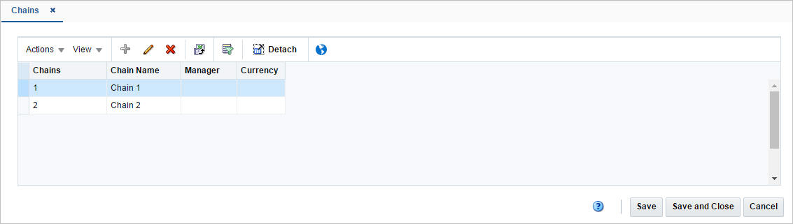

The Chain window allows you to create, edit, view, and delete a chain in the organizational hierarchy. A chain is below the company and above the area in the organizational hierarchy. You can use the chain level to define a variety of store formats, concepts, or geographical groupings.
Use the Actions Menu and icons to apply actions to the table. You can perform the actions listed below.
Table 2-5 Chains - Actions Menu/Icons and Description
Add and Add icon |
You can add new chains by selecting Actions > Add or by using the Add icon. For more information about how to add new chains, see the Creating a Chain section. This function is not available in edit mode. |
Delete and Delete icon |
You can delete chains:
Select Actions > Edit or use the Edit icon to edit the selected chain. For more information about how to edit a chain, see the Editing Chains section. |
Translate and Translate icon |
You can create a translation by selecting Actions > Translate or by using the Translate icon. |

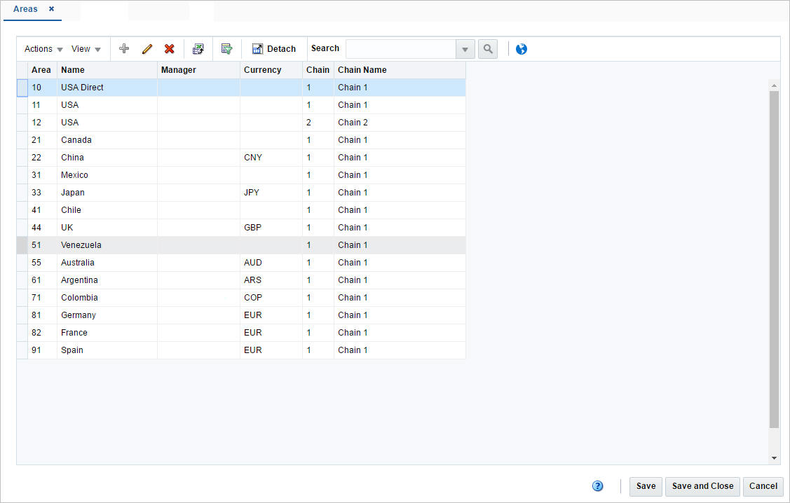

To create an Area, follow the steps below.
From the Tasks menu, select Foundation Data > Locations > Organizational Hierarchy. The Organizational Hierarchy window appears.
Select the Area button. All available areas are displayed in the table.
In the table, select Actions > Create, or use the Create icon. The Areas window appears.

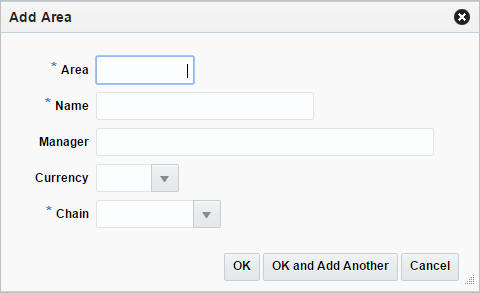

Then select Actions > Add, or use the Add icon. The Add Area window appears.
In the Area field, enter a unique number. This field is a required field.
In the Name field, enter the name of the area. This field is a required field.
In the Manager field, enter the name of the manager who is responsible for the area.
In the Currency field, enter, select or search for the area's currency code.
In the Chain field, enter, select or search for the chain ID which is associated with the area. This field is a required field.
Click OK to save the area and close the window.
Click OK and Add Another to save the current area and add additional entries.

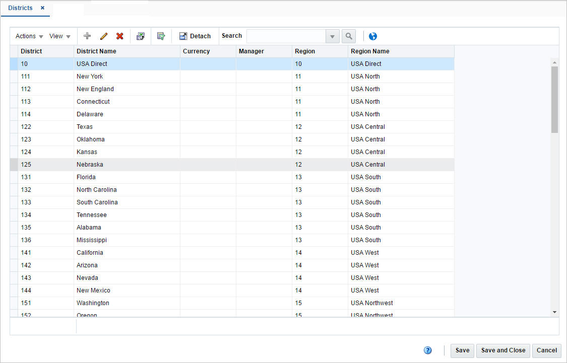

The Areas window allows you to create, edit, delete, or view an area in the organizational hierarchy. Area is below chain and above region in the organizational hierarchy. Typically, an area is used to define a geographical grouping within the organization. An area can belong to only one chain within the organizational hierarchy.You can associate location traits with an area. Location traits that are applied to an area are applied automatically to the regions, districts, and stores within the area.
Table 2-8 Areas - Actions Menu/Icons and Description
Add and Add icon |
You can add new areas by selecting Actions > Add or by using the Add icon. For more information about how to add new areas, see the Creating an Area section. This function is not available in edit mode. |
You can delete areas:
Select Actions > Edit or use the Edit icon to edit the selected area. For more information about how to edit an area, see the Editing Areas section. |
Search and Search icon |
You can search for the corresponding chain of an area:
You can customize the view of the table by using the options in the View Menu.
For more information about the View Menu and icons, see Table 2-6, "Chains - View Menu/Icons and Description".

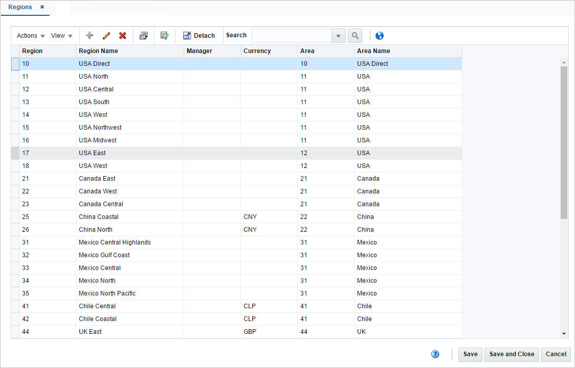

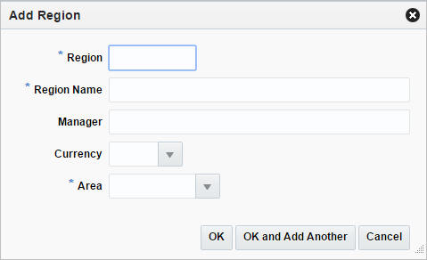

To create a region, follow the steps below.
Select the Region button. All available regions are displayed in the table.
In the table, select Actions > Create. The Regions window appears.
Then select Actions > Add, or use the Add icon. The Add Region window appears.
In the Region field, enter a unique number. This field is a required field.
In the Region Name field, enter the name of the region. This field is a required field.
In the Manager field, enter the name of the manager who is responsible for the region.
In the Currency field, enter, select or search for the region's currency code.
In the Area field, enter, select or search for the area ID which is associated with the region. This field is a required field.
Click OK to save the region and close the window.
Click OK and Add Another to save the current region and add additional entries.
To edit a region, follow the steps below.
Select the Region button. The available regions are displayed in the table.
Select a record in the table.
Then click the region ID link, or select Actions > Edit, or use the Edit icon. The Regions window appears.
Select Actions > Edit, or use the Edit icon. The Edit Region window appears.
The Region field displays the selected region ID.
Edit the region name, manager, currency and/or area, if necessary.
Click OK to add your changes to the table and close the window.
The Regions window allows you to add, edit, delete, and view a region in the organizational hierarchy. A region is below the area and above the district in the organizational hierarchy. Typically, the region is used to define a geographical grouping within the organization.
Table 2-10 Regions - Actions Menu/Icons and Description
Add and Add icon |
You can add a new region by selecting Actions > Add or by using the Add icon. For more information about how to add a new region, see the Creating a Region section. This function is not available in edit mode. |
You can delete regions:
Select Actions > Edit or use the Edit icon to edit the selected region. For more information about how to edit a region, see the Editing Regions section. |
You can search for the corresponding area of a region:
The toolbar contains the following icon and buttons.
Table 2-11 Regions Toolbar - Icons/Buttons and Description
| Icons/Buttons | Description |
Help icon |
You can access the online help for a particular page by clicking the Help icon. |
Save |
Click Save to save the entered records. |
Save and Close |
Click Save and Close to save the entered records and close the window. |
Cancel |
Click Cancel to reject all entries and close the window. |
Done |
If you open the window in view mode, the Done button is displayed. Click Done to close the window. |

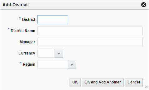

To create a district, follow the steps below.
Select the District button. All available districts are displayed in the table.
In the table, select Actions > Create. The Districts window appears.
Then select Actions > Add, or use the Add icon. The Add District window appears.
In the District field, enter a unique number. This field is a required field.
In the District Name field, enter the name of the district. This field is a required field.
In the Manager field, enter the name of the manager who is responsible for the district.
In the Currency field, enter, select or search for the district's currency code.
In the Region field, enter, select or search for the region ID which is associated with the district. This field is a required field.
Click OK to save the district and close the window.
Click OK and Add Another to save the current district and add additional entries.
To edit a district follow the steps below.
Select the District button. The available districts are displayed in the table.
Then click the district ID link, or select Actions > Edit, or use the Edit icon. The Districts window appears.
Select Actions > Edit, or use the Edit icon. The Edit District window appears.
The District field displays the selected region ID.
Edit the district name, manager, currency and/or region, if necessary.
The Districts window allows you to add, edit, delete, and view a district in the organizational hierarchy. A district is below the region and above the store in the organizational hierarchy. Typically, the district is used to define a geographical grouping within the organization.
Table 2-12 Districts - Actions Menu/Icons and Description
Add and Add icon |
You can add a new district by selecting Actions > Add or by using the Add icon. For more information about how to add a new district, see the Creating a District section. This function is not available in edit mode. |
You can delete districts:
Select Actions > Edit or use the Edit icon to edit the selected district. For more information about how to edit a district, see the Editing Districts section. |
You can search for the districts belonging to the entered region:
Table 2-13 Districts Toolbar - Icons/Buttons and Description
Help icon |
Save |
Save and Close |
Cancel |
Done |

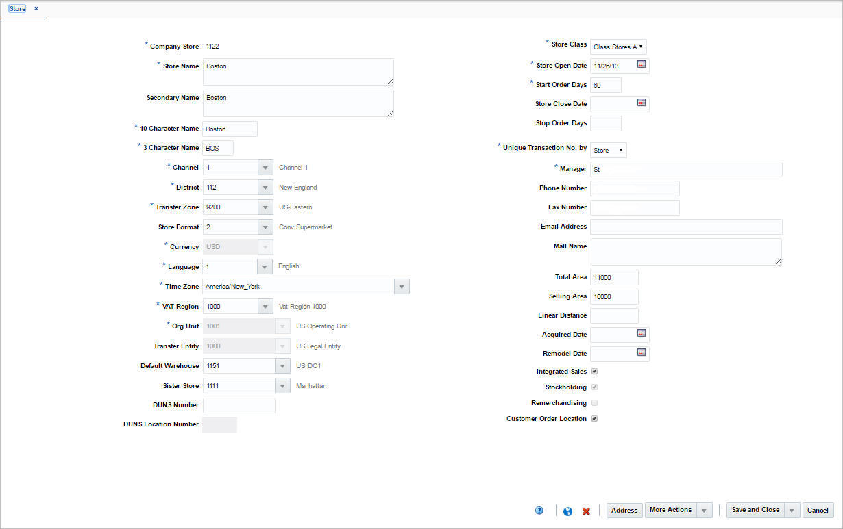

To create a store, follow the steps listed below.
Select the Store button. All available stores are displayed in the table.
In the table, select Actions > Create, or use the Create icon. The Store window appears.
Enter the necessary information for the store. For more information about the available fields in the Store window, see the Store Window section.
To edit a store, follow the steps below.
Select the Store button. The available regions are displayed in the table.
Then click the store ID link, or select Actions > Edit, or use the Edit icon. The Store window appears.
Edit the fields, if necessary. For more information about the available fields in the Store window, see the Store Window section.
Note: You cannot edit the Company Store ID, Currency, Org Unit and Transfer Entry. Additionally you cannot select or deselect the Stockholding checkbox in edit mode. |
The Store window allows you to create, edit, delete, and view a store in the organizational hierarchy. The store is the lowest level of the organizational hierarchy. The store may be defined as the selling entity. The store is crucial because it is the level at which business transactions are processed. A store can belong to only one district within the organizational hierarchy.
You can navigate to other windows in order to set up attributes, the square area of the store's departments, location traits, associations with competitors' stores, activity and delivery schedules, and geocodes.
Table 2-14 Store Window - Fields and Description
| Fields | Description |
Store |
Select the store type from the list. Possible store types are:
The Store field next to the store type enables. Enter a unique ID for the store. This field is a required field. |
Store Name |
Enter a unique description for the store. This field is a required field. |
Secondary Name |
Enter the secondary name for the store. |
10 Character Name |
Enter up to 10 character abbreviation for the store. This field is a required field. |
3 Character Name |
Enter up to 3 character abbreviation for the store. This field is a required field. |
Channel |
Enter, select or search for the channel of business to which the store belongs. This field is a required field. |
District |
Enter, select or search for the district ID. This field is a required field. |
Transfer Zone |
Enter, select or search for the transfer zone. This field is a required field. |
Store Format |
Enter, select or search for the store format ID. For example, select Mall. |
Currency |
Enter, select or search for the currency code. This field is a required field. |
Language |
Enter, select or search for the language code for the store. This field is a required field. |
Time Zone |
Enter, select or search for the time zone of the store. This field is a required field. |
VAT Region |
Enter, select or search for the VAT region code for the store. This field is a required field. |
Org Unit |
Enter, select or search for the organizational unit ID. This field is available if Oracle Financials is integrated. This field is a required field, if available. |
Transfer Entity |
Enter, select or search for the transfer entity ID. This field is a required field. |
Default Warehouse |
Enter, select or search for the default warehouse of the store. This field is only enabled, if you have specified a channel ID. For Franchise stores, this field is a required field. |
Sister Store |
Enter, select or search for the store number. This field is used to copy the store's history when defining allocations for new stores. |
DUNS Number |
Enter the Dun & Bradstreet Data Universal Numbering System (DUNS) number. The DUNS number is a nine digit code that identifies your store. |
DUNS Location Number |
Enter the DUNS location number. The DUNS location number is a four digit code that identifies the locations of your store. This field is only enabled, if you have entered the DUNS number for your store. |
Store Class |
The Store Class field is disabled, if you selected the store type Company. The Store Class field is defaulted to Class X if you selected the store type Franchise. Select the Store Class from the list. A store is grouped under the class based on the sale or the location. |
Store Open Date |
Enter the date when the store opens or use the Calendar icon to select a date. This field is a required field. |
Start Order Days |
Enter the number of days before the store opens to start ordering merchandise. |
Store Close Date |
Enter the date when the store closes or use the Calendar icon to select a date. |
Stop Order Days |
Enter the number of days before the store closes to stop ordering merchandise. |
Unique Transaction No. by |
Select the store or register for the Unique Transaction Number By from the list. This field indicates if the transaction number in the store is generated uniquely across store or at each register. This field is a required field. |
Manager |
Enter the name of the store manager. |
Phone Number |
Enter the phone number. |
Fax Number |
Enter the fax number. |
Email Address |
Enter the email address. |
Mall Name |
Enter the mall name, if necessary. |
Total Area |
Enter the total space of the store. |
Selling Area |
Enter the selling space available at the store. |
Linear Distance |
Enter the shelving space available at the store. |
Acquired Date |
Enter the date when the store has been acquired or use the Calendar icon to select a date. |
Remodel Date |
Enter the date when the store has been remodeled or use the Calendar icon to select a date. |
Integrated Sales checkbox |
The Integrated Sales checkbox is selected by default. You cannot load the sales for that store in ReSa, if the Integrated Sales option is not selected. |
Stockholding checkbox |
If the store is intended to be stockholding, this option must be selected. The Stockholding option is selected by default. |
Remerchandising checkbox |
Select the Remerchandising checkbox, if the store is undergoing a significant remerchandising effort as an indicator to Advanced Inventory Planning (AIP) application. |
Customer Order Location checkbox |
This option is available if the store type is Company and also for stock holding Franchise Stores. If the option is enabled, the store can be used to source or fulfill customer orders. |
Customer |
Only enabled, if the store type Franchise has been selected. Enter, select or search for the customer the franchise store belongs to. |
The Like Store section of the Store window allows you to create a store with the same assortment of items as another store. Also, you can choose to copy replenishment information, delivery schedules, and dates when closed as well as items on clearance from the existing store to the new store.
In the Store window, expand the Like Store section.
In the Like Store field, enter, select or search for the desired store ID.
In the Information to Copy section, select the desired checkboxes to copy the following information from the selected store:
Select the Replenishment Information to copy the replenishment information.

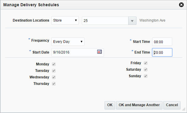

Select Delivery Schedule to copy delivery schedules.
Select Activity Schedule to copy dates when the store is closed.
Select Clearance Items to copy items on clearance to the new store.
In the Zoning Location section of the Store window you can associate a store with a retail price and a cost location. To add this information follow the steps below.
In the Store window, expand the Zoning Location section.
In the Pricing Store field, enter, select or search for the pricing store ID.
In the Cost Location field, select the location type from the list.
The field next to the location type enables. Enter, select or search for the cost location ID.
Table 2-15 Store Toolbar - Icons/Buttons and Description
Help icon |
Delete icon |
To delete a store:
Address |
Opens the Address window. For more information about how to add an address to a warehouse, see the Addresses Window section. |

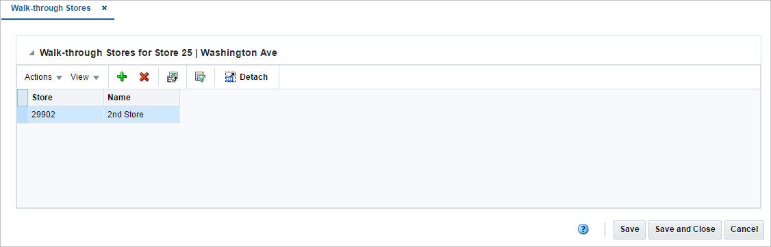

The Walk-through Stores window allows you to define several stores in one location. Each store may operate as a separate entity, however the stores are located in the same physical location. You can associate multiple stores as walk through locations. Walk-through stores can be uploaded into the system, or you can add walk through locations to a store. You must set up the stores and then associate one with another.
Table 2-16 Walk-through Stores Table - Actions Menu/Icons and Description
Add and Add icon |
You can add walk-through stores to a store by selecting Actions > Add or by using the Add icon. For more information about how to add walk-through stores, see the Adding a Walk-Through Store section. |
You can delete a walk-through store from a store.
You can customize the view of the table by using the options in the View Menu and icons listed below.
Table 2-17 Walk-through Stores Table - View Menu/Icons and Description
Columns |
Sort |
Reorder Columns |
The toolbar contains the following icons and buttons.
Table 2-18 Walk-through Toolbar - Icons/Buttons and Description
Help icon |
Save |
Save and Close |
Cancel |
Done |
To add walk through stores to a store, follow the steps below.
Select the Store button. The available stores are displayed in the table.
In the Store column, click the store ID link, or mark a record and select Actions > Edit, or use the Edit icon. The Store window appears.
In the Store window, select More Actions > Walk Through. The Walk-through Stores window appears.
Then select Actions > Add or use the Add icon. The Add Walk-through Stores window appears.
In the Store field, enter the store ID.
In the Name field, enter the store name.
Click OK to save the current store as walk-through store and close the window.
Click OK and Add Another to save the current store and add additional entries.
In the Walk-through Stores window, choose one of the following options.
Click Save to save your changes.
Click Save and Close to save your changes and close the window.

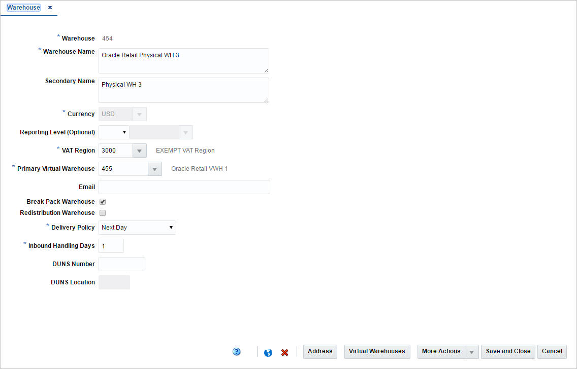

The Warehouse window allows you to create, edit, delete, and view a warehouse. The warehouse is the entity within RMS that defines the physical storage, cross-dock, or distribution facility in an organization. The warehouse has all of the transaction capability of the store, except for sales and price changes. You can specify at which organizational level a warehouse is reported.
You also have the option to designate a warehouse as a redistribution warehouse. A redistribution warehouse does not actually hold stock and cannot be used as a distribution center. With the existence of a redistribution warehouse, you can create purchase orders before the distribution center is known. Orders must be redistributed to actual warehouses or stores when the locations become known and before the merchandise is shipped.
You can access additional windows in order to set up attributes, activity schedules, and delivery schedules.
Table 2-19 Warehouse Window - Fields and Description
Warehouse |
Enter a unique ID for the warehouse. This field is a required field. |
Warehouse Name |
Enter a unique description for the warehouse. This field is a required field. |
Secondary Name |
Enter the secondary name for the warehouse. |
Currency |
Reporting Level (Optional) |
Select a reporting level from the list. |
VAT Region |
Enter, select or search for a VAT region for the warehouse. This field is a required field. |
Primary Virtual Warehouse |
This field is enabled when at least one virtual warehouse is created. Enter, select or search for the primary virtual warehouse. |
Enter an email address for the warehouse. |
Break Pack Warehouse checkbox |
Select the checkbox to indicate that the warehouse is capable of distributing less that the supplier case quantity. |
Redistribution Warehouse checkbox |
Select the checkbox to indicate that the warehouse distributes to other warehouses. |
Delivery Policy |
Select a delivery policy from the list. |
Inbound Handling Days |
Enter the number of days that the warehouse requires to receive any item and move the item to the shelf, so that it is ready to be picked. Next Day indicates that the if a location is closed, the warehouse will deliver on the next day. Next Valid Delivery Day indicates that the warehouse will wait until the next scheduled delivery day before delivering the item. |
DUNS Number |
Enter the DUNS location number. The DUNS location number is a four digit code that identifies the locations of your store. This field is only enabled, if have entered the DUNS number for your store. |
Zoning Location section: This section is only available, when you create a new warehouse |
Cost Location |
Select a cost location type from the list. The location ID field enables, enter, select or search for the location. |
Table 2-20 Warehouse Toolbar - Icons/Buttons and Description
Help icon |
Delete icon |
To delete a warehouse:
Address |
Virtual Warehouses |
Opens the Virtual Warehouses window. For more information about how to create a virtual warehouse, see the Virtual Warehouses Window section. |
More Actions |
Click More Actions to see a list of additional actions that can be performed in the Warehouse window.
Save and Close |
Save and Create Another |
Click Save and Create Another to save the entered records and add additional entries. This option is only available, if you create a warehouse. |
Save and Edit Another |
Click Save and Edit Another to save the entered records and edit additional entries. This option is only available in edit mode. |
Cancel |
Done |

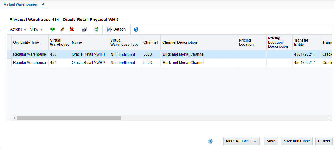

The Virtual Warehouse window allows you to divide a physical warehouse into one or more virtual warehouses. Virtual warehouses are used in a multi-channel environment to track ownership of inventory by channel. You associate each virtual warehouse with a channel. If the virtual warehouse contains a finishing location, you can indicate an additional virtual warehouse within the channel.
Virtual warehouses are considered stockholding locations, while the physical warehouse is considered a non-stockholding location.

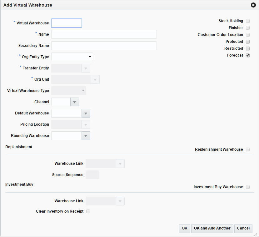

To add a virtual warehouse to a physical warehouse, follow the steps below.
From the Tasks menu select Foundation Data > Locations > Organizational Hierarchy. The Organizational Hierarchy window appears.
Select the Warehouse button. The available warehouses are displayed in the table.
Then, select Actions > Edit or use the Edit icon. The Warehouse window appears.
Click the Virtual Warehouse button. The Virtual Warehouses Window appears.
Select Actions > Add or use the Add icon. The Add Virtual Warehouse window appears.
In the Virtual Warehouse field, enter a unique warehouse ID. This field is a required field.
In the Name field, enter the name of the warehouse. This field is a required field.
In the Secondary Name field, enter the secondary name for the warehouse.
In the Org Entity Type field, select the org entity type from the list. This field is a required field.
In the Transfer Entity field, enter, select or search for the transfer entity. This field is a required field.
In the Org Unit field, enter, select or search for the org unit. This field is a required field.
In the Virtual Warehouse Type field, select a warehouse type from the list. This field is a required field.
In the Channel field, enter, select or search for a channel. This field is a required field.
In the Default Warehouse field, enter, select or search for the warehouse.
In the Pricing Location field, enter, select or search for the pricing location ID. This field is a required field.
In the Rounding Warehouse field, enter select or search for the warehouse.
Select the Stock Holding checkbox to indicate that the warehouse is a stock holding one.
Note: If you select Regular Warehouse as the Org Entity Type, the Stock Holding checkbox is selected and disabled. You cannot deselect this checkbox. |
Select the Finisher checkbox to indicate that the warehouse is a finisher location.
Select the Customer Order Location checkbox to indicate that the warehouse is a location where the customer places orders.
Select the Protected checkbox to indicate that the warehouse is affected last in transactions where inventory is removed or affected first in short-shipment type transactions where inventory is being added.
Select the Restricted checkbox to indicate that the virtual warehouses is restricted from receiving stock during an inbound transaction.
Select the Forecast checkbox to indicate that the warehouse should be included in forecast calculations.
Select the Replenishment checkbox to indicate that the virtual warehouse is included in the net inventory calculations for the replenish able warehouse.
In the Warehouse Link field, enter, select or search for the corresponding link.
Then select one of the following options.
Click OK to add the current warehouse and close the window.
Click OK and Add Another to add the current warehouse and add additional warehouses.

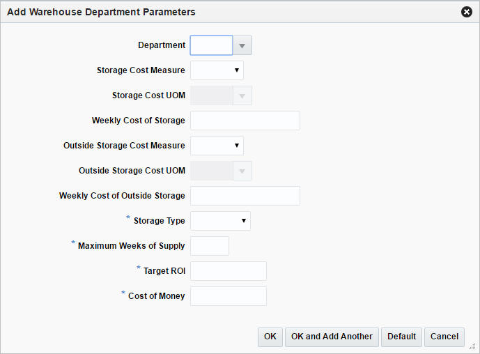

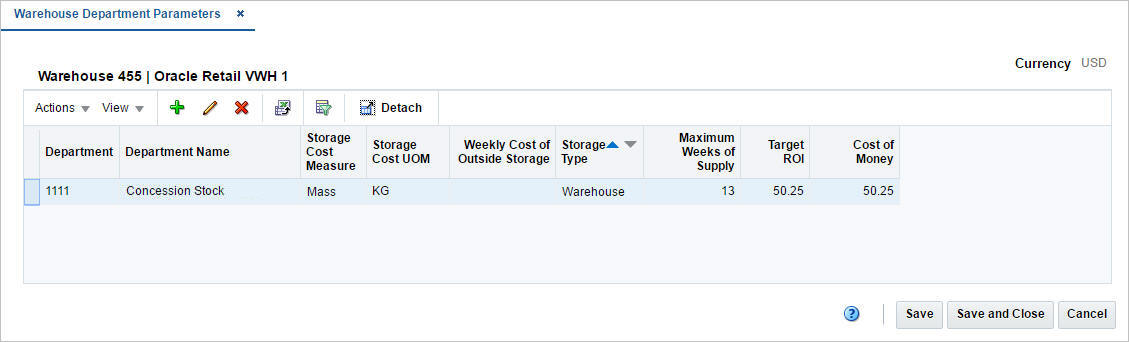

The Warehouse Department window allows you to specify investment buy parameters at the warehouse or warehouse/department level. You can set up costs of storage and other parameters for a specific warehouse. Within the warehouse, you can set up several sets of investment buy parameters which are specific for a set of items, such as frozen goods.
Use the Actions Menu and Icons to apply actions to the table. You can perform the actions listed below.
Table 2-24 Warehouse Department Parameters - Actions Menu/Icons and Description
Add and Add icon |
You can add parameters by selecting Actions > Add or by using the Add icon. For more information about how to add parameters, see the Adding Warehouse Department Parameters section. |
You can edit parameters by selecting Actions > Edit or by using the Edit icon. For more information about how to edit parameters, see the Editing Virtual Warehouses section. |
You can delete parameters:
Table 2-25 Warehouse Department Parameters - View Menu/Icons and Description
Columns |
Reorder Columns |
Table 2-26 Warehouse Department Parameters Toolbar - Icons/Buttons and Description
Help icon |
Save |
Save and Close |
Cancel |
Done |
To add warehouse department parameters, follow the steps below.
Select Actions > Edit or use the Edit icon. The Warehouse window appears.
Select More Actions > Warehouse Department Parameters. The Warehouse Department Parameters window appears.
Then, select Actions > Add or use the Add icon. The Add Warehouse Department Parameter window appears.
In the Department field, enter, select or search for the department.
In the Storage Cost Measure field, select the cost measure from the list. The Storage Cost UOM field enables.
In the Storage Cost UOM field, enter, select or search for the unit of measure.
Note: This field is disabled, if you select Eaches as a storage cost measure. |
In the Weekly Cost of Storage field, enter the weekly cost of storage value.
In the Outside Storage Cost Measure field, select an outside cost measure from the list. The Outside Storage Cost UOM field enables.
In the Outside Storage Cost UOM field, enter, select or search for the unit of measure.
In the Weekly Cost of Outside Storage field, enter the weekly cost of outside storage value.
In the Storage Type field, select the type from the list. This field is a required field.
In the Maximum Weeks of Supply field, enter the number of weeks. This field is a required field.
In the Target ROI field, enter the target ROI (Return of Investment). This field is a required field.
In the Cost of Money field, enter the cost.
Click OK to save the current parameter and close the window.
Click OK and Add Another to save the current parameter and add additional entries.
Click Default to save the current parameter and set it as the default value.
To edit warehouse department parameters, follow the steps below.
Click the Virtual Warehouses button. The Virtual Warehouses Window appears.
Select Actions > Edit or use the Edit icon. The Edit Warehouse Department Parameter window appears. The parameters of the selected record are shown.
Edit the values, if necessary.
Click OK to save your changes and close the window.
Click Default to save the current parameter and set it as default value.

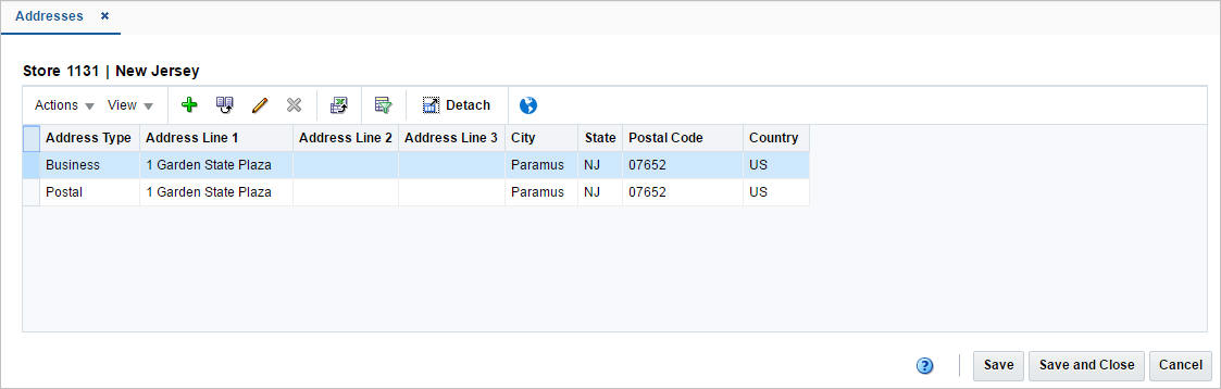

To maintain addresses, follow the steps below.
To maintain an address for a store:
Then select More Actions > Address. The Addresses window appears.
To maintain an address for a warehouse:
Select the Warehouse button. The available stores are displayed in the table.
In the Warehouse column, click the store ID link, or mark a record and select Actions > Edit, or use the Edit icon. The Warehouse window appears.

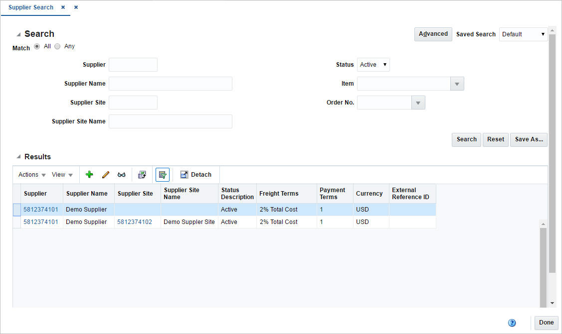

To maintain an address for a supplier:
From the Tasks menu, select Foundation Data > Suppliers and Partners > Manage Suppliers. The Supplier Search window appears.
Enter or select search criteria as desired to make the search more restrictive.
Click Search. The suppliers that match the search criteria are displayed in the Results section.
In the Supplier/Supplier Site column, click the supplier/supplier site ID link, or mark a record and select Actions > Edit, or use the Edit icon. The Supplier/Supplier Site window appears.
Select More Actions > Address. The Addresses window appears.
To maintain an address for a partner:
From the Tasks menu, select Foundation Data > Suppliers and Partners > Manage Partners. The Partner Search window appears.
Click Search. The partners that match the search criteria are displayed in the Results section.
In the Partner Site column, click the partner ID link, or mark a record and select Actions > Edit, or use the Edit icon. The Partner window appears.
To add an address in the Addresses window:
In the table, select Actions > Add or use the Add icon. The Add Address window appears.
In the Address Type field, select the corresponding type.
The Apply to all Undefined Required Types checkbox, indicates that the current address information is added to each required address type. This checkbox is selected by default.
In the Address information section, enter the following details.
In the Address field, enter the full address. This field is a required field.
In the City field, enter the city in which the store is located. This field is a required field.
In the State field, select a state from the list.
In the Postal Code field, enter the postal code of the store.
In the Country field, enter, select or search for the country. This field is a required field.
Select the Primary Address checkbox to indicate that the current address is a primary address.
In the Contact information section, you can enter the following details.
In the Name field, enter the name of the contact person associated to the store.
In the Phone field, enter the phone number of the contact.
In the Fax field, enter the fax number.
In the Pager field, enter the pager number.
In the Email field, enter the email address.
Click OK to save the current address and close the window.
Click OK and Add Another to save the current address and add additional entries.
To add a new address from an existing address, follow the steps below.
In the Address window, select a record in the table.
Select Actions > Add from Existing or use the Add from Existing icon. The Add Address window appears.
The address and contact fields enable and display the data of the selected address. Change the entries as necessary.
Note: The Primary Address field is disabled. |
To edit an address, follow the steps below.
In the Addresses window, select a record in the table.
Select Actions > Edit or use the Edit icon. The Edit Address window appears.
In the Address Type field shows the type of the selected address. You cannot edit this field.
The address and contact fields display the data of the selected address. Change the entries as necessary.
Click OK to save the your changes and close the window.

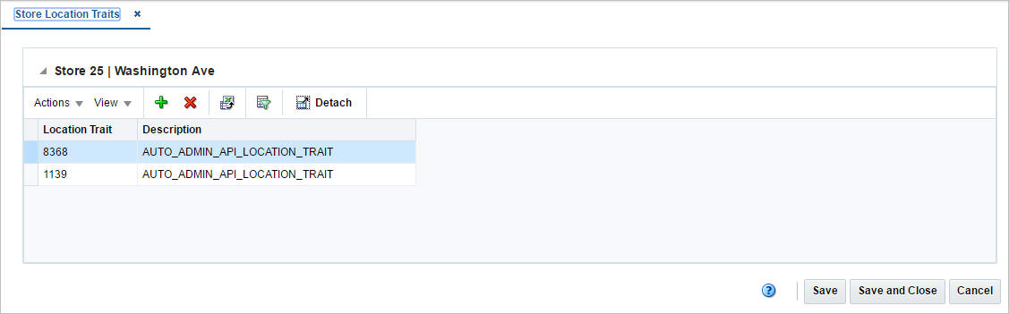

The Store Location Traits window allows you to add, delete, and view location traits. You can group areas, regions, districts, or stores by location traits.
At the store level, location traits can be used as a grouping mechanism when you:
Record Attributes for a Store
Add Locations to a Location List
Table 2-30 Store Location Traits - Actions Menu/Icons and Description
Add and Add icon |
You can add location traits by selecting Actions > Add or by using the Add icon. For more information about how to add location traits, see the Adding Store Location Traits section. |
You can delete location traits:
Table 2-31 Store Location Traits - View Menu/Icons and Description
Columns |
Reorder Columns |
Table 2-32 Store Location Traits Toolbar - Icons/Buttons and Description
Help icon |
Save |
Save and Close |
Cancel |
Done |
To add a location trait to the store, follow the steps below.

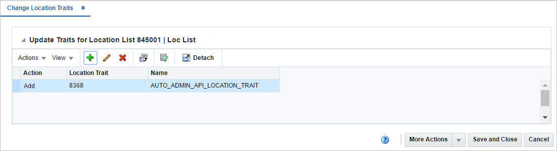

In the Store window, select More Actions > Location Traits. The Store Location Traits window appears.
Then select Actions > Add or use the Add icon. The Add Location Trait window appears.
In the Location Trait window. Enter, select or search for the desired location trait ID.
Click OK to add the location trait and close the window.
Click OK and Add Another to save the current record and add additional entries.

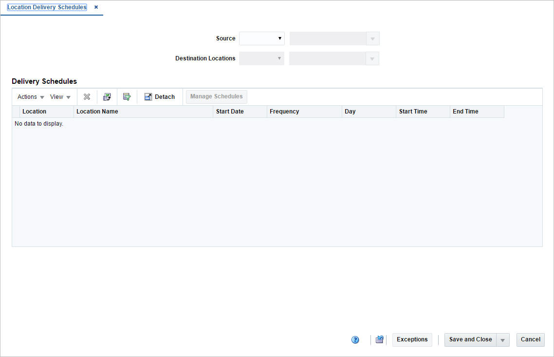

The Location Delivery Schedules window allows you to create, edit, and view delivery schedules for items from a supplier or warehouse to stores and warehouses. After you create a delivery schedule, you can define exceptions to the schedule by specifying which items are not to be delivered to the location on a specific delivery day.
When the Use Location Delivery Schedule system parameter is selected, the replenishment feature uses the delivery schedule to calculate lead times for the items at the location. When there is a delivery schedule for a supplier or warehouse at a location, the specified lead times for the item are the minimum amount of time in which a purchase order can be delivered to that location.
When the delivery date of the purchase order does not fall on a delivery day of the supplier or warehouse, the lead time is calculated by taking the minimum lead time and adding additional days to reach the next valid delivery day. In effect, the lead time is extended until the next delivery day of the supplier or warehouse. Extending the lead time increases the number of units required to replenish the item. The lead time is only extended when the replenishment method is Dynamic, Dynamic - Seasonal, Dynamic - Issues, or Floating Point.
The Location Delivery Schedule window contains the following sections.
The header displays the Source and Destination Location field.
In the Source field, select the source type, store or warehouse. Then, enter, select or search for the source ID.
In the Destination Location field, select the destination type, store or warehouse. Then, enter, select or search for the destination ID.
When you access the Location Delivery Schedules window from the Warehouse window, the Destination Locations fields are populated with the selected warehouse. The Source fields are blank and enabled. Once you choose a source, the table displays records matching the source and destination locations values.
When you access the Location Delivery Schedules window from the Supplier Site window, the Source fields are populated with the selected supplier site. The Destination Locations fields are blank and enabled. Once you choose a destination, the table displays records for the source and destination values.
The table displays the available delivery schedules for the selected location.
Use the Actions Menu and icons to apply actions to the Delivery Schedules Table. You can perform the actions listed below.
Table 2-33 Location Delivery Schedules Table - Actions Menu/Icons and Description
You can delete delivery schedules from the table.
Manage Schedules button |
Opens the Manage Delivery Schedules window. For more information about how to manage delivery schedules for a location, see the Managing Location Delivery Schedules section. |
Table 2-34 Delivery Schedules Table - View Menu/Icons and Description
Columns |
Sort |
Reorder Columns |
You can filter the items by one or multiple column values by clicking Query by Example or by using the Query by Example icon. |
The Toolbar contains the following icons and buttons.
Table 2-35 Location Delivery Schedules Toolbar - Icons/Buttons and Description
Help icon |
Refresh icon |
You can refresh the window by clicking the Refresh icon. All entries are reset and not saved. This option is not available, if you enter the window through the Supplier Site window. |
Exceptions |
Opens the Source Delivery Exceptions window. For more information about this function, see the Source Delivery Exceptions Window section. |
Save and Close |
Select Save and Create Another to save the current record and enter additional records. This option is not available, if you enter the window through the Supplier Site window. |
Cancel |
To manage location delivery schedules, follow the steps below. You can enter the Location Delivery Schedules window in different ways.
To add a delivery schedule at the store or warehouse level:
Select the Store/Warehouse button. The available stores/warehouses are displayed in the table.
In the Store/Warehouse column, click the store/warehouse ID link, or mark a record and select Actions > Edit, or use the Edit icon. The Store/Warehouse window appears.
Click More Actions > Delivery Schedules. The Location Delivery Schedules window appears.
Store/Warehouse Level:
In the Source fields, select supplier site or warehouse. Then enter, select or search for the source ID.
The Destination Locations fields display the information of the selected store/warehouse.
To manage delivery schedules, see the Managing Delivery Schedules section.

In the Delivery Schedules window, follow the steps below.
In the table, select the Manage Schedules button. The Manage Delivery Schedules window appears.
The Destination Location fields display the store information.
In the Frequency field, select the desired time span from the list.
In the Start Date field, enter the start date or use the Calendar icon to select a date.
In the Start Time field, enter the starting time of the schedule.
In the End Time field, enter the end time of the schedule.
Select the checkboxes of the desired weekdays of the delivery schedule.
Click OK to add the current schedule and close the window.
Click OK and Manage Another to add the current schedule and add additional entries.

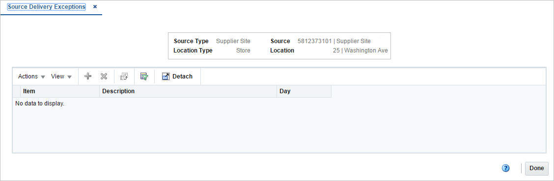

The Source Delivery Exceptions window allows you to define exceptions to the delivery date of a supplier at a store or warehouse. You specify which items are not to be delivered to the location on a specific delivery date.
The Source Delivery Exceptions Window contains the following sections.
Header
The header displays the source type, ID and name as well as the location type, ID and name.
The table displays the item for which the delivery exception is valid.

To add a delivery exception for a supplier to a warehouse or store, follow the steps below. You can enter the Source Delivery Exceptions window in different ways
Navigate: through Store/Warehouse window
Click Exceptions. The Source Delivery Exceptions window appears.
Navigate: through Supplier Site window
In the Supplier Site column, click the supplier site ID link, or mark a record and select Actions > Edit, or use the Edit icon. The Supplier Site window appears.
Select More Actions > Delivery Schedule. The Location Delivery Schedules window appears.
In the Source Delivery Exceptions window, follow the steps below.
In the table, select Actions > Add, or use the Add icon. The Add Exceptions window appears.
In the Item Type field, select the type, item or item list.
In the Item field, enter select or search for the item.
In the Date field, enter the day on which you do not want the item or item list delivered or use the Calendar icon to select a date.
Click OK to add the current exception and close the window.
Click OK and Add Another to add additional exceptions.

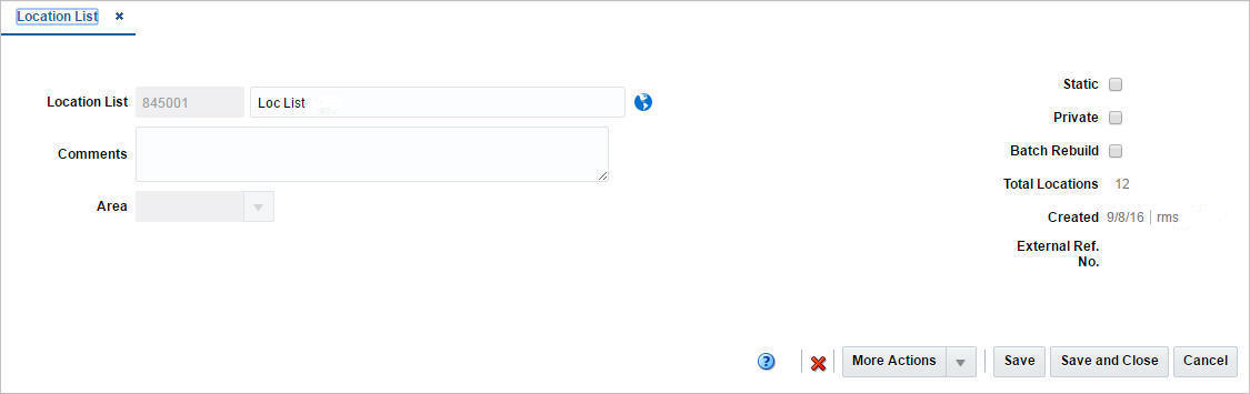

To create a location list, follow the steps below.
You can enter the Create Location List window in different ways.
From the Tasks menu, select Foundation Data > Locations > Create Location List. The Create Location List window appears.
From the Tasks menu, select Foundation Data > Locations > Manage Location Lists. Search for location lists. Then select Actions > Create or use the Create icon. The Create Location List window appears.
Enter the data, as necessary.
For more information about the available fields in the Location List window, see the Location List Window section.
The Location List window allows you to create, edit, or view basic information about a location list. You can indicate whether the location list is static or dynamic. Dynamic lists can be rebuilt on demand. You can indicate whether a dynamic location list can also be rebuilt by a scheduled batch program. The ID of the user who created the location list and the date on which it was created appear. You can also view the number of locations that make up the location list.
The Location List window contains the following fields.
Table 2-39 Location List - Fields and Description
Location List |
Displays the location list ID and description of the selected list. |
Comments |
Add comments to the selected location list. |
Hierarchy Level: |
The name of this field depends on the hierarchy level the location list is associated to. |
Chain |
Enter, select or search for the chain. |
Area |
Enter, select or search for the area. |
Region |
Enter, select or search for the region. |
District |
Enter, select or search for the district. |
Store |
Enter, select or search for the store. |
Warehouse |
Enter, select or search for the warehouse. |
Static checkbox |
If selected, the location list is static. You can not add additional locations to the list. If not selected, the location list is dynamic. |
Private checkbox |
This checkbox Select the checkbox to indicate that the security for a location list is on. |
Batch Rebuild checkbox |
If selected, the dynamic location list is rebuilt automatically by a scheduled batch program based on the original criteria. |
Total Locations |
Displays the total number of locations on the selected location list. |
Created |
Displays the date, when list has been created, and the user, who created the list. |
External Ref. No |
Displays a reference number, if available. |

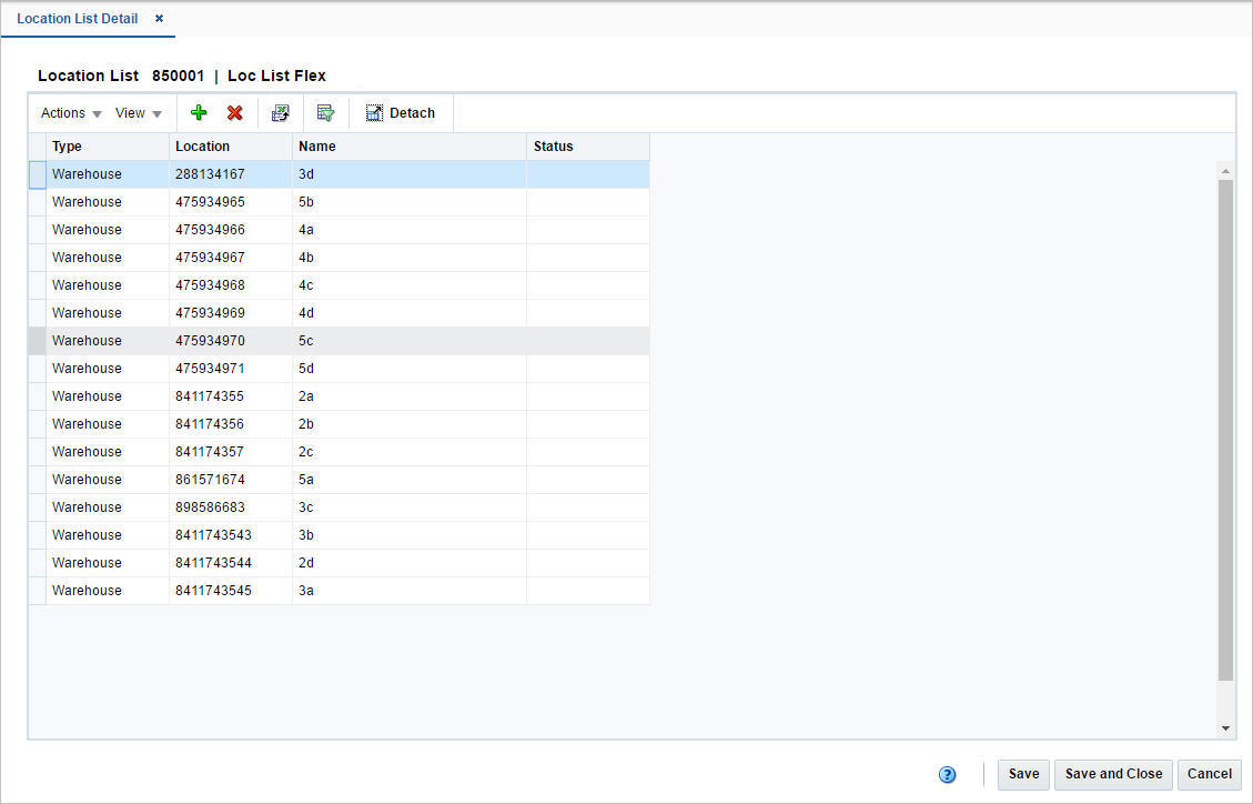

The Location List Detail window allows you to add, delete, and view the locations that make up a location list.
The Location List Detail window contains the following sections.
Location List Detail Header
The header contains the location list ID and description.
The table displays all the locations making up the location list. The location type, location ID, name and status are displayed by default.
Table 2-41 Location List Details Table - Actions Menu/Icons and Description
Add and Add icon |
You can add locations to the current list, by selecting Actions > Add, or use the Add icon. For more information about how to create/add a location to the location list, see the Adding Locations to Location Lists section. |
You can delete a location from the location list:
Table 2-42 Location List Detail - View Menu/Icons and Description
Columns |
Reorder Columns |
Table 2-43 Location List Detail Toolbar - Icons/Buttons and Description
Help icon |
Save |
Click Save to save the entered records. Only displayed, if the location list is static. |
Save and Close |
Click Save and Close to save the entered records and close the window. Only displayed, if the location list is static. |
Rebuild |
Opens the Location List Rebuild window. Only displayed, if the location list is dynamic. For more information about how to rebuild a location list, see the Rebuilding Location Lists section. |
Rebuild and Close |
Rebuilds the current location list and closes the window. Only displayed, if the location list is dynamic. For more information about how to rebuild a location list, see the Rebuilding Location Lists section. |
Cancel |
Done |
To add a location to the selected location list, follow the steps below.
From the Tasks menu, select Foundation Data > Locations > Manage Location Lists. The Manage Location List window appears.
Click Search. The items that match the search criteria are displayed in the Results section.
Select a record in the Results section.
Then select Actions > Edit, or use the Edit icon. The Location List window appears.
Select More Actions > Locations. The Location List Detail window appears.
Then select Actions > Add or use the Add icon. The Add Location window appears.
In the Type field, enter the location type. For example, select Warehouse.
In the Location field, enter, select or search for the location ID.
Click OK to add the new location and close the window.
Click OK and Add Another to add additional entries.

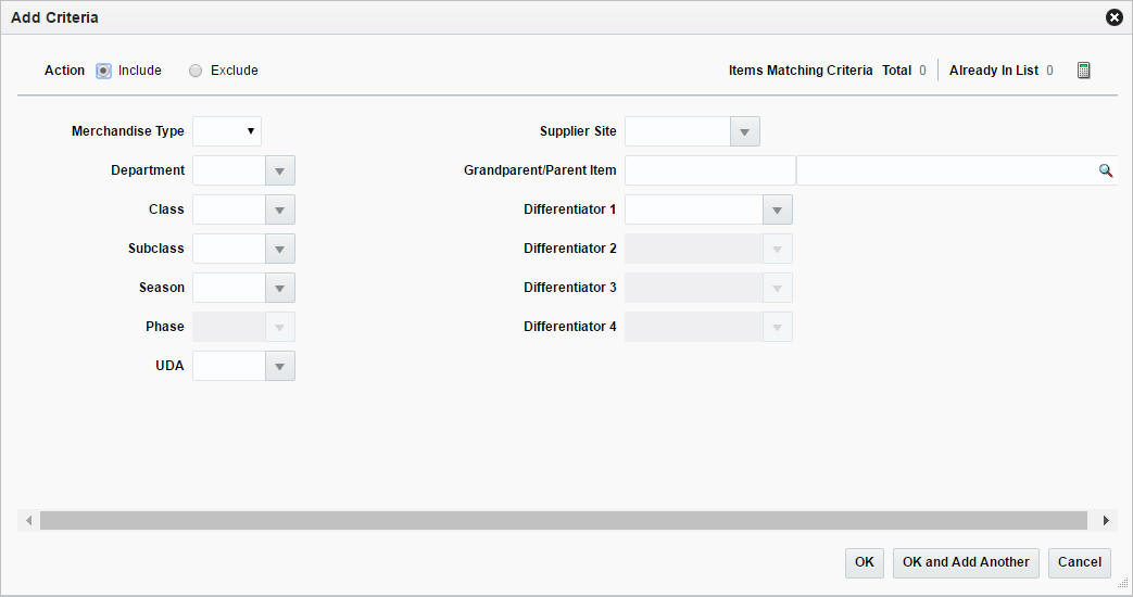

To add location list criteria, follow the steps below.
Go to the Location Type field, in the top right corner of the window. Select a location type.
Then select Actions > Add or use the Add icon. The Add Criteria window appears.
In the Element field, select an element from the list.
Note: If the Element is Cost Zone or Store Grade, you can specify which group (cost zone group or store grade group) the zone or grade is a member of. |
In the Comparison field, select a sign from the list.
In the Value field, enter a value.
In the Logic Operation field, select an option from the list.
In the Related Value field, enter, select or search for the value.
Click OK to add your entries and close the Add Criteria window.
Click Cancel to reject all entries and close the Add Criteria window.
Click the Test SQL button to test, if the entered criteria is valid.
Note: If the location list criteria is not valid, a message is displayed. |
Click Build List to rebuild the location list.
Click Save to save your entries.
Click Save and Close to save your entries and close the window.

To rebuild a location list, follow the steps below.
Select More Actions > Location List Rebuild. The Location List Rebuild window appears. The location list details are displayed.
Select the Rebuild Location List checkbox, to rebuild the current list.
Click Execute and Close to rebuild the selected location list and close the window.

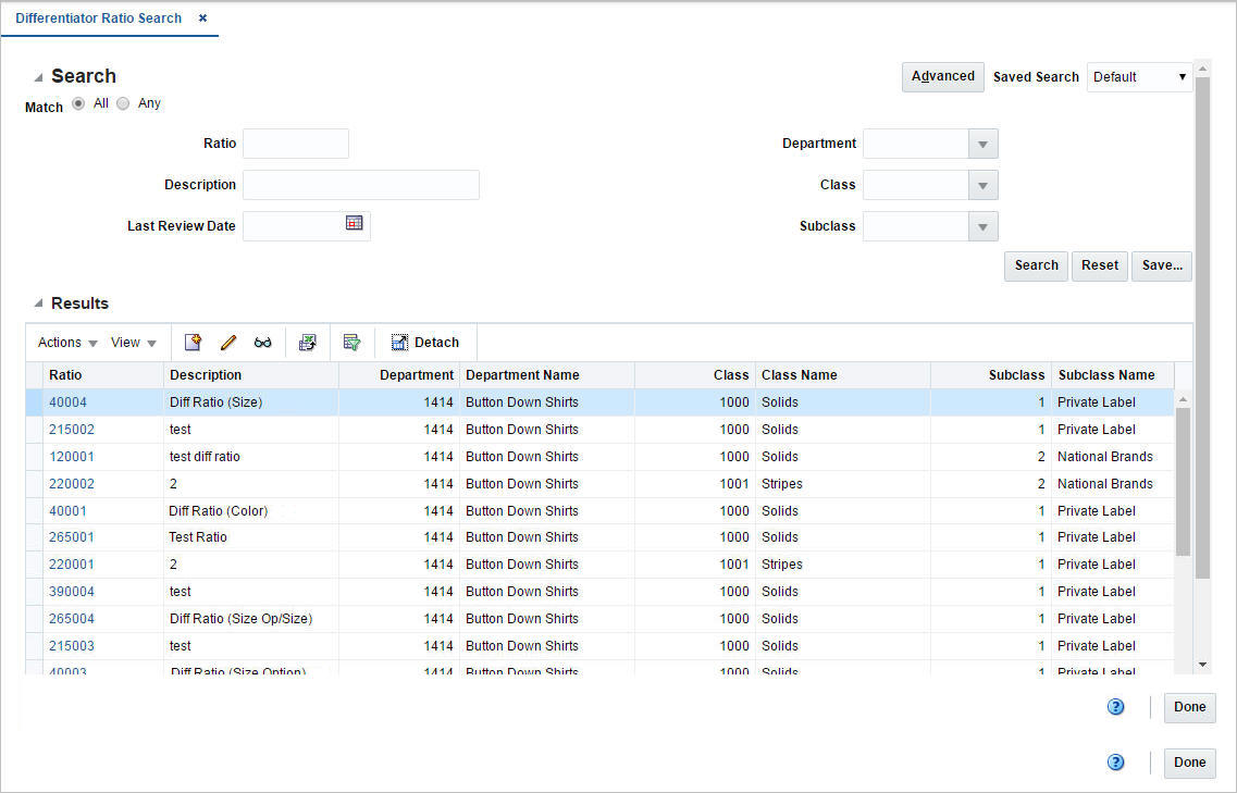

The Manage Location Lists option opens the Location List Search window. In the Location List Search window you can perform the following actions.
Search for a location list by various search criteria
View the entered search results
View a location list
Create a location list
Create a location list from an already existing location list
Edit a location list
You can access the Location List Search window from the Task menu, select Foundation Data > Locations > Manage Location Lists. The Location List Search window appears.

To search for a location list:
From the Task menu, select Foundation Data > Locations > Manage Location Lists. The Location List Search window appears.
You can search for a location list by using basic or advanced search criteria, depending on the requirement. The basic mode is the default search mode.
Click Advanced to access the search section in advanced mode.
Click Basic to return to basic mode.
To search for a location list by using basic search criteria:
Enter, select or search for one or all of the following basic search criteria.
Table 2-47 Location List Search - Basic Search Criteria and Description
Match option |
Check radio button All or Any. All - only location lists matching all entered search criteria are shown. Any - location lists matching any of the entered search criteria are shown. |
Location List |
Enter the location list ID. |
Description |
Enter a location list description. |
Type |
Select the location list type, Static or Dynamic, from the list. |
Created Date |
Enter the create date of the location list or use the Calendar icon to select a date. |
Store |
Enter, select or search for the store ID. |
Store Name |
Enter the store name. |
Warehouse |
Enter, select or search for the Warehouse ID. |
Warehouse Name |
Enter the name of warehouse. |
Click the Saved Search list to select one of the saved search criteria. Selecting a saved search populates the search section with the saved search criteria. If the run automatically function is enabled for the search, the search is executed immediately.
You can also personalize your saved searches by selecting Personalize. The Personalized Saved Searches window appears.
For more information about the Personalized Saved Search, see the Common User Interface Controls chapter, section "Personalize Saved Search".
Click Search. The location lists that match the search criteria are displayed in the Results section.
Click Reset to clear the search section and results.
Click Save As... to save the current search criteria. The Create Saved Search window appears.
For more information about how to save your search criteria, see the Common User Interface Controls chapter, section "Create Saved Search".
