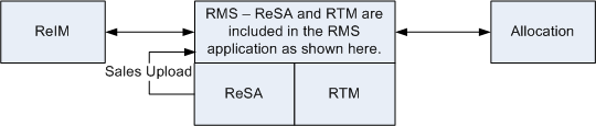

RMS Integration with Other Applications
RMS provides essential information to all of the Oracle Retail Merchandising Operations Management applications (ReSA, RTM, ReIM, Allocation), and interacts with all of them. RMS exists on the same database schema as all of the other applications, which provides flexibility in how information is shared between RMS and the other Oracle Retail Merchandising Operations applications.
Information is shared with other Oracle Retail Merchandising Operations Management applications through direct reads from Oracle Retail Merchandising Operations Management application tables, calls to Oracle Retail Merchandising Operations Management application packages, batch processes, and the Oracle Retail Integration Bus (RIB) if the client is using this option.
The following diagram illustrates the RMS location in the merchandising footprint.
Figure 4-1 RMS Location in the Merchandising Cloud Services Footprint
Surrounding text describes Figure 4-1 .
RMS and RTM
Oracle Retail Trade Management (RTM) and RMS share the same database instance. When RTM is enabled in an RMS instance, certain import-specific data maintenance is required for country, supplier, partners and items. These are directly updated into the RMS database and subsequently used in RTM.
RMS and ReSA
Oracle Retail Sales Audit (ReSA) and RMS share the same database. ReSA shares some of its master data with RMS. Foundation data such as stores a company/location close dates, location traits, bank setup and tender types are maintained in RMS and used in ReSA.
Sales Upload Process
Current reference data is retrieved from RMS into ReSA by the batch program SAGETREF. The data is extracted into multiple data files. The data in the files is used by the batch program SAIMPTLOG as reference data for doing validation checks on the POS/OMS transaction data during the data upload to ReSA. Having the reference in data file formats increases the performance of the SAIMPTLOG process. SAGETREF generates the following reference files:

RMS and Allocation
RMS provides the following to Allocation:
  • Foundation Data is essential to all areas of Allocation including valid locations to allocate to and from, location groupings, and valid merchandise hierarchies to allocate within.
  • Item-Allocations are generated at the item location level so it is necessary that the Allocation application understand what items and item/locations are eligible in the system.
  • Purchase Order-One of the sources from which a user can allocate. Allocation relies on RMS to provide Purchase Order information.
  • Transfer-One of the sources from which a user can allocate. Allocation relies on RMS to provide Transfer information.
  • Bill Of Lading (BOL)-One of the sources from which a user can allocate. Allocation relies on RMS to provide BOL information.
  • Advance Shipment Notices (ASN)-One of the sources from which a user can allocate. Allocation relies on RMS to provide ASN information.
  • Inventory-In order to determine the correct need at an item location level before performing an allocation the application needs visibility to the current on hand inventory at each location being allocated to. Allocation relies on RMS to provide inventory information at the item/location level.
  • Sales Information-Allocation can use historical sales, forecast sales, and plan sales in order to determine the need at an item/location level for an allocation. Allocation interfaces this information in from external planning system to an Allocation table.
Allocation provides the following to RMS/RTM/ReSA:
  • Foundation Data is essential to all parts of invoice matching including valid locations for Invoices to be implemented at, valid suppliers to receive invoices from, and supplier addresses to send credits and debits based on invoice matching results.
  • Item is essential to the invoice matching process as item information ensures that invoices being received are valid for the business. For example an item received on an invoice is carried by the client, is supplied by the supplier who sent the invoice, and is carried in the locations for which the item was received.
  • Purchase Orders are used by Invoice Matching to facilitate the invoice matching process which is performed at the purchase order location level.
  • Shipments-Shipment information is used by Invoice Matching to determine if a PO has been received yet which affects the matching algorithm used by the AutoMatch batch program in Invoice Matching.
  • Deals and Rebate-Invoice Matching creates credit memos, debit memos, and credit requests based on deal and rebate information in RMS for processing by the financial (AP) system. This is performed by the ComplexDealUpload and FixedDealUpload batch processes that read from RMS staging tables.
Invoice Matching provides the following to RMS:
  • Invoice Matching results for shipments-Shipment records are updated with the invoice matching results from the invoice match process (this involves updating the match status and quantity matched of the shipments in question). The matching process is handled by the AutoMatch batch process in Invoice Match which attempts to match all invoices in ready-to-match, unresolved, or multi-unresolved status.
  • Receiver Cost Adjustments-An API is executed when invoice matching discrepancies are resolved through a receiver cost adjustment. The API updates the purchase order, shipment, and potentially the item cost in RMS, depending on the reason code action used.
  • Receiver Unit Adjustments-An API is executed when invoice matching discrepancies are resolved through a Receiver Unit Adjustment. The API updates the purchase order and shipment in RMS to complete the transaction.
  • Closing unmatched shipments-Invoice matching closes the invoice matching status for shipments in RMS after a set period of time (defined by the client in system options). This updates the invoice matching status of the shipment on the shipment table in RMS. This process is managed by the ReceiptWriteOff batch program.

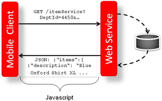

The RMS ReSTful Web services are based on a mobile application defined by Oracle Retail. The services are designed to support the mobile application functionality.
Figure 4-2 Mobile Client and Web Services integration through Javascript
Surrounding text describes Figure 4-2 .
Other Uses
The main objective of the ReSTful Web service is to support mobile applications, some of the services functionalities may not be useful for general use.The services are used for client's custom mobile application. The ReSTful Web services Java code cannot be customized, but the MBL PL/SQL functions and object types can be customized for a client use. In addition, the client uses the RSE tool to create their own custom services in place of the ReSTful Web services.
Using ReSTful WebService

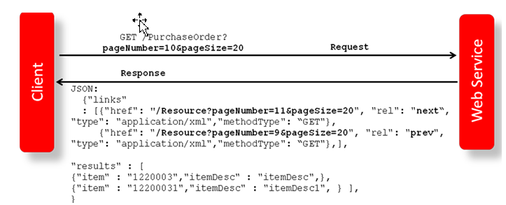

Paging
Some of the RMS ReSTful Web services have the potential to bring back a large number of records and therefore these services are equipped to segmenting the result into pages. The page number to retrieve and the size of the page are added as input parameters to all the paged services.
Each paged result includes the following information:
  • Total Record Count: Displays the number of all records matching the service input criteria.
  • Next Page URL: Shows the service URL with same input parameters, but with the pageNumber plus 1, when more records exists.
  • Previous Page URL: Shows the service URL with same input parameters and the pageNumber input value minus 1, when page number is not 1.
Next or previous page URL is not provided when:
  • No records are returned.
  • Previous page is not returned, when the page number is 1.
  • Next page is not returned, when the record reaches the last page.
Figure 4-3 Javascript for Paging Information in RMS Web Services
Surrounding text describes Figure 4-3 .

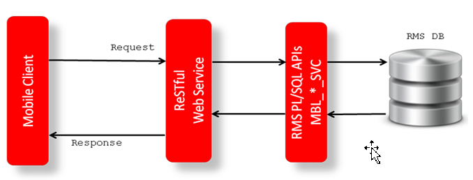

Web Service APIs Process Flow
The diagram shows the Web service API process flow.
Figure 4-4 Web Service APIs Process Flow
Surrounding text describes Figure 4-4 .

Merchandising Foundation ReST services provide visibility to a limited amount of data. Custom extensions that utilize the ReST services must ensure that any sensitive data retrieved is handled in a secure manner. Potentially sensitive data exposed by the ReST services include:
  • System options
  • Supplier data
  • Purchase Order data
  • Transfer data
