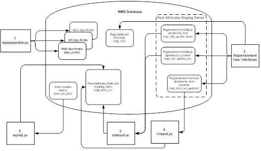

Establishment/Management of Replenishment Calculation Attributes
Many user and batch processes combine to manage replenishment calculation attributes.
  1. replsizeprofile.pc reconciles the size profiles in RMS and Allocations and refreshes the size profile materialized view used in replenishment processing.
  2. Users create or update assorted replenishment calculation attributes. Data defined by end users includes the schedule the item/location should be reviewed and item/location level attributes. Item/location level attribute changes are written to a series of Replenishment Attribute Staging Tables.
  3.  rplatupd.pc moves information from the item and location level Replenishment Attribute Staging Tables (repl_attr_update_item and repl_attr_update_loc) to the Replenishment Attributes Working Table (repl_item_loc).
  4. rilmaint.pc moves information from the item/loc level Replenishment Attribute Staging Table (repl_item_loc_updates) to the Replenishment Attributes Working Table (repl_item_loc).
  5. repladj.pc updates the Replenishment Attributes Working Table (repl_item_loc) for item/locations using the Floating Point Replenishment Method based on history.
    Figure 13-2 Managing Replenishment Calculation Attributes

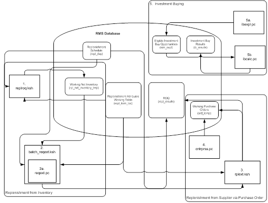

Calculation of Recommended Order Quantity (ROQ)
Many user and batch processes combine to calculate ROQ. Item/Locations follow very different paths through the calculation of ROQ depending on whether they are replenished from inventory (WH to Store via transfer) or from suppliers (via Purchase Order).
  1. replroq.ksh determines working net inventory
  2. batch_reqext.ksh multithreads reqext.pc
    1. reqext.pc uses calculated ROQ in rpl_net_inventory_tmp, franchise order quantity on store_orders, and replenishment attributes to create transfer. Adjusted ROQ is written to repl_results.
      Transfers generated by Replenishment will follow the same integration, processing and admin described in the ’Transfers, Allocations and Receiving' described in this volume. Transactions will also be published as described in Volume 2 of the Operations Guide.
  3. rplext.ksh uses replenishment attributes to determine ROQ for item/locs replenished from suppliers. ROQ is written to repl_results. Working POs are written to ord_temp.
  4. If the customer uses Contracts, contracts are evaluated by cntrprss.pc. See the chapter ’Contracts' in this guide for more information.
  5. If the customer uses Investment buying
    1. ibexpl.pc determines eligible investment buy opportunities
    2. ibcalc.pc calculates recommended investment buys that will meet the target return-on-investment
      Figure 13-3 Calculation of ROQ
      Calculation of ROQ

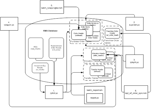

Build Transactions to Replenish Inventory
Transactions are built based on ROQ. Additional jobs optimize the resulting POs, Allocations and Transfers.
  1. rplbld.pc uses ROQ and Investment Buy Results to build Orders
  2. supcnstr.pc scales POs based on supplier constraints
  3. rplsplit.pc splits POs and Allocations to optimize truck loads
  4. rplapprv.pc approves Purchase Orders and Allocations
    Once approved, Purchase Orders and Allocations generated by Replenishment will follow the same integration, processing and Admin described in the ’Purchase Orders' and ’Transfers, Allocations and Receiving' described in this volume. Transactions will also be published as described in Volume 2 of the Operations Guide.
  5. batch_rplapprvgtax.ksh updates tax information (only necessary for GTAX implementations
    1. repl_wf_order_sync.ksh creates appropriate franchise orders for approved allocations created during replenishment
      Figure 13-4 Building Transactions to Replenish Inventory
      Transactions to Replenish Invetory

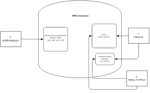

Cleanup Replenishment Data
Replenishment creates large volumes of data. Several programs exist to purge aged replenishment information. Regular purging ensures good batch performance.
Note that all tables discussed in this chapter are not purged by replenishment cleanup jobs. Many replenishment processes clean up their own working tables. The POs, transfers and allocations created by replenishment are purged in their own batch processes.
  1. rplprg.pc purges aged ROQ and investment buy results.
  2. rplahistprg.pc purges aged replenishment attribute history.
  3. rplprg_month.pc purges ROQ and investment buy results.
    Figure 13-5 Cleanup Replenishment Data

batch_reqext.ksh (Multithreading Wrapper for reqext)
Module Name batch_reqext.ksh
Description Multithreading Wrapper for reqext
Functional Area Replenishment
Module Type Admin
Module Technology ksh
Catalog ID RMS192
Runtime Parameters NA
Design Overview
The purpose of this module is to run the reqext.pc batch program multithreaded.
prepost reqext pre - create the TSFHEAD records for unique combination of Warehouse and Store, stock category, and department.
prepost reqext post – update transfer status to ’A'pproved.
Scheduling Constraints
Table 13-11 Schedulng Constraints
Schedule Information Description
Frequency
Daily
Scheduling Considerations
Sales Posting, rplatupd, rilmaint, repladj, prepost replroq and replroq need to run before reqext
rplext.ksh should run after reqext
Pre-Processing
prepost reqext pre
Post-Processing
prepost reqext post, rplext.ksh
Threading Scheme
Threaded by different partitions of RPL_NET_INVENTORY_TMP
Restart/Recovery
N/A - this script only serves as a wrapper for the batch process reqext.pc.

reqext (ROQ Calculation and Distribution for Item/Locs Replenished from WH)
Module Name reqext.pc
Description ROQ Calculation and Distribution for Item/Locs Replenished from WH
Module Type Business Processing
Module Technology ProC
Catalog ID RMS310
Design Overview
This module performs the automatic replenishment of items from warehouses to stores. It runs through every item-store combination set to be reviewed on the current day, and calculates the quantity of the item, known as the recommended order quantity (ROQ) that needs to be transferred to the store (if any). In addition, it distributes this ROQ over any applicable alternate items associated with the item.
Once the transfer quantity of an item has been calculated, transfers are created and records are written to the replenishment results table (REPL_RESULTS) based on the replenishment order control indicator.
For franchise stores, separate transfers are created based on the need date and will be linked back to a Franchise Order through the wf_order_no field.
This batch will also insert records into the respective tables for supporting the localization feature. This will be applicable only if localizations are enabled.
prepost reqext pre - Create the TSFHEAD records for unique combination of Warehouse and Store, stock category and department.
prepost reqext post – update transfer status to approved.
Table 13-13 Schedulng Constraints
Frequency
Daily
Sales Posting, rplatupd and repladj need to run before reqext
rplext should run after reqext
Pre-Processing
prepost reqext pre rplatupd and repladj
Post-Processing
Threading Scheme
Multiple processes of this program can be run at the same time, each running against a different partition of rpl_net_inventory_tmp
Restart/Recovery
The logical unit of work is an item/source warehouse. Restart/recovery is achieved implicitly because repl_item_loc records that have been processed are updated with a last review date and only records that have not been reviewed today will be picked up by the driving cursor again. Records will be committed to the database when commit_max_ctr defined in the RESTART_CONTROL table is reached. During the night run the batch processed only those store order records with delivery slot. The review dates are not updated during day run. During night all the records are processed irrespective of the delivery slots.

rplext.ksh (ROQ Calculation and Distribution for Item/Locs Replenished from Supplier
Module Name rplext.ksh
Description ROQ Calculation and Distribution for Item/Locs Replenished from Supplier
Module Technology KSH
Catalog ID RMS315
Design Overview
RPLEXT (Vendor Replenishment Extraction), which is in bulk processing logic, is the driving program for the replenishment process. It cycles through every item-location combination that is ready to be reviewed on the current day, and calculates the quantity of the item that needs to be ordered to the location. The program then writes these temporary order line items to ORD_TEMP and REPL_RESULTS. ORD_TEMP is later reviewed by the module CNTPRSS.PC in its evaluation of orders against contract types A, C, D, whereas REPL_RESULTS is processed by RPLBLD.
The wrapper script does the following things:
  • Insert records into the SVC_REPL_ROQ table and determines the thread id of each record.
  • Move the records from SVC_REPL_ROQ to SVC_REPL_ROQ_GTT table and the processed records will be inserted to ORD_TEMP and REPL_RESULTS tables.
  • prepost rpl pre – truncate records in ORD_TEMP and ORD_MISSED tables.
  • prepost rplext post – truncate records in RPL_DISTRO_TMP and RPL_ALLOC_IN_TMP table.
Table 13-15 Schedulng Constraints
Frequency
Daily
rplatupd.pc, rilmaint.pc, rpladj.pc, reqext.pc and cntrordb.pc need to run before rplext
If contracting is being used, cntrprss.pc should run after rplext.pc; otherwise, run ibexpl.pc, ibcalc.pc rplbld.pc
Pre-Processing
prepost rpl pre
Post-Processing
prepost rplext post
Threading Scheme
Multiple processes of this program can be run at the same time against different departments
Restart/Recovery
If the program fails, the program can be restarted and it will process the remaining records on SVC_REPL_ROQ table.
Locking Strategy
STORE_ORDER table records are locked while calculating ROQ.
Security Considerations

Design Overview
RPLBLD builds RMS orders from recommended order quantities (ROQ) generated by the RPLEXT.PC and IBCALC.PC processes. CNTRPRSS.PC associates contracts with the ROQs created by RPLEXT.PC. These ROQs are placed on a temporary table (ORD_TEMP or IB_RESULTS) by RPLEXT.PC and IBCALC.PC. All records on ORD_TEMP/IB_RESULTS are processed by RPLBLD each night. These ORD_TEMP/IB_RESULTS records are placed into logical groups, and a RMS order is created for each logical group.
In order to be placed in the same order group, the item/location ROQs from ORD_TEMP/IB_RESULTS must share a common supplier, have the same order_status (’W'orksheet or ’A'pproved), and be on the same contract (or not be associated with a contract). Depending on flags on the ORD_INV_MGMT table, two other criteria can be used for splitting order groups. First, if the INV_MGMT_LVL is set to ’D'ept, only items in a single department are allowed in an ordering group. Secondly, the SINGLE_LOC_IND can be set to ’Y'es. If this is the case, only one location is allowed per ordering group. Finally, a SKU may only exist in an ordering group with a single origin country. When an item/loc ROQ ORD_TEMP/IB_RESULTS record is encountered with a different origin country than the one it exists with in the current ordering group, it is placed in a different ordering group.
To assist the recalculation and order scaling processes of replenishment ROQs, the REPL_RESULTS record, associated with the ORD_TEMP being processed, is updated with the ORDER_NO and ALLOC_NO that the ORD_TEMP record was placed with. IB_RESULTS is also updated with the ORDER_NO.
If the location to be replenished is a Franchise location and the replenishment Order Control is Semi-Automatic or Automatic, Franchise POs will be created per Costing Location/Location. Associated Franchise Orders will also be created.

Runs after rplext.pc, cntrprss.pc (if contracting is being used). Runs after vrplbld and ibcalc. Runs before supcnstr
Pre-Processing
None
Post-Processing
None
Threading Scheme
This program is threaded by supplier.
Restart/Recovery
The logical unit of work is supplier, contract number, and order status. Records will be committed to the database when commit_max_ctr defined in the RESTART_CONTROL table is reached

repl_wf_order_sync.ksh (Sync Replenishment Franchise Orders
Module Name repl_wh_order_sync.ksh
Description Sync Replenishment Franchise Orders
Catalog ID RMS306
Runtime Parameters N/A
Design Overview
This module will serve as the wrapper for the package function WF_ALLOC_SQL.REPL_SYNC_F_ORDER which will check the crossdock orders created during replenishment and create franchise order records for any allocations where the destination location is a franchise store.
Table 13-31 Scheduling Constraints
Frequency
Daily
End of replenishment batch schdule
Pre-Processing
rplapprv
Post-Processing
NA
Threading Scheme
NA
Restart/Recovery
NA

rplprg (Purge Aged Replenishment Results)
Module Name rplprg.pc
Description Purge Aged Replenishment Results
Module Type Admin
Catalog ID RMS316
Design Overview
The replenishment extraction programs (RPLEXT, REQEXT) write a number of records to REPL_RESULTS. Store orders populate the STORE_ORDERS table. The investment buy process writes records to IB_RESULTS and the Buyer Worksheet Form populates BUYER_WKSHT_MANUAL. These tables hold information that is relevant to replenishment processes. Over time, records on these tables become unneeded and must be cleared out. The replenishment purge program goes through these tables and clears out those records that are older than a predetermined number of days. The purging cycles (number of days) are maintained as a system parameter.
Table 13-33 Scheduling Constraints
Frequency
Daily
NA
Pre-Processing
NA
Post-Processing
NA
Threading Scheme
NA
Restart/Recovery
Because this program performs only deletes, there is no need for restart/recovery or multithreading, and there is no driving cursor. However, this program still needs an entry on RESTART_CONTROL to determine the number of records to be deleted between commits.

rplathistprg (Purge Replenishment Attribute History)
Module Name rplathistprg.pc
Description Purge Replenishment Attribute History
Module Type Admin
Catalog ID RMS312
Design Overview
The batch will purge data from the REPL_ATTR_UPD_HIST table if it's older than the defined number of retention weeks as specified in the system parameters.
Table 13-35 Scheduling Constraints
Frequency
Weekly
This program should run at the end of the week
Pre-Processing
NA
Post-Processing
NA
Threading Scheme
NA
Restart/Recovery
NA

rplprg_month (Purge Replenishment Results History by Month)
Module Name rplprg_month.pc
Description Purge Replenishment Results History by Month
Module Type Admin
Catalog ID RMS317
Design Overview
The replenishment extraction programs (RPLEXT, REQEXT) write a number of records to REPL_RESULTS. The investment buy process writes records to IB_RESULTS and the Buyer Worksheet Form populates BUYER_WKSHT_MANUAL. These tables hold information that is relevant to replenishment processes. Over time, records on these tables become unneeded and should be cleared out. The monthly replenishment purge program goes through these tables and clears out those records that are older than a predetermined number of days (maintained in SYSTEM_OPTIONS). The eways ewInvAdjustToRMS, ewReceiptToRMS need to be shutdown when RPLPRG_MONTH.PC is run.
Table 13-37 Scheduling Constraints
Frequency
Monthly
NA
Pre-Processing
NA
Post-Processing
NA
Threading Scheme
NA
Restart/Recovery
