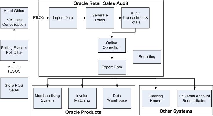

Integration with Other Applications
Oracle Retail Sales Audit interfaces with the following Oracle products:
  • Oracle Retail Merchandise System
  • Store Inventory Management
  • Oracle Retail Invoice Matching System
  • Retail Insights
This figure displays the Sales Audit interfacing products:
Figure 4-1 Oracle Retail Sales Audit Interface
Surrounding text describes Figure 4-1 .
Oracle Retail Sales Audit also interfaces with the following third-party applications:
  • Automated Clearing House.
  • Universal Account Reconciliation System.
Integration with Oracle Retail Merchandising System
Sales Audit and Merchandising share the same database. Sales Audit shares some of its master data with Merchandising. Foundation data such as items, stores, company/location close dates, location traits, bank setup, and tender types are maintained in Merchandising and used in Sales Audit.
Current reference data is retrieved from Merchandising into Sales Audit by the batch program SAGETREF. The data is extracted into multiple data files. The data in the files are used by the batch program SAIMPTLOG as reference data for doing validation checks on the POS/OMS transaction data during the data upload from POS/OMS to Sales Audit. Having the reference in data file formats increases the performance of the SAIMPTLOG process. SAGETREF generates the following reference files: Items, Wastage, Sub-transaction level items, Primary variant relationships, Promotions File, Currency File, Warehouse File, Inventory Status File, Variable weight PLU, Store business day, Code types, Error codes, Store POS, Tender type, Merchant code types, Partner vendors, Supplier vendors, Employee IDs, Banner IDs.
All clean and audited sales and returns data is extracted from Sales Audit into a POSU file by the batch program SAEXPRMS. All corrected sale and return transactions that do not have Merchandising errors are extracted into the file. The sales audit system options parameter work unit controls the export of data into file in case of presence of Merchandising errors in the POS/OMS transaction data. The shell scripts UPLOADSALES.KSH and SALESPROCESS.KSH load data from the POSU file into the RMS tables.
Integration with Xstore Point-of-Service and Order Management System
Sales, returns, and other transaction data are loaded into Sales Audit from a Point-of-Service application, such as Oracle Retail Xstore, for in-store transactions and an Order Management System, for ecommerce orders fulfilled from non-store locations. These applications should provide a standard RTLog file. The RTLog data is loaded into Sales Audit either in trickle mode or once a day. If the data is uploaded in trickle mode, then corporate inventory reflects a more accurate intra-day stock position. The data from the RTLog is loaded into Sales Audit using the batch program SAIMPTLOG for end-of-day. If trickle processing is used the final RTLog for the day must include a count of all RTLog files for the store/day.
Integration with Oracle Retail Invoice Matching
In the normal course of business, payments are made to vendors at the store level. Payments for merchandise purchases done at store level are booked against a corresponding merchandise invoice. Payments of non-merchandise purchases or miscellaneous services availed at the store are booked against a corresponding non-merchandise invoice. These transactions are passed from the POS/OMS to Sales Audit as specially designated PAID OUT transactions (sub-transaction type of EV - Expense Vendor or MV - Merchandise Vendor). All these invoices are assumed paid. The batch program SAEXPIM transfers the PAID OUT type of transactions to the Invoice Matching staging tables.
The batch program SAEXPIM is also used for escheatment processing. Unclaimed monies of outstanding, non-expiring vouchers are totaled after a defined period of time from the date of issuance of the voucher and posted to the Invoice Matching staging tables as a non-merchandise invoice by SAEXPIM. The unclaimed amount is paid out as income to the issuing Retailer. In some U.S. states, it is paid out to the state (based on configuration). ReSA determines who receives this income and accordingly posts a non-merchandise invoice for the partner. These invoices are assumed not paid.
The batch job EDIDLINV is used to extract the invoices from the Oracle Retail Invoice Matching staging tables and load as EDI invoices to Invoice Matching.
Integration with General Ledger
The batch program SAEXPGL transfers the sales data from Sales Audit into the financial staging tables in Merchandising. This batch program executes only if the external financial system is set to O (for other), E-Business Suite, or some other external financial application based on system options configuration.
SAEXPGL directly inserts the data into financial stage tables of Merchandising.
Integration with Automated Clearing House
Sales Audit determines the estimated bank deposit for each store/day. The batch program SAEXPACH posts the store/day deposits into a database table and creates the standard ACH format file. The output file is sent to a Clearing House. The output file conforms to the requirements imposed by the National Automated Clearing House Association (NACHA). The nature of the ACH process is such that as much money as possible must be sent as soon as possible to the consolidating bank. Any adjustments to the amount sent can be made front-end. This batch assumes that there is only one total to be exported for ACH per store/day.
Integration with Universal Account Reconciliation Solution
The batch program SAEXPUAR extracts specified TOTALS to a flat file that is interfaced to an account reconciliation application. For each store day, all specified totals are posted to their appropriate output files. All the stores and totals with usage type starting with UAR are exported.
Integration with Store Inventory Management
Sales Audit sends audited data to SIM which helps SIM to be synchronized with Merchandising with respect to inventory levels. The batch program SAEXPSIM extracts information from transactions with changed item quantities, item deletions, item addition, change in item status to VOID, and change in transaction status to PVOID. This information in the form of a file (SIMT) is uploaded and processed by SIM.
