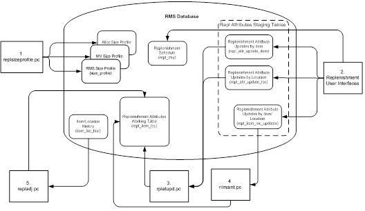

Many user and batch processes combine to manage replenishment calculation attributes.
replsizeprofile.pc reconciles the size profiles in RMS and Allocations and refreshes the size profile materialized view used in replenishment processing.
Users create or update assorted replenishment calculation attributes. Data defined by end users includes the schedule the item/location should be reviewed and item/location level attributes. Item/location level attribute changes are written to a series of Replenishment Attribute Staging Tables.
rplatupd.pc moves information from the item and location level Replenishment Attribute Staging Tables (repl_attr_update_item and repl_attr_update_loc) to the Replenishment Attributes Working Table (repl_item_loc).
rilmaint.pc moves information from the item/loc level Replenishment Attribute Staging Table (repl_item_loc_updates) to the Replenishment Attributes Working Table (repl_item_loc).
repladj.pc updates the Replenishment Attributes Working Table (repl_item_loc) for item/locations using the Floating Point Replenishment Method based on history.

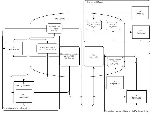

Many user and batch processes combine to calculate ROQ. Item/Locations follow very different paths through the calculation of ROQ depending on whether they are replenished from inventory (WH to Store via transfer) or from suppliers (via Purchase Order).
replroq.ksh determines working net inventory
batch_reqext.ksh multithreads reqext.pc
reqext.pc uses calculated ROQ in rpl_net_inventory_tmp, franchise order quantity on store_orders, and replenishment attributes to create transfer. Adjusted ROQ is written to repl_results.
 Note: Transfers generated by Replenishment will follow the same integration, processing and admin described in the ’Transfers, Allocations and Receiving' described in this volume. Transactions will also be published as described in Volume 2 of the Operations Guide. |
rplext.ksh uses replenishment attributes to determine ROQ for item/locs replenished from suppliers. ROQ is written to repl_results. Working POs are written to ord_temp.
If the customer uses Contracts, contracts are evaluated by cntrprss.pc. See the chapter ’Contracts' in this guide for more information.
If the customer uses Investment buying
ibexpl.pc determines eligible investment buy opportunities
ibcalc.pc calculates recommended investment buys that will meet the target return-on-investment

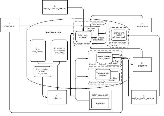

Transactions are built based on ROQ. Additional jobs optimize the resulting POs, Allocations and Transfers.
rplbld.pc uses ROQ and Investment Buy Results to build Orders
supcnstr.pc scales POs based on supplier constraints
rplsplit.pc splits POs and Allocations to optimize truck loads
rplapprv.pc approves Purchase Orders and Allocations
 Note: Once approved, Purchase Orders and Allocations generated by Replenishment will follow the same integration, processing and Admin described in the ’Purchase Orders' and ’Transfers, Allocations and Receiving' described in this volume. Transactions will also be published as described in Volume 2 of the Operations Guide. |
batch_rplapprvgtax.ksh updates tax information (only necessary for GTAX implementations
repl_wf_order_sync.ksh creates appropriate franchise orders for approved allocations created during replenishment

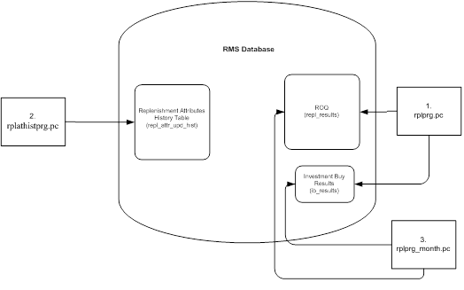

Replenishment creates large volumes of data. Several programs exist to purge aged replenishment information. Regular purging ensures good batch performance.
 Note: Note that all tables discussed in this chapter are not purged by replenishment cleanup jobs. Many replenishment processes clean up their own working tables. The POs, transfers and allocations created by replenishment are purged in their own batch processes. |
rplprg.pc purges aged ROQ and investment buy results.
rplahistprg.pc purges aged replenishment attribute history.
rplprg_month.pc purges ROQ and investment buy results.

This module performs the bulk of the logic to process and persist the replenishment data into RPL_NET_INVENTORY_TMP table. (The information on this table is extracted by reqext batch program.)
The wrapper script does the following things:
Insert records into the SVC_REPL_ROQ table and determines the thread id of each record.
Move the records from SVC_REPL_ROQ to SVC_REPL_ROQ_GTT table and will calculate the net inventory position and determine the ROQ of items which are on replenishment.
Prepost replroq pre – truncate records in RPL_NET_INVENTORY_TMP tables and build RPL_DISTRO_TMP and RPL_ALLOC_IN_TMP tables.

The purpose of this module is to run the reqext.pc batch program multithreaded.
prepost reqext pre - create the TSFHEAD records for unique combination of Warehouse and Store, stock category, and department.
prepost reqext post – update transfer status to ’A'pproved.

This module performs the automatic replenishment of items from warehouses to stores. It runs through every item-store combination set to be reviewed on the current day, and calculates the quantity of the item, known as the recommended order quantity (ROQ) that needs to be transferred to the store (if any). In addition, it distributes this ROQ over any applicable alternate items associated with the item.
Once the transfer quantity of an item has been calculated, transfers are created and records are written to the replenishment results table (REPL_RESULTS) based on the replenishment order control indicator.
For franchise stores, separate transfers are created based on the need date and will be linked back to a Franchise Order through the wf_order_no field.
This batch will also insert records into the respective tables for supporting the localization feature. This will be applicable only if localizations are enabled.
prepost reqext pre - Create the TSFHEAD records for unique combination of Warehouse and Store, stock category and department.
prepost reqext post – update transfer status to approved.

RPLEXT (Vendor Replenishment Extraction), which is in bulk processing logic, is the driving program for the replenishment process. It cycles through every item-location combination that is ready to be reviewed on the current day, and calculates the quantity of the item that needs to be ordered to the location. The program then writes these temporary order line items to ORD_TEMP and REPL_RESULTS. ORD_TEMP is later reviewed by the module CNTPRSS.PC in its evaluation of orders against contract types A, C, D, whereas REPL_RESULTS is processed by RPLBLD.
Move the records from SVC_REPL_ROQ to SVC_REPL_ROQ_GTT table and the processed records will be inserted to ORD_TEMP and REPL_RESULTS tables.
prepost rpl pre – truncate records in ORD_TEMP and ORD_MISSED tables.
prepost rplext post – truncate records in RPL_DISTRO_TMP and RPL_ALLOC_IN_TMP table.

| Module Name | ibexpl.pc |
| Description | Determines Eligible Investment Buy Opportunities |
| Functional Area | Investment Buy |
| Module Type | Business Processing |
| Module Technology | ProC |
| Catalog ID | RMS250 |
| Runtime Parameters | NA |
The ibexpl batch program pre-qualifies investment buy (IB) eligible wh/dept and IB eligible supp/dept/locs.
The WH_DEPT table holds IB parameters at the WH or at the wh/dept level. If there are IB parameters defined at the wh/dept level, they are used. If there are no IB parameters defined at the wh/dept level, the IB parameters at the WH level are used. If IB parameters are not defined at either level, then system level IB parameters are used. The first part of this program sends IB parameters to the wh/dept level no matter what level they are held at in the database. The results are written to the WH_DEPT_EXPL table.
Next the WH_DEPT_EXPL table is combined with supplier inventory management data to get the final list of all eligible sup/dept/locs. The supplier inventory management data determines whether or not a given sup/dept/loc combo is IB eligible.

The ibcalc.pc batch program is the calculation engine for investment buy processing. It identifies investment buy (IB) opportunities and calculates recommended order quantities (ROQs) that will meet the target return-on-investment (ROI)
This module will calculate forward buy opportunities using:
Carrying costs
Ordering parameters
Deals – future and expiring
Cost changes – future
Forecasts
Inventory levels
Target ROI (return on investment)
The deals and cost change components will be contained on a FUTURE_COST table. This table will hold a record for each future date that has a costing event (for example, a cost change, deal activation/deactivation). This process utilizes the default costing bracket and default deal thresholds in the calculations.
Prepost ibcalc pre – set ib_results.status from ’W' (worksheet) to ’U' (unprocessed).

RPLBLD builds RMS orders from recommended order quantities (ROQ) generated by the RPLEXT.PC and IBCALC.PC processes. CNTRPRSS.PC associates contracts with the ROQs created by RPLEXT.PC. These ROQs are placed on a temporary table (ORD_TEMP or IB_RESULTS) by RPLEXT.PC and IBCALC.PC. All records on ORD_TEMP/IB_RESULTS are processed by RPLBLD each night. These ORD_TEMP/IB_RESULTS records are placed into logical groups, and a RMS order is created for each logical group.
In order to be placed in the same order group, the item/location ROQs from ORD_TEMP/IB_RESULTS must share a common supplier, have the same order_status (’W'orksheet or ’A'pproved), and be on the same contract (or not be associated with a contract). Depending on flags on the ORD_INV_MGMT table, two other criteria can be used for splitting order groups. First, if the INV_MGMT_LVL is set to ’D'ept, only items in a single department are allowed in an ordering group. Secondly, the SINGLE_LOC_IND can be set to ’Y'es. If this is the case, only one location is allowed per ordering group. Finally, a SKU may only exist in an ordering group with a single origin country. When an item/loc ROQ ORD_TEMP/IB_RESULTS record is encountered with a different origin country than the one it exists with in the current ordering group, it is placed in a different ordering group.
To assist the recalculation and order scaling processes of replenishment ROQs, the REPL_RESULTS record, associated with the ORD_TEMP being processed, is updated with the ORDER_NO and ALLOC_NO that the ORD_TEMP record was placed with. IB_RESULTS is also updated with the ORDER_NO.
If the location to be replenished is a Franchise location and the replenishment Order Control is Semi-Automatic or Automatic, Franchise POs will be created per Costing Location/Location. Associated Franchise Orders will also be created.

| Module Name | supsplit.pc |
| Description | Split Replenishment Orders Among Suppliers |
| Functional Area | Replenishment |
| Catalog ID | RMS370 |
This program splits replenishment orders among different suppliers based on the supplier distribution ratio setup for an item/location on replenishment. It only applies to Direct to Store and Crossdock replenishments where a purchase order will be created from a supplier.
Table 13-23 Scheduling Constraints
| Schedule Information | Description |
 Frequency  |
 Daily  |
 Scheduling Considerations  |
 This program will run nightly after the vendor replenishment extraction program (rplext.pc) and before the contract replenishment program (cntrprss.pc)  |
 Pre-Processing  |
 rplext.pc prepost supsplit pre  |
 Post-Processing  |
 cntrprss.pc  |
 Threading Scheme  |
 Thread by department  |
The logical unit of work for this program is set at item level. Records will be committed to the database when commit_max_ctr defined in the RESTART_CONTROL table is reached.
| Module Name | rplsplit.pc |
| Description | Truck Splitting Optimization for Replenishment |
| Catalog ID | RMS318 |
The purpose of this program is to select all the orders eligible for truck splitting, which are created by the replenishment programs. The orders that are eligible will be sent into the truck splitting logic and the resulting orders will be created.
The orders, which will be eligible for splitting, are as follows:
The order must have been created today by replenishment with ord_inv_mgmt.ord_approve_ind = ’Y'.
The order must not have been already split.
The order must be a single location order and the location must be a warehouse.
The order must not have any allocations associated.
Orders will only be split if they meet criteria for splitting as defined in the supplier inventory management parameters.
Table 13-25 Scheduling Constraints
 Frequency  |
 Daily  |
 This program will run nightly after the replenishment-scaling program (supcnstr.pc) and before the replenishment approval program (rplapprv.pc)  |
 Pre-Processing  |
 supcnstr.pc  |
 Post-Processing  |
 rplapprv.pc  |
 Threading Scheme  |
 Thread by supplier  |
The logical unit of work for this program is set at order level. Records will be committed to the database when commit_max_ctr defined in the RESTART_CONTROL table is reached.

| Module Name | rplapprv.pc |
| Description | Approve Replenishment Orders |
| Catalog ID | RMS300 |
This program looks at all replenishment, vendor and contract orders created during the nightly batch run to determine if they can be approved. These orders are compared with any vendor minimums that may exist. Orders that do not meet the vendor minimums are either deleted or placed in worksheet status. A flag, held at the supplier inventory management level (ORD_INV_MGMT.ORD_PURGE_IND), determines what action is taken on orders that fail minimums. Vendor generated orders are not subject to these minimum checks.
Vendor minimums can be held at the order, item, or location level. Order and location level minimums are held on the SUP_INV_MGMT table. There is a flag that determines if they are applied at the order level or at the location level. Vendor minimums at the SKU level are held on the ITEM_SUPP_COUNTRY table.
When the ORD_INV_MGMT.ORD_PURGE_IND is ’N', a failure at any level causes the order to be placed in worksheet status. When the ORD_INV_MGMT.ORD_PURGE_IND is ’Y', a failure at the location level causes the offending location to be deleted; a failure at the SKU level causes the problematic SKU to be deleted; and a failure at the order level caused the entire order to be deleted.
For any orders that fail vendor minimums when the ORD_INV_MGMT.ORD_PURGE_IND is ’Y', a record is written to the SUPS_MIN_FAIL table for reporting purposes. This table is purged during the pre-processing of this batch program.
After order records are updated, any applicable deals, brackets and allowances are applied to the orders by subsequent processes. Open to buy is then updated for any orders built in approved status. If any orders are contract orders, the contract amounts are updated as well to reflect any order record deletions.
If any orders are Franchise POs, the associated Franchise Orders are also approved if they pass the credit check. If they fail the credit check, both Franchise POs and orders will remain in Worksheet.
An order may not pass vendor minimum checks assuming that the vendor minimum checks are performed for a physical WH. If the vendor minimum is not met for a physical location, all the virtual WHs on the order within the physical WH will need to be removed along with associated allocations.
Prepost rplapprv pre – truncates sups_min_fail table
Table 13-27 Scheduling Constraints
 Frequency  |
 Daily  |
 This program should run directly after the replenishment supcnstr.pc program. It is important that this program runs before any other process affects the generated orders. The script batch_rplapprvgtax.ksh should also run immediately after this program to ensure that taxes are computed for the approved replenishment orders in a global tax configuration  |
 Pre-Processing  |
 Prepost rplapprv pre  |
 Post-Processing  |
 batch_rplapprvgtax.ksh (when GTAX)  |
 Threading Scheme  |
 NA  |
The logical unit of work is order number. Records will be committed to the database when commit_max_ctr defined in the RESTART_CONTROL table is reached.

| Module Name | batch_rplapprvgtax.ksh |
| Description | Update Replenishment Order Taxes |
| Module Technology | ksh |
| Catalog ID | RMS194 |
This script calls the TAX_THREAD_SQL.LOAD_REPL_ORDER_TAX_BREAKUP to enable parallel execution via multiple thread calls to the L10N_BR_INT_SQL.LOAD_ORDER_TAX_OBJECT function to compute taxes for approved replenishment orders. Computed taxes are inserted/updated into the ORD_TAX_BREAKUP table.
This batch should be run only for Global Tax (GTAX) configuration.

| Module Name | repl_wh_order_sync.ksh |
| Description | Sync Replenishment Franchise Orders |
| Catalog ID | RMS306 |
| Runtime Parameters | N/A |
This module will serve as the wrapper for the package function WF_ALLOC_SQL.REPL_SYNC_F_ORDER which will check the crossdock orders created during replenishment and create franchise order records for any allocations where the destination location is a franchise store.

| Module Name | rplprg.pc |
| Description | Purge Aged Replenishment Results |
| Module Type | Admin |
| Catalog ID | RMS316 |
The replenishment extraction programs (RPLEXT, REQEXT) write a number of records to REPL_RESULTS. Store orders populate the STORE_ORDERS table. The investment buy process writes records to IB_RESULTS and the Buyer Worksheet Form populates BUYER_WKSHT_MANUAL. These tables hold information that is relevant to replenishment processes. Over time, records on these tables become unneeded and must be cleared out. The replenishment purge program goes through these tables and clears out those records that are older than a predetermined number of days. The purging cycles (number of days) are maintained as a system parameter.
Because this program performs only deletes, there is no need for restart/recovery or multithreading, and there is no driving cursor. However, this program still needs an entry on RESTART_CONTROL to determine the number of records to be deleted between commits.
| Module Name | rplathistprg.pc |
| Description | Purge Replenishment Attribute History |
| Catalog ID | RMS312 |
The batch will purge data from the REPL_ATTR_UPD_HIST table if it's older than the defined number of retention weeks as specified in the system parameters.
| Module Name | rplprg_month.pc |
| Description | Purge Replenishment Results History by Month |
| Catalog ID | RMS317 |
