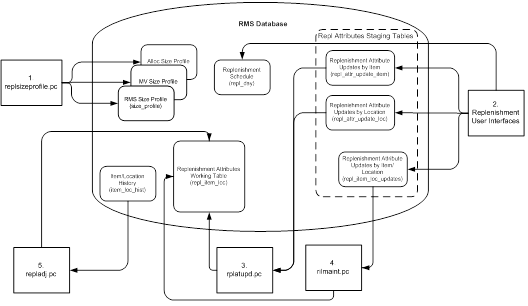

Establishment/Management of Replenishment Calculation Attributes
Many user and batch processes combine to manage replenishment calculation attributes.
  1. replsizeprofile.pc reconciles the size profiles in RMS and Allocations and refreshes the size profile materialized view used in replenishment processing.
  2. Users create or update assorted replenishment calculation attributes. Data defined by end users includes the schedule the item/location should be reviewed and item/location level attributes. Item/location level attribute changes are written to a series of Replenishment Attribute Staging Tables.
  3.  rplatupd.pc moves information from the item and location level Replenishment Attribute Staging Tables (repl_attr_update_item and repl_attr_update_loc) to the Replenishment Attributes Working Table (repl_item_loc).
  4. rilmaint.pc moves information from the item/loc level Replenishment Attribute Staging Table (repl_item_loc_updates) to the Replenishment Attributes Working Table (repl_item_loc).
  5. repladj.pc updates the Replenishment Attributes Working Table (repl_item_loc) for item/locations using the Floating Point Replenishment Method based on history.
    Figure 13-2 Managing Replenishment Calculation Attributes

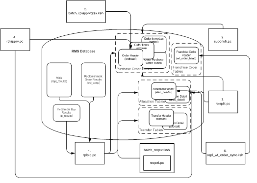

Build Transactions to Replenish Inventory
Transactions are built based on ROQ. Additional jobs optimize the resulting POs, Allocations and Transfers.
  1. rplbld.pc uses ROQ and Investment Buy Results to build Orders
  2. supcnstr.pc scales POs based on supplier constraints
  3. rplsplit.pc splits POs and Allocations to optimize truck loads
  4. rplapprv.pc approves Purchase Orders and Allocations
    Once approved, Purchase Orders and Allocations generated by Replenishment will follow the same integration, processing and Admin described in the ’Purchase Orders' and ’Transfers, Allocations and Receiving' described in this volume. Transactions will also be published as described in Volume 2 of the Operations Guide.
  5. batch_rplapprvgtax.ksh updates tax information (only necessary for GTAX implementations
    1. repl_wf_order_sync.ksh creates appropriate franchise orders for approved allocations created during replenishment
      Figure 13-4 Building Transactions to Replenish Inventory
