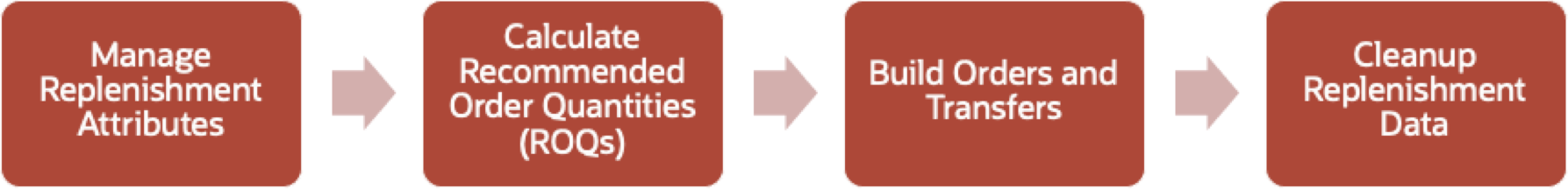

Replenishment Sub Processes
Replenishment can be divided into four major sub-processes:

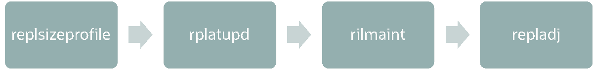

Manage Replenishment Attributes
Manage Replenishment Attributes Process Flow
Replenishment attributes are set up for item/locations, or higher levels, using the Merchandising UI or uploaded from an external system using one of the supported integration methods. Attribute updates managed at levels higher than item/location or that are scheduled for future updates require backend processing to help manage the updates. Additionally, for some methods or configurations, there is other supporting data that requires batch processes to periodically refresh data, including that for size profiles and maximums for Floating Point replenishment.

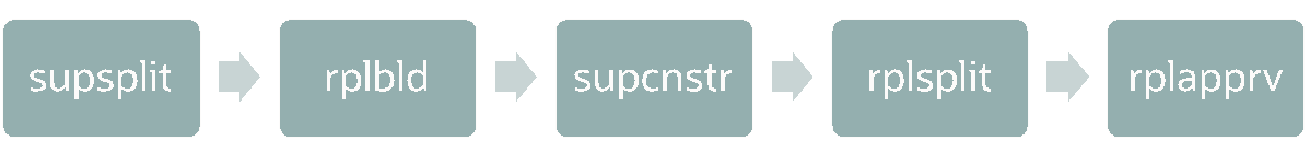

Build Orders and Transfers
This section of programs create purchase orders and transfers based on the calculated ROQs.
Additional batch processes that may apply for this section of batches, depending on your implementation:
