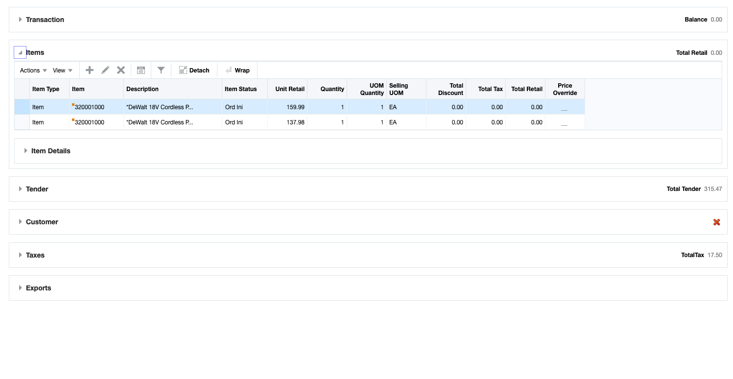

Balancing Customer Order Transactions
When balancing transactions that contain line items using the item statuses Order Initiate (ORI), Order Complete (ORD), or Order Cancel (ORC), there are some differences from regular sales transactions, as the extended item retail value for items of this status will always be 0. The balancing equation used is as follows:
Balance = Tender - (Payment + Item Total + Tax Total)
The below images show an example of what this might look like in a transaction.
Balance Customer Order Transaction
