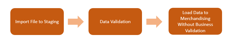

Item Direct Load
For cases when a large volume of items is to be converted in a very constrained timeline, then the item direct load approach can be considered. This approach is devoid of all the business validations, but it can verify database integrity constraint errors, by loading items from staging to the main Merchandising tables without undergoing business validations.
As previously described in this document, business validations are critical in establishing that converted data adheres to key Merchandising and Pricing validations. It also gives an opportunity to capture data integrity errors prior to the data load to main Merchandising tables. Although, it is not recommended to use this option during cut-over migration, skipping business validation during later mock cycles, once you have confidence in your legacy transformation processes, may be useful when you are on a tight data conversion schedule. This should be used only once the initial mock runs using item entity have confirmed the quality of input data and necessary corrections have been made at the source. It is your responsibility to make the decision on whether this option to be used during item conversion or not.
Item Load Process
Key Considerations
  • The file structure for the ITEM_DIRECT_LOAD and ITEM entities are generally similar, apart from a few additional files required for the ITEM_DIRECT_LOAD entity. The file names and staging tables can be found through the Entity Sequence List screen in the Data Conversion tool.
  • By default, triggers publishing to MFQUEUE tables are temporarily disabled for item entities with an intent to enhance overall load performance. For this default setting, you will need to import ITEM_PUB_INFO table during conversion.
  • This approach requires thorough testing of converted data to ensure the data is free from errors and it provides smooth batch processing later on.
  • You are required to provide default values in the tables that are otherwise auto populated during the full validation method, if you would have chosen the normal item load.
