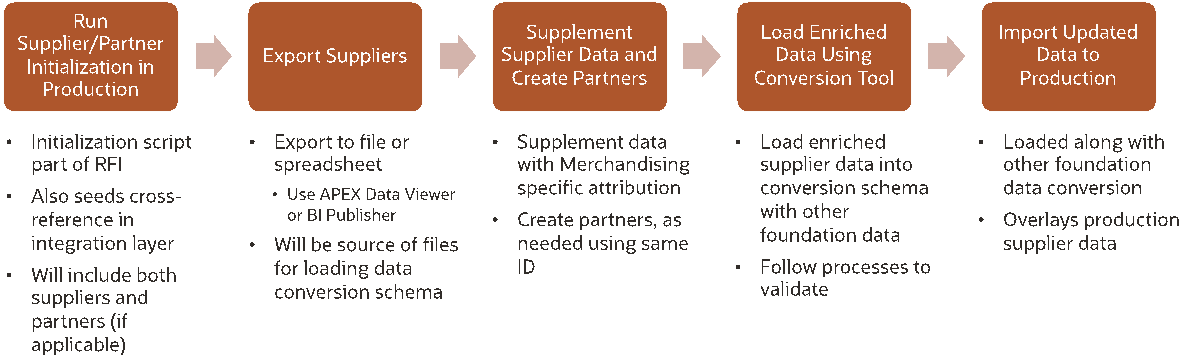

If integrating with a financials solution, a slightly different process for converting is recommended based on the dependency for financials as part of the creation process. The diagram below outlines the recommended process.
Process for Integrating with Financials Solution
It is recommended you start with setting up these parties in financials and integrate them to the production version of Merchandising as a way to convert the financials owned data into the solutionFoot 1 . Oracle Retail Financial Integration (RFI) has a seeding process that is used for this purpose. This also means that any dependent data for suppliers, like org units, freight terms, and payment terms, should be loaded into production. This could be done using either spreadsheet upload or the data conversion tool.
Loading the suppliers and partners from financials into production directly will generate the cross references and Merchandising IDs needed for these entities, however there still will be some Merchandising specific attributes you will need to configure, as well as you will need to copy the entities that are really partners to their own table.
For suppliers, the recommended approach would be to use the APEX Data Viewer functionalityFoot 2  to query the supplier table to extract the data that was loaded from financials and use this data as a basis to build the conversion data dat files for both suppliers and supplier sites. The same IDs should be used in conversion to reload these suppliers, but they can have the retail specific data added as well.
For partners, the recommended approach also is to extract the data from the production supplier table and use the data to convert into the partner table. The same IDs should also be loaded into the partner table in Merchandising, along with the attribution from Financials and any new attribution that is retail specific as part of the conversion.
For both of these entities, when the converted data is promoted to production, it will overwrite the data in the Merchandising tables, but the key data setup in the cross references would still be accurate and now the data would include the retail specific attributes as well.

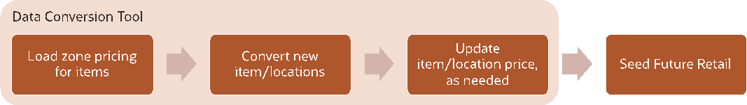

Price History Load initial record with a tran type of 0 on this table for the item with a location of 0 using the Price Hist entity. Location-level records added in the item/location ranging are described below.
Item Zone Price The zone-level pricing details will be used by the item/location ranging process described below to default the regular retail price for the item/location combinations if the retail price is not provided in the input file. If any retails need to be corrected, or if any of the items are on clearance, the selling retail price at the item/location combinations will need to be updated after converting zone pricing and item/location ranging. See also the "Pricing" section below for details on seeding clearance events and future retail.
Item/Location Ranging To associate stores and warehouses with your items as part of conversion, use the Item Ranging entity. Pricing for your location can be provided in the input file during the item/location ranging process. If unit retail is not specified, it will default based on the zone pricing. This will take care of inserting records for the following entities in Merchandising:
Item Location (ITEM_LOC)
Item Location Stock on Hand (ITEM_LOC_SOH)Foot 1
Item Supplier Country Location (ITEM_SUPP_COUNTRY_LOC)
Future Cost (FUTURE_COST)
Price History (PRICE_HIST) for tran type 0
It is assumed that only active item/location combinations will be converted.
Update Item/Location Pricing for your location will be established by the item/location ranging process as described above. As needed, you can use this entity to update those values. This also includes setting of the clearance flag and selling unit retail for items on clearance at the time of conversion, as needed. If you update the item/location level price you will also want to add a row in the Price History table for the new price as well. See the "Pricing" section below for more on initializing items on clearance within the Pricing Cloud Service.

First, you will need to seed the Future Retail table to establish the initial retail prices that were included as part of your item/location conversion.
Seed Future Retail Table Process
The diagram above shows how the steps that were performed in the data conversion tool are used as a basis for this process. Seeding the future retail values will be done by executing the DC_RPM_SEED_FUTURE_RETAIL task from the System Administration screen in the data conversion tool. It is required that this be run after your foundation data and item data is loaded, but before your conversion of stock on hand and stock ledger. This will establish seed records in Pricing for all active item/locations in the system at the time the conversion is run. The task is intended to run a single time, and should be run after the Item Location conversion has been validated. The task looks directly at the ITEM_LOC table to determine the records to be processed.
