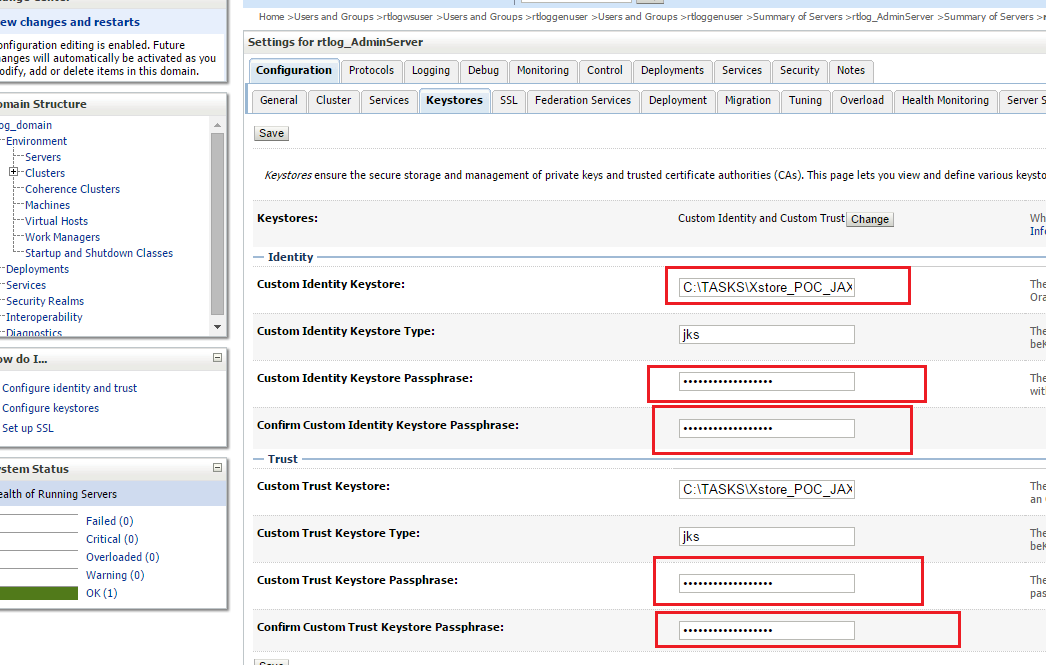

    • Pass a JVM argument to the server startup script and bounce the server:
      -Drtloggen.config.dir=C:/<custom_directory>/
      If the WebLogic domain is created with a Node manager, the same argument can be passed from the Administration Console in the Arguments field. See Figure 6-1.
      Figure 6-1 Administration Console Configuration Page
      This image shows the WebLogic Server Administration Console.
    • Specify the context-param field in the RTLog Generator WAR file. This requires opening up the WAR file and making the required changes. Update the web.xml file as shown in the following example:
      <context-param>
          <param-name>rtlog.generator.config.home</param-name>
          <param-value>C:/<custom_directory>/</param-value>
      </context-param>
      Figure 6-2 Example of context-param Field Update
      This image shows an example of a context-param field update.
      The JVM argument takes the precedence over the default location, that is, C:\<rtlog-gen-config>. If either of the two does not exist, the context parameter is used. If nothing is specified, the RTLog Generator application will fail on startup with error messages in the server logs.

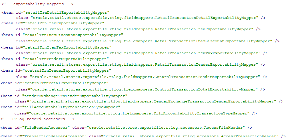

    • RTLogMappingBean.xml:
      This is a spring configuration XML file that provides metadata for the FieldMapper and Record Accessor beans which get injected into the RTLog Generator business logic classes. The following example is an excerpt from this file:
      Figure 6-3 RTLogMappingBean.xml File Excerpt
      Image shows an excerpt from the RTLogMappingBean.xml file

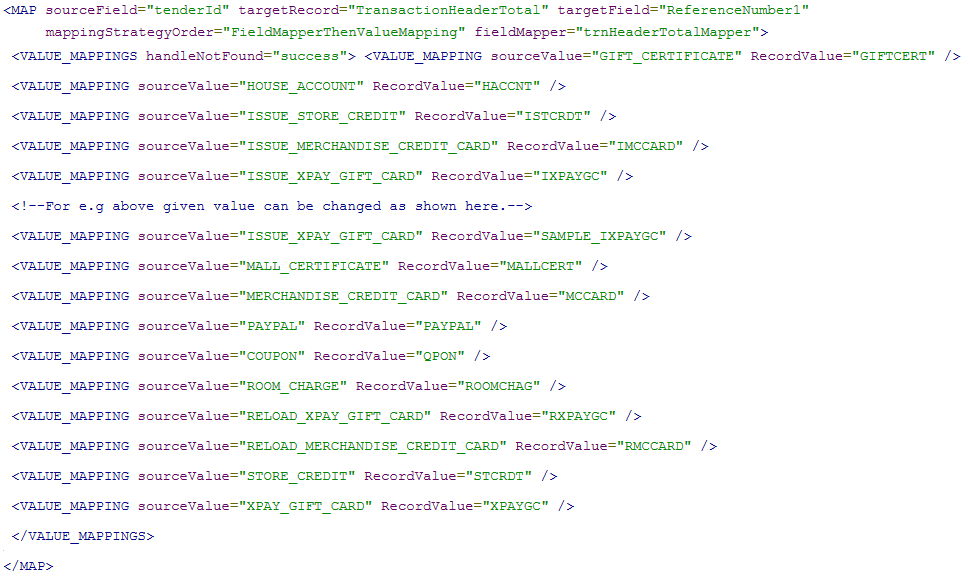

    • RTLogMappingConfig.xml:
      The RTLog Generator application relies heavily on the XML-based mapping which provides extensibility and a way to maintain/upgrade features for the application. This file can be used to override all the field values for either mapping strategy:
      • FieldMapperThenValueMapping: The RecordValue attribute values as shown in the following example can be changed:
        <MAP sourceField="tenderId" targetRecord="TransactionHeaderTotal" targetField="ReferenceNumber1" mappingStrategyOrder="FieldMapperThenValueMapping" fieldMapper="trnHeaderTotalMapper">
         <VALUE_MAPPINGS handleNotFound="success"> <VALUE_MAPPING sourceValue="GIFT_CERTIFICATE" RecordValue="GIFTCERT" />
         <VALUE_MAPPING sourceValue="HOUSE_ACCOUNT" RecordValue="HACCNT" />
         <VALUE_MAPPING sourceValue="ISSUE_STORE_CREDIT" RecordValue="ISTCRDT" />
         <VALUE_MAPPING sourceValue="ISSUE_MERCHANDISE_CREDIT_CARD" RecordValue="IMCCARD" />
         <VALUE_MAPPING sourceValue="ISSUE_XPAY_GIFT_CARD" RecordValue="IXPAYGC" />
         <!--For e.g above given value can be changed as shown here.-->
         <VALUE_MAPPING sourceValue="ISSUE_XPAY_GIFT_CARD" RecordValue="SAMPLE_IXPAYGC" />
         <VALUE_MAPPING sourceValue="MALL_CERTIFICATE" RecordValue="MALLCERT" />
         <VALUE_MAPPING sourceValue="MERCHANDISE_CREDIT_CARD" RecordValue="MCCARD" />
         <VALUE_MAPPING sourceValue="PAYPAL" RecordValue="PAYPAL" />
         <VALUE_MAPPING sourceValue="COUPON" RecordValue="QPON" />
         <VALUE_MAPPING sourceValue="ROOM_CHARGE" RecordValue="ROOMCHAG" />
         <VALUE_MAPPING sourceValue="RELOAD_XPAY_GIFT_CARD" RecordValue="RXPAYGC" />
         <VALUE_MAPPING sourceValue="RELOAD_MERCHANDISE_CREDIT_CARD" RecordValue="RMCCARD" />
         <VALUE_MAPPING sourceValue="STORE_CREDIT" RecordValue="STCRDT" />
         <VALUE_MAPPING sourceValue="XPAY_GIFT_CARD" RecordValue="XPAYGC" />
         </VALUE_MAPPINGS>
        </MAP>
        Figure 6-4 RTLogMappingConfig.xml Field Mapper Example 1
        Example 1 of the RTLogMappingConfig.xml field mapper

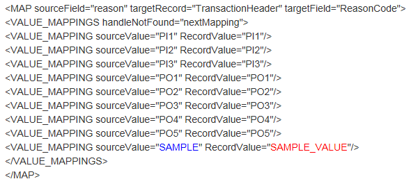

      • No mappingStrategyOrder and fieldMapper attributes are defined: The RecordValue attribute values shown in the following example can be changed or a new value can be added:
        <MAP sourceField="reason" targetRecord="TransactionHeader" targetField="ReasonCode">
         <VALUE_MAPPINGS handleNotFound="nextMapping">
         <VALUE_MAPPING sourceValue="PI1" RecordValue="PI1"/>
         <VALUE_MAPPING sourceValue="PI2" RecordValue="PI2"/>
         <VALUE_MAPPING sourceValue="PI3" RecordValue="PI3"/>
         <VALUE_MAPPING sourceValue="PO1" RecordValue="PO1"/>
         <VALUE_MAPPING sourceValue="PO2" RecordValue="PO2"/>
         <VALUE_MAPPING sourceValue="PO3" RecordValue="PO3"/>
         <VALUE_MAPPING sourceValue="PO4" RecordValue="PO4"/>
         <VALUE_MAPPING sourceValue="PO5" RecordValue="PO5"/>
        <VALUE_MAPPING sourceValue="SAMPLE" RecordValue="SAMPLE_VALUE"/>
         </VALUE_MAPPINGS>
         </MAP>
        Figure 6-5 RTLogMappingConfig.xml Field Mapper Example 2
        Example 2 of the RTLogMappingConfig.xml field mapper

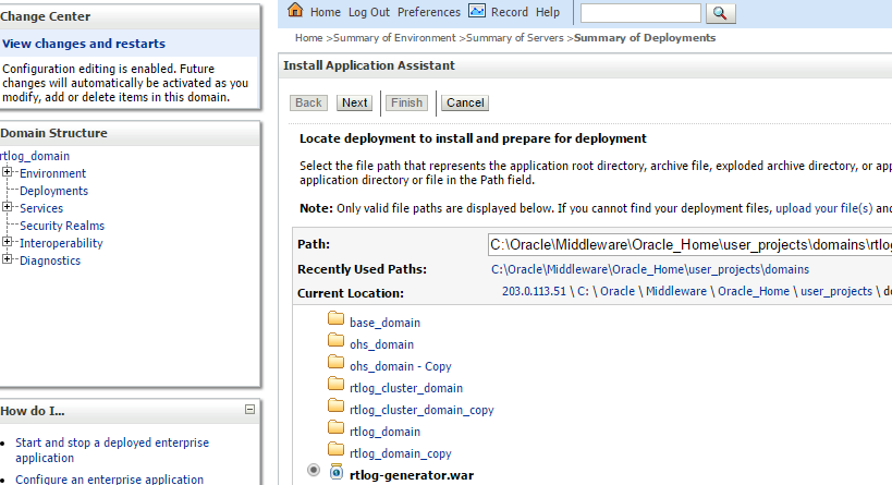

  1. Log in to the WebLogic 12 Server Administration Console (http://<hostName>:<port>/console).
  2. Click the Deployment link from the left navigation menu.
  3. Click Install.

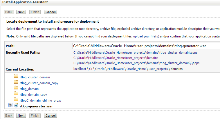

  4. Navigate to the rtlog-generator.war file directory. Select the rtlog-generator.war option.
    Figure 6-8 Administration Console Install Application Assistant Page
    Administration Console Install Application Assistant page

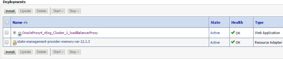

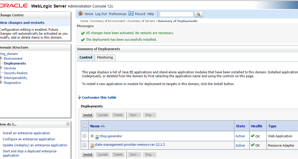

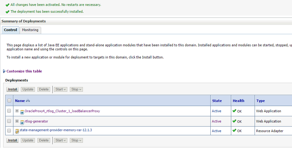

  5. Click Next and then Finish. Once deployed, RTLog Generator should be listed as one of the deployed applications as shown in Figure 6-9.
    Figure 6-9 Administration Console Summary of Deployments
    Administration Console Summary of Deployments page

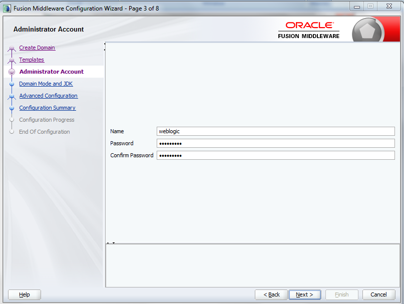

  4. On the Administrator Account page, enter the Administrator user name and password. Enter the password a second time to confirm. Click Next.
    Figure 6-12 Configuration Wizard Administrator Account Page
    Configuration Wizard Administrator Account page.

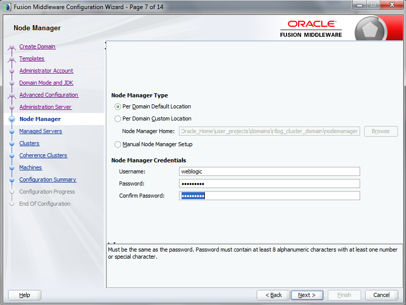

  8. On the Node Manager page, do not change the default node manager settings. For the credentials, enter weblogic as the user name and enter the password. Click Next.
    Figure 6-16 Configuration Wizard Node Manager Page

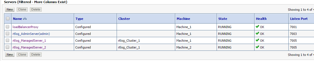

  9. On the Managed Servers page, add and configure each managed server:
    1. For the listen address, enter the IP address of the managed server. Do not select All local Addresses.
    2. rtlog_ManagedServer_1 will be running on Machine_1 in this configuration. Enter the Machine_1 IP address for the server.
    3. rtlog_ManagedServer_2 will be running on Machine_2 in this configuration. Enter the Machine_2 IP address for this server.
    4. oracleProxy is running on Machine_1, but is not a part of the cluster. It is an Oracle proxy HTTP cluster servlet used for failover and load balancing purposes. Enter the Machine_1 IP address for this server.
    5. Enable SSL for all the managed servers.
    6. Click Next.

  12. On the HTTP Proxy Applications page, select Create HTTP Proxy and then select the server from the drop-down list. By default, it should have already been selected. Click Next.
    Figure 6-20 Configuration Wizard HTTP Proxy Applications Page
    Configuration Wizard Proxy Applications page

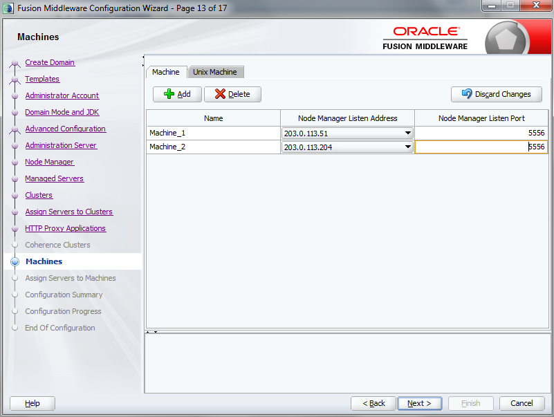

  13. On the Machines page, add and configure each machine. To add Machine_1 and Machine_2, click Add and enter the respective IP addresses. This configuration is for setting up the Node managers on both the machines. Since these node managers are physically separated, you can select the same host. Click Next.
    Figure 6-21 Configuration Wizard Machines Page

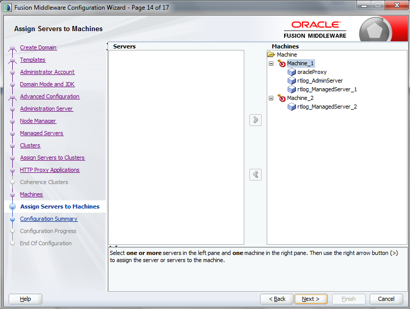

  14. On the Assign Servers to Machines page, assign the servers to the machines. In this example, Oracle proxy (load balancer), Administration server, and one managed server are configured on Machine_1. Another managed server is configured on Machine_2. Click Next.
    Figure 6-22 Configuration Wizard Assign Servers to Machines Page
    Configuration Wizard Assign Servers to Machines page

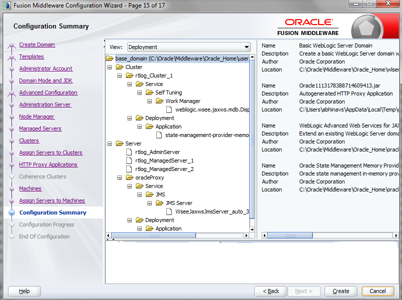

  15. On the Configuration Summary page, verify the selected configuration. Click Create. The domain is created.
    Figure 6-23 Configuration Wizard Configuration Summary Page
    Configuration Wizard Configuration Summary page

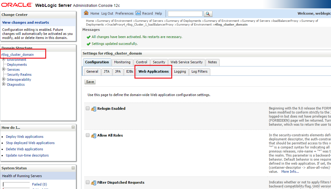

To complete the configuration of the cluster:
  1. Start and stop the node manager. You can find the start up script inside the newly created domain, that is, the <rtlog_clust_domain>\bin directory.
  2. In the nodemanager.properties file, set SecureListener=false. This file is found in the <rtlog_clust_domain>\nodemanager directory.
  3. Edit the <rtlog_clust_domain>\config\config.xml file. Use plain communication for the node managers by updating the communication type for the node managers as shown in the following example:
    <machine>
           <name>Machine_1</name>
           <node-manager>
          <nm-type>Plain</nm-type>
          <listen-address>203.0.113.51</listen-address>
        </node-manager>
     </machine>
     <machine>
        <name>Machine_2</name>
        <node-manager>
          <listen-address>203.0.113.204</listen-address>
        </node-manager>
      </machine>
  4. If the <rtlog_clust_domain> is created with the production mode option:
    1. Run <rtlog_clust_domain>\startWeblogic.cmd for the first time. This creates the servers folders under the domain. Enter the administration user name and password.
    2. Create a folder named security under the <rtlog_clust_domain>\servers\Admin server.
    3. Create the boot.properties file with the following entries under the security folder:
      password=%admin_server_password%
      username=%admin_server_username%
      %admin_server_password% and %admin_server_username% are the administrator password and user name.
    4. After making these changes, if there are any running processes, shut down all the processes.

  6. To enroll the remote (Machine_2) node manager:
    1. Run the WebLogic scripting utility. This utility can be found at the following location: <WL_HOME>\wlserver\common\bin\as wlst.cmd
    2. Start the node manager on this machine, in this example, Machine_2. The node managed must be started before connecting to the Machine_1 Admin server.
    3. Run the following command:
      connect ('adminServer_username', 'adminServer_password','t3://Machine_1_IPAddress:Admin_server_unsecured_port')
      For example: connect ('weblogic','weblogic1','t3://203.0.113.51:7003')
    4. Once the connect command shows the connection completed successfully, run the following command:
      nmEnroll ('<WL_HOME>/user_projects/domains/<rtlog_cluster_domain>','<WL_HOME>/user_projects/domains/<rtlog_cluster_domain>/nodemanager')
    5. When the command completes successfully, run exit ().
    Repeat Step 6 for all the remote machines that will be in the cluster on which managed servers will be running. This step used Machine_2 as the example.
  7. Log in to the Administration Server console and make sure all the node managers are reachable. This can be found under Machines. Repeat this step for all the clustered machines to ensure all of them are reachable.

  9. Start all the managed servers including the Oracle proxy. Figure 6-26 shows an example of the list of managed servers.
    Figure 6-26 Administration Console List of Servers
    Administration Console List of Servers with Oracle Proxy

  2. Navigate to the Administration Console home page and click Deployments in the left navigation menu. Figure 6-27 shows an example of the page before deploying the RTLog Generator application.
    Figure 6-27 Administration Console Deployments Page
    Administration Console Deployments page.
  3. Click Install. The Install Application Assistant page appears. Select the path to the RTLog Generator WAR directory. Select the rtlog-generator.war option. Click Next.
    Figure 6-28 Administration Console Install Application Assistant Page
    Administration Console Install App Assistant for RTLog
  4. Select only the managed servers and click Next to finish the deployment.
    Figure 6-29 Install Application Assistant Select Deployment Targets Page
    Install Application Assistant Select Deployment Targets page
    After it is successfully deployed, the RTLog Generator application appears in the Summary of Deployments page.
    Figure 6-30 Summary of Deployments Page
    This image shows the Summary of Deployments page.

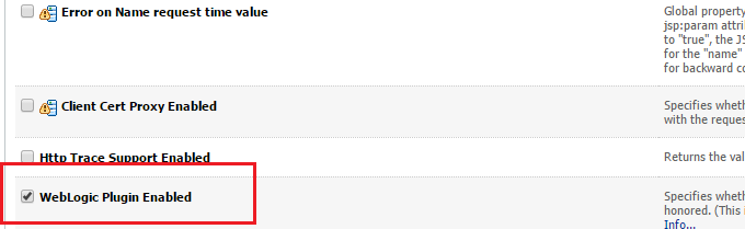

  6. To enable the WebLogic Plugin Enabled parameter from the cluster domain:
    1. Click the <rtlog_cluster_domain> link in the left navigation menu. Navigate to the Web Application tab.
      Figure 6-31 Administration Console Settings Page
      Administration Console Settings for the Web Application tab
    2. Scroll down the page and select WebLogic Plugin Enabled. Click Save.
      Figure 6-32 WebLogic Plugin Enabled Parameter
      This image shows the WebLogic Plugin Enabled parameter.

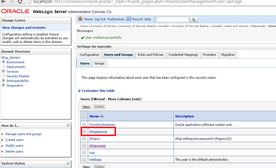

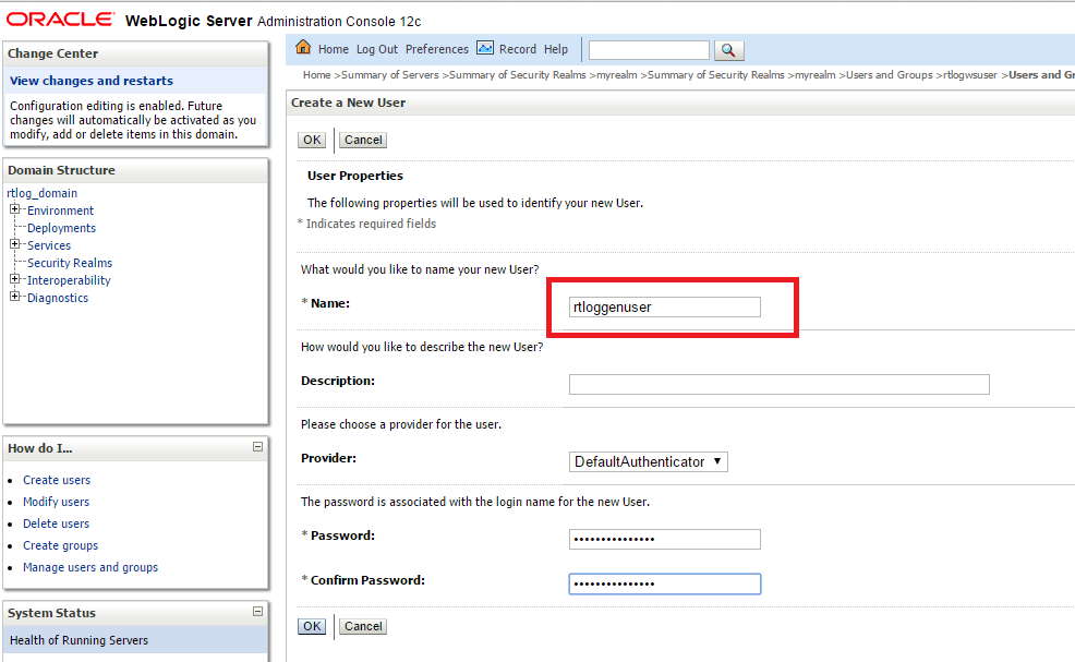

  5. Select the Users tab and click New. Enter a user name and password and click OK.
    Figure 6-35 Create a New User Page
    This image shows the Create a New User page.
  6. In the list of users, click the newly created user.
    Figure 6-36 Users Page
    This image shows the Users page.
  7. Select the Groups tab. Assign this user to the same group created in Step 4.
    Figure 6-37 User Settings Page
    This image shows the User Settings page.

  5. Click the linked name for the Administration Server. The page containing the settings for the Administration Server appears. Select the Keystores tab.
    Figure 6-41 Settings for the Administration Server
    This image shows the settings for the Administration Server.
  6. Enter the path to keystore.jks, including the file name, and enter the custom Identity Keystore passphrase you created for the keystore. Repeat this for trustore.jks, but enter the appropriate passphrase for the truststore. For an example, see Figure 6-41.
  7. Switch to the SSL tab. Enter the alias name and private keyphrase as created during the certificate generation. To save the changes, click Save.
    Figure 6-42 Save Settings for Administration Server
