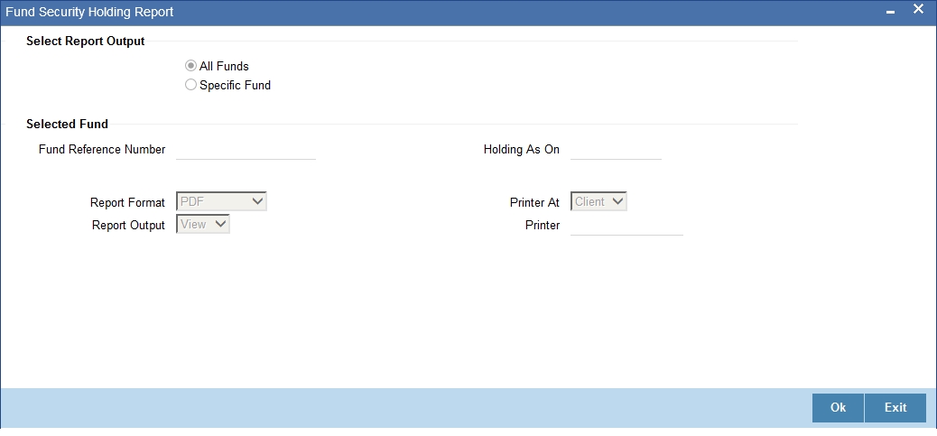

You can invoke the ‘Fund Security Holding Report’ screen by typing ‘AMRFNDHD’ in the field at the top right corner of the Application tool bar and clicking on the adjoining arrow button.
Select the report output you need to generate for from the options. The following options are provided for selection:
Fund Reference Number
If you have selected the option ‘Specific Fund’ then select the fund to be considered for report generation from the adjoining option list.
Holdings As On
If you want to generate report based on the fund holdings as per a specific date then select the date from the adjoining calendar button based on which the report should be generated.
The options that you specified while generating the report are printed at the beginning of the report.

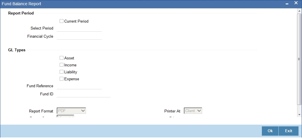

You can invoke this screen by typing ‘AMRFUNBL’ in the field at the top right corner of the Application tool bar and clicking on the adjoining arrow button.
You can indicate the following preferences for generating the report:
Current Period
Check this box if the report has to be generated for the current period.
Select Period
Select the period to be considered for report generation.
Financial Cycle
Specify the financial cycle for which the report has to be generated.
Check the box against the type of GL that has to be considered for report generation. The types of GL available are:
Fund Reference
Select the fund reference number based on which the report has to be generated, from the adjoining option list.
Fund ID
Specify the id of the fund to be considered for report generation.

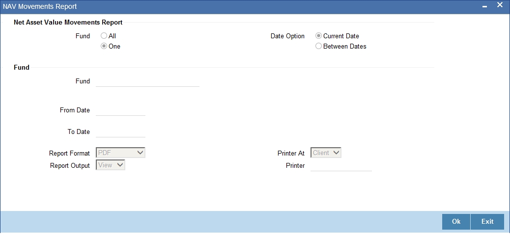

You can invoke this screen by typing ‘AMRNAVMV’ in the field at the top right corner of the Application tool bar and clicking on the adjoining arrow button.
Fund Option
Select the fund for which you need to generate the report from the options. The following options are provided for selection.
Date Option
Select the date from when you need to generate the report from the options. The following options are provided for selection.
You can specify the following details here:
Fund
If you have selected the fund option as ‘One’, you need to specify the fund for which the NAV movement report has to be generated.
From Date
If you have selected ‘Between Dates’ options then specify the start date of the time period for which the NAV movement report has to be generated.
To Date
If you have selected ‘Between Dates’ options then specify the end date of the time period for which the NAV movement report has to be generated.
