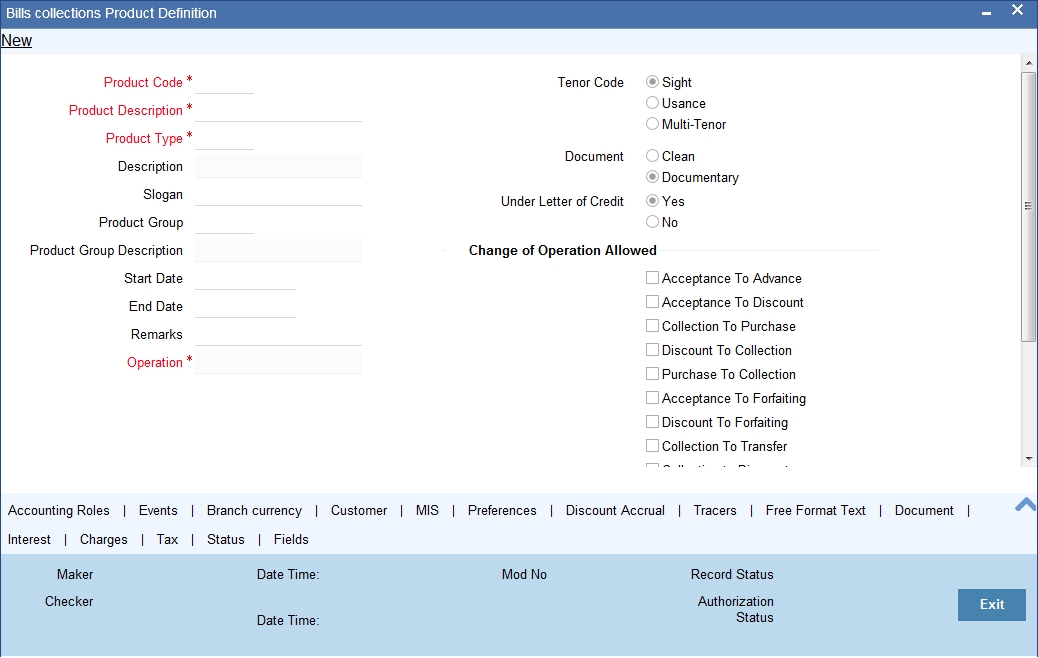

You can define the attributes specific to a BC product in the BC Product Definition Main screen and the BC Product Preferences screen. In these screens, you can specify the product type and set the product preferences respectively.

Product Type
An important detail in defining a product is to specify the type of product you are creating. A Bill product that you create in Oracle FLEXCUBE can be of the following types:
The type of bill product you are creating determines the operations that can be performed on a bill.

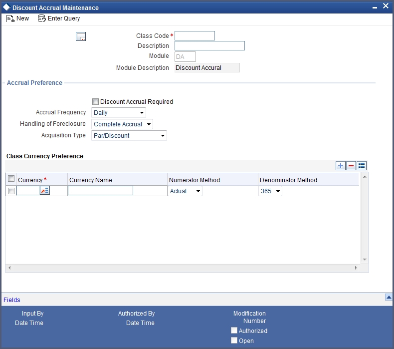

You can refer to the chapter titled ‘Defining Discount Accrual Fee Classes’ for more information on discount accruals.

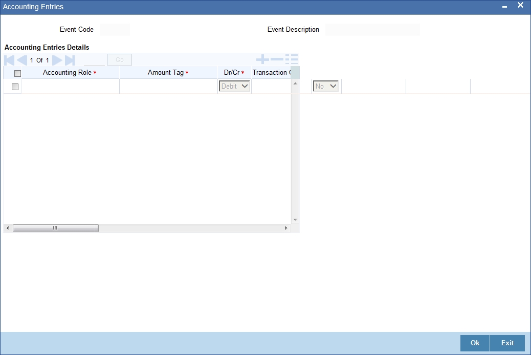

Click ‘Accounting Roles’ button to define accounting roles for the product you are creating. In the screen that corresponds to this icon you can map Accounting Roles to Accounting Heads.

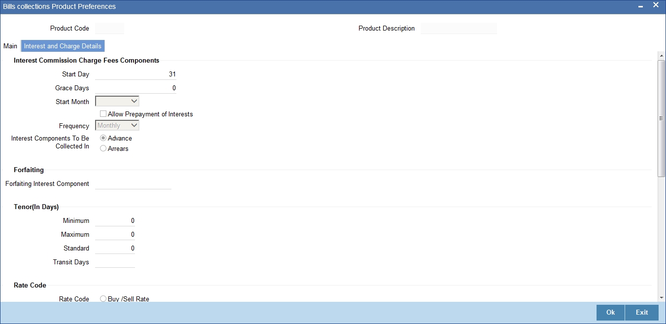

Preferences are the options available to you for defining attributes that will help distinguish a product. The preferences that you state will ultimately shape the product.
By default, a bill involving a product inherits all the attributes defined for the product. The attributes defined as the product’s preferences can be changed for a bill.
Click ‘Preferences’ button to invoke the’ Bills and Collections Product – Preferences’ screen. Through this screen you can define preferences for the product you are creating. The Preferences that you define for a product will be made applicable to all Bills involving the product. The preferences that you can define for a product are discussed below.

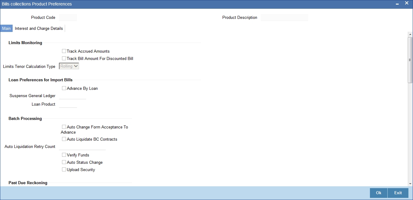

You can specify the following Main preferences related to the Bills and Collections product.
You can capture the following details regarding Limits Monitoring.
Track Accrued Amounts
You have to specify whether the accrued interest of bills that have not yet been paid should also be considered as the utilized amount for the purpose of credit administration. You can make more than one interest type of component applicable to a bill product. In such a case, one type is designated as the main interest. The following example illustrates how this concept works.
For example, You have purchased a bill worth 100,000 from Mr. Sam Brown on June 1, 1999. You have specified that the bill should be liquidated automatically on the maturity date may 31, 1999. The central liability limit assigned to Mr. Sam Brown is USD 110,000.
On 31, December 1999, Mr. Brown approaches you to discount a bill for USD 10000.
If you had opted to track the accrued interest, his total liability to the bank on December 31, 1999 is USD 110,167 (USD 100,000 + USD11, 167 as of December 31 - Interest calculation method Actual/365). Since the utilized amount is above the central liability limit of USD 110,000, Mr. Brown will not be eligible to discount his bill with the bank.
If you had chosen not to track the accrued interest on the bill, he would have been eligible for the discounting of the second bill of USD10, 000. As only the bill amount will be considered for Central Liability tracking.
Tracking Bill Amount for Discounted Bills
Under a discounted bill, the interest that is calculated for the bill is deducted at the time of initiating the bill.
For the purpose of limits tracking, you should indicate whether the actual bill amount or the discounted amount should be tracked, against the limit assigned to the customer under a Credit Line.
Check against this field, to indicate that the actual bill amount should be considered for the purpose, of limits tracking. Leave it unchecked to indicate that the discounted amount should be considered.
For example, You are discounting bill of USD 100,000 and the interest component amounts to USD1000. Under the discounted type of interest payment, the total interest calculated until the maturity date of the bill (USD1000), is deducted from the nominal (USD 100,000) and then advanced to Mr. Brown.
If you check against this field, USD 100,000 will be tracked against the credit limit assigned to Mr. Brown. If you leave it unchecked, USD 90,000 will be tracked against his credit limit.
Limits Tenor Calculation Type
For tenor based bills you can indicate the type or manner in which the bill needs to be tracked.
The tenor calculation type can be either of the following:
If you indicate fixed, a tenor-based bill will through out its tenor be tracked against the relevant credit line.
For example, Mr. Brown has requested your bank to discount his bill worth USD 100,000. The tenor of the bill is 60 days.
You have also assigned Mr. Brown credit limits, under the following tenor based sub-lines, for the Main Line Bills:
Credit Line |
Tenor |
Bill30 |
30 days |
Bill45 |
45 days |
Bill60 |
60 days |
Bill90 |
90 days |
Mr. Sam Brown has been assigned a credit limit under all the sub-lines under the Main Line - Bills.
For fixed tenor type
If you specify the tenor calculation type as Fixed, the bill that has been discounted will be tracked under the credit line ‘Bill60’ throughout its tenor.
For rolling tenor type
If you specify the tenor calculation type as revolving, the bill that has been discounted will be tracked under the credit line Bill60 when it is initiated. After 15 days of discounting the bill, the bill amount will be automatically be tracked under the credit line Bill45. Similarly after 30 days, it will be tracked under the sub-line Bills30 and so on until the bill is liquidated.
You can capture the following loan preferences here:
Advance by Loan
Checking on the option ‘Advance by Loan’ allows you to book a loan. Loan booking is allowed only during final liquidation and is not allowed during partial liquidation of bill. Once you have opted for this option, you need to specify the loan product and the bridge GL in the consecutive fields.
Note
You are allowed to create a loan for import bills that are of Acceptance type and also for Usance and Sight import bills for both under LC and not under LC.
Loan Product
After opting to book a loan, you need a loan product to create a loan. Choose the loan product from the option list. The loan will be created using this product at the time of liquidating the bills.
Note
Only Loan products will be displayed in the option list.
Suspense General Ledger
To create a loan, you need to transfer the principal from Bills to Loans. For this purpose, a Bridge GL has to be specified in this field. Select the GL from the option list.
Note
The system displays only GL’s in the option list and will not display any customer accounts.
You can specify the following preferences related to Batch Processing:
Auto Liquidate BC Contracts
Components of a bill can be liquidated automatically or manually. In the Product Preferences screen, you can indicate whether you need to liquidate the BC Contracts automatically.
If the automatic mode of liquidation is specified, a bill will be automatically liquidated on the day it falls due, by the Contract Auto Liquidation function run as part of the BOD processing. If a bill for which you have specified auto liquidation matures on a holiday, the bill will be processed based on your holiday handling specifications in the Branch Parameters table.
If you do not specify Auto Liquidation, you have to give specific instructions for liquidation through the Manual Liquidation screen on the day you want to liquidate the bill.
Auto Liquidate Retry Count
Specify the number of retry counts for auto liquidation of the bills under reimbursement LC. The system will try to auto liquidate the bill contract until it completes the number of attempts specified here. If the bill has not been auto liquidated even after these many attempts, the system triggers LIQF event. You need liquidate the bill manually in that case.
This is applicable to bills contracts under reimbursement LC only. Other bills contracts are liquidated as part of auto liquidation batch.
Verify Funds
Check this option to check the available balance in settlement account of a bills contract during its auto liquidation. If you check this option, the system verifies the balance only to cover the bill amount. Charges associated with the bill liquidation will not be considered.
If the account has insufficient funds during manual liquidation of a bills contract, the system does not generate advices to issuing bank and claiming bank. An error message is displayed in such instances.

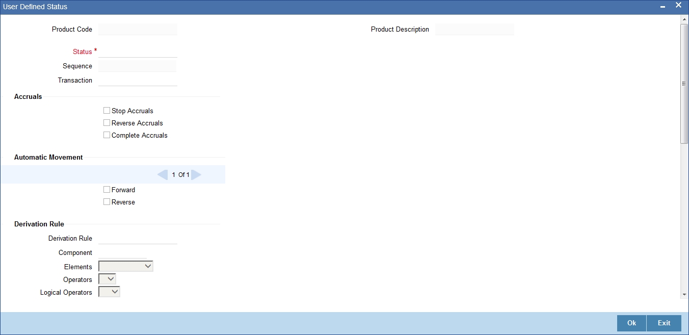

Auto Status Change
A status change is one in which the status of a bill changes from one to the next.
If you specify that status changes have to be carried out automatically, the status of the bill will be changed after the specified number of days. If not, you have to change the status of a bill, through the bill processing function. In the Bills - User Defined Status Maintenance screen, you can specify whether the status change should be in the forward or reverse direction. Other details related to the status change can also be specified here.
Even if automatic status change has been specified for a product and therefore a bill involving it, you can manually change the status of a bill, before the automatic change is due. It can be done through, the Contract On-line Details screen.
If a product has been specified with manual status change, you cannot specify automatic status change, for a bill involving the product.
Note
You will be allowed to specify whether automatic status change should be in the forward or reverse direction in the status maintenance screen only if you specify that automatic status change is allowed for the product.
Auto Change from Acceptance to Advance
A product to cater to the acceptance type of bills is being created. You can indicate whether the bills linked to this product, should be automatically converted into an Advance type of bill, on its liquidation date.
Upload Security
This needs to be checked if the Bills contract is to be considered as Banker’s Acceptance and uploaded as an instrument into the Securities module. The value date of the Bill would be the issue date of the Security and maturity date will be mapped to the redemption date of the security. The Bill amount will be uploaded as the initial and current Face Value of the security
The Past Due Status preferences that you define for a product default to the bills processed under it.
By Goods Arrival Date
In the BC Product Preferences screen, you can indicate if the past due status (of bill contracts entered under the product) should be determined with respect to the Goods Arrival Date.
Days after Goods Arrival
If you opt to determine the past due status with respect to the Goods Arrival Date, you can enter the number of days vis-à-vis the Goods Arrival Date that should determine the past due status. The following example illustrates what this implies.
For example, when building a Bills product, you opt to determine the Past Due Status of bills entered under it with respect to the Goods Arrival Date. You can specify this in the BC Product Preferences screen.
Choose the ‘By Goods Arrival Date’ option by clicking on the check box adjacent to it.
In the Days after Goods Arrival field, specify the number of days after the goods arrival date that should determine the past due status, say, ‘4’.
Implication on bill contracts entered under the product:
When capturing the details of a bill contract, you specify the Goods Arrival Date as 25 May 1999.
If this bill is not settled by 29 May 1999 (25 May 1999 plus ‘4’ days), the bill will be moved, automatically, to the Past Due Status.
INCO Term
Specify the INCO term related to goods that are a part of the LC instrument. You can select one of the following values from the adjoining option list:
Liquidate Using Collateral
Check this box to indicate that the bill should be liquidated using the collateral account instead of customer account if the collateral account has sufficient funds.
Transfer Collateral from LC
Check this box to indicate that the collateral amount obtained during LC creation should be transferred to the Bill availed under LC proportionately. This flag is defaulted from product level and can be modified at contract level after which it cannot be changed.

For handling Rollover, you will have to maintain two events and associate the relevant accounting roles and amount tags while defining the Bills Product.
The two events are:
The system posts the following accounting entries when rollover is initiated manually on the bills contract:
Event |
Dr./Cr. |
Accounting Role |
Amount Tag |
ROLL |
DR |
ROLL_BRIDGE_GL |
PRINCIPAL_ROLL |
ROLL |
CR |
ADV UNDER LCS |
PRINCIPAL_ROLL |
INIT |
DR |
ADV UNDER LCS |
PRINCIPAL_ROIN |
INIT |
CR |
ROLL_BRIDGE_GL |
PRINCIPAL_ROIN |

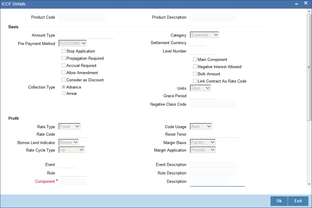

You can specify the Interest and Charge Details in the ‘Interest and Charge Details’ tab.
Accrual Frequency
Apart from the bill amount, a bill can have other components, such as interest, charges or fees. They can be accrued over the tenor of the bill. The frequency, at which these components should be accrued, can be specified as a Product Preference.
The attributes of the other components are defined in the ICCF sub-system of Oracle FLEXCUBE. The frequency with which the components should be accrued is specified in this screen.
The system carries out automatic accruals at the frequency specified by you, as part of the End of Cycle processing. If the accrual date falls on a holiday, the accruals are done as per your holiday handling specifications in the Branch Parameters screen:
You could have specified that automatic events for a holiday(s) are to be processed on the working day before the holiday. The accruals falling due on a holiday(s) will be then processed during End of Day processing on the last working day before the holiday.
You could have specified that the automatic events for a holiday(s) are to be processed on the working day following the holiday; the automatic events falling due on a holiday(s) will be processed on the next working day, during the Beginning of Day processing.
The frequency can be one of the following:
In the case of monthly, quarterly, half yearly or yearly accruals, you should specify the date on which the accruals have to be done during the month. For example, if you specify the date as 30, accruals will be carried out on that day of the month, depending on the frequency.
If you want to fix the accrual date for the last working day of the month, you should specify the date as 31 and indicate the frequency. If you indicate the frequency as monthly, the accruals will be done at the end of every month. That is, on 31st for months with 31 days, on 30th for months with 30 days and on 28th or 29th, as the case may be, for February.
If you specify the frequency as quarterly and fix the accrual date as 31, the accruals will be done on the last day of the month at the end of every quarter. It works in a similar manner for half-yearly and yearly accrual frequency.
If you set the accrual frequency as quarterly, half yearly or yearly, you have to specify the month in which the first accrual has to begin along with the date.
For example, you have selected the half-yearly option, specified the start date as 31 and the start month as June. In this case, the system will make the first accrual on June 30, 1999 for the period from January 1 to June 30, 1999. The second accrual will be on December 31, 1999, for the period from July 1, 1999 to December 31, 1999.
Accrual Start Day
Accrual Start Month
Grace Days
The grace period specifies the period after the repayment date, within which the penalty interest (if one has been defined for the product) will not be applied, even if the repayment is made after the due date. This period is defined as a specific number of days and will begin from the date the repayment becomes due.
Penalty interest will be applied, on a repayment made after the grace period. The penalty interest will be calculated for the entire period it has been outstanding (that is, from the date the payment was due).
For example, The repayment on Mr. Sam Brown’s bill is due on June 15, 1999. You have specified a grace period of 5 days, after which a penalty interest of 2% will be imposed.
Bill repayment made within the grace period
Now, if Mr. Brown makes the payment on June 18, which falls within the grace period, he will not have to pay penal interest.
Bill repayment made after the grace period
But if he makes the payment after the expiry of the grace period, that is, after June 20, then he will be charged penal interest starting from June 16 (the repayment date) and not from June 20, the day the grace period expires.
Interest Components to be collected in
You can have the interest collected in one of the following ways:
Advance - When interest is to be collected in advance, it will be collected at the time of initiating the bill.
For example, you have purchased a bill on Jan 10th and set it up as having interest to be collected in advance.
In this case 10th is the transaction date of the bill. Therefore, the interest amount due on the bill is collected on Jan 10th.
Note
If you opt to collect interest in advance, you can also specify the discounting method applicable on the bill. This is discussed in the section titled ‘Specifying the Discounting Method’ of this chapter.
Arrears - If the interest component of a bill is to be collected in arrears, the interest is collected on the maturity date of the bill.
For example, you have discounted a bill on 10 January 1999, which matures on 31 April 1999. You have specified that the bill is to be collected in arrears.
In this case, on 31 April 1999, which is the expiry date of the bill, the interest amount due on the bill, will be collected.
Allow Prepayment of Interest
If this option is checked at the product level, payment of interest is allowed even before the due date is reached.
Here you need to capture the interest component.
Forfeiting Interest Component
For bills that can be forfeited, you need to specify the interest component at the product preference level. The adjoining option list displays all the interest components (except the main interest component) attached to the product. You can select the appropriate one.
You can specify the interest collection preference in the ‘Interest Component’ screen. To invoke this screen, click ‘Interest’ button in the ‘Bills and Collections – Product Preferences’ screen.
You can set the Standard, Minimum and the Maximum limits for tenor based bills. The tenor details that you specify for a bill product, is always expressed in days.
Maximum
You can fix the maximum tenor of a product. The tenor of the bills that involve the product should be less than or equal to the Maximum tenor that you specify.
Minimum
You can fix the minimum tenor of a product. The tenor of the bills that involve the product should be greater than or equal to the Minimum tenor that you specify.
Standard
The standard tenor is the tenor that is normally associated with a bill, involving a product. The standard tenor of a bill is always expressed in days and will apply to all bills involving the product. If you do not specify any specific tenor while processing a bill, the standard tenor will be applicable to it. The standard tenor applied on a bill can be changed during bill processing.
You can create a product with the standard tenor as zero. While processing a bill involving such a product, you will need to specify the maturity and the expiry date of the bill.
If you attempt to save the bill without entering the expiry or maturity date you will be prompted for an override.
For example, you have defined a bill product to cater to tenor based discounted bills. The minimum tenor specified for this product is 100 days and the maximum tenor is 1000 days. You have also specified a standard tenor that is 500 days.
For this product, you can process bills with a tenor between 100 and 1000 days. As you have specified the standard tenor as 500 days, by default, a bill involving this product will have a 500 day tenor. At the time of processing the bill you can change this tenor to any period between the Minimum and Maximum tenor limits specified.
Transit Days
The transit days is used to compute the maturity date of the bill. Enter the transit days for the bill. The system does not allow you to save the record in case the transit day exceeds the standard tenor.

Click ‘Discount Accrual’ button to define the discount accrual preferences.
Refer to the Discount Accrual chapter in this User Manual for more details.

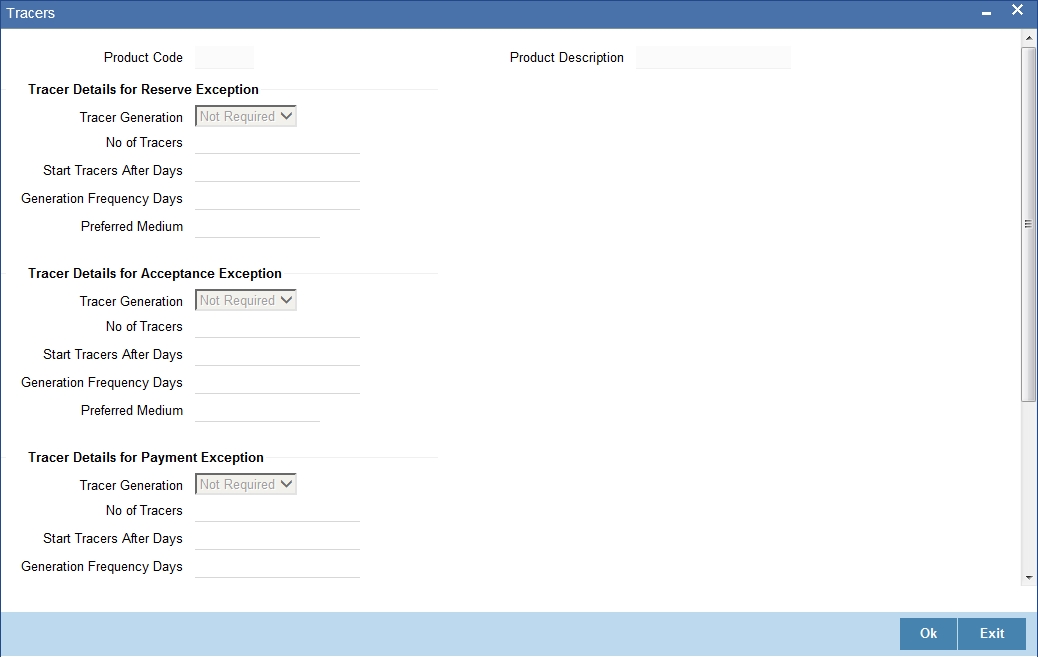

Tracers are reminders, sent to various parties involved in a bill indicating that an exception that has occurred, while processing the bill. In this screen you can capture tracer details for the following exception events:
Reserve Exception – sent by negotiating bank (for bills under LC), if discrepancies are noted and negotiation is done under reserve (right of recourse). The tracers are for reminding resolution of the discrepancies and get stopped when the respective discrepancy is marked as resolved
The details specified for the product involved in the bill will be defaulted to the contract. You can change the defaults to suit the requirements of the bill you are processing. Click ‘Tracers’ button in the ‘Bills and Collections Product Definition’ screen and invoke the following screen. If you have checked the option ‘Reimbursement Claim’ in the ‘Bills and Collection Product Definition’ screen, you will not be able to save details in this screen.
The system will display an error message while saving the product if you have entered details in this screen.
You can specify the following details here:
Tracer Generation
You can indicate whether the exception tracer (for reserve, acceptance, payment and charges) is applicable to the bill you are processing. You can select one of the following options:
Number of Tracers Required
If you have indicated that the tracer is applicable, to the bill you are processing, you should also specify the maximum number of tracers that should be generated, for each of the exception events.
By default, the first tracer for all authorized bills linked to this product, will be sent after the number of days that you prescribe, for the product.
Start Tracer after Days
Exception tracers can be generated, only after the maturity date of the bill. While creating a product, you have also indicated the number of days that should elapse after the Bill matures on which the first tracer should be generated.
Generation Frequency Days
You can specify the frequency (in days), with which the tracer should be sent to the concerned parties, involved in the bills linked to this product.
Preferred Tracer Medium
For each of the exception tracers that you specify, indicate the preferred medium through which the tracer should be generated to the concerned party.
For a bill involving the product, you can change the medium that is defaulted. The medium you specify here is only the preferred medium, for the exception tracer.
Template ID
Specify the template related to MT799 or MT499 message types. The adjoining option list displays all the templates related to MT799 (if it is under LC) or MT499 (if it is not under LC) message types defined in the ‘Swift FFT Template Screen Maintenance’ screen. You can choose the appropriate one.
This field is mandatory if the ‘Tracer Generation’ is indicated as ‘Required’ and ‘Preferred Medium’ as ‘SWIFT’. This Template id is used while generating Charge and Commission Tracer (CHG_COM_TRACER) in MT799/MT499 swift format as part of LQ EOD Batch if the ‘Preferred Medium’ is ‘SWIFT’.
For further details on Swift FFT Template Screen Maintenance screen, refer the section ‘Maintaining SWIFT FFT Template’ in the ‘Defining Free Format Messages‘ chapter in the ‘Messaging System’ User Manual.

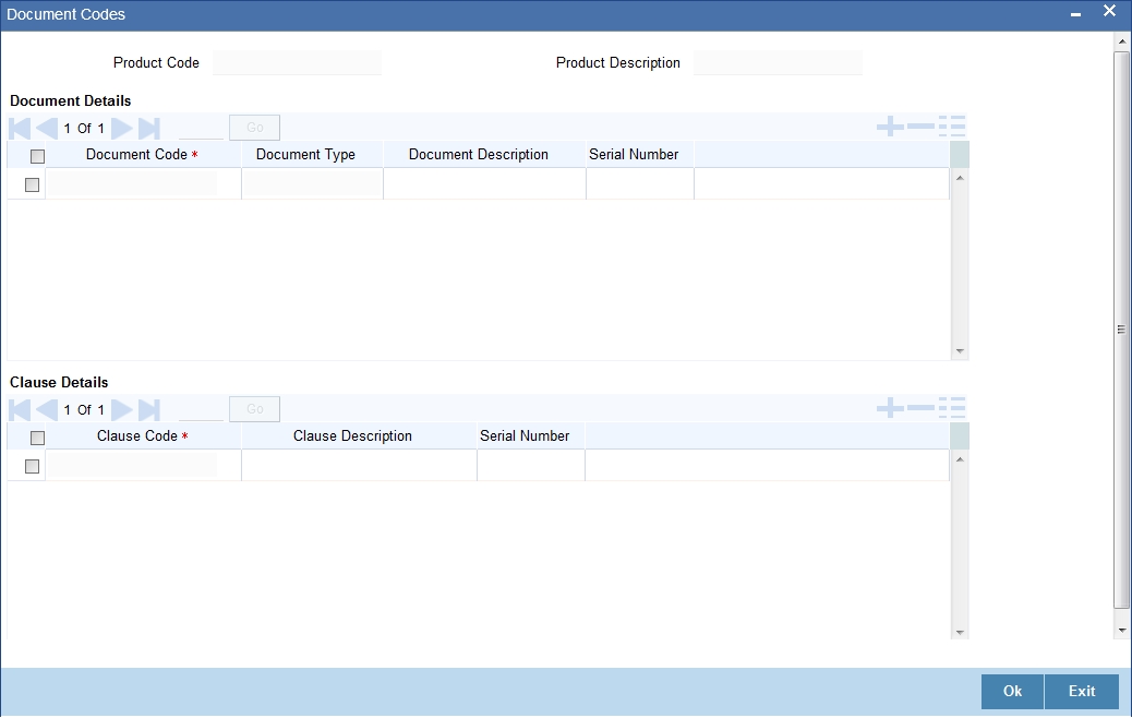

Click ‘Document’ button in the ‘Bills and Collection Product Definition’ screen and invoke the following screen.
Document codes and clause codes applicable to the product you are creating can be defined here.
The documents that can be associated with a bill are broadly classified into:
There are certain standard documents that are required, under a documentary bill. You can specify the documents that are applicable to the bills that are linked to the product.
Document Code
A list of the standard shipping documents that can accompany the bill is maintained in the Documents Maintenance screen. Along with these documents, you will also be provided with a pre-defined list of documents.
Select a document code from the list of documents maintained earlier.
Document Type and Description
The description and the document type associated, with the code you have selected will be displayed.
You can specify more than one of the predefined documents, for the product you are creating. All the documents that you define for the product will be defaulted to all the bills involving this product. While entering a bill you can add to or delete, from the defaulted list of documents.
After you have specified details of the document, click add icon to add it to the list of documents, applicable to the product. Click delete icon to delete a document from the product.
Click ‘Interest’ button to define the Interest that is to be collected for Bills involving this product.
Here you can capture details about interest computation, accrual and liquidation for all contracts under the product.
Collection Method
Indicate the method for collecting interest for the components by choosing one of the following:
Refer the User Manual on Interest under Modularity for further details.

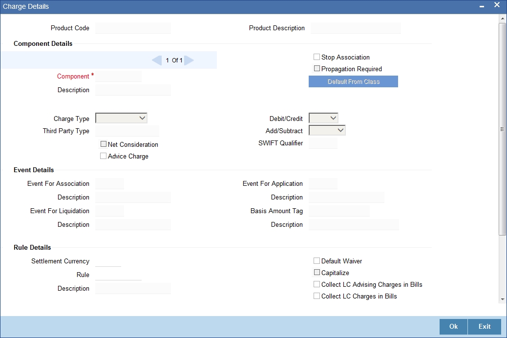

Click ‘Charges’ button to define the Charges or Fees that are to be collected for Bills involving this product.
Refer the User Manual on Charges and Fees under Modularity for further details.

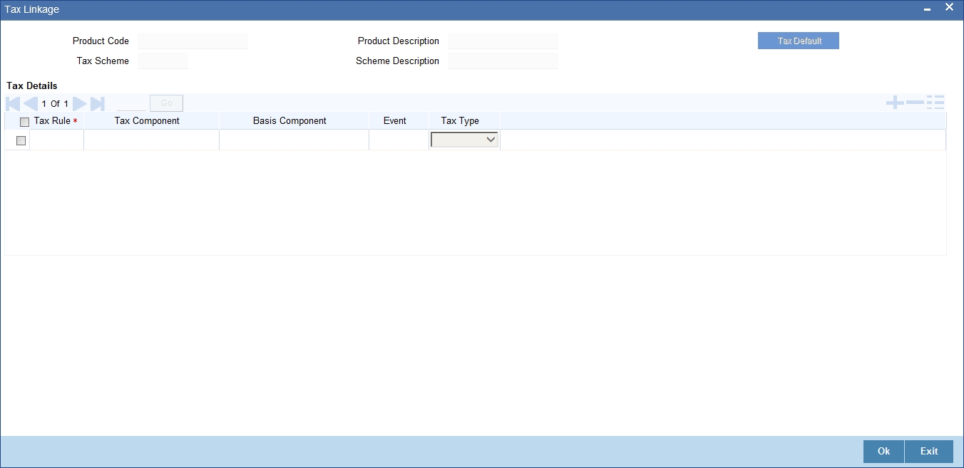

Click ‘Tax’ button to indicate the tax schemes that are applicable to the product you are creating.
Refer the User Manual on Tax under Modularity for further details.
An Active status is automatically allotted to a bill on its initiation. A bill on which payment has not been made, on the due date can pass through more than one status. Click ‘Status’ button and invoke the following screen.
You can define attributes for each status through the User Defined Status Maintenance screen. These attributes are:
Status
This is the sequence in which, a bill should move to the status you are defining. Usually, more than one status is defined for a product. In this context, you should indicate the sequence in which a bill moves from status to status.
You can also specify the number of days after a repayment falls due that a component has to be moved to the status you are defining.
Incase of a component for which repayment is due, you can specify the number of days after the Maturity date, on which the component should be moved, to the status being defined.
For example, you define the following status for the product, Export Bills Discounted - 45 days:
You want a bill under this product, to move from one status to another in the order in which they are listed above.
For such a condition, the status sequence has to be defined as follows:
Based on the default number of days defined for each component, a bill will first move from Active status to PDO, then to NAB and lastly to WO status.

Indicate the movement preference for statuses.
Forward
A forward status change is one in which the status changes from one to the next. In our example, the movement from Active to PDO, PDO to NAB and NAB to Write Off are forward changes.
Reverse
A reverse status change is one in which the status changes from present status to the previous. Such a situation arises when a payment is made on a bill with a status other than Active.
If you specify that forward changes have to be carried out automatically, the status of the bill will be changed, after the specified number of days. If not, you have to change the status of a bill through the bill processing function. Even if automatic status change has been specified for a product and therefore a bill involving it, you can manually change the status of a bill before the automatic change is due. You can do it through the, Contract On-line Details screen.
If a product has been specified with manual status change, then you cannot specify automatic status change for a bill involving the product.
If you specify, that reverse changes have to be carried out automatically, the status will be changed when a payment is made on a bill with a status, other than Active. If you specify that reverse changes should not be automatic, the status remains unchanged, even if a repayment is made on the bill. The status has to be changed by you through the, Contract Processing function.
A reverse change may also become necessary, when the number of days of default is increased for a product.
If you specify that forward changes or reverse changes have to be carried out automatically, the status changes will be carried out by the Automatic Contract Update function during BOD processing. This is done on the day the change falls due. If the day on which the forward or reverse status change is due happens to be a holiday, then, the processing would depend upon your specifications in the Branch Parameters screen.
If you have not specified that the forward or reverse changes should be carried out automatically, the status remains unchanged till you change it for a bill, through the Contract Processing function.

You can use the following fields to define derivation rules:
Derivation Rule
If you have opted for automatic status change, specify the criteria (rules) based on which the system will perform the status change. A bill is said to be in a specific status if any one of the five conditions associated with the status holds true. If all the conditions are false, the bill will automatically move to the next available status for which the condition is true.
You can define five conditions for each status. The conjunctions ‘AND’ and ‘OR’ can be used to create multiple conditions. Use those buttons appropriately between each condition.
Elements
Select element based on which you need to build a condition for automatic status change of bill. The drop-down list displays the following elements:
Choose the appropriate one.
Operators
Select the operator for building a condition for automatic status change. You can use multiple elements, in conjunction with the functions and arithmetic operators. The drop-down list displays the following operators:
Logical Operators
Select the logical operator for building a condition for automatic status change. The system uses the logical operators in combination with the elements for creating derivation rules. The drop-down list displays the following logical operators:
The ‘Customer Credit Rating’ field at the Customer level will be used as a SDE CUSTOMER_CREDIT_RATING for defining status change rules. This will also be available for provision rule definition at the CL product level.
Enter the following details.

In order to perform bill forfeiting, you need to maintain specific products with the following set-up:
Invoke the ‘Bills and Collections Product Definition’ screen.
Operation
Select ‘Acceptance’ or ‘Discount’ from the option list.
Change of Operations Allowed
You can check the following options:
Invoke the ‘Interest Details’ screen.
You need to set up the following interest components:
Collection Method
You need to specify ‘Advance’ for the forfeiting and rebate interest components. You need to indicate the collection method as ‘Arrears’ for the main interest component.
Rate Type
The forfeiting interest component should not be of type ‘Special’.
