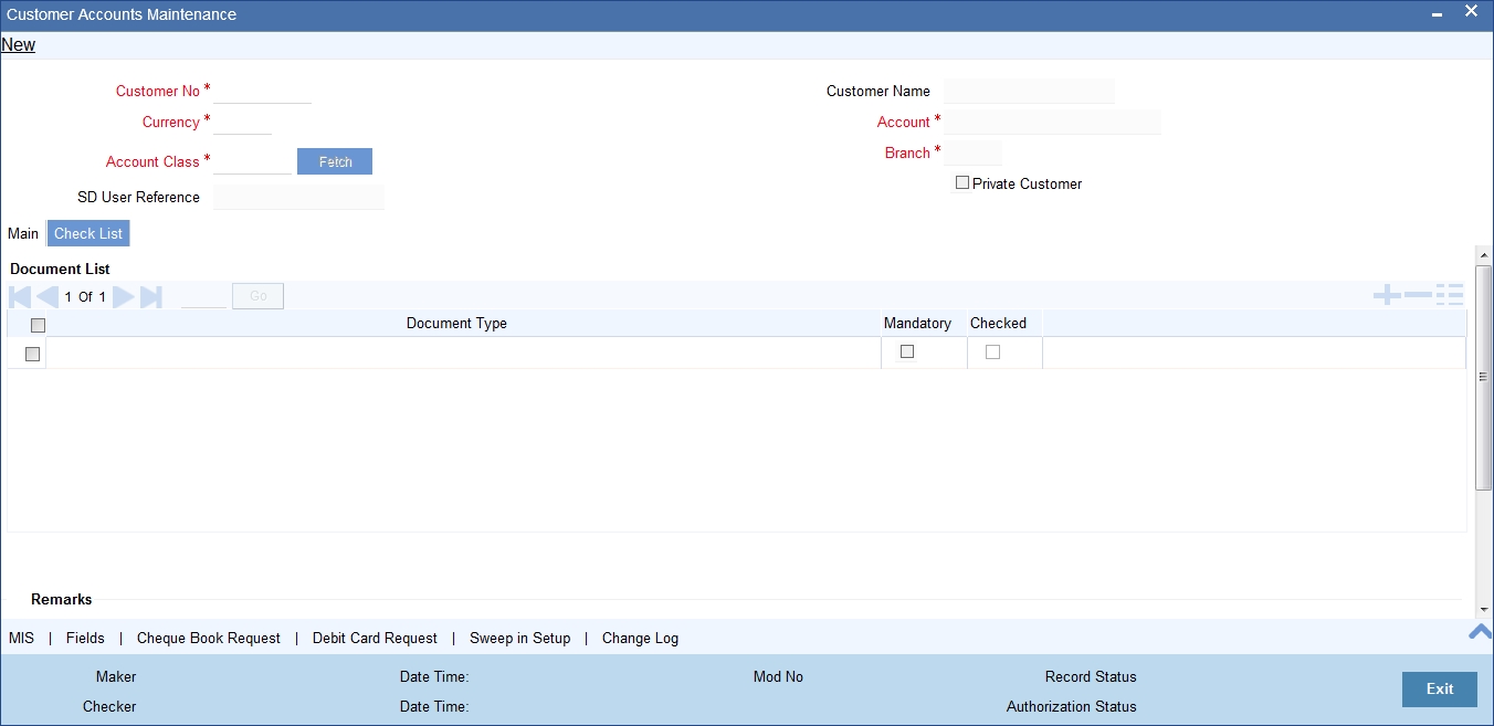

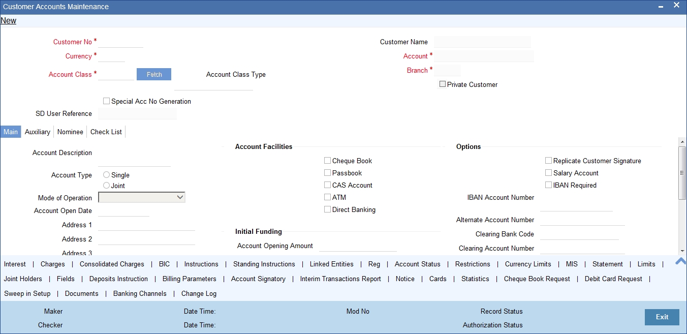

Invoke the ‘Customer Accounts Maintenance’ screen by typing ‘STDCUSAC’ in the field at the top right corner of the Application tool bar and clicking the adjoining arrow button. Click the new button on the toolbar.
Note
You can query or modify the account details of the customers whose accounts are permitted to you for the query/modification in the ‘Group Code Restriction’ screen
The ‘Customer Accounts Maintenance - Main’ screen is displayed by default when you invoke the ‘Customer Accounts Maintenance’ screen. The Branch Code of the sign-on branch is on display.
Customer No
To create an account, you need to input the CIF number of the customer for whom the account is to be created. The adjoining option list displays all the valid customer codes. You can select the appropriate one.
If the CIF number is a part of the account mask, the specified CIF should be as part of the account number as per the length of CIF in the mask.
If you have included the CIF Number of the customer as part of the Account Mask, the system automatically defaults the CIF code of the customer in the respective field. You can modify this code.
However, while defining the Account Mask in the Account Parameters section of the Bank-wide Parameters screen, if you have specified that the CIF Number should not be a part of the account mask you will have to specify the customer code manually. A list of all the valid customer codes is displayed in the available option list. You can select the appropriate.

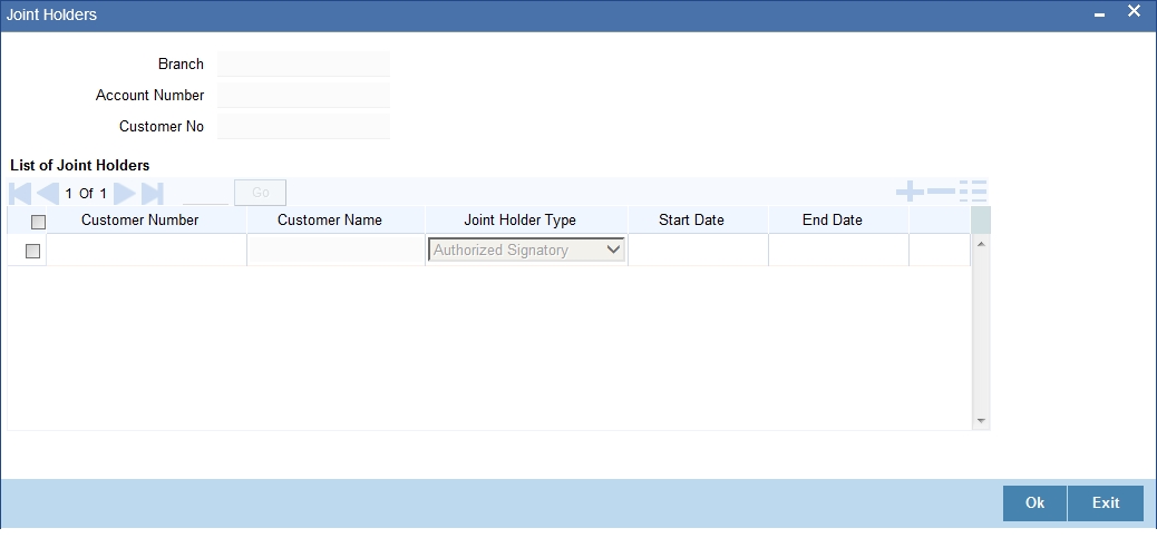

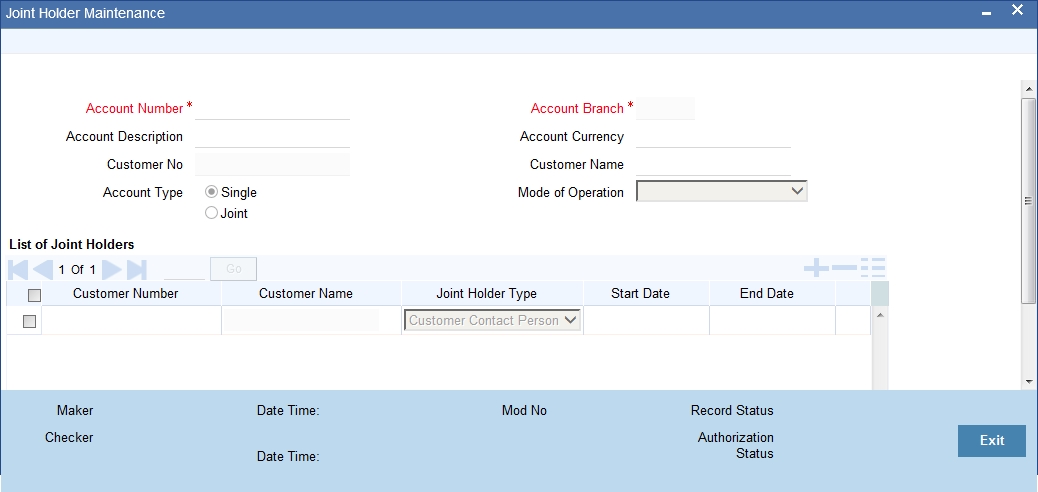

To view the joint holder’s details of an account and the mode of operation maintained at the account level, place the cursor on the Account field and press Ctrl+J. The system displays the ‘Joint Holder’ screen.
For more information on the ‘Joint Holder’ screen refer to the section ‘Joint Holder Maintenance’ in this User Manual.

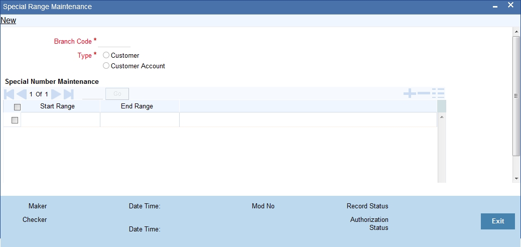

Special Account No Generation
Check this box to generate a special account number in the ‘Account’ field.

Details maintained in this screen are classified into four broad tabs and are discussed in detail in the subsequent sections:
Tab |
Remarks |
Main |
Here you maintain the main attributes of each customer account like the account number, customer code, the account class, account currency, type of account - single or joint, account status, other statuses applicable, Cheque Book preferences etc. |

Check List |
Document details like document type, expiry date, expected date of submission and so on are maintained under Check List. |
Account Description
The system displays the customer’s complete name. However, you can modify it, if required. Here you can enter the nature of the account like current, savings, overdraft, etc. If a customer has two or more accounts under one account class, you can specify the purpose of that account.
Note
It is mandatory to enter the account description. If the full name is not maintained at customer level or account description is not entered, the system will display an error message.
Account Type
You have to indicate whether the account is to be opened only by the account holder or whether it can be jointly operated.
Mode of Operation
Select the mode of operation from the following options:
Account Open Date
The system displays the current branch date. However, you need to specify the date on which the account was opened.
Address 1–4
Specify the address of the customer.
Location
An address for a customer account is based on the ‘Location’ and ‘Media’ combination. Location codes maintained through the ‘Account Address Location Type Maintenance’ screen are made available against this field. The address maintained here is always the primary or the default address. Each customer can have several addresses for a particular media. To distinguish between one address of a customer from another for a given media, it is essential for you to specify a unique location for each address. Also, if you are amending an address here, the same gets updated in the ‘Customer Account Address - Detailed’ table after the validations are through.
Media
Indicate the media for which the charge should be levied. Select one of the following options from the option list:
Country Code
Specify the country of the customer. This adjoining option list displays all valid country codes maintained in the system. You can choose the appropriate one.
Note
The country information is captured to enable Mantas to analyse the transactions for possible money laundering activities.
As part of specifying the account facilities, you can indicate whether the account holder can avail he following facilities:.
You can indicate that the account holder can avail of a Chequebook, Passbook, ATM facility, Direct Banking facility by checking the box positioned next to each of these fields. The system displays a configurable override message if the defaulted values are modified.
If you have indicated that the account holder needs to be provided with the check book facility, you can also specify whether automatic reordering of cheque books should be allowed for the account. In addition, you will have to maintain the check book details through the respective screen. Similarly, you can choose to indicate that the account holder needs to be provided with a Passbook, ATM and Direct Banking facility.
Note
Although these specifications are defaulted from the account class screen, where you had maintained these specifications for all accounts belonging to a class, the options specified at the account level will supersede that specified for the account class.
Cheque
System checks the box by default if you have selected the option for availing cheque book facility in account class screen.

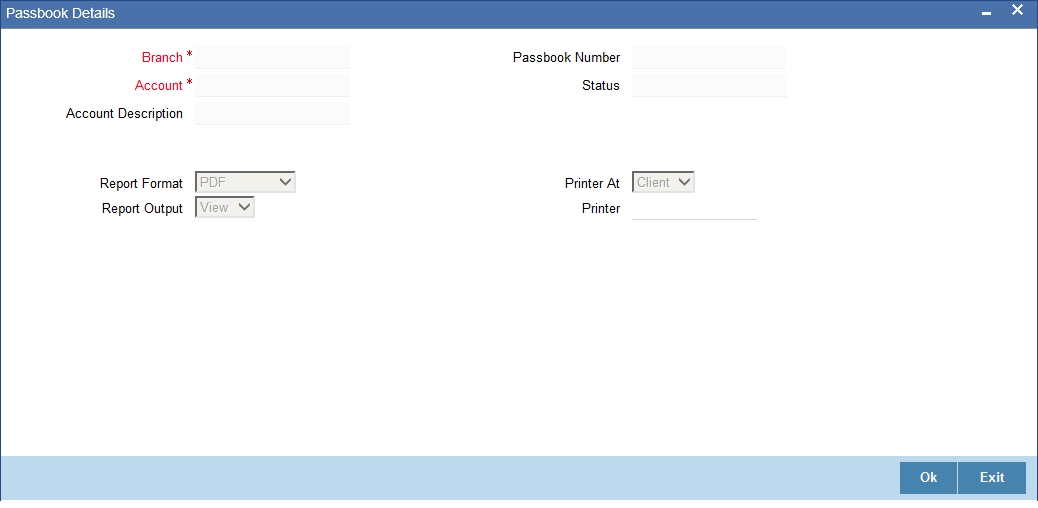

Passbook
System checks the box by default if you have selected the option for availing passbook facility in account class screen.
This shall be defaulted from the account class screen, where you had defined this facility for all accounts belonging to a class. The option specified at the account level will supersede that specified for the account class.
CAS Account
Check this box if you wish to have CAS account facility.
ATM
System checks the box by default if you have selected the option for availing ATM facility in account class screen.
Direct Banking
The system checks this box by default, if you have selected the option for availing direct banking facility in account class screen. You are allowed to modify it.
By availing direct banking facility you can only view the minimum balance of the account. The system does not allow you to perform any other transactions with this facility.
You can maintain the following details here:
Account Opening Amount
Specify the amount being deposited to open a customer account. While saving the record, the system checks whether this amount is equal to or greater than the minimum limit maintained for the linked account class. If the amount is less than the applicable limit, the system will display an error message. If it is equal to or greater than the limit amount, the system will proceed with saving.
Input to this field will be mandatory if limit amount has been maintained for the linked account class.
Pay-In Option
Select the method for initial funding during account creation. Choose one of the following options:
Offset Branch
Specify the branch code of the account for redemption.
Offset Account
Specify the offset Account. If you have chosen ‘Pay In By Account’, as the pay-in option, specify the customer account that should be debited while posting accounting entries. The adjoining option list displays all valid customer accounts and customer GLs maintained in the system. You can choose the appropriate one.
If you choose ‘Pay In By GL’, the system will display the offset GL maintained for the branch in the ‘Term Deposit Payin Parameters Maintenance’ screen.
Waive Account Opening Charges
Check this box to indicate that account opening charges should be waived for individual customer account.
Replicate Customer Signature
The signature of the customer gets defaulted from the linked CIF (customer) level to account. This value will be defaulted only if the customer type is individual with single or joint mode of operation.
Salary Account
Check this box to indicate the salary account which should be selected for loan recovery on salary credit. By default this option is unchecked.
IBAN Required
Check this box to capture the details of the IBAN account for a specific customer. ‘IBAN Required’ is enabled by default if:
IBAN Account Number
Specify the IBAN Account Number. If IBAN details are maintained for the branch and 'IBAN Required' is checked for the account, then the system will generate the IBAN number on saving the account.
The IBAN consist of 34 alphanumeric characters out of which first two letters are the country code, next two characters being check digits followed by a country specific Basic Bank Account Number (BBAN).
For Nostro accounts, you have to provide the IBAN after checking 'IBAN Required' flag.
Alternate Account Number
You have to define an alternate account number for the account you are defining. The alternate account number that you specify should be unique for each customer. You can capture the old account numbers used by your bank before installing the Oracle FLEXCUBE system. The old account numbers would be mapped with the new account numbers. This would facilitate quick tracking of the account and generating queries.
In the Data Entry Module, you can input a transaction using the alternate account number instead of the actual account number.
Clearing Bank Code
Specify the external bank’s code that should be used for clearing maintenance. The adjoining option list displays the valid banks maintained in the system. You can choose the appropriate one.
Clearing Account Number
The clearing account number for the customer account is generated automatically if you have opted for auto generation in the Branch parameters. The account number is created according to the account mask you have maintained for the branch. This will be mandatory, and has to comply with length of 9 characters and MOD 11 validation, if the value of the UDF ‘Clearing A/C Mandatory’ is maintained as YES in the Field Name to Value Definition screen.
However, you can choose to change this number here and the system validates this number with the account mask you have maintained for the branch.

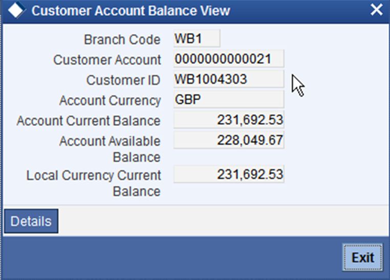

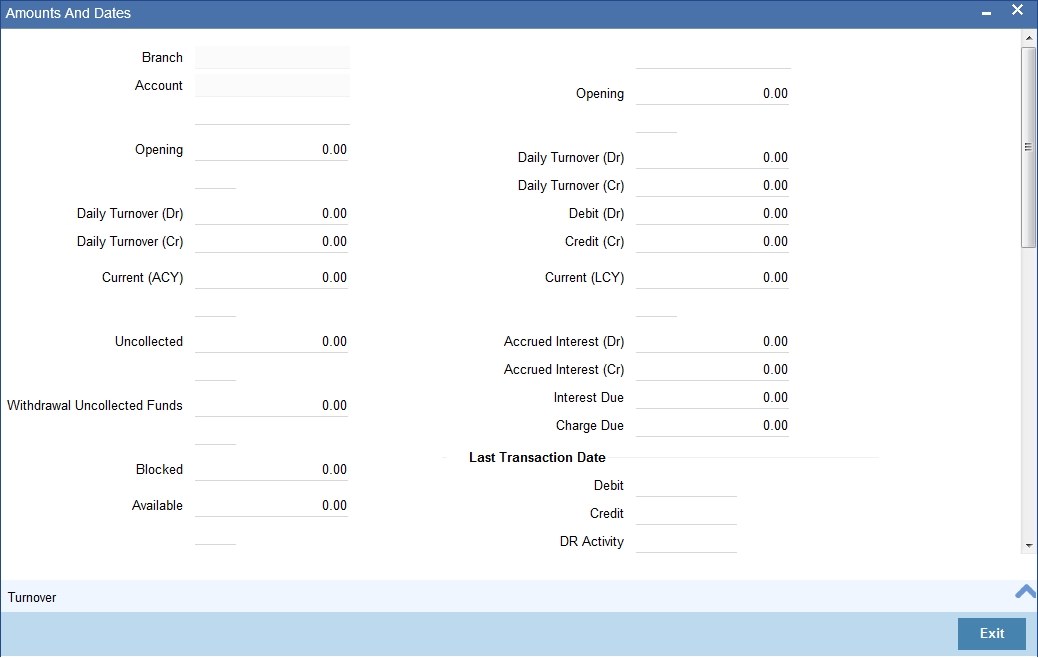

In the Customer Accounts Maintenance - Amounts and Dates screen you can view all financial details of this customer’s account along with the details of the previous debit or credit activities. However, access to all financial information of an account can be restricted for any user. The financial details of an account include the account balance, the sweep eligible balance, the uncleared debit and credit balances, the debit and credit turnover, and the interest details. The turnover limit details of an account include the current financial period, currency, utilized and unutilized limit balances.
Click ‘Amounts and Dates’ button in the Customer Accounts Maintenance screen.
The total available balance displayed by the system includes the initial funding amount and unutilized line amount (in case the customer enjoys an OD limit).
In the Amounts and Dates screen, you can view the outstanding debit interest and/or charges due on the account, as on the current date.
You can also view the amount that can be withdrawn against uncollected funds, on the account.
The System computes and displays the following
Click ‘F11’ to compute sweep eligible balance. Based on the available balance, an authorizer in a bank authorizes debit transaction on primary source CASA account which has sweeps arrangement in place. Click ‘Details’ button to view the details
Accrued interest (Dr/Cr) shows the amount accrued till date on the account.
System displays the outstanding interest due & charge due in these fields. If the check box Liquidation Using Receivable is checked at the account class level and if the account has insufficient balance, then system debits interest and charges from the receivable GL and the same will be displayed in these fields.
When this branch is under EOD processing, the inter-branch transactions originated from other branches are tanked. The funds are made available automatically after BOD and till such time they are treated as unposted items.
You can view the account balance status with respect to the turnover balance limit set for the financial period. You can view the financial period, currency, total deposited amount and the permissible limit for deposits. The period and limit details are inherited from the limit code associated with the parent account class.
During every credit transaction on the account, the system updates the limit utilization and checks the balance amount against the permissible threshold. On account of a transaction, if the balance breaches the limit threshold, the system will display an override message.
You can view the component-wise outstanding amounts in ACY and the component-wise oldest outstanding dates for overdraft accounts.

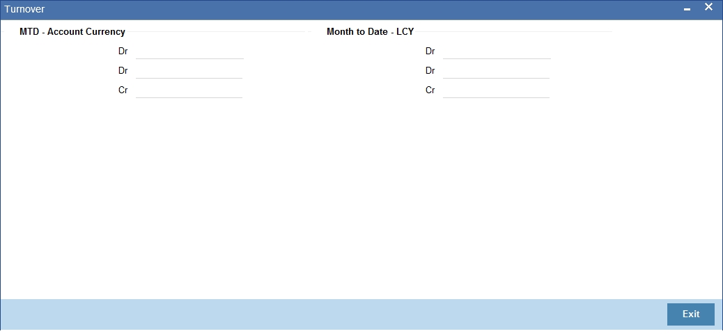

In the Customer Account - Turnover Amounts screen you can view the total turnover of this customer account from the first date of this month to the current day’s system date. Also, you can view the accumulated interest associated with debit or credit transactions after the last liquidation.
To view the turnovers for the account, click the ‘Turnover’ button. The Customer Accounts - Turnover Amounts screen is displayed.
After maintaining the required details, you can return to the Amounts and dates screen.

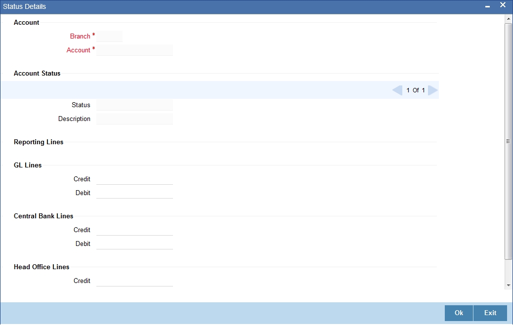

Status Details
The account status reflects the status of the account. The account may have a No Credit or No Debit order issued against it or a Stop Payment order or it may have been frozen for some reason and therefore dormant.
While posting transactions to the customer account, the system checks the status of the account before the entry is processed. If the status of the account is dormant, then the system will display an override message indicating the same.

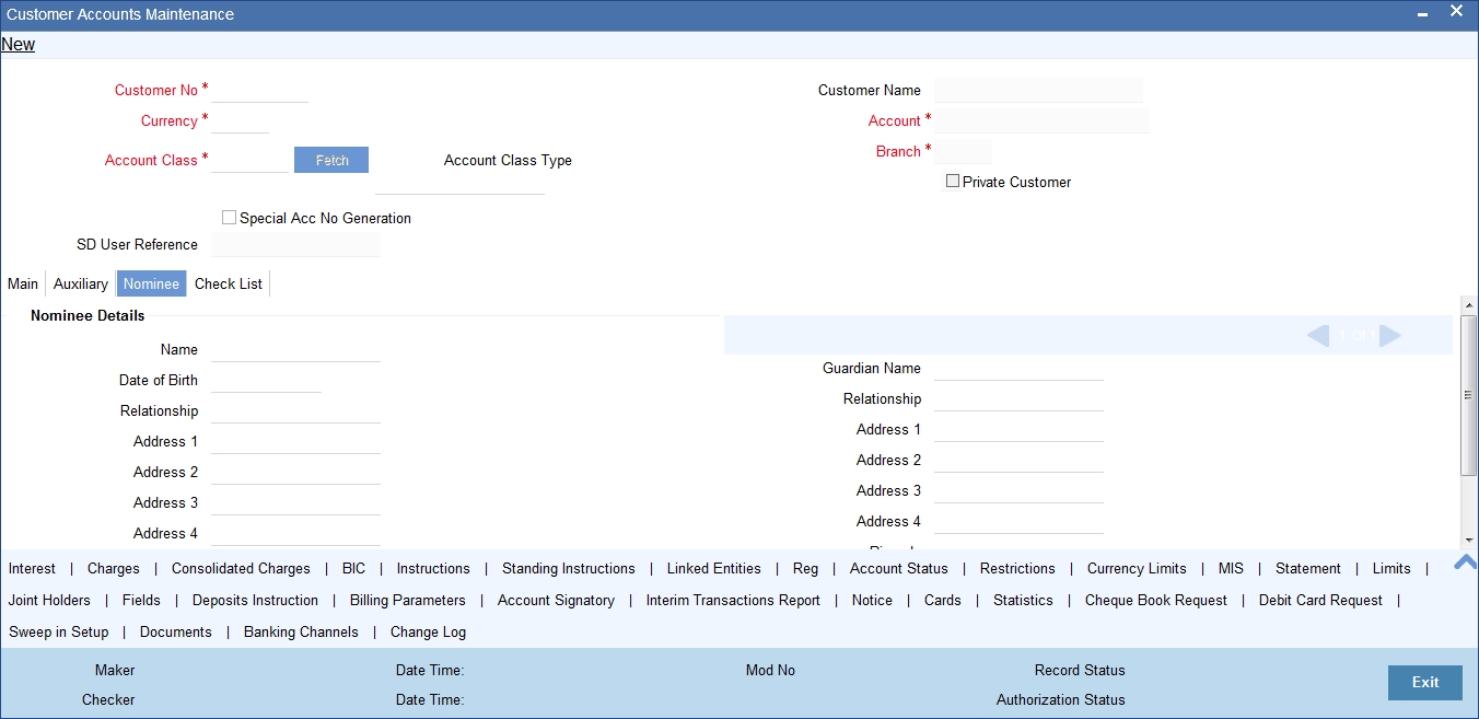

First Nominee
You can nominate two persons who would have the right to the balances in your account after the account holder’s demise
Subsequent to the account holder, the first nominee is called to claim the balances in the account. If the first nominee is no more or is missing then the second nominee is called upon to claim the balances in the account.
Second Nominee
You can nominate two persons who would have the right to the balances in your account after the account holder’s demise.

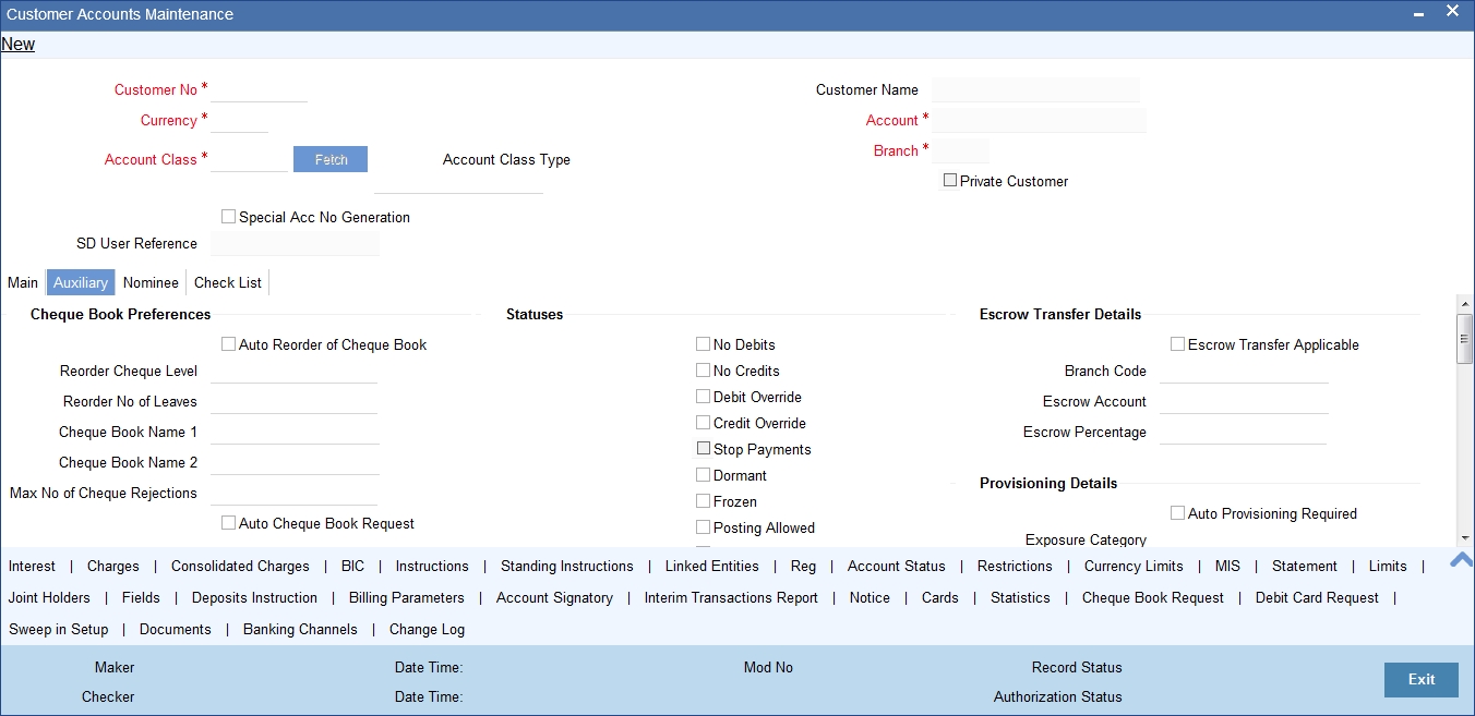

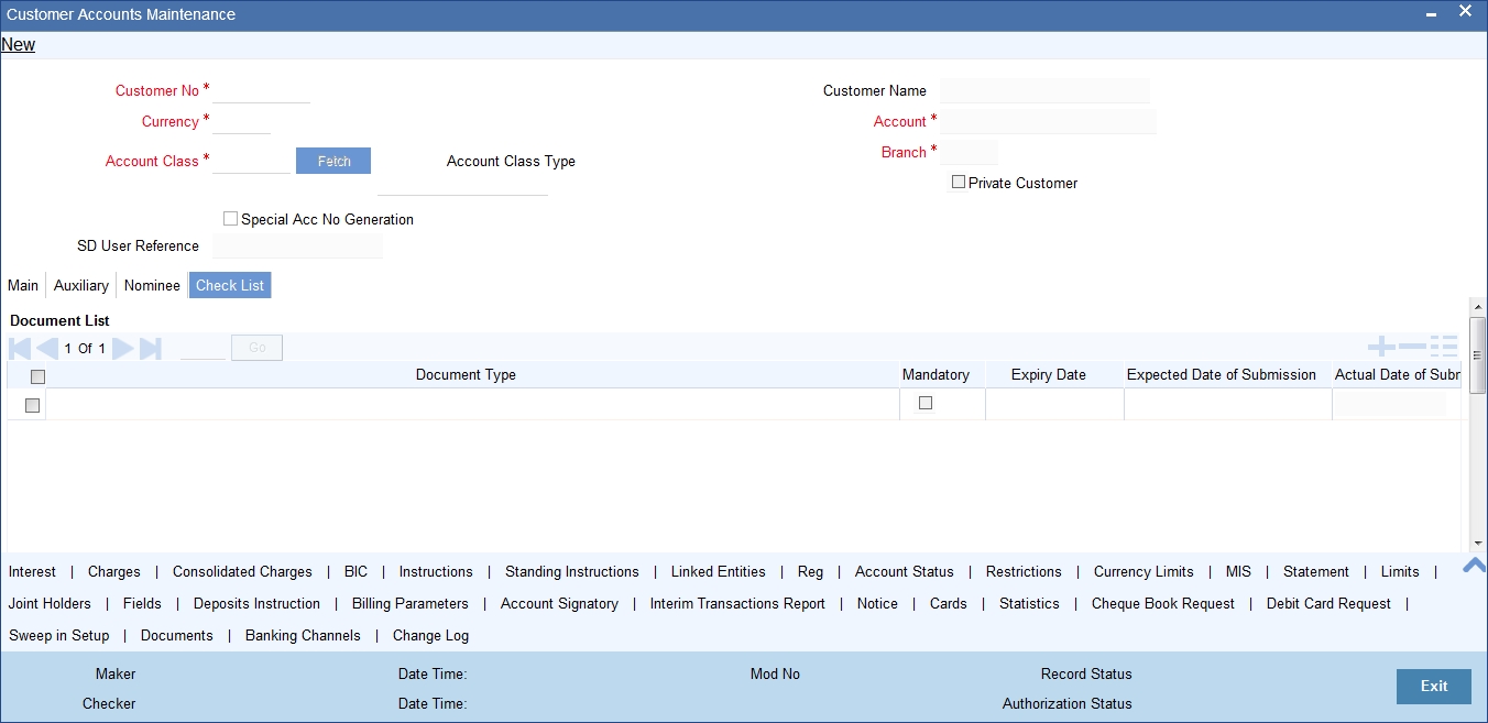

Click on the ‘Auxiliary’ tab to invoke the following screen.

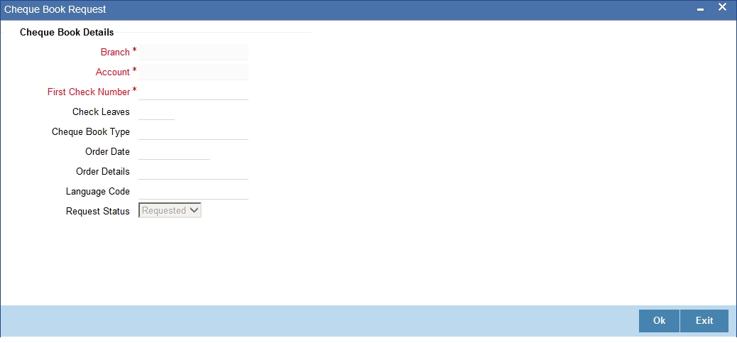

Auto Reorder of Cheque Book
Check this box to automatically generate a reorder for chequebook, based on the number of leaves outstanding. This field will be enabled only if you have checked the ‘Cheque Book’ Check box.
Reorder Cheque Level
This field specifies the level at which the re-order of cheque book happens. Re-ordering of the check book is possible, only if the unused cheque leaves is equal or less than the re-order level. This field will be enabled only if you have checked the 'Auto Re-order of Cheque book' check box.
Reorder No of Leaves
This field specifies the number of leaves, which should be ordered for the new cheque book . This field will be enabled only if you have checked the ‘Auto Re-order of Cheque book’ check box.
Cheque Book Name1 & Cheque Book Name 2
Specify the name mentioned in the cheque book, while printing the cheque leaf.
Note
It is mandatory to specify cheque Book Name1 if the cheque book box is enabled in main screen.
Max No. of Cheque Rejections
The system defaults the value of maximum number of cheque rejections that can be allowed for an account from the account class. However, you can modify it at the account level.
Note
Auto Cheque Book Request
Check this box if you want the system to create a request for the cheque book automatically, for the account during account creation.
When you check this box, the system allows you to capture cheque book request details in the Cheque Book Request screen, as part of account creation.
Branch
Specify the branch code of the account.
ATM Account Number
Specify the ATM account number in this field only if you have opted for the ATM facility for that account. The ATM account number which is a numeric value will be used only for information purpose and no further processing will be done based on this field.
Daily Amount Limit
Specify the daily limit of the amount that can be withdrawn from the ATM.
Daily Count Limit
Specify the maximum number of times the customer is allowed to use ATM facility in a day.
Auto Debit Card Request
Check this box, if you want the system to create a request for the debit card automatically, for the account during account creation.
When you check this box, the system allows you to capture debit card request details in the Debit Card Request Details screen, as part of account creation.

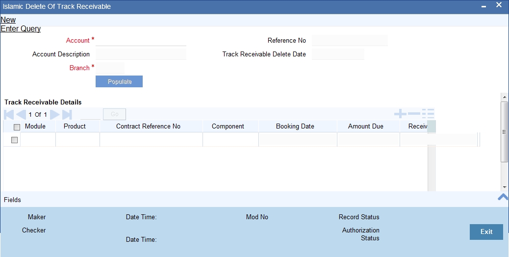

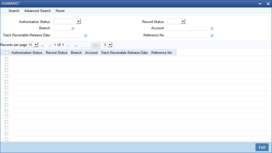

Track Receivable
During liquidation of loan contracts as well as processing of retail teller contracts, if the system detects insufficient funds in the settlement account, then you can choose to block the subsequent credit that happens to the settlement account. In other words, the system will track the account for receivables (credits). As and when a credit happens, the funds will be allocated to the loan or retail teller contract, for liquidation. If the track receivable option is checked for the account, the system will track the receivables for the account if sufficient funds are not available in the account.
The allocation of funds will happen in a sequence that you specify at the account class level. This is explained in the section titled ‘Maintaining Account Classes’.

No Debits
No debits can be posted to the account. For example, Silas Marner, a customer of your bank, going abroad for a year instructs you not to debits his account till his return. You can execute this instruction by checking this box.
No Credits
No credits can be posted to the customer account by enabling the check box positioned next to this field.
Debit Override
Check this box to selectively allow or restrict debit transactions from a particular account. This check box is disabled once the account is authorized. You can further modify the debit override status from 'Manual Status Change' screen or 'Bulk Account Status Change' screen.
If an account is updated with both 'No Debit' and 'Debit Override' status, the system will consider the functionality of No Debit status over Debit Override status.
Credit Override
Check this box to selectively allow or restrict credit transactions to a particular account. This check box is disabled once the account is authorized. You can further modify the credit override status from 'Manual Status Change' screen or 'Bulk Account Status Change' screen.
If an account is updated with both 'No Credit' and 'Credit Override' status, the system will consider the functionality of No Credit status over Credit Override status.
Stop Payments
If a stop payment instruction is issued (for a cheque or an amount) against the account number, the system will automatically check the ‘Stop Payment’ box. When the stop payment instruction is withdrawn, the status gets updated accordingly. If a customer has requested for stop payment of multiple cheques, the ‘Stop Payment’ option will continue to remain checked till the last request is also cancelled. After cancellation of the last stop payment instruction, the option gets updated (unchecked) immediately.
Dormant
The system updates this status for an account based on the dormancy days specified in the Account Class Maintenance screen
Frozen
If you have frozen a customer account in the ‘Customer Information Maintenance – Basic’ screen the accounts gets frozen. For instance, at the behest of a court order, the status of the account is reflected here in the ‘Customer Accounts Maintenance’ screen.
Posting Allowed
The system checks or unchecks this check box based on the value maintained at Account Class level.
This check box facilitates Inter-branch Accounting through Entity/Accounts instead of GLs. The accounts maintained for these Inter-Branch transactions are used only for posting system generated Inter-Branch entries and not for any direct posting using ‘Journal Entry’ or Teller Transaction screens.
Status Change Automatic
This specification will be defaulted from the account class to which the account belongs. However, you have the option of changing it at the customer account level. If you check this option, the status of the account will be changed automatically by the system as per the conditions maintained in the ‘Status Rule Definition’ screen (invoked from the Account Class Maintenance screen). If you do not select this option, you have to change the status manually through the ‘Manual Status Change’ screen.
For details on conditions maintained in the ‘Status Rule Definition’ screen, refer the chapter ‘Maintaining Mandatory Information’ in the Core Entities user manual.
Overdraft
The system displays a check in the check box if the customer account has overdraft facility. The system checks or un-checks the check box based on the information available in Account Class Maintenance.
Note
If you want to amend any of above statuses, you can do only via 'Manual Status Input' screen.

Propagate Reporting Details
This field indicates whether the reporting lines defined for status movement, for the account class that this account reports to, must also be applicable to it.
The following GL’s are defined in the Account Class Maintenance for posting account balances when a status movement occurs on any accounts belonging to the account class:
When you select this option, the GL’s maintained for the account class will be applicable to the customer account you are defining in this screen. The reporting lines will be propagated to the account whenever a status change occurs.
If you do not want the account class details to be propagated to the account as well, you have the option of maintaining the status codes and the reporting lines exclusively for an account. You can achieve this through the ‘Status Details’ screen. Click the ‘Account Status’ button in the Customer Accounts Maintenance screen to invoke it.

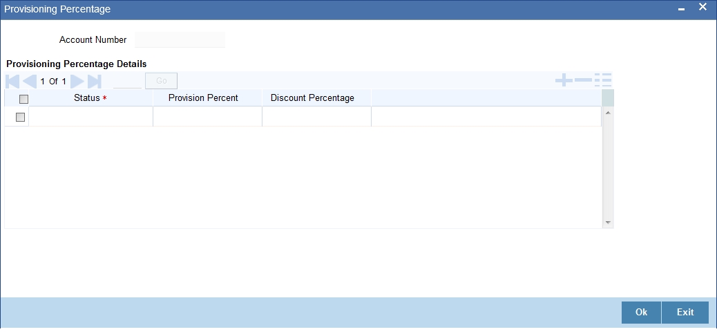

An account inherits the provisioning parameters defined for the account class it uses. You can change the defaulted parameters and make the following specifications, as required, in the Provision Details section of the Customer Account Maintenance screen:
Auto Provisioning Required
You can indicate whether the provisioning for bad loans in corporate loans and deposits module is applicable for the account. If you indicate so, the provisioning batch, when executed, picks up the account for provisioning.
Exposure Category
If the logic for deriving the exposure category of the CIF or customer group to which the customer belongs, based on the total exposure, has been maintained in the Exposure Type Category Linkage maintenance, then the exposure category of the account is identified. If no logic has been maintained, you can specify the exposure category in the Customer Account Maintenance screen.
Risk Free Exposure Amount
You can indicate the risk-free collateral amount that would be used in computing the provisioning amount for the account.
Provisioning Currency
You can indicate the currency in which the provisioning amount must be calculated – either account currency or local currency. This specification is defaulted from the preferences for the account class used by the account, and you can alter it if necessary.
In addition to the provisioning preferences listed above, you must also indicate the applicable provisioning percentage and the discount percentage details in the Provision Percentages screen that you can invoke by clicking on the ‘Provisioning Percentage’ button in the Provisioning Details section of the ‘Customer Account Maintenance’ screen.
Account Number
The system displays the customer account number
Status
Specify the status of the account for which you are maintaining provisioning percentages. The adjoining option list displays all valid status codes maintained in the system. Select the appropriate one.
Provision Percent
If you wish to indicate a specific provisioning percentage to be applicable for the account, you can specify it in the Provisioning Percentage screen.
If you do not specify any provisioning percentage, the provisioning batch picks up the applicable provisioning percentage from the Exposure Provisioning Percentage Maintenance, for the exposure category of the account and the account status.
Discount Percentage
If you wish to indicate a specific discount percentage to be applicable for the account, you can specify it in the Provisioning Percentage screen.
If you do not specify any discount percentage, the provisioning batch picks up the applicable discount percentage from the Exposure Provisioning Percentage Maintenance, for the exposure category of the account and the account status.

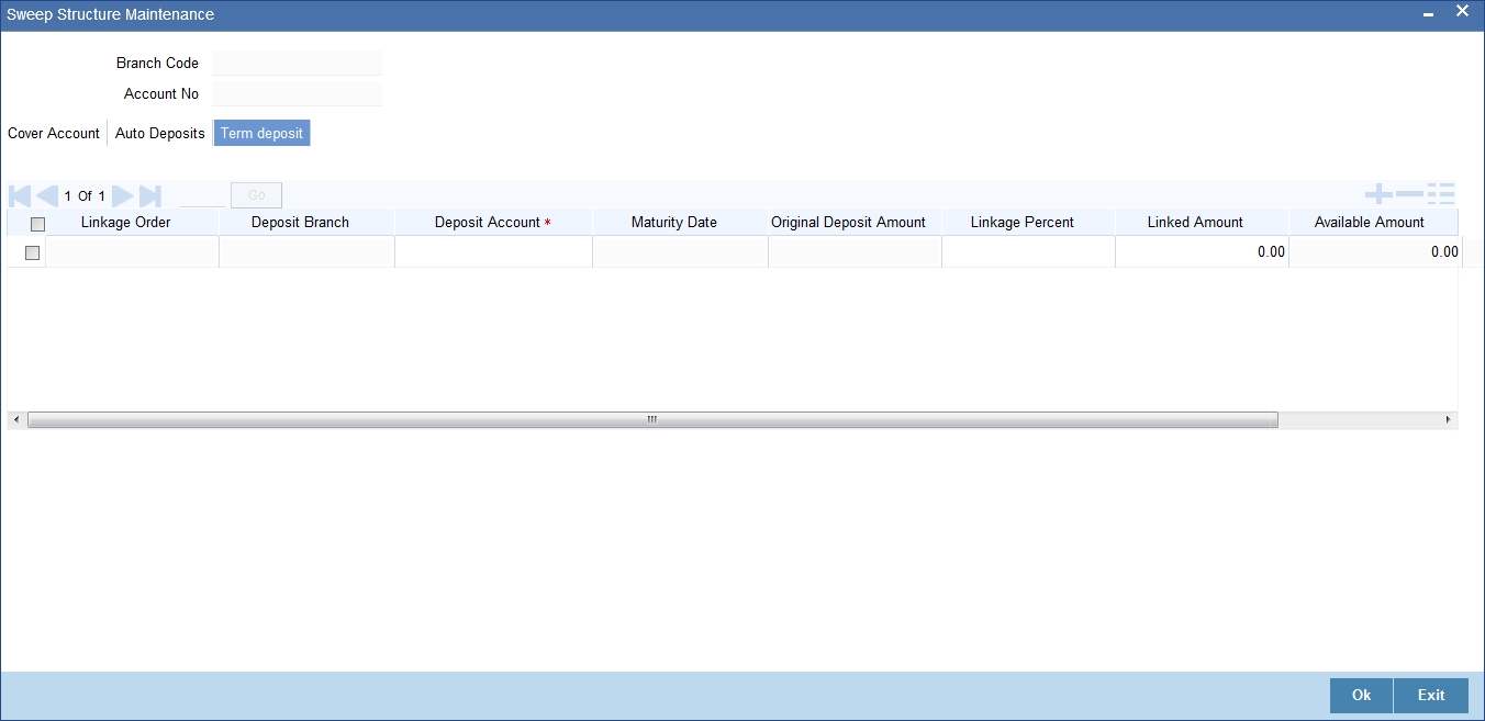

Enable Sweep In
The system checks or unchecks the check box based on the status maintained at Account Class Maintenance level.
Enable Reverse Sweep in
System displays the passbook details here,
Passbook Number
The system displays the latest passbook number. You cannot modify the value.
Passbook Status
The system displays the current status of the passbook. You cannot modify the value
Note
Passbook details get populated once the passbook is issued for the customer account with the latest status and latest passbook number issued.

Click ‘Nominee’ tab in the ‘Customer Accounts Maintenance’ screen in order to capture nominee details for the account.
Specify the following details:
Name
Specify the name of the nominee of the account.
Date of Birth
Specify the date of birth of the account nominee.
Relationship
Specify the relationship that the nominee shares with the primary account holder.
Address 1 – 4
Specify the address of the nominee.
Minor
Check this box to indicate that the nominee is a minor (less than 18 years old).
Guardian Name
In case the nominee is a minor, specify the name of the nominee’s guardian.
Relationship
Specify the relationship that the nominee shares with the guardian.
Address 1 – 4
Specify the guardian’s address.
Click the ‘Check List’ tab from the ‘Customer Accounts Maintenance’ screen to capture the details of document types that are to be maintained.
Document Type
Specify the document type. The adjoining option list displays all the document types that are maintained in the system. You can select the appropriate one.
Mandatory
Check this box to indicate that the document specified here is mandatory.
Expiry Date
Specify the expiry date of the document provided by the customer.
Note
Expiry date will always be greater than ‘Expected Date of Submission’ and ‘Actual Submission Date’.
Expected Date of Submission will always be greater than current date.
Specify the expected date on which the customer is accepted to submit the required documents.
Actual Date of Submission
System displays the actual date on which customer has submitted the required documents.
Document Reference
System defaults the document reference here.
Checked
Check this box to indicate that the received documents are acknowledged.
Note
You cannot save and authorize an account if the mandatory documents are not confirmed as ‘Checked’.
Upload
Click on this button to upload the selected document type.
Delete
Click on this button to delete the selected document.
View
Click on this button to view the selected document.
System defaults notification details from the ‘Account Class Maintenance’ screen.
Send Notification
This check box indicates whether to send notifications or reminders for not submitting the mandatory documents.
Reminder Frequency (Notification)
System defaults the frequency of notification to be sent. The frequency can be one of the following:
Notes
The check box ‘Send Notification’ is checked in Account Class Maintenance’ screen.
The account status is active and authorized.
The mandatory documents are not submitted.
Days (Reminder)
System defaults the number of days left for the expiry or submission due date of the documents for sending the reminder.
System will send the following reminders:
Note
If there are more than one notifications or reminders of the same message type for which the notification schedule date falls on the same day for the same account, a single notification will be sent which will have the details of all the related documents.
Remarks 1 to 10
Specify the additional information, if required.
You can capture additional details for the account by clicking the following buttons in the ‘Customer Accounts Maintenance’ screen:
Button |
Function |
Interest |
This invokes the ‘IC Special Conditions Maintenance’ screen. |
Charges |
This invokes the ‘Account level charges conditions’ screen. |

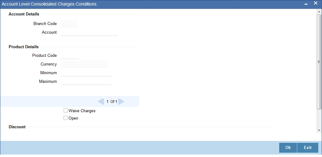

Consolidated Charges |
This invokes the ‘Account Level Consolidated Charges Conditions’ screen. |
BIC |
This invokes the ‘Authorized SWIFT BICs for Customer Account’ screen. |

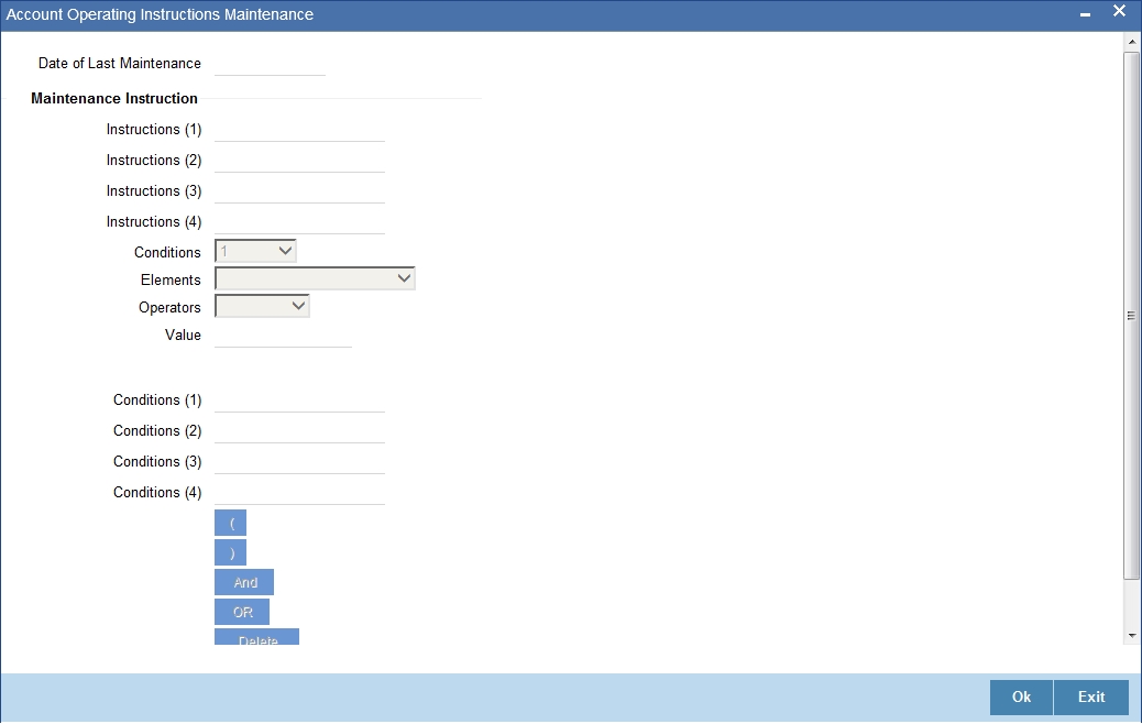

Instructions |
This invokes the ‘Account Operating Instructions Maintenance’ screen. |

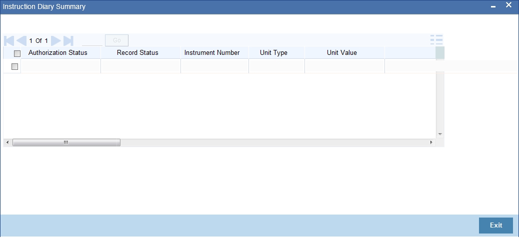

Standing Instructions |
This invokes the ‘Instruction Diary Summary’ screen. |
Linked Entities |
This invokes the ‘Linked Entities’ screen. |
REG |
This invokes the ‘REG Details’ screen. |
Account Status |
This invokes the ‘Status Details’ screen. |

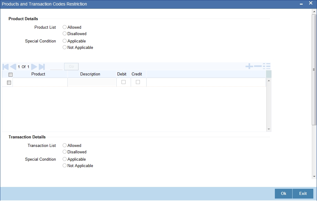

Restrictions |
This invokes the ‘Products and Transaction Codes Restriction’ screen. |

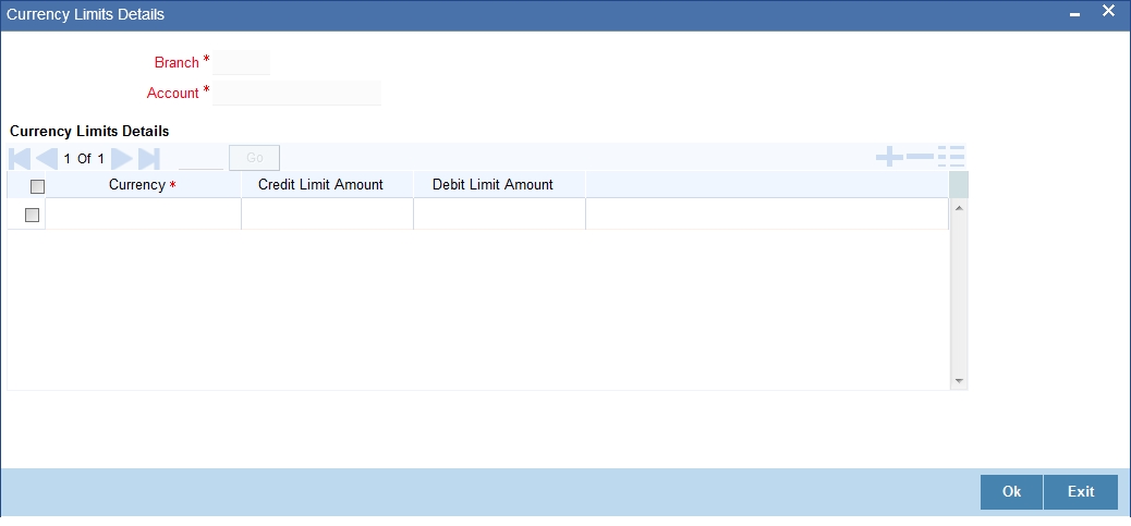

Currency Limits |
This invokes the ‘Limits’ screen. |

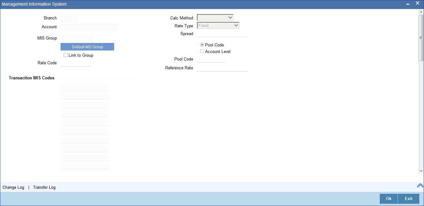

MIS |
This invokes the ‘Management Information System’ screen. |
Statement |
This invokes the ‘Statement Details’ screen. |

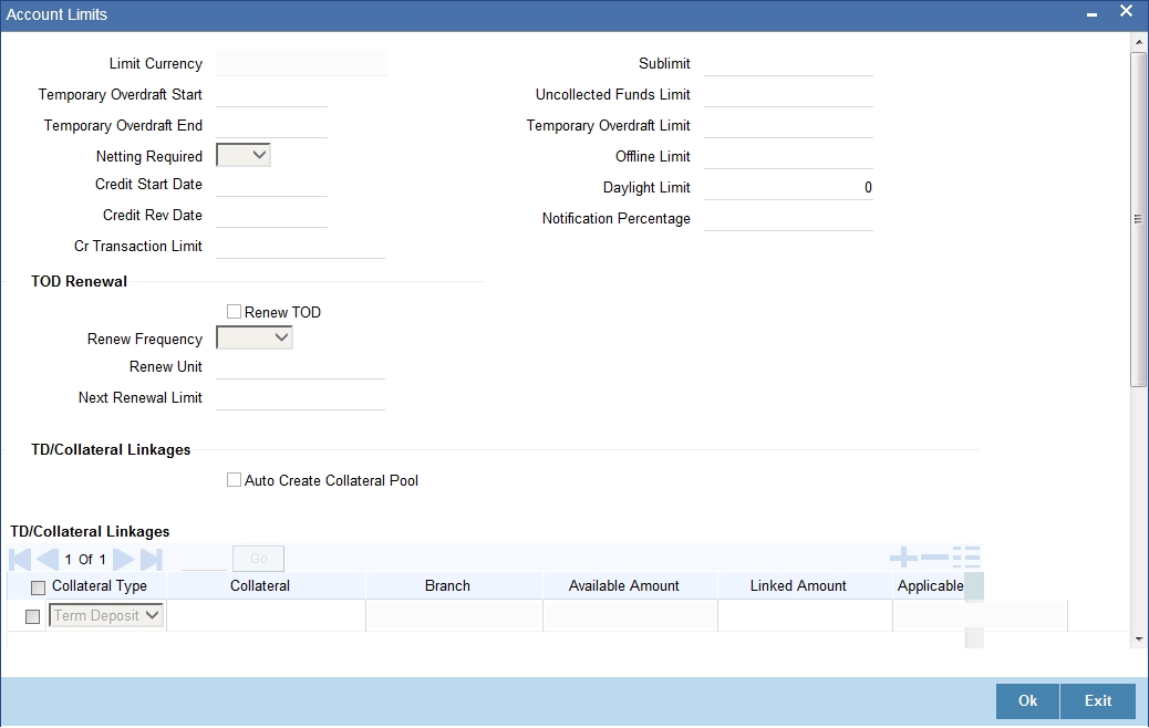

Limits |
This invokes the ‘Account Limits’ screen. |
Joint Holders |
This invokes the ‘Joint Holder screen. |
Fields |
This invokes the ‘UDF’ screen. |

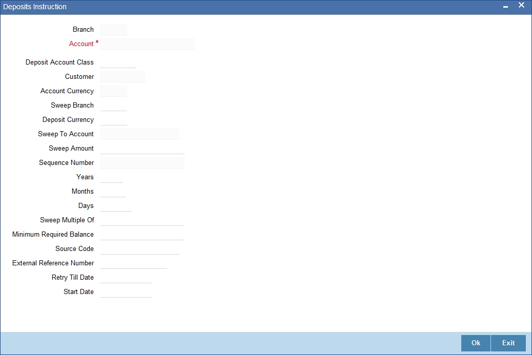

Deposits Instruction |
This invokes the ‘Deposits Instruction’ screen. |

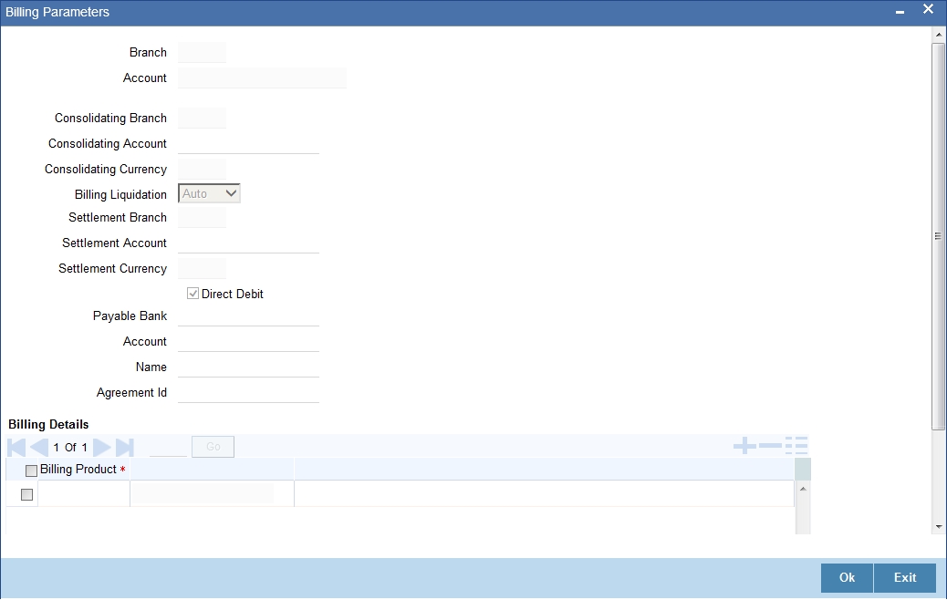

Billing Parameters |
This invokes the ‘Billing Parameters’ screen. |

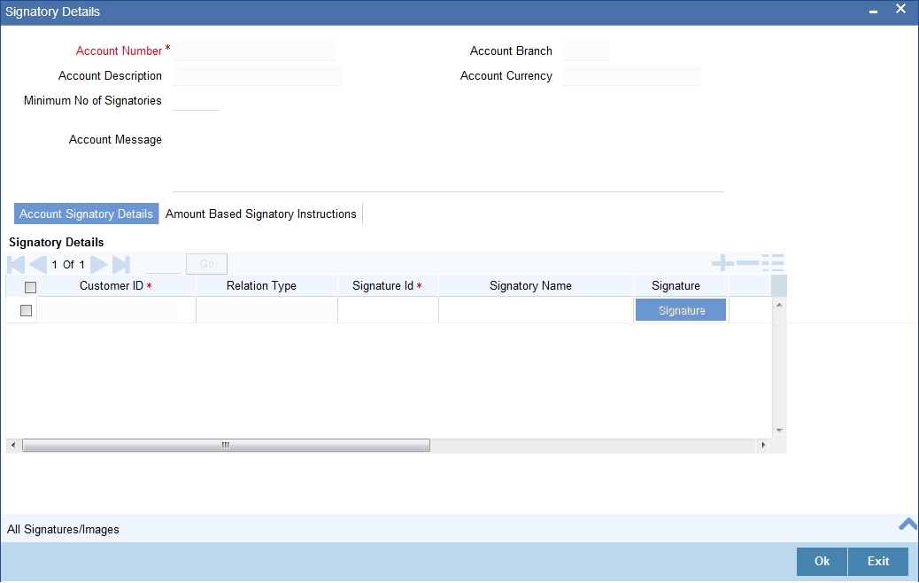

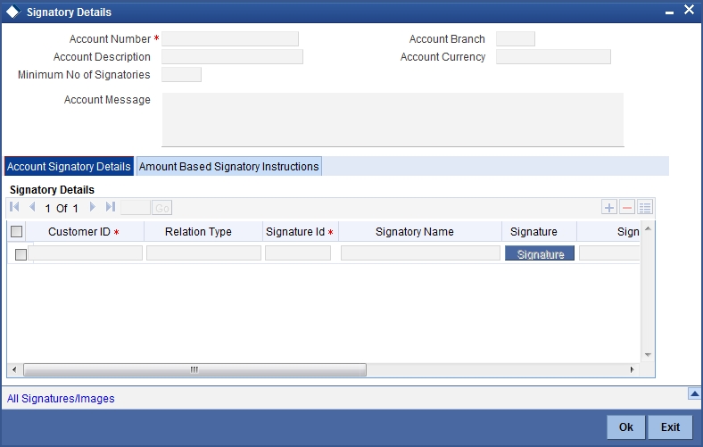

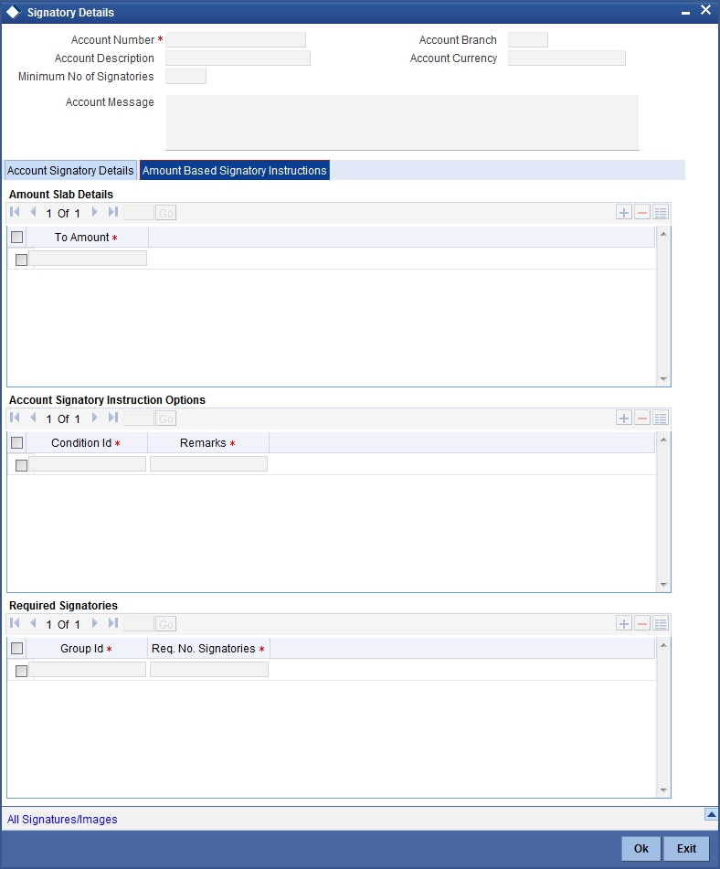

Account Signatory |
This invokes the ‘Signatory Details’ screen. |

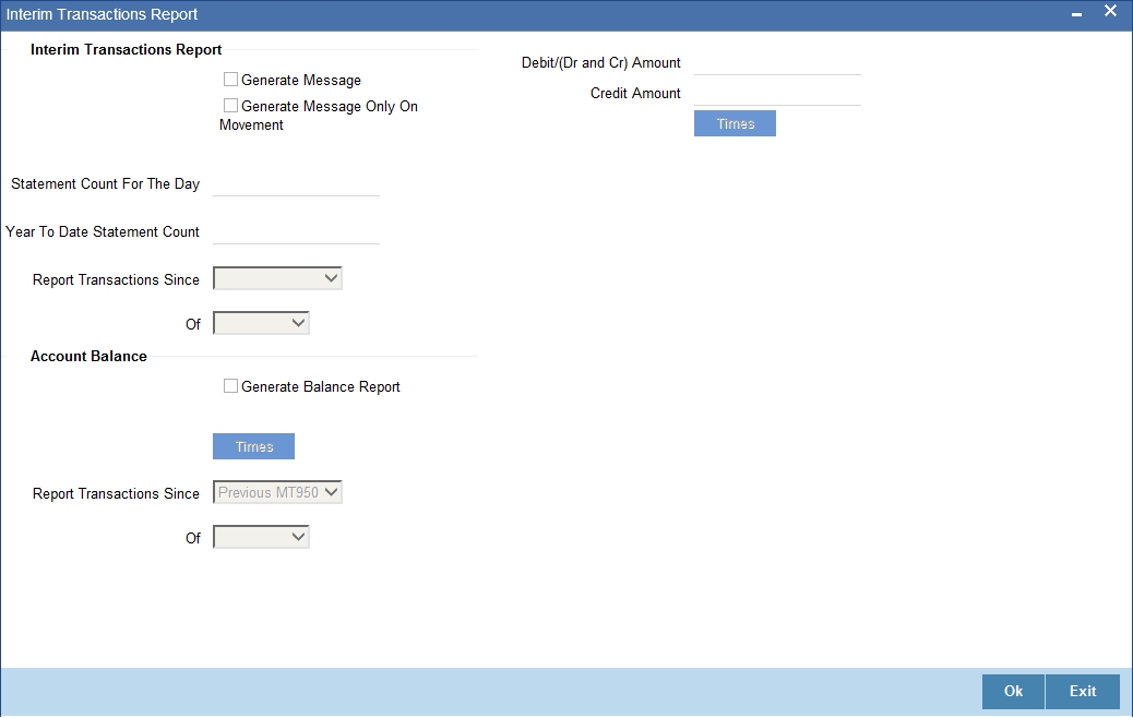

Interim Transactions Report |
This invokes the ‘Interim Transactions Report’ screen. |

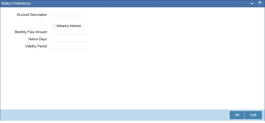

Notice |
This invokes the ‘Notice Preferences’ screen |

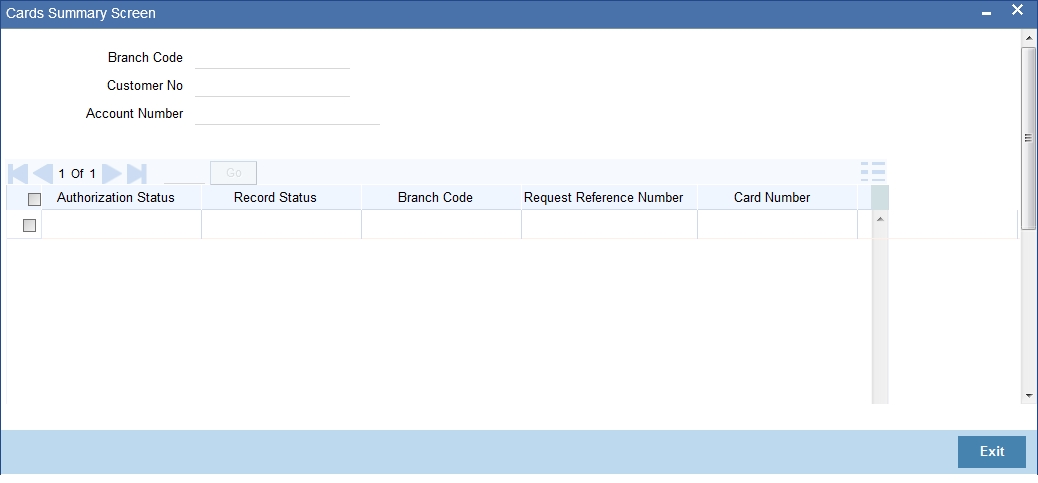

Cards |
This invokes the ‘Cards Summary’ screen. |
Statistics |
This invokes the ‘Account Statistics’ screen. |
Cheque Book Request |
This invokes the ‘Cheque Book Request’ screen. |
Debit Card Request |
This invokes the ‘Debit Card Details’ screen. |

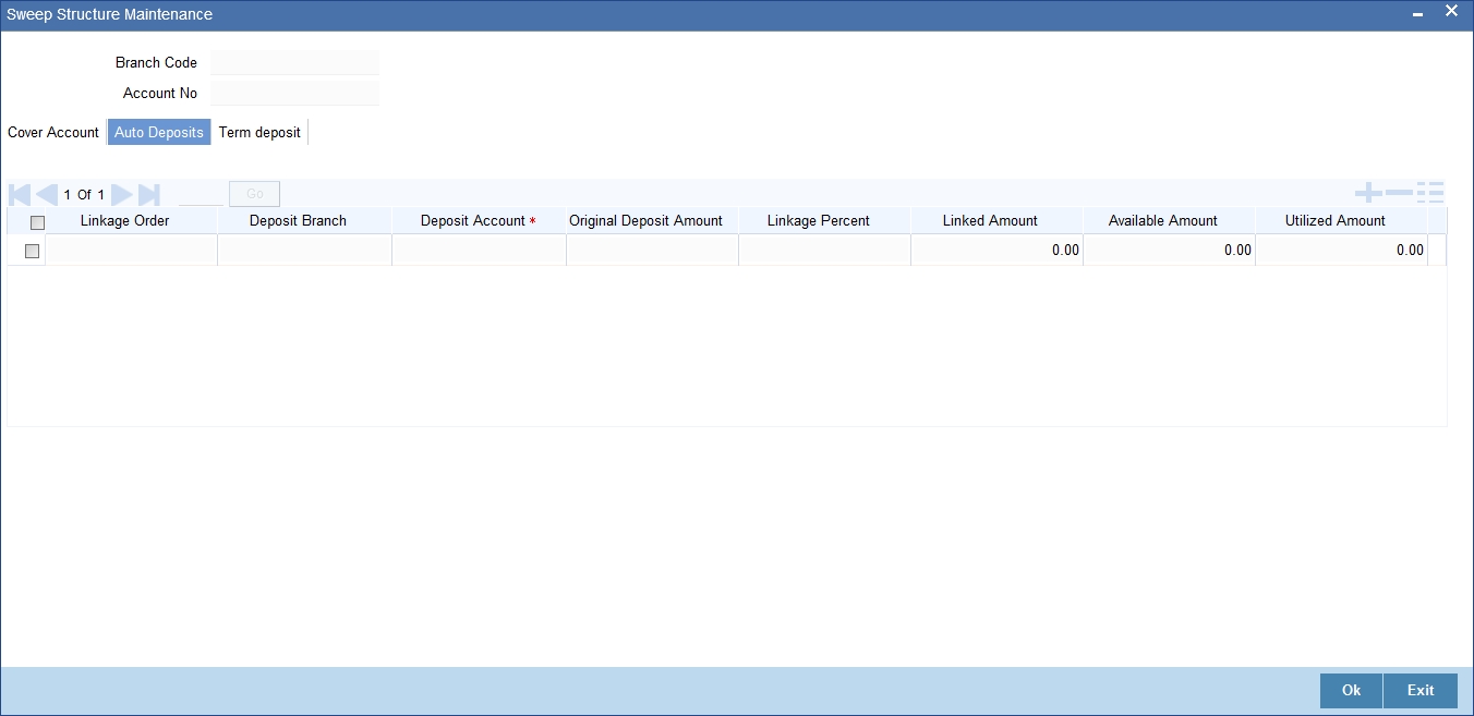

Sweep In Setup |
This invokes the ‘Sweep Structure Maintenance’ screen, |
Documents |
This invokes the ‘Document Upload’ screen, |

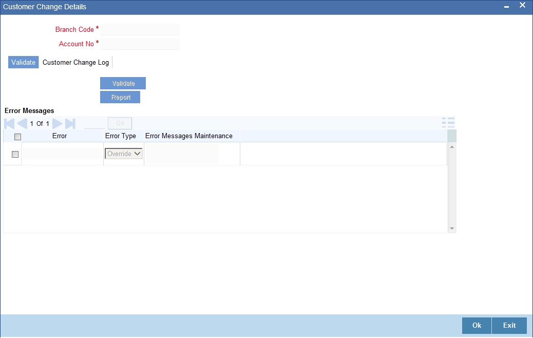

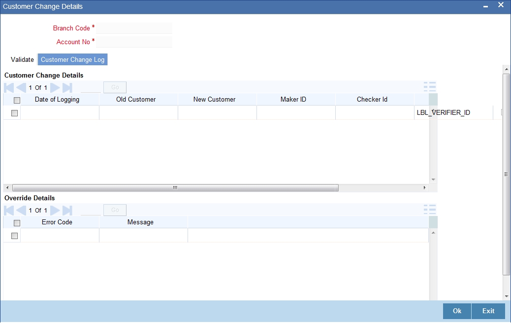

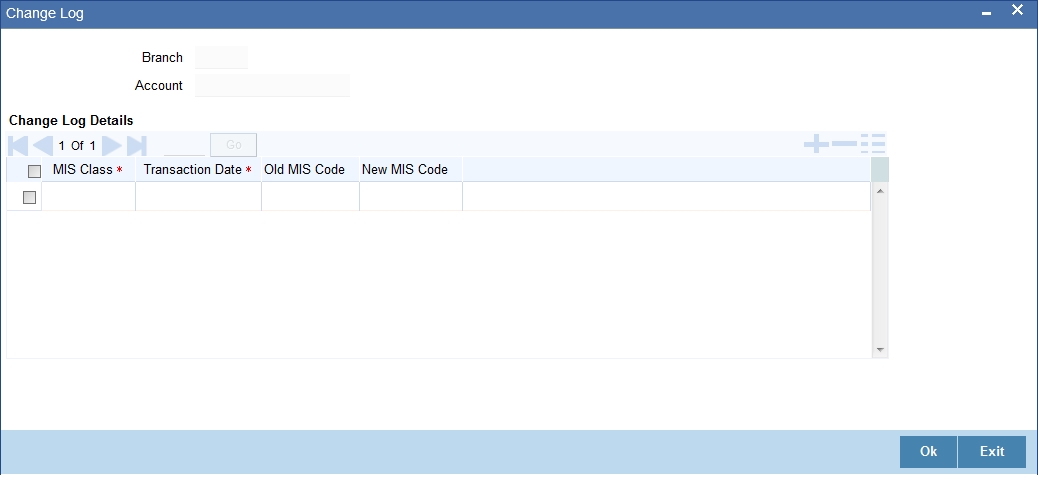

Change Log |
This invokes the ‘Customer Address Change Log’ screen. |

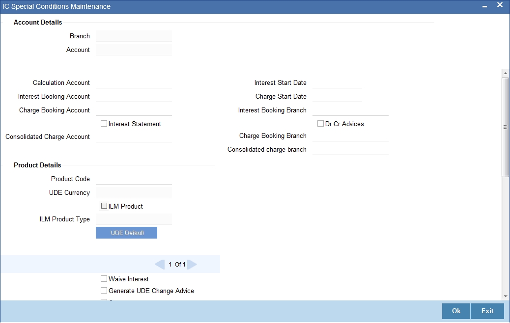

You can capture details of interest for the account, using the ‘IC Special Conditions Maintenance’ screen. Click the ‘Interest’ button in the ‘Customer Accounts Maintenance’ screen to invoke this screen.
Interest Booking Branch
By default, the customer’s account in the current branch will be displayed in this screen (in the Interest/Charge Booking Account and Interest/Charge Booking Branch fields). However, you have the option of booking interest/charge to a different account belonging to another branch also. You can select the Interest/Charge Booking Branch from the option-list available. ]The accounts maintained in the selected Booking Branch will be available in the option-list provided for Interest/Charge Booking Account. You can select the account from this list. Interest/Charge will be liquidated into the selected account.
Interest Booking Account
You can select the accounts for booking interests on transactions processed at your bank.
At the time of creating an IC product, if you have maintained the booking account type as Interest (in the ‘Interest and Charges – Product Definition’ screen), the Interest will be liquidated into the Interest Booking account. By default, the customer’s account in the current branch will be displayed in this screen (in the ‘Interest Booking Account’ field). However, you have the option of booking interest to a different account belonging to another branch also. The accounts maintained in the selected Booking Branch will be available in the adjoining option list. You can select the appropriate account. Interest will then be liquidated into the selected account.
Calculation account
Specify the calculation account. When you specify a calculation account, then all balances and turnovers for the specified account are clubbed with the balances and turnovers for the combined account for calculation purposes.
By default, the customer’s account in the current branch will be displayed in this screen (in the Interest/Charge Booking Account and Interest/Charge Booking Branch fields). However, you have the option of booking interest/charge to a different account belonging to another branch also. You can select the Interest/Charge Booking Branch from the option-list available. The accounts maintained in the selected Booking Branch will be available in the option-list provided for Interest/Charge Booking Account. You can select the account from this list. Interest/Charge will be liquidated into the selected account.
You can select the accounts for booking charges on transactions processed at your bank
At the time of creating an IC product, if you have maintained the booking account type as Charge (in the ‘Interest and Charges – Product Definition’ screen), the charge will be liquidated into the Charge Booking account. By default, the customer’s account in the current branch will be displayed in this screen (in the ‘Charge Booking Account’ field). However, you have the option of booking charge to a different account belonging to another branch also. The accounts maintained in the selected Charge Booking Branch will be available in the adjoining option list. You can select the appropriate account. Charges will then be liquidated into the selected account.
Interest Statement
You can also indicate if you would like to generate an interest statement for the account. The Interest Statement will furnish the values of the SDEs and UDEs and the interest rule that applies on the account.
Consolidated Charge Branch
By default it will be same as the current branch. However you can select the branch of the consolidated charge account from the adjoining option list.
Consolidated Charge Account
The consolidated charge will be a group of charge products that are linked to one IC product. Select the account that is identified as the master account for collecting the consolidated Fall Below Fee.
The Fall Below Fee is a kind of fee that is charged if sum of average monthly balance of all the accounts is less than the minimum required balance.
Note
Dr Cr Advices
You can indicate whether you want to generate an interest liquidation advice for a customer account. Check the ‘Debit/Credit Advices’ box to indicate that the system must generate payment advices when interest liquidation happens on an account. The advices are generated in the existing SWIFT or/and MAIL format. No advices will be generated if you leave this box unchecked.
The preference you have made in the Customer Account Class screen will be defaulted here. However, you can choose to change your preference to generate or suppress these Advices.
Interest Start Date
For the account for which you are defining special conditions, you must specify the date from which you would like to apply interest. Interest for this account will be calculated according to the special conditions that you define subsequently.
Charge Start Date
For the account for which you are defining special conditions, you must specify the date from which you would like to apply charges. Charges for this account will be calculated according to the special conditions that you define subsequently.
By default, charges on an account would be applied when the free banking period (if any) elapses. This means that the Charge Start Date is arrived at by the System by adding the Free Banking Period days (if any, specified for the account class used by the account) to the Account Opening Date. If no Free Period has been indicated for the account class used by the account, the Charge Start Date is defaulted to the Account Opening Date (that is, charges on the account would be applied right from the account opening date) and displayed in the Special Conditions Maintenance screen.
You can override the default Charge Start Date and specify the desired start date for charge application.
Product
To calculate interest for an account, you must apply an interest product on the account. To recall, every interest product that you create is linked to an interest rule. The logic to calculate interest is built into an interest rule. When you apply an interest product on the account, interest for the account will be calculated according to the interest rule definition.
For the account for which you are defining special conditions choose the product(s) that you wish to apply. To recall, you can define a Special Condition for an account only if the account class of the account has a General Condition defined for the product. Thus, the picklist from where you select the product for which you want to define a Special Condition will contain products that satisfy one of the following conditions:
The interest rule that is linked to the product(s) will determine the interest that is applied on the account.
You may want to apply more than one interest product on an account. For example, you may want to pay credit interest on the credit balance maintained in a current account and levy a debit interest if the account lapses into a debit balance. In order to achieve this, you would have to apply two products (one defined for credit interest and another defined for debit interest). In this screen, you can choose the interest products that you want to apply on an account.
Note
The UDE currency, defined for the product (in the Interest Product Preferences screen) that you apply on the account, is displayed. Note that the UDE values that you specify for the account subsequently will be taken to be in this currency.
You can opt to generate an advice, for the benefit of the customer, when the values of the UDEs defined for the interest rule change.
Generate Rate Change Advice
Check the box ‘Generate UDE change advice’ at account level, to indicate that interest rate change advice has to be generated for the account at EOD. System generates interest rate change advices for Customer Accounts and Savings accounts when the interest rate changes as part of EOD. For those accounts, when interest rate changes the details are handed off for rate change advice generation and the same is generated in the pre determined swift format as per MT 935.
The advice tag used for interest rate change is RTCHG_ADVICE.

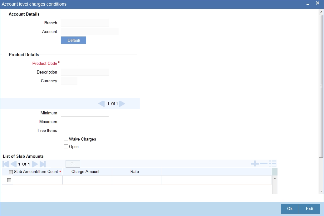

You can capture details of charges for the account, using the ‘Account level charges conditions’ screen. To invoke this screen, click the ‘Charge’ button in the ‘Customer Accounts Maintenance’ screen.
Branch Code
The Branch Code to which the account belongs (for which you are defining special conditions) is displayed in this field.
Account
The Account number of customer (for which you are defining special conditions) is displayed in this field.
Note
You can click the ‘Default’ button to default the Charge Products and the corresponding details applicable for the account. You can then modify these values to define the special conditions.
Product
The system defaults a product when you click the ‘Default’ button at the time of account creation. You must modify it to identify the Charge product using which the applicable charges would be collected.
Currency
The charges would be collected in the currency defined for the selected charge product, and this currency is displayed on the screen.
Minimum and Maximum
You must indicate the charge amount range, representing the minimum and maximum charge that can be applied for the account.
Free Items
You must indicate the number of free items for which the customer will not be charged. The number of free items is derived based on the charge basis defined for the charge product in the IC module.
Open
By default, each charge consolidation charge setup that you set up is enabled and active. You can also disable the setup by checking the ‘Open’ box.
Waive Charges
You can choose to waive charges for an account.
You can capture details of consolidated charges for the account, using the ‘Account Level Consolidated Charges Conditions’ screen. To invoke this screen, click the ‘Consolidated Charge’ button in the ‘Customer Accounts Maintenance’ screen.
Branch
Product
You must identify the consolidated charge product using which the applicable charges would be consolidated. The charges would be consolidated in the currency defined for the selected consolidated charge product, and this currency is displayed on the screen.
When you opt for a consolidated charge product, all the consolidated charge parameters defined for the selected product are defaulted to the account for which the product has been linked. You can change the default in respect of the following parameters:
Currency
Minimum
You must indicate the minimum charge that can be applied for the account.
Maximum
You must indicate the maximum charge that can be applied for the account.
Open
By default, each charge consolidation charge setup that you set up is enabled and active. You can also disable the setup by checking the Open box.
Waive Charges
You can choose to waive consolidated charges for an account.
Discount Amount
In this field, you can indicate the flat discount amount, if any, which would be applicable for the consolidated charge calculated for the account. After the discounting has been applied, the Maximum and Minimum validations are performed.
Alternatively, the discount, if any, which is applicable, can be specified as a percentage of the calculated consolidated charge amount.
Discount Percentage
You can indicate the discount percentage, if any, which would need to be applied to the calculated charge. After the discounting has been applied, the Maximum and Minimum validations are performed.
The discount, if any, which is applicable, can also be specified as a flat discount amount.

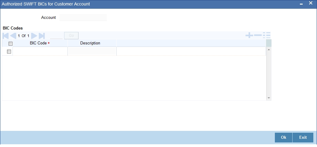

You can capture details of all SWIFT BIC that should be allowed for a customer account, using the ‘Authorized SWIFT BICs for Customer Account’ screen.
To invoke this screen, click ‘BIC’ button in the ‘Customer Accounts Maintenance’ screen.
Account Number
The system defaults the account number of the customer in this field.
BIC Code
Specify the BIC here. You can choose any valid BIC maintained in the ‘BIC Code Maintenance’ screen.
Description
The system displays the description for the corresponding BIC that you have specified.
You can capture details for operating the account, using the ‘Account Operating Instructions Maintenance’ screen. To invoke this screen, click ‘Instructions’ button in the ‘Customer Accounts Maintenance’ screen.
Date of Last Maintenance
The current system date is also displayed
Instructions
Specify the instructions to be borne in mind when operating a customer account
Conditions
You can maintain the instructions using the above screen during the account opening. The maintained instructions can be viewed from the 'Account Maintenance' screen invoked from Signature Verification screen.

You can capture details of standing instructions for the account, using the ‘Instruction Diary Summary’ screen. To invoke this screen click the ‘Standing Instructions’ button in the ‘Customer Accounts Maintenance’ screen.
Here you can view the following details:

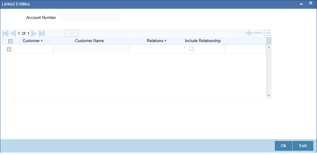

You can capture details of linked entities for the account, using the ‘Linked Entities’ screen. To invoke this screen; click the ‘Linked Entities’ button in the ‘Customer Accounts Maintenance’ screen.
Customer
Select the customer from the option list with whom you want to establish the relationship with the customer account that you are maintaining.
Description
In this field, the system displays the name of customer that you have selected in the previous field. You cannot change the description.
Relationship
You have to choose a relationship code to establish a relationship between the customer being selected and the customer account you are maintaining.
By default, the system will select the customer of the account as the Primary Holder. This is a pre-shipped relationship and you will not be allowed to change the relationship.

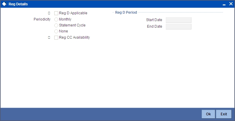

Reserve Requirements for Depository Institutions (Regulation D) is a US Federal Reserve Board regulation that limits the number of preauthorized withdrawals and transfers from a savings account or money market account. The regulation applies to all United States banking institutions offering such accounts. In consumer banking, ‘Regulation D’ often refers to §204.2(d)(2) of the regulation, which places a limit of six withdrawals or outgoing transfers per month from savings or money market accounts via several transaction methods.
The Expedited Funds Availability Act (EFA or EFAA) was enacted in 1987 by the United States Congress in order to standardise hold periods on deposits made to commercial banks and to regulate institutions' use of deposit holds. It is called as Regulation CC or Reg CC after the Federal Reserve regulation that implemented the act. Regulation CC stipulates four types of holds that a bank may place on a cheque deposit, at its discretion.
You can capture limited Regulation D and regulation CC details for the customer account, using the ‘REG Details’ screen. To invoke this screen, click the ‘REG’ button in the ‘Customer Accounts Maintenance’ screen.The screen is shown below:
Reg CC Availability
Check this box if the check deposits into this account should be considered for Regulation CC aggregation.
Specify the following details.
Reg D Applicable
Indicate whether the Regulation D limits are applicable for the account
Periodicity
If you indicate the periodicity of Regulation D applicability as ‘Statement Cycle’, the restricted transactions would be counted over the primary statement cycle defined for the customer account.
Start Date
The start date for Regulation D applicability is first set to be the date on which you mark the availability option in this screen. Subsequent to the first period, the EOD process would update the start date according to the periodicity defined.
End Date
Subsequent to the first period, the EOD process would update the end date according to the periodicity defined.
You can specify status details for the account, using the ‘Status Details’ screen. To invoke this screen, click the ‘Account Status’ button in the ‘Customer Accounts Maintenance’ screen.
Here you can capture the following details:
Branch
The system defaults the code of the current branch

Status
You can select the different status codes applicable to the account, in this field. Use the Add icon to define each status and the attributes for the same. You can use the navigation icons to move from one status to the other.
On selection of the status, the associated description will be displayed alongside
Dr and Cr GL Line
Select the debit GL account, to which all debit balances within a specific account class will report to, when it moves to the status being defined. You can identify the debit GL from the list of existing GLs. Likewise, all credits within a particular account class will report to the GL account that you have identified to track credits.
Dr Central Bank Line
Specify the Central Bank line to which this account will report to, if it is in debit. This line is maintained in the ‘Reporting Lines Maintenance’ screen.
Cr Central Bank Line
Specify the Central Bank line to which this account will report to, if it is in credit. This central bank line is maintained in the ‘Reporting Lines Maintenance’ screen.
Dr Head Office Line
Specify the Debit Head Office GL to which the account will report, if they are in a debit
Cr Head Office Line
Specify the Credit Head Office GL to which this account will report, if it is running in credit.
You can specify restrictions for the account, using the ‘Products and Transaction Codes Restriction’ screen. To invoke this screen, click the ‘Restriction’ button in the ‘Customer Accounts Maintenance’ screen.
Special Condition
By default, the restrictions maintained at the account class level will be displayed here. When you define transaction code or product restriction attributes for an account itself, rather than for the account class to which it belongs, it is referred to as a Special Condition. You can apply special conditions by selecting the option ‘Special Condition Applicable’ at the account level. If you opt to define special conditions for an account the ‘restrictions’ defined for the Account Class, to which the account belongs, will NOT apply to this account. If you wish to continue with the account class restrictions, opt for ‘Special Condition Not Applicable’.
Restriction Type
Specify the restriction type here. The options available are:
Product Code
You can select the products and specify the type of transaction (Dr, Cr or both) that you would like to allow/disallow for each product. In contracts involving the selected products, the accounts would be used for processing the selected type of transaction. For instance, assume that for the account A1, you have allowed ‘Dr’ for the product ABCD. This would mean that if a Dr entry for the product ABCD is passed to the account, A1, it would go through but in case a Cr entry is passed for this product, then the system will display a message indicating that the transaction is restricted for the account.
Description
The system displays the description for the product code that which you have specified
Dr
During transaction processing, the system will validate whether any restrictions are placed on the account based on either product and/or transaction code. If you have indicated to allow Dr Transactions for the product ABCD, and attempt to post a credit entry, the system will seek an override. You can continue the transaction, despite the restrictions, by providing appropriate reasons for the same.
During maintenance or online operations, in the respective contract screens for the restricted transactions, when you specify the customer account, the system checks whether the account is restricted for the product that has been selected, or the debit/credit transaction type. If so, an override is sought when such contracts are saved.
Cr
During transaction processing, the system will validate whether any restrictions are placed on the account based on either product and/or transaction code. If you have indicated to allow Dr transactions for the product ABCD, and attempt to post a credit entry, the system will seek an override. You can continue the transaction, despite the restrictions, by providing appropriate reasons for the same.
Special Condition
Restriction Type
Transaction Code
Likewise, you can maintain restrictions for transaction codes as well
Description
The system displays the description for the transaction code that you have specified
Dr
During transaction processing, the system will validate whether any restrictions are placed on the account based on either product and/or transaction code. If you have indicated to allow debit transactions for the product ABCD, and attempt to post a credit entry, the system will seek an override. You can continue the transaction, despite the restrictions, by providing appropriate reasons for the same.
Cr
You can specify restrictions for the account, using the ‘Currency Limits Details’ screen. To invoke this screen, click the ‘Currency Limits’ button in the ‘Customer Accounts Maintenance’ screen.
Account Number
The system displays the customer account for which PC limits are being maintained
Currency
Specify the currency in which the auto exchange limits should be maintained. The adjoining option list displays the currency codes maintained in the system. You can choose the appropriate one.
Cr Lmt Amt
Specify the credit limit amount in the chosen currency.
Dr Lmt Amt
Specify the debit limit amount in the chosen currency.
You can capture Management Information System details for the account, using the ‘Management Information System’ screen. To invoke this screen; click the ‘MIS’ button in the ‘Customer Accounts Maintenance’ screen.
Branch
The current logged-in branch code is displayed here
MIS Group
For an account, the transaction type of MIS class will be picked up from the account class
Rate Code
Specify the rate code. Select the appropriate one from the adjoining option list, which displays all valid rate codes maintained in the system
Link to Group
If an MIS Group is linked, you can indicate whether the linkage with the group should always be maintained. If yes, any change to the MIS Group will automatically apply to the customer to whom the MIS Group is linked. If not, the entities defaulted for the customer will continue, even if they are changed subsequently for the group.
Calc Method
System displays the calculation method.
Rate type
If you have indicated that rates maintained for the individual account should be picked up for MIS refinancing you have to specify the Rate Type that is to be used. The options available are:
Select the appropriate.
Pool Code/Account Level
The Pool Code/Account Level to which the account class or product belongs should be defined.
Pool Code
For an account, the pool code will be picked up from the account class.
Transaction MIS Group
For an account, the transaction type of MIS class will be picked up from the account class.
Composite MIS Group
The composite type of MIS class will be defaulted from those defined for the customer.
Cost Code
For an account, the cost codes will be picked up from the account class.

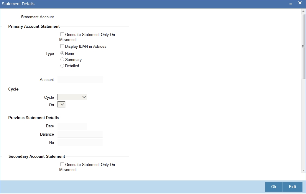

You can specify restrictions for the account, using the ‘Statement Details’ screen. To invoke this screen, click the ‘Statement’ button in the ‘Customer Accounts Maintenance’ screen.
Account Number
The system displays the account number for which you are setting the statement details
Primary A/c Statement
This refers to the type of statement to be generated periodically by the system, for this account. You can specify whether you want a detailed or summary statement or if you do not want a statement for this account at all.
Cycle
You can specify the frequency for generating the account statements. To specify the frequency of the statements, click on the adjoining drop-down list. The following list is displayed:
On
For a weekly statement you specify the day of the week on which account statements should be generated and for fortnightly and monthly statements the dates of the month. To specify for weekly statements, click on the adjoining drop-down list. The following list of days will be displayed:
To specify for monthly statements enter a number between 1 and 31 (corresponding to the system date)
If you set the statement date to 30, then account statements will be generated on:
If you set the statement date to 31, then account statements will be generated on:
For a fortnightly statement you could specify 1 and 15
For all other cycles, account statement will be generated on the last day of that cycle
Generate Stat. Only On Movement
You can indicate that an account statement should be generated for the customer’s account only when there has been a movement of funds into the account or when funds have been transferred out of the account.
For instance, let us assume that on the August 21, 2001, you have set the account statement generation frequency as Daily for the account LI020804. On the September 5, 2001, there has been no movement of funds in the particular account. If you have opted for the Generate Only on Movement option, the system will not generate a statement message for September 5, 2001.
If you choose not to enable this option, account statements will be generated regardless of whether there has been a movement of funds or not.
Display IBAN in Advices
If you would like to print the IBAN number of the customer on advices sent to the customer, you can enable the Display IBAN in Advices option by checking it. This specification will be defaulted from the account class linked to the customer account. You will be allowed to change it for a specific account.
You can choose to print the IBAN Number in advices that are sent to the customer by enabling the check box positioned next to the Display IBAN on Advices field. If the Display IBAN on Advices check box is disabled, you can enable this option by checking the box. Consequently, the IBAN Account Number will be printed on all customer correspondence (Debit/Credit advices) involving the particular account.
Because of choosing to print IBAN numbers in the correspondence sent to the customer, the Oracle FLEXCUBE account number will be replaced by the IBAN number. The lists of SWIFT messages that will include IBAN account numbers are as follows:
Note
While processing incoming payments, the system checks to see whether the account involved is an IBAN account. If the account is an IBAN account, it will be processed with the corresponding Oracle FLEXCUBE account number.
Secondary A/c Statement
Cycle
On
To specify for monthly statements enter a number between 1 and 31 (corresponding to the system date).
For a fortnightly statement, you could specify 1 and 15
For instance, let us assume that on the August 21, 2001, you have set the account statement generation frequency as Daily for the account LI020804. On September 5, 2001, there has been no movement of funds in the particular account. If you have opted for the Generate Only on Movement option, the system will not generate a statement message for September 5, 2001.
Tertiary A/c Statement
Cycle
On
For instance, let us assume that on the August 21, 2001, you have set the account statement generation frequency as Daily for the account LI020804. On September 5, 2001, there has been no movement of funds in the particular account. If you have opted for the Generate Only on Movement option the system will not generate a statement message for September 5, 2001.
Exclude Same Day Reversal trns from Stmt
If you do not wish transactions booked and reversed on the same day to be reflected in the account statement, you can specify the preference here. This feature is applicable only for the customer account legs and not for the related GL legs. Also, reversals made through the DE module will not be considered for exclusion.
This specification is defaulted from the account class linked to the account. You can change it for a specific account.
Statement Account
A customer may have two or more accounts with your bank but may desire to receive a single consolidated account statement.
Oracle FLEXCUBE allows you to link accounts. For the particular account whose statement preferences you are defining you can indicate the parent account to which the account should be linked for statement generation purposes.
The statement account is applicable for all type of account statements (Primary, Secondary and Tertiary). If the statement account has been specified, you cannot enter other statement details.
If the statement account is not specified for a particular account then the account can be a statement account for other accounts. If statement accounts have been maintained, during EOD, the account statement will not be individually generated for the child accounts. Instead a consolidated account statement would be generated based on the frequency specified for the parent account.
While closing a parent account, a message will be shown requesting removal of the parent-child account linkage.

You can capture details of account limits, using the ‘Account Limits’ screen. Click the ‘Limits’ button in the ‘Customer Accounts Maintenance’ screen to invoke this screen.
Temp. OD Start and End
The start and end dates represent the dates from which the temporary overdraft limit becomes effective upto the date on which it should ceases to be effective.
Netting Required
To process linked accounts, which are marked for referral, you will need to enable the Netting Required option. This option is defaulted from the Credit Line associated with the customer account. If you change the default option, the system displays an override message.
Temp. OD Limit
The temporary OD limit is the limit upto, which any overdraft is allowed, for a specified time period, over and above the limit set for this account.
This limit is independent of any credit line linked to this account. This is mostly used for short term overdrawing.
Sublimit
The sub-limit represents that portion of the total credit amount that can be used by this customer account. The sub-limit need be input only when the account is to be limited to a portion of the available line amount.
While passing transactions to an account with a sub-limit the first credit check made is against this sub-limit amount. If the sub-limit is crossed, you will be asked for an override.
Uncoll. Funds Limit
The uncollected funds limit represents the credit transaction amounts that have not been collected as of the current day. You can set the limit upto which withdrawal is allowed against uncollected funds.
The uncollected opening balance is reset with the current uncollected balance amount during the EOD process. This amount is to be considered when calculating Central Limit availability.
Offline Limit
This is the limiting amount till which transactions will be carried out between account(s) for the account class you are defining here, between branches when the database connectivity is not functional.
Daylight Limit
The daylight limit is the limit up to which an overdraft is allowed for the business day. The daylight limit will be added to temporary overdraft to calculate the available balance if EOD is not in progress. Daylight limit is not considered during EOD.
Note
You can specify the daylight limit only if ‘Daylight Limit’ option is checked in linked ‘Account Class - Preferences’ screen. By default, the system will display the value as zero. You can however change it.

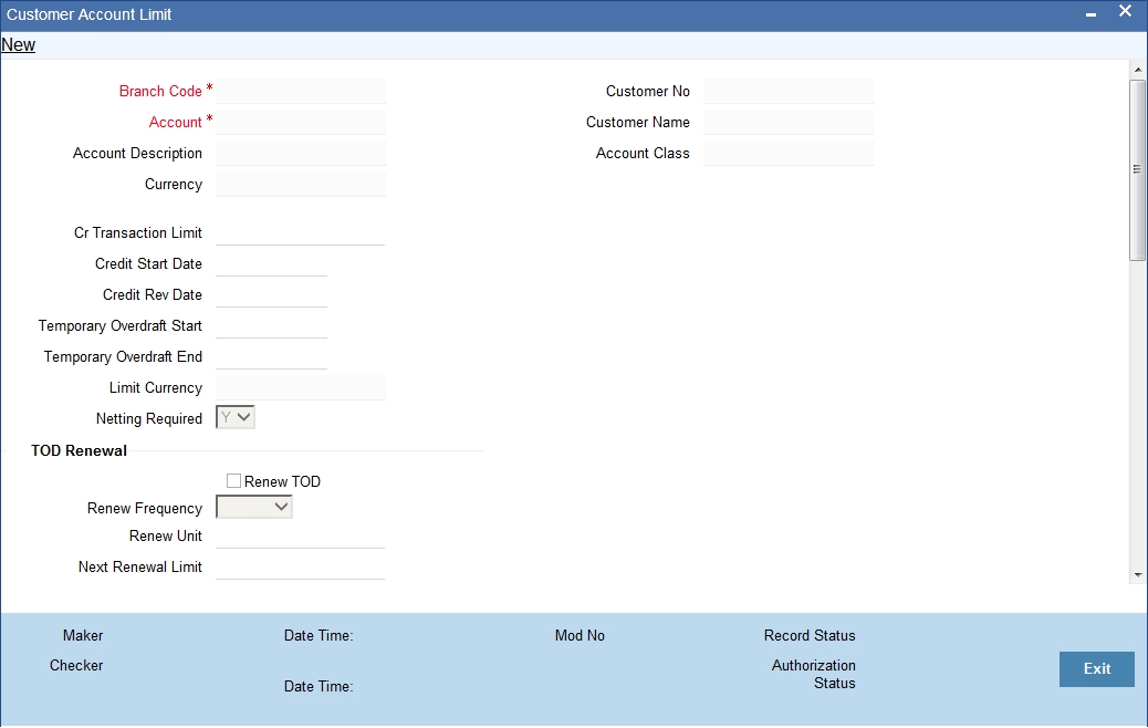

SOD Notification %
Specify the consolidated percentage utilization used for notification of the limit breach under the SOD (secure overdraft).
For more information on SOD Alert Generation, refer topic ‘Generating Alert for SOD Utilization’ later in this chapter.
Cr Transaction Limit
This is the limit for credit transactions in the account currency. When a transaction exceeds this limit, an override is displayed. The override requires a dual authorization to save the transaction.
Credit Start Date
This is the date from which this monitoring comes into effect. The check will be performed for all entries to customer accounts with transaction (booking) date greater than or equal to the start date.
Credit Rev Date
This is the date on which you would wish to revise this limit. The limit check will continue irrespective of the date maintained here. The revision date must be greater than the start date and can be left blank.
Renew TOD

Oracle FLEXCUBE facilitates linking a new TD or collateral and de-linking the existing TD or collaterals. Also, you can modify the linked amount and spread for existing collaterals. The modified linkages will be effective from the start of the current liquidation cycle.
Here you can specify the following collateral details:
Collateral Type
Select the collateral type from the options available. The options available are as follows:
Note
Collateral
Specify the Term deposit or the collateral which needs to be linked to the overdraft account from the adjoining option list.
Note
Multiple TDs/Collaterals can be linked to a single OD Account.
Branch
The system displays the branch code of the TD or collateral.
Available Amount
The system displays the available amount of the TD or collateral.
Linked Amount
Specify the linkage amount. The linked amount should not be greater that the available collateral amount
Applicable Interest Rate
The system displays the interest rate applicable to the TD or collateral on choosing the collateral.
Interest Spread
Specify the spread amount which will be used to calculate the rate of interest.
If collateral type is chosen as unsecured collateral then you should input the interest rate in the interest spread field. On saving, the system defaults the rate of interest same as interest spread.
Rate of Interest
The system displays the interest rate applicable to the OD Account.
Collateral Category
Specify the collateral category using which collateral will be created from the adjoining option list. If collateral type is TD or collateral then only secured collateral category will be displayed in the option list. If collateral type is unsecured collateral then only the unsecured collateral category will be displayed in the option list.
You can De-link or Add new TD/Collateral. For existing collaterals, system supports modification of linked amount and spread. The modification will be effect from the start of the current liquidation cycle
Hair Cut
Specify the haircut percentage available for the collateral category you entered.

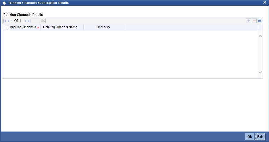

You can capture the information of channels like Internet Banking, Interactive Voice Response, Mobile, ATM, and Credit Card at customer account level. Click ‘Banking Channels’ button to specify the details relating to channels.
Banking Channels
Specify the banking channels code. Alternatively, you can select the list of channels from the option list. The list displays the channels maintained in the system.
Banking Channel Name
The system displays the name of the banking channel.
Remarks
Specify remarks for the banking channel subscription.
Note
During authorization of the account, the system does not repopulate the channel details. While authorizing primary party change, the system defaults the existing channels which are attached to the account and repopulates from the new Customer and Account Class. You can modify the channel information from the main screen for Customer Account Creation.
During save, the system defaults the channel details from Customer and Account Class of the account. You can modify the details in the Account Creation screen (STDCUSAC).
You can capture details of joint holders of the account, using the ‘Joint Holders’ screen. Click the ‘Joint Holders’ button in the ‘Customer Accounts Maintenance’ screen to invoke this screen.
Account Number
The system displays the account number here.
Customer Number
The system defaults the customer number based on the selected account number.
Branch Code
The system displays the branch code of the current branch.
You can add the joint holder details in this section if the selected account type is ‘Joint’. Maintain the following details:
Customer Number
Specify the customer Id for the joint holder. The adjoining option list displays the list of all valid customer numbers. Select the appropriate one.
Customer Name
The system displays the customer name based on the selected customer number.
Joint Holder Type
Specify the type of authority. Select the appropriate one from the drop-down menu. The options are:
Start Date and End Date
The Start Date and End Date display the validity of the joint holder of the account. This is for information purpose only.

The system defaults the latest modified /sequence number record from ‘Deposit Instruction’ screen. This latest modified /sequence number is applicable for creation of new Auto Deposit creation.
Every modification at Account level reflects at ‘Deposit Instruction’ screen, based on the sequence number.
Oracle FLEXCUBE allows you to create auto deposits from a savings account if the balance in the account exceeds a certain limit. You can capture details for creation of auto deposits, using the ‘Deposits Instruction’ screen. To invoke this screen, click the ‘Deposits Instruction’ button in the ‘Customer Accounts Maintenance’ screen.
While saving auto deposit instructions of customer account;
The following batches are available in the system to handle batches for AD creation:
You can capture billing parameters for the account, using the ‘Billing Parameters’ screen. To invoke this screen; click the ‘Billing Parameters’ button in the ‘Customer Accounts Maintenance’ screen.
You will have to maintain a set of parameters for the billing module. While settling or liquidating the bill, the default parameters that you have maintained for the account involved in this module will be used.
The screen also displays the Product Code and Description of all Billing Products applicable to the account.
Consolidating Account
You can specify a consolidating account for the given account. From the option list you can choose:
Billing Liquidation
You have two modes of liquidation i.e. Auto or Manual. The preference you have maintained for the billing product will be defaulted here. You can choose to change the mode for the specified account under the following scenarios:
Note
If the consolidation account is different from the present account, then the system uses the liquidation parameters specified at the consolidation account level and liquidation parameters specified, if any, at this account level is ignored.
Settlement Account
As mentioned above, you need to specify the settlement account to enable automatic liquidation of billing.
For liquidating the billing amount and also for collecting the bill amount, the system makes use of the account specified here.
Maintaining direct debit details
If you have maintained the mode of settlement for auto liquidation of bills as Direct Debit instructions, you need to specify the following details:
During liquidation, the direct debit contract is uploaded into the system in case you have maintained the settlement mode as direct debit transaction. The upload happens for both automatic liquidation and manual liquidation.

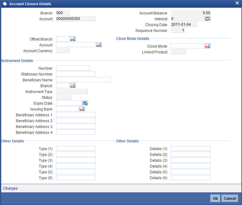

In the event of account closure, the system allows closure only after all invoice are generated and payment of outstanding bill amount is made.
Before closing the account, you need to:
All the components of a bill can be liquidated automatically or manually. In the Product Preferences screen, you can indicate whether the mode of liquidation of bills is to be automatic or manual. The system automatically liquidates those bills marked for auto liquidation. If the bills are marked for manual liquidation, you have to liquidate them through the Billing Liquidation screen.
The liquidation is triggered differently for each of the following scenarios:
Refer the section ‘Defining parameters for settlement/liquidation of bill for an account’ in Billing User Manual under Modularity for details about this screen.
You can capture details of signatories for the account, using the ‘Signatory Details’ screen. To invoke this screen, click the ‘Account Signatory’ button in the ‘Customer Accounts Maintenance’ screen.
Account Branch
The system defaults the current branch here.
Account Number
This system displays the account number to which signatories are to being linked.
Account Description
The system displays the description for the account selected.
Account Currency
The system displays the account currency.
Minimum Number of Signatories
Specify the minimum number of signatories necessary to endorse an instrument involving the account.
Note
If the linked or replicated signatories are less than the specified minimum number then the system displays an error message.
Account Message
Specify a brief description about particular signatories. It can be related to the name, number and the type of signatory of your customer. You can specify a maximum of 4000 characters as account message length.
For instance you can capture a message like - "This signatory is a joint account holder with rights to sign instruments only up US 8000".
You can maintain account signatory details for different customers using this tab.Click on ‘Account Signatory Details’ tab to invoke the following screen
Customer ID
Specify the customer signatory you want to link to the account.
You can link a customer signatory to an account either by:
Note
If the signatory ID that you specify has not been maintained, the system will generate an error and you will not be able to create an account. ".
Relation Type
The system displays the relation type of the customer.
Signatory ID
Specify the signatory ID of the customer. Alternatively, you can select the ID from the option list. The list displays values maintained in CIF signatory for the customer number.
Signatory Name
The system displays the corresponding name of the signatory number specified.
Signature Type
Specify the signatory type of the customer. Alternatively, you can select the type from the option list. The list displays signatory types maintained for the customer number.
Approval Limit
Specify the amount up to which the account signatory can approve for debits.
Signatory Message
Specify additional signatory message details in this field. You can enter a maximum of 4000 characters, alphanumeric.
Solo Sufficient
Check this box to indicate whether one signatory detail is sufficient.
You can maintain account signatory instructions for different amount slabs in this tab.Click on ‘Amount Based Signatory Instruction, tab to invoke the following screen:
To Amount
Specify the slabs by setting a ‘To Amount’. The amount slab will start from zero and the first value entered sets the slab from zero to that amount. The amounts are arranged in ascending order. For next slab, an amount above the previous ‘To Amount’ is considered as the ‘From’ value.
For example, If the ‘To Amount’ entered are as below
To Amount |
10,000 |
100,000 |
1,000,000 |
Then the maintenance will indicate the below amount slabs:
From Amount |
To Amount |
0 |
10,000 |
Above 10,000 |
100,000 |
Above 100,000 |
1,000,000 |
You can define different conditions for the amount slabs in this section.
Condition Id
Specify a unique Id for condition to be set.
Remarks
Give a brief description for the condition id.
You can provide the required signatories for the conditions set in this section.
Signature Type
Select the signature type required from the option list. The list displays the signature types maintained in static type maintenance screen.
Note
The signature type cannot be repeated for a condition.
Required No. of Signatories
Specify the number of signatories for each signatory type.This number should be less than or equal to the total number of signatories maintained under the signatory type.
Note
The Amount Based Signatory Instructions tab will be enabled in the following RT screens only if the value of param ‘AMOUNT_BASED_SV’ is Y in CSTM_BRANCH_LOC_PARAMS.

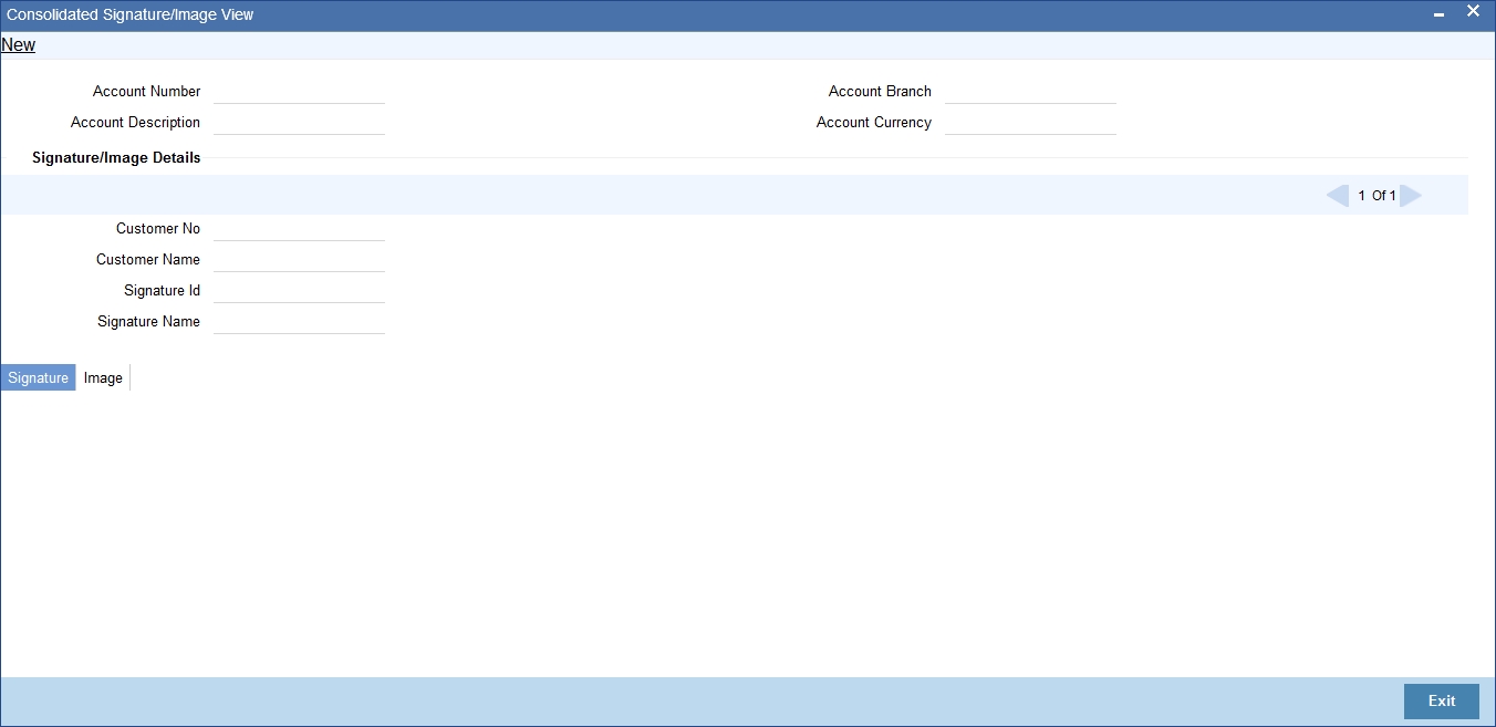

Click ‘All Signatures/Images’ button to view ‘Customer Signature/Image Consolidated View’ screen.
The following details will be displayed in the above screen
The ‘Signature/Image’ tab displays nine signatures/Images for a signature id in a single pane with three signatures/Images in a row.
If there is more than one signature id linked to a customer account, then they would be displayed in different pages.
Each image is provided with the following buttons:
The Customer accounts maintenance provides you with the facility to generate balance reports for the customer account. These details are defaulted from the account class maintenance performed for the account class category the customer account comes under. You can however, alter these details utilizing the Customer account maintenance screen.
To invoke this screen click the ‘Interim Transactions Report’ button, in the customer account maintenance screen. You need to specify the details for an MT 941 message.
This screen contains the details necessary for the account generation parameters. The message details the balance of the customer account that is under a particular account class. The account balances indicate the condition of the customer account for an identified time period.
Generate Message
Check this box to indicate that the periodic interim statement (MT942) generation is required for the account. This will be defaulted from ‘Account Class Maintenance’ screen. However, you can modify it. The ‘Consolidated Statement’ and ‘Generate Message’ are mutually restricted.
Generate Message Only on Movement
Check this box to indicate that the interim statement generation is required, only if additional entries have been posted subsequent to the previous interim statement generation. This will be defaulted from ‘Account Class’ screen, however you can modify it.
Report Transaction Since
This section lists all the transactions of the interim account statement, which are supposed to be reported. This will be defaulted from ‘Account Class’ screen, however you can modify it. You can choose the appropriate values applicable:
Debit (Dr and Cr) Amount
Specify the minimum transaction amount for the debit transaction to be eligible for reporting in the interim statement. The corresponding amount for the account currency will be defaulted. However, you can modify the amount defaulted. If the amounts are not defined at the account class for the currency in which the account is being created, no defaulting of amounts shall be done.
If you do not specify the minimum credit amount, the system will consider the amount specified in this field for reporting the eligible credit transactions also.
Credit Amount
Specify the minimum transaction amount for the credit transaction to be eligible for reporting in the interim statement. However, you can modify the amount defaulted. If the amounts are not defined at the account class for the currency in which the account is being created, no defaulting of amounts shall be done.
Daily Statement Count
Specify the count of interim statement generated during the day. In case a statement is scheduled to generate, but is not generated because there is no movement, the counter will not be incremented. The counter will be reset at End of Day.
Year to Date Statement Count
Specify the count of interim statement generated for the account since start of the financial year. The financial year will be as defined in the Accounting Period maintenance. This counter would be set at the end of year.
Generate Balance Report
To indicate that the customer account is considered for generation of its balance message, check this box
Of
Select the mode of message for balance generation from the option list
This section lists all the transactions the customer account has undergone, in the interval of balance messages generated for the account. You can choose the appropriate values applicable:

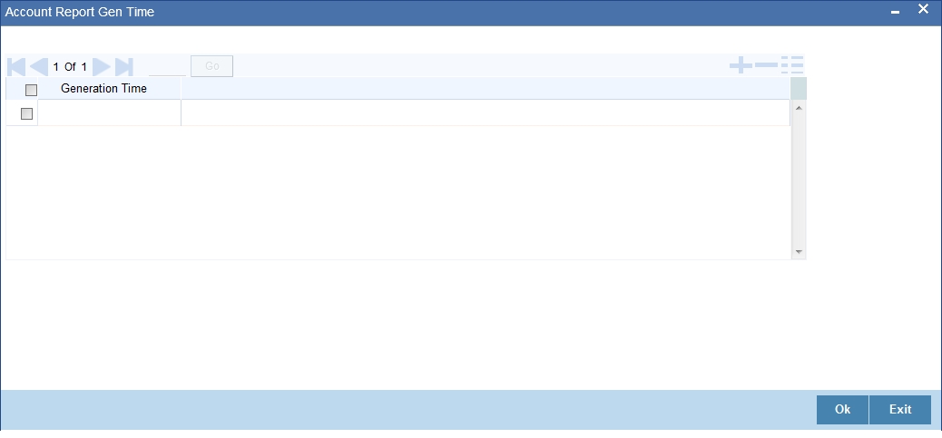

You can synchronize the time instance by hours for generation of the balance message by clicking the ‘Times’ button.
This screen is employed to indicate the the time instance in hours for the generation of the balance report.
Message generation time
Specify the timing for generation of the MT 941/ MT942 message. You can specify the time interval in hours only.
The details for issuing the balance reports are discussed in the chapter ‘Maintaining Mandatory information, for different accounts under a particular class. The details involved in generation of a balance report for a specific customer account correspond with those discussed for account classes.
The balance statement can be handed off as part of scheduled task under Oracle FLEXCUBE. You need to assign its frequency in hours. This process is initiated for all accounts requiring a balance account statement. As discussed previously the time for generation of the statement is determined and specified. In case of no subsequent transactions reports, the statement is not generated.
The balance statement can be facilitated to run as part of a scheduled job as part of the Oracle jobs initiated during processing. The Jobs Browser screen of the application provides you the facility to run the balance statement as a synchronized task, subject to specified time intervals in hours.
Invoke the ‘Jobs Browser’ screen from the application typing ‘CSSJOBBR’ in the field at the top right corner of the Application tool bar and click on the adjoining arrow button.
Select the option ‘Generate Balance Report’ from the Process option list. All associated accounts of the particular branch that have been marked for generation of balance statements are procured by Oracle FLEXCUBE
The debit and credit accounts considered since the previous issue of an MT941/MT942, are picked up for the current processing. The previous messages are based on the parameters maintained for each account. This processing produces details of the statement generation.

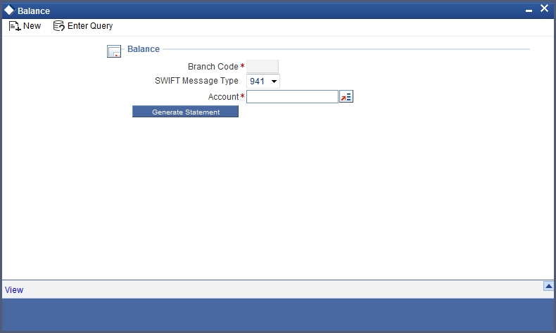

Balance reports for each account under an account class can be generated on an ad hoc basis. The Ad Hoc report generation screen is used for capturing details of a balance report sent ad hoc.
You can invoke this screen by selecting Messages in the application browser. Hereafter select ‘Detailed’ under ‘Account Balance and Interim Report’.
Alternatively, you can invoke this screen by typing ‘ACDADCRP’ in the upper right corner of the application toolbar, and clicking the arrow adjacent it.
Branch Code
The branch to which the account marked for balance report generation belongs is displayed; you cannot change or modify this value.
Account
Select the account, which has been identified for generation of a balance statement, from the option list. The account balance of this account is generated as an outgoing statement.
Swift Message Type
Select the type of message required to be sent. As the message is a balance statement, select MT941/ MT942.
Click on the ‘Generate Statement’ to initiate the generation of balance statement for the account you have selected. This process would pick up the entire debit and credit component accounts created since the issue of a previous MT941, MT942, MT950 or MT940 are included in the generated statement.

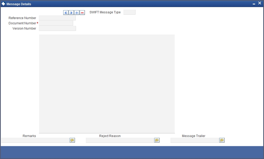

You can examine the details of the generated message, to ensure that all details entered are correct. Click on the ‘View’ button, to observe the outgoing message.
You can examine the message for ensuring the information entered is complete. You can only view the details of the message; no input of additional information is supported at this stage.

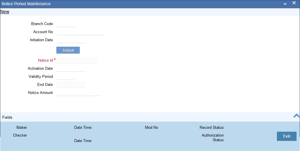

You can view and modify the notice preferences maintained at the account class level for the withdrawal of amount from savings account through the ‘Notice Preferences’ screen. Click ‘Notice’ button in the ‘Customer Accounts Maintenance’ screen. The ‘Notice Preferences’ screen is displayed as follows:
Note
This screen is applicable only for saving type of account
The following field is displayed in this screen:
Description
The following details are defaulted from the account class maintenance level. However, at the account level you are allowed to modify this.
Advance Interest
Check this field to levy the advance interest on the account
Note
The customer is liable to pay this advance interest in case he/she fails to provide the required notice to the bank
The system deducts the advance interest from the credit Interest earned by the customer on his/her credit balance in the account

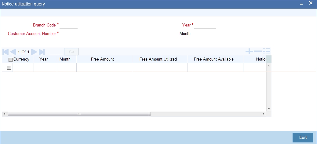

Monthly Free Amount
Specify the amount that the customer can withdraw per calendar month from his/her savings account without being liable to pay advance interest.
Notice Days
Specify the number of days before which the customer should notify the bank if he/she wants to withdraw an amount more than the ‘Free Amount’ from his/her account.
Validity Period
Specify the validity period in number of days. During this period, the customer can do the withdrawal of the amount for which he/she notified the bank.
For more details on ‘Notice Accounts’ refer the following section ‘Levying penalty interest on notice accounts’.
Click ‘Cards’ button to view details about debit cards issued against the account.
Here, you can view the following details.
Branch Code
The branch code is displayed from the main ‘Customer Accounts Maintenance’ screen.
Customer No
The customer identification code (CIF) of the account holder is displayed from the main ‘Customer Accounts Maintenance’ screen.
Account No
The account number is displayed from the main ‘Customer Accounts Maintenance’ screen..

Indicate the authorisation status of the debit card by selecting one of the following values:
Record Status
Indicate the record status of the debit card by selecting one of the following values:
Branch Code
The system displays the branch code where the debit card has been issued.
Request Reference Number
The system displays the request reference number of the card issuance record.
Card Number
The system displays the debit card number of the card holder.
Multiple cards can be issued to a customer.

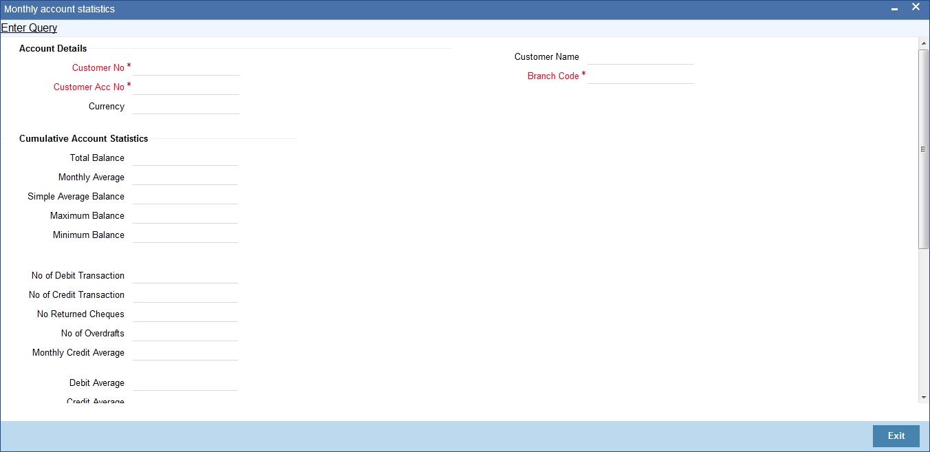

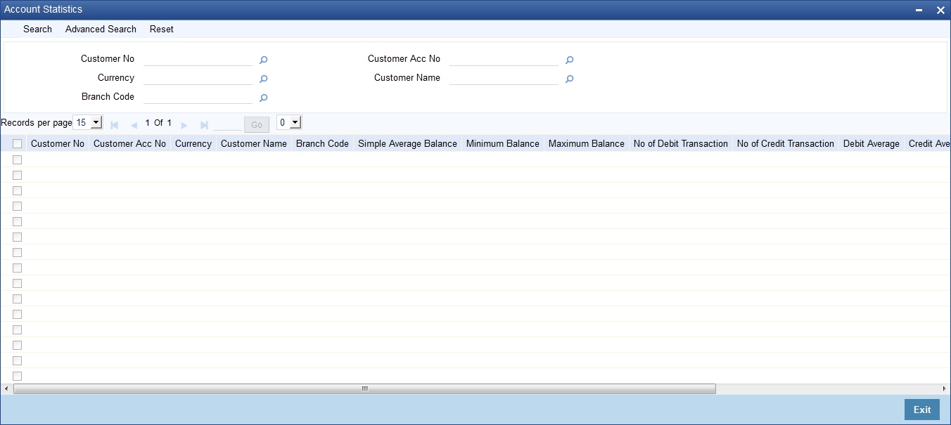

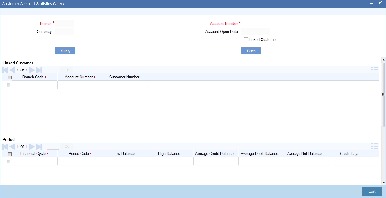

Click ‘Statistics’ button to view the details on Highest Debit Balance for the last 12 months including the current month.
You can view the following details here:
Click on the ‘Change Log’ button in the ‘Customer Account Maintenance’ screen to invoke the Change Log screen
Branch
The current logged-in branch code is displayed here.
Click on the ‘Cheque Book Request’ button in the ‘Customer Account Maintenance’ screen to invoke the Cheque Book Request screen.
You will be able to invoke this screen, only if you have checked the ‘Auto Cheque Book Request’ check box in the ‘Customer Account Maintenance’ screen.
Branch
The branch detail gets defaulted from the account branch.
Account
Select the account number to which a cheque book needs to be issued. The adjoining option list displays all the accounts which are enabled for the cheque book issuance.
First Check Number
Specify the number of the first cheque leaf of the cheque book. If the cheque book number is auto generated, you need not specify.
Check Leaves
Specify the number of cheque leaves in the cheque book.
Cheque Book Type
Specify the cheque book type. The adjoining option list displays the cheque types maintained in the system. You can choose the appropriate one.
You need to specify the cheque book type if the cheque book is generated with inventory tracking.
Order Date
The order date gets defaulted as the current date. However you can change the same.
Order Details
Specify the order details.
Language Code
Specify the code of the language. The adjoining option list displays all valid language codes maintained in the system. You can choose the appropriate one.
Request Status
The value of this will be defaulted to ‘Requested’ status.
Click ‘Ok’ to save the cheque book request details.
Click on the ‘Debit Card Request’ button in the ‘Customer Account Maintenance’ screen to invoke the Debit Card Request Details screen.
You will be able to invoke this screen, only if you have checked the ‘Auto Debit Card Request’ check box in the ‘Customer Account Maintenance’ screen.
Branch Code
The reference number of the request is auto generated and populated, when you click on the ‘Default’ button.
Customer No
The customer number of the account gets defaulted.
Account No
The account number gets defaulted from account details.
Card Products
Specify the card products. The adjoining option list displays the card products maintained in the system. You can select the appropriate ones.
Card Bin
Specify the card bin. The adjoining option list displays the card bins maintained for the specified card product. You can choose the appropriate one.
Name on Card
Specify the customer name that is to be printed on card.
Card Number
Specify the debit card number to be requested. The adjoining option list displays the valid debit card numbers maintained in the system. You can choose the appropriate one.
Card Application Date
The card application date would be defaulted as the current date of the branch. However you can change the same.
Primary Card
The primary card check box remains checked by default.
Card Status
The status of the card will be defaulted to ‘Requested’
Click ‘Ok’ to save the Debit card request details.

Click ‘Auto Deposits’ tab in the ‘Sweep Structure Maintenance’ screen to verify auto deposit details.
Click ‘Term Deposits’ tab in the ‘Sweep Structure Maintenance’ screen to maintain auto deposit details.
You can maintain the following deposit account details:
Linkage Order
The system defaults the linkage order of the specified parent deposit account, when you save the sweep structure record. This number is used to identify the preference level of the deposit account.
Deposit Account
Specify the deposit account that should be linked with the specified linkage order. The adjoining option list displays a list of valid accounts maintained in the system. Select the appropriate one.
Once you specify the deposit account, the system defaults the following details:
Linkage Percent
Specify the linkage percent for the linked deposit account.
Linked Amount
Specify the linkage amount. The linked amount should not be greater that the available collateral amount.
Note
Specify the Linkage percentage /Linked amount only during new operation. You cannot maintain both Linked amount and Linkage percentage of the deposit amount during new linkage of Deposit.

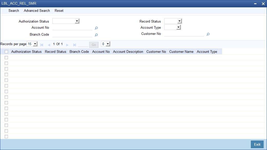

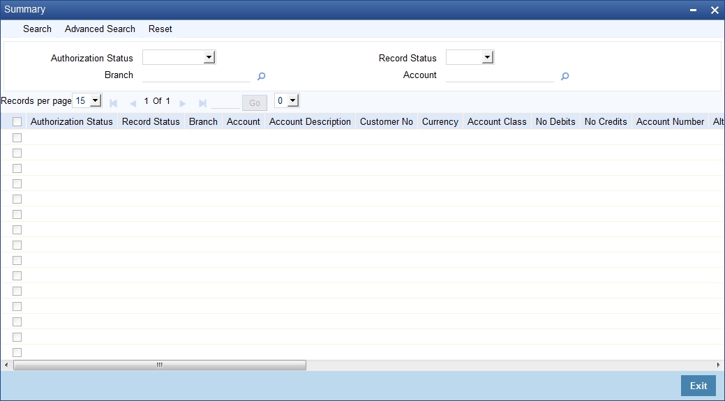

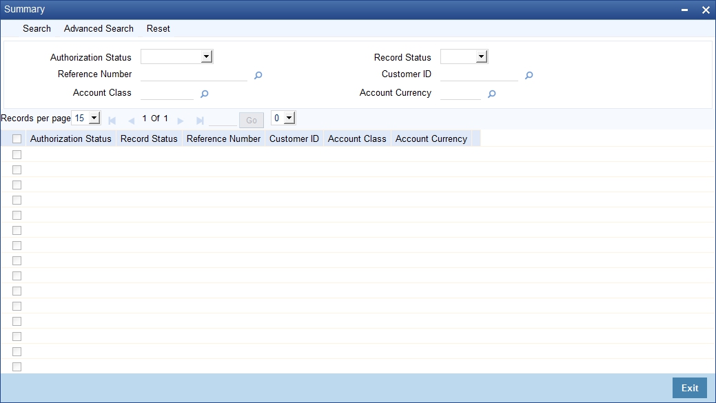

You can view the customer accounts details maintained in the ‘Customer Accounts Maintenance’ screen using the ‘Customer Accounts Summary’ screen. You can invoke this screen by typing ‘STSCUSAC’ in the field at the top right corner of the Application tool bar and clicking on the adjoining arrow button.
In the above screen, you can base your queries on any or all of the following parameters and fetch records:
Select any or all of the above parameters for a query and click ‘Search’ button. The records meeting the selected criteria are displayed.
Note
You can query or modify the account details of the customers whose accounts are permitted to you for the query/modification in the ‘Group Code Restriction’ screen.
If you are allowed to query customer information, then system displays the following details pertaining to the fetched records:

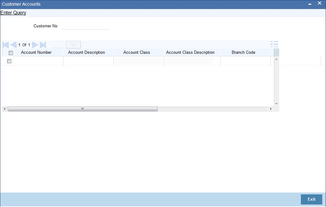

You can view the details of all accounts maintained for a specific customer using ‘Customer Account’ screen. You can invoke this screen by typing ‘STDACCDT’ in the field at the top right corner of the Application tool bar and clicking on the adjoining arrow button.
Customer Number
Specify the customer number. On search, the system displays the following details pertaining to all the accounts held by this customer.
To view the joint holder’s details of an account and the mode of operation maintained at the account level, place the cursor on the Account Number field and press Ctrl+J. The system displays the ‘Joint Holder’ screen.

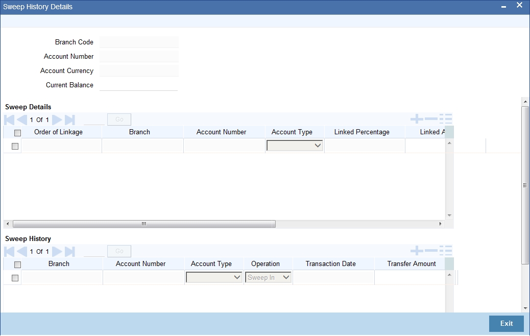

The system computes the Sweep history details when Cover Accounts / Auto Deposits / Term Deposits are linked to the primary CASA account in ‘Sweep in Structure’ screen at customer account level.
You can view Customer Account Sweep details in the Customer Account Sweep History Details screen. You can invoke this screen by typing ‘STDSWHIS’ in the field at the top right corner of the Application tool bar and clicking the adjoining arrow button.
In the above screen, you can base your queries on following parameters and fetch records:
If you are allowed to query sweep details for the account, then system displays the details pertaining to the Sweep and Sweep History:
Sweep Details
Sweep History for the customer account:

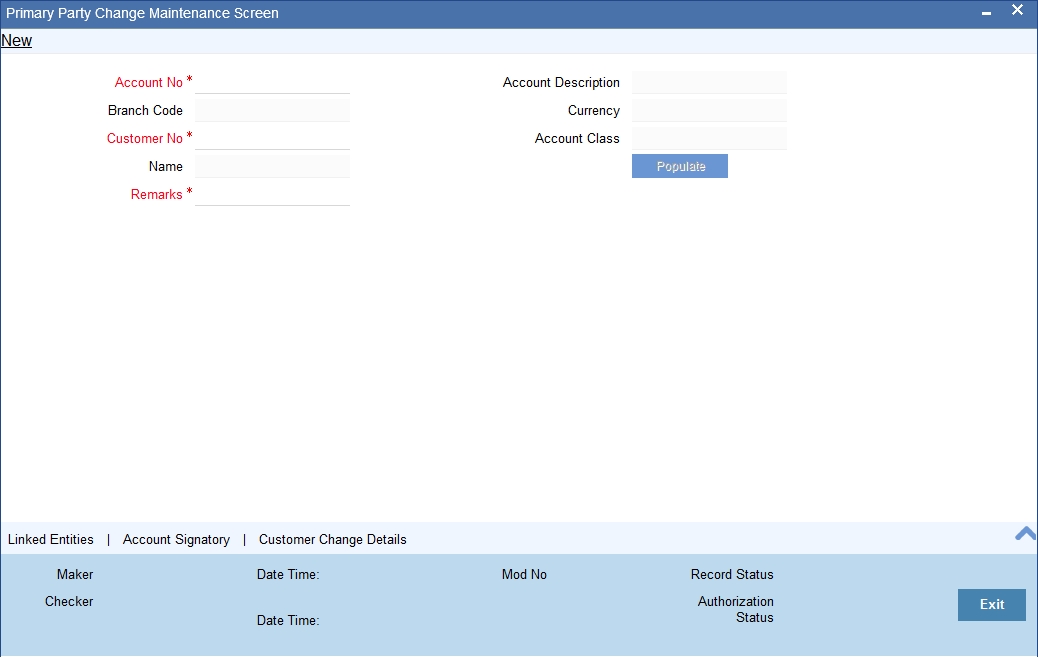

You can change the primary customer of a specific account using ‘Primary Party Change Maintenance’ screen. To invoke this screen, type ‘STDCUSCH’ in the field at the top right corner of the application toolbar and click the adjoining arrow button.
Account
Specify the account number for which you need to change the primary customer. The option list displays all valid active and open accounts under the current branch. Unauthorized and tanked accounts will not be available for selection.
Select the appropriate account number.
Description
Based on the account selected, the system displays the account description.
Branch Code
The system displays the current branch code.
Currency
The system displays the currency associated with the selected account.
Customer Number
The system displays the customer number of the primary customer of the account.
You can modify this and specify the customer number as per requirement. The option list displays all valid active and open customer numbers. Select the appropriate one.
The customer number that you select here must be different from the customer number displayed on selection of the account number.
Once you have selected the customer number, click ‘Populate’ button. The system will update the ‘Account Signatory’ and ‘Linked Entities’ details based on the changed customer number. If you do not click the ‘Populate’ button, on saving the record, the system will display an error message.
Customer Name
Based on the customer number, the system displays the name of the customer.
Account Class
The system displays the account class to which the selected account belongs.
Remarks
Specify your remarks related to the change of primary customer.
Click ‘Linked Entities’ button to view the linked entities.
When you click ‘Populate’ button after selecting the customer account, the system will update the changed customer as the primary account holder in ‘Linked Entities’ screen. The other details will remain the same. However, you can modify the details.
For further details on the ‘Linked Entities’ screen, refer to the section ‘Specifying Linked Entities’ in this chapter.
Click ‘Account Signatory’ button to view the account signatory details.
When you click ‘Populate’ button after selecting the customer account, the system will update the account signatory details based on the changed customer.
The amount based signatures will be defaulted from the account level. In case modifications are done on these, system will reflect in the changes in STDCUSAC after authorization.
If you have checked the box ‘Replicate Customer Signature’, then the system clears the signatures maintained for the old customer in the ‘Account Signatory’ sub-screen and displays the rest of the signatures. This may include signatures of the joint holders. The system will also default the signature maintained for the changed primary account holder.
If you have not checked the option ‘Replicate Customer Signature’, then the system clears the signatures maintained for the old customer.
For further details on the ‘Account Signatory’ details, refer to the section ‘Specifying Account Signatory Details’ in this chapter.
Click ‘Customer Change Details’ button to view the details of primary customer changes.
You can view the following details:
Branch Code
The system displays the branch code.
Account
The system displays the account number for which the primary account has been changed,
From the ‘Validate’ tab, you can validate the customer changes and view the error/override messages. Click ‘Validate’ button. The system will displays the following details if there is a possible error or override during the process.
Error Code
This is the error code for the error\ override message.
Type
This indicates whether the message was an error message or an override message.
Message
This field displays the details of the error/ override message.
The list will contain the details of possible errors in the beginning, followed by the possible overrides.
You can generate a report of the error/ override messages using the ‘Report’ button. Once you click this button, the system will display the ‘Report Options’ screen. Select the appropriate options and click ‘OK’ button to generate the report.
You can view the following details in the report:
Header
Under the Header, you can view the following details:
Detailed
Under detailed section, you can view the following details:
Based on the possible error information received, you can resolve such issues and proceed to save the customer change.
Under this tab, you can see the history of all customer changes that has happened for the selected account.
In this tab, you can view the history of all customer changes happened on a given account. Against each customer change information, you can view all the overrides triggered during the change process.
This screen will display the details of unauthorized customer changes, if any. The authorizer can view the overrides and take a decision whether to authorize the change or not.
For each primary party change, you can view the following details:
For every selected change record, you can view the following details of the errors/ overrides:
