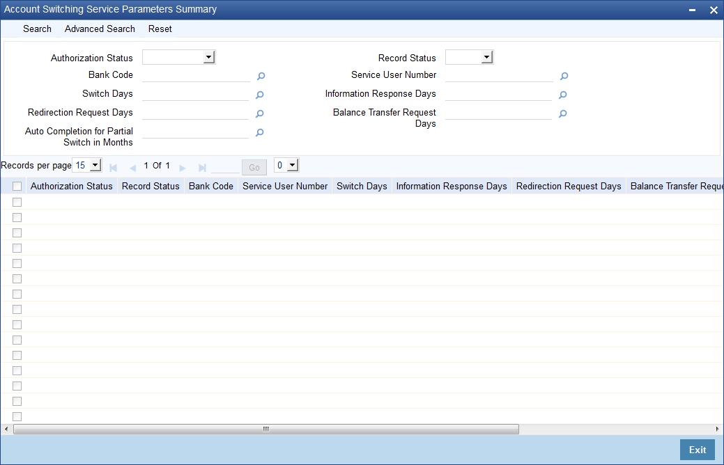

You can maintain account switching parameters in Account Switching Service Parameter screen. To invoke this screen type ‘ STDASPRM’ in the field at the top right corner of the Application tool bar and clicking the adjoining arrow button.
You can maintain the following in this screen:
Bank Code
The system displays the bank code
Service User Name
Specify the service user name. This is a 6 digit service user number allocated by Bacs member bank for current account switching.
Switch Days
Specify the number of branch working days within which the switch process should be completed for full switch service.The system calculates the switch date by adding the switch days to request booking date.
Information Response Days
Specify the number of branch working days within which the bank should respond to the information request. Information response days should be less than redirection request days
Redirection Request Days
Specify the number of branch working days on which the new bank should send redirection request to the Account Switching Service. Redirection request days should be less than balance transfer request days but greater than information response days.
Balance Transfer Request Days
Specify the number of branch working days on which the balance transfer request should be raised by the new bank. Balance transfer request days should be less than switch days but greater than redirection request days.
Auto Completion for Partial Switch
Specify the number of months on which the system will automatically process the action on partial switch request.
You can view the account switching parameter details maintained in the Account Switching Service Parameter screen. You can invoke this screen by typing ‘STSASPRM’ in the field in the top right hand corner of the application toolbar and clicking on the adjoining arrow button.
In the above screen, you can base your queries on any of the following parameters and fetch records-
Select any or all of the parameters for a query and click ‘Search’ button. The records meeting the selected criteria are displayed.

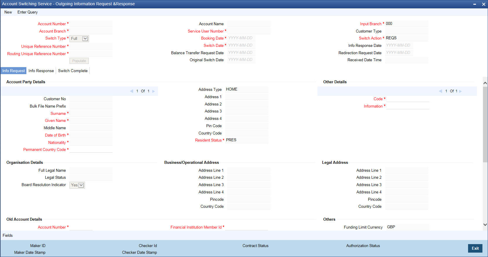

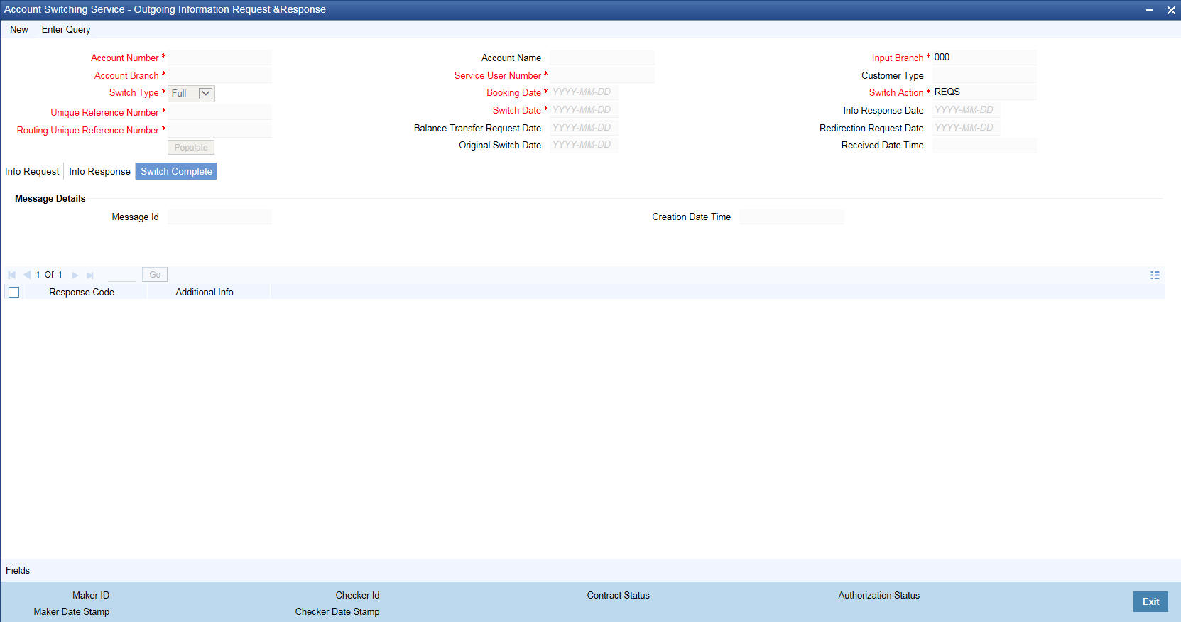

You can capture the data required for sending the Information Request message in ‘Account Switching Outgoing Information Request Input’ screen. To invoke this screen type ‘ STDASORQ’ in the field at the top right corner of the Application tool bar and clicking the adjoining arrow button.
You can specify the following in this screen:
Branch Code
The system displays the branch code.
Account Number
Select the account number to which account switching from old account is required. Alternatively, you can select the account number from the option list. The list displays all valid account numbers maintained in the system.
Switch Type
Select the account switching service type from the drop-down list. The list displays the following values:
Click ‘Populate’ to display the following details:
The system displays the following details based on the values maintained in Customer Maintenance (STDCIF) screen:
If the account is a joint account then the details of all the account holders will be defaulted in the account party details.
Code
Specify the code. Alternatively, you can select the code from the option list. The list displays all valid options.
Information
Specify the information. Alternatively, you can select the information from the option list. The list displays all valid options.
Resident Status
The system displays the resident status.
Full Legal Name
The system defaults the full legal name based on Customer Maintenance screen.
Legal Status
Select the legal status from the drop-down list. The list displays the following values:
Board Resolution Indicator
Select the board resolution indicator from the drop-down list. The list displays the following values:
The system displays the following details based on the Customer Maintenance screen:
Account Number
Specify the account number of the old bank that you want to switch.
Account Name
Specify the name as in the old account.
Financial Institution Member ID
Specify the bank code of the old bank.
Funding Limit
Specify the amount that new bank covers for the negative balance of the old account.
Funding Limit Currency
The system displays the currency of the funding limit amount.
Balance Transfer Window
Specify the processing window in which the balance transfer will be processed on the switch date.
ID
The system displays the message for the ID generated.
Creation Date Time
The system displays the date and time when the message was created.
Response Code
The system displays the response code for technical rejection.
Additional Information
The system displays additional information, if any, on the response code.

The switch complete notification message will be displayed in the switch complete tab. Click ‘Switch Complete’ tab in the Account Switching Outgoing Information Request Input screen to view the following screen.
The system displays the following details in this screen:
The system uploads the technical rejection on outgoing information request based on the unique reference number with switch action as TRJT. Once the request is marked as TRJT, then further actions are not allowed in this request. You need to create a new request with new unique reference number.
You can generate the outgoing information request message by configuring intra day or end of day batch. All the authorized outgoing information request records with ‘Switch Action’ as REQS will be generated through this batch process.
A message ID in the following format is generated and stored in the Account Switching Outgoing Message Browser:

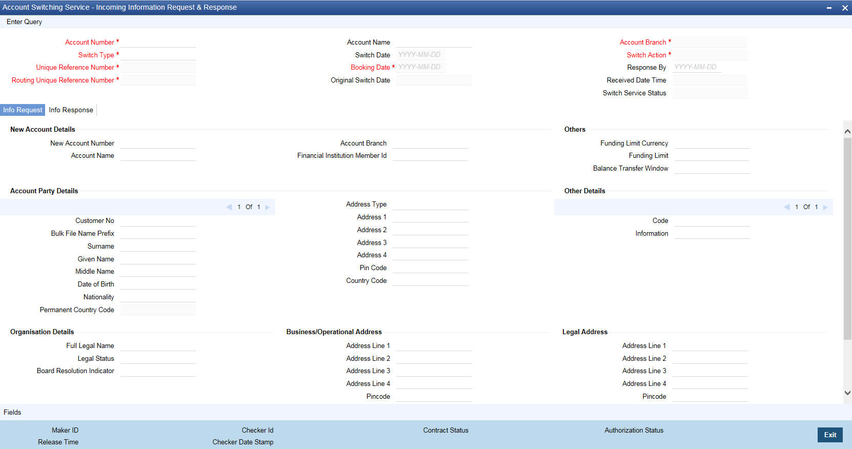

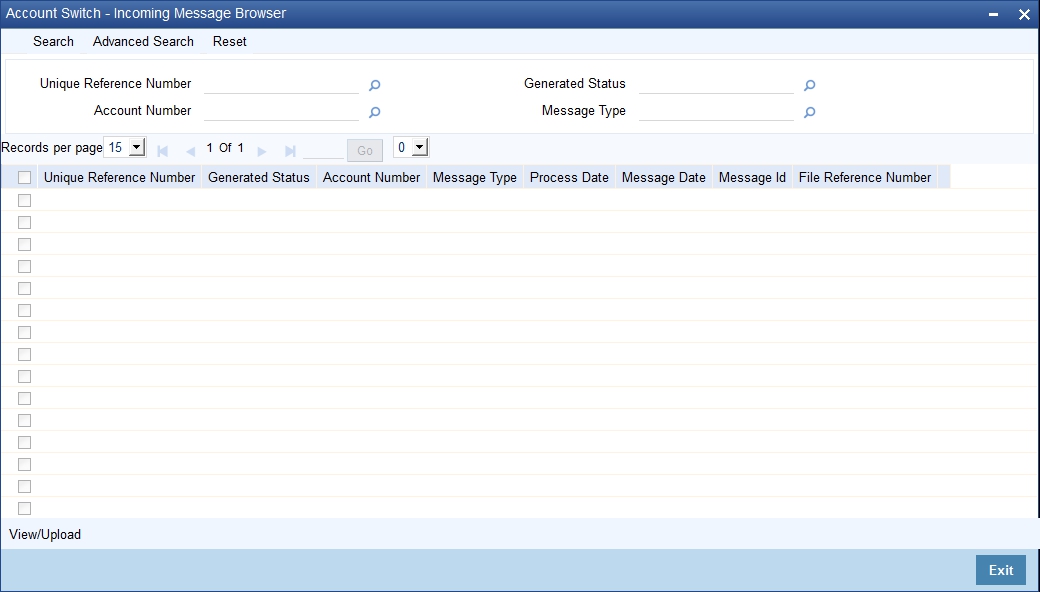

You can view and upload the incoming account switching service in the ‘Account Switch Incoming Message Browser’ screen. To invoke this screen type ‘STSASIMS’ in the field at the top right corner of the Application tool bar and click the adjoining arrow button.
You can view the following details in this screen:
File Name
The system displays the name of the file with the message.
Processing Date
The system displays the date on which the message is picked for processing.
The system displays the following details depending upon the file name and processing date:
You can view and respond to the information request details received from the new bank through Account Switching Service Incoming Information Request and Response screen. You can opt to accept or reject an incoming information request. To invoke this screen type ‘STDASIRQ’ in the field at the top right corner of the application toolbar and click the adjoining arrow button.
Branch Code
Account Number
The system displays the account number from which account switching is required.
Account Name
The system displays the account name.
Switch Type
The system displays the account switching service type.
Unique Reference Number
The system displays the unique reference number.
Routing Unique Ref No.
The system displays the routing unique reference number.
Switch Date
The system displays the date on which the switch process will be completed.
Booking Date
The system displays the booking date.
Original Switch Date
The system displays the original switch date.
Switch Action
The system displays the action code during the course of full switch workflow process.
Response by
The system displays the date on which the response to the information request is expected.
Received Date Time
The system displays the message received date and time.
Switch Service Status
The system displays the switch status.
Account Number
Specify the account number of the old bank that has to be switched.
Account Name
Specify the account name as in the old bank.
Funding Limit
Specify the amount that the new bank covers for the negative balance of the old account.

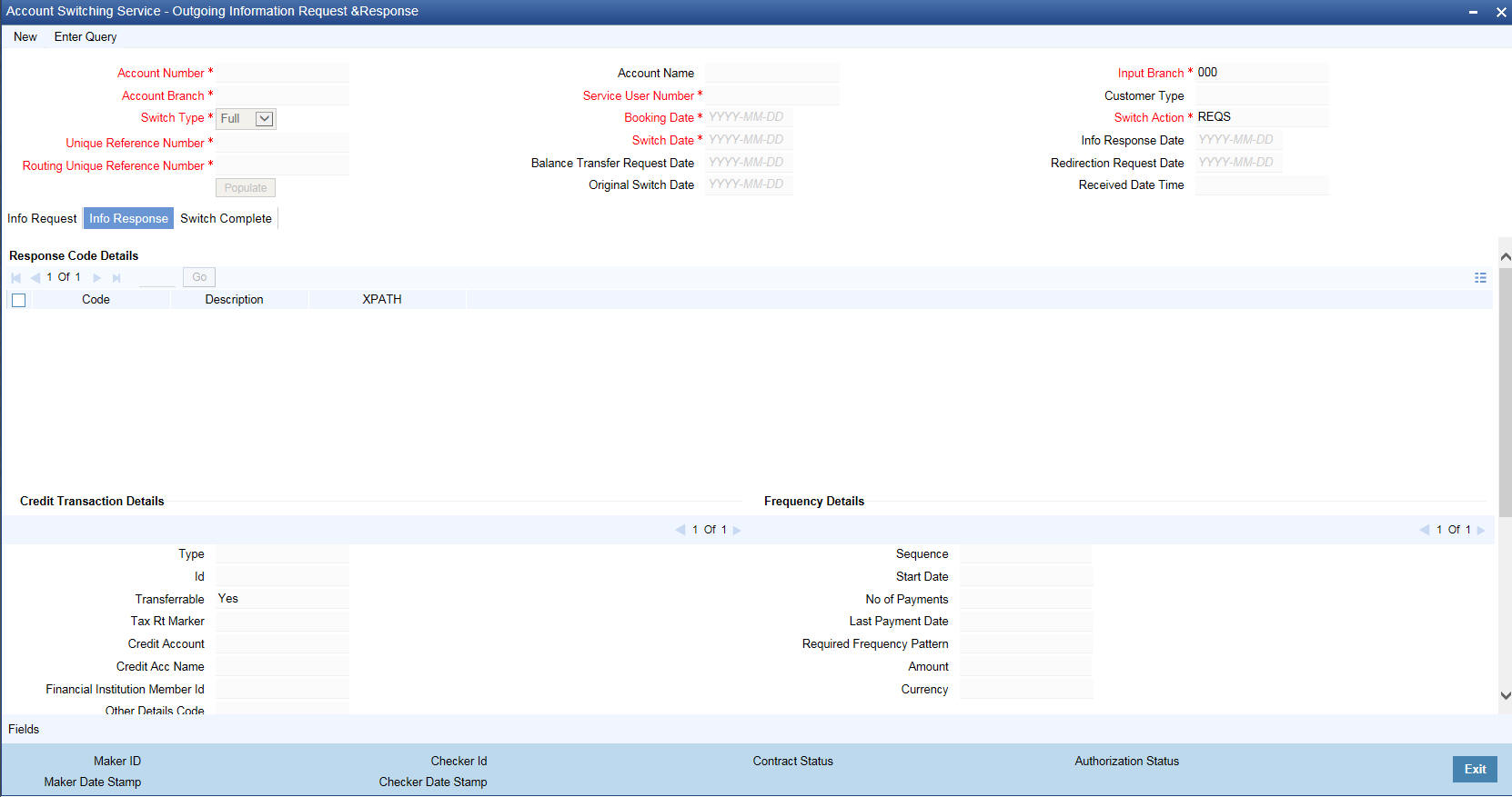

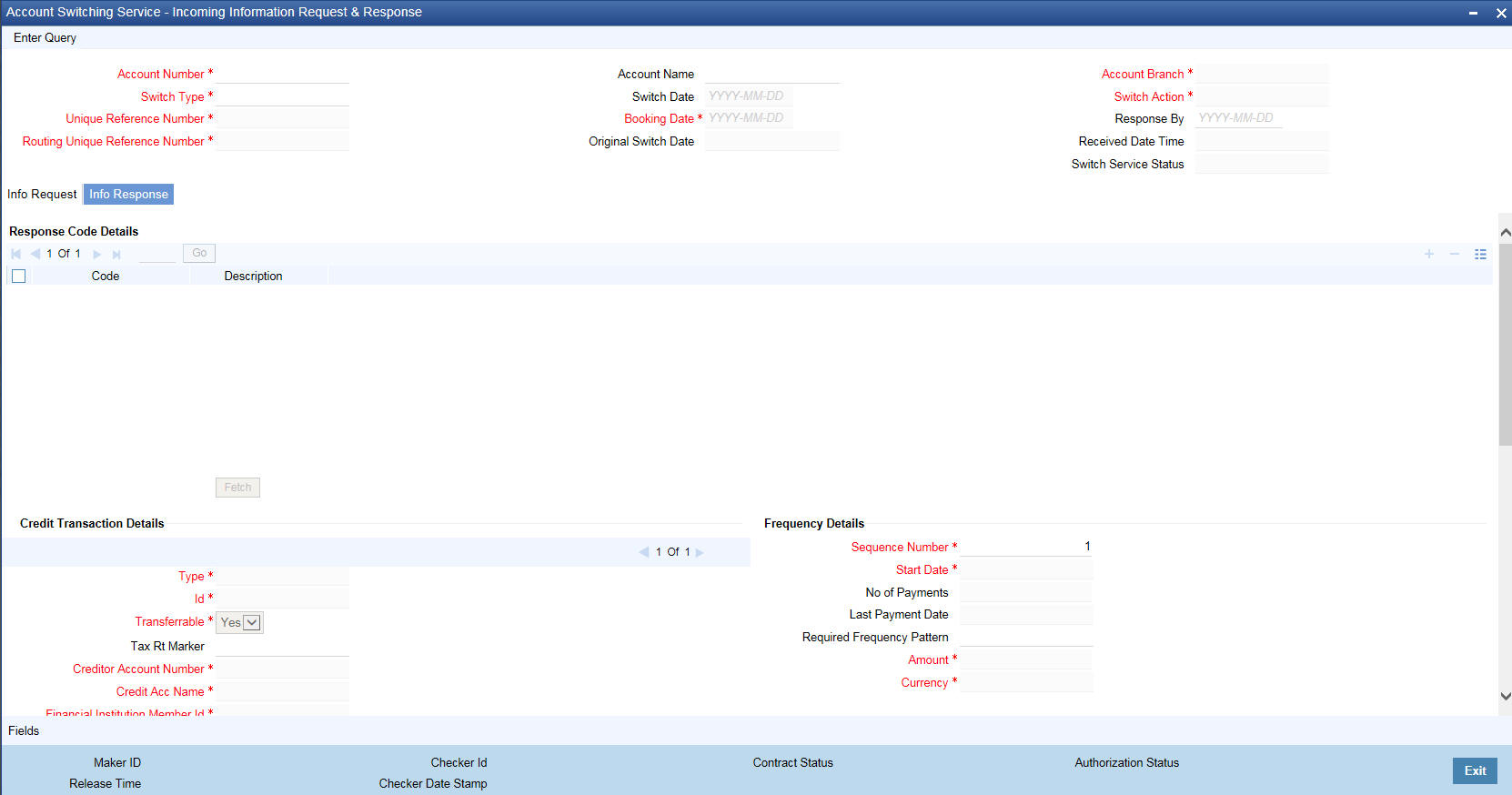

The system displays the following details in this tab:
You can Click ‘Info Response’ tab to view the following screen.
Code
Specify account switching service response code. Alternatively, you can select the response code from the option list. The list displays all valid response codes in the system.
Description
The system displays the account switching service response code description.
Click ‘Fetch’ to fetch the credit transaction and direct debit details from the system for the account number.
You can view the following details in this section:
Transferable
Check this box to transfer the credit payment arrangement.
Tax Rate Maker
Specify the tax rate marker.
Other Details Code
Specify the details of non-transferable credit payment arrangement.
Other Details Description
Sequence
Specify the sequence number.
Start Date
Specify the date of the first payment to be made for this payment schedule as defined by the Schedule Code (PSC070) and its associated parameters.
No of Payments
The system displays the number of patterns.
Last Payment Date
The system displays the last payment date.
Required Freq Pattern
Specify the required frequency pattern.
Amount
The system displays the payment amount.
Currency
The system displays the payment currency.
Mandate ID
The system displays the mandate ID.
Automated DD Instruction
Indicate if the Direct Debit Instructions are automated or not. The options are ‘Yes’ or ‘No’.
Transferable
Check this box to transfer the direct debit instruction.
Name
Specify the counter party name from PC Debtor Direct Debit Details.
Organization ID
Specify the organization ID.
Message ID
The system displays the message ID.
Last Collection Date
The system displays the date of the most recent collection.
Last Collection Amount
The system displays the most recent collection amount.
Last Collection Currency
The system displays the most recent collection currency.
Other Details Code
Specify the details of the non-transferable direct debit instruction.
Other Details Info
Creation Date Time
The system displays the message creation date and time.
The system displays the following technical rejection details:
The system uploads the technical rejection based on the unique reference number with switch action as TRJT. The response action ‘Accept’ or ‘Reject’ is allowed again when the information response is marked as TRJT.
You can generate the outgoing information response message by configuring intra day or end of day batch. All the authorized outgoing information response records with ‘Switch Action’ as ACCT or REJT will be generated through this batch process.

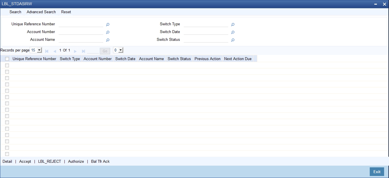

You can query records, view the details of a record, accept, reject or acknowledge balance transfer actions through ‘Account Switching Incoming Request Workflow’ screen. To invoke this screen type ‘STSASIRW’ in the field at the top right corner of the application toolbar and click the adjoining arrow button.
In the above screen, you can base your queries on any or all of the following parameters and fetch records:
The system displays the following details depending upon the selection criteria:

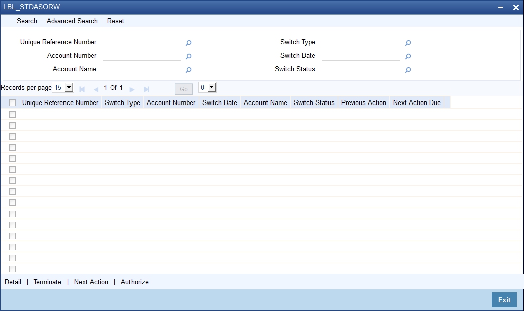

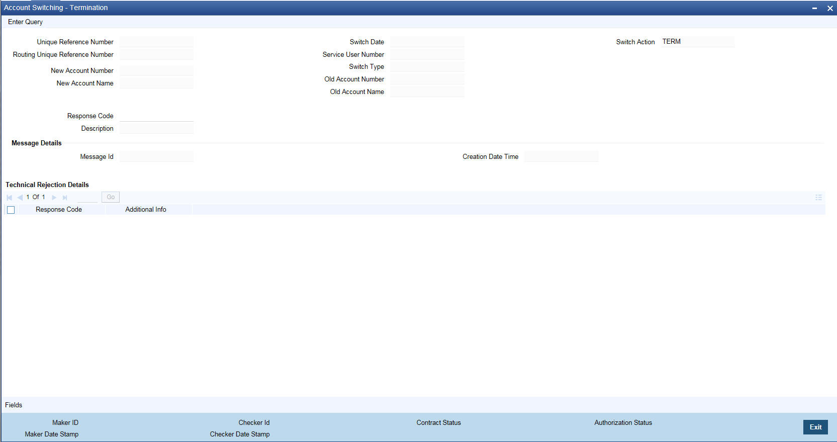

You can query and process or terminate an outgoing request through Account Switching Outgoing Request Workflow screen. To invoke this screen type ‘STSASORW’ in the field at the top right corner of the application toolbar and click the adjoining arrow button.
In the above screen, you can base your queries on any or all of the following parameters and fetch records::

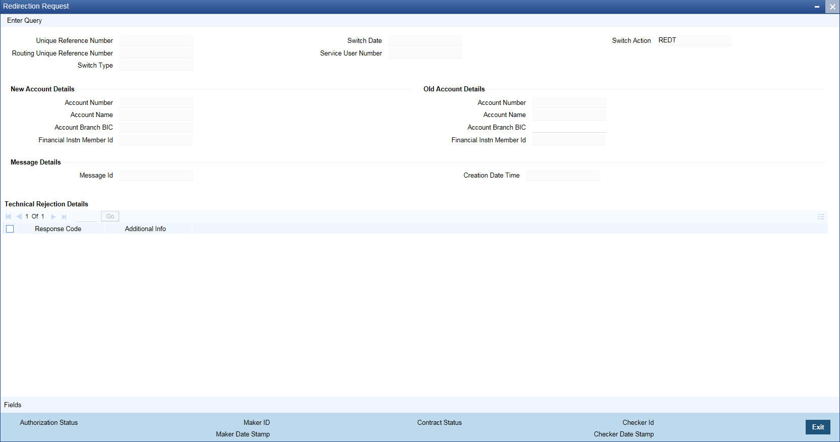

You can redirect a request through Account Switching Redirection Request screen. To invoke this screen type ‘STDASRDT’ in the field at the top right corner of the application toolbar and click the adjoining arrow button. The request can be redirected from Outgoing Workflow screen. If the Switch Status of a record is ACCT or TRJT, then the next action is request redirection.
Account Branch BIC
Specify the BIC of the old account.
The system uploads the technical rejection based in the unique reference number and switch action ‘TRJT’. The next action as Request Redirection will be allowed again when the previous redirection request is marked as TRJT.
You can generate the outgoing request redirection message by configuring it as intra day or end of day batch. All the authorized redirection request records with ‘Switch Action’ as REDT will be generated through this batch process.

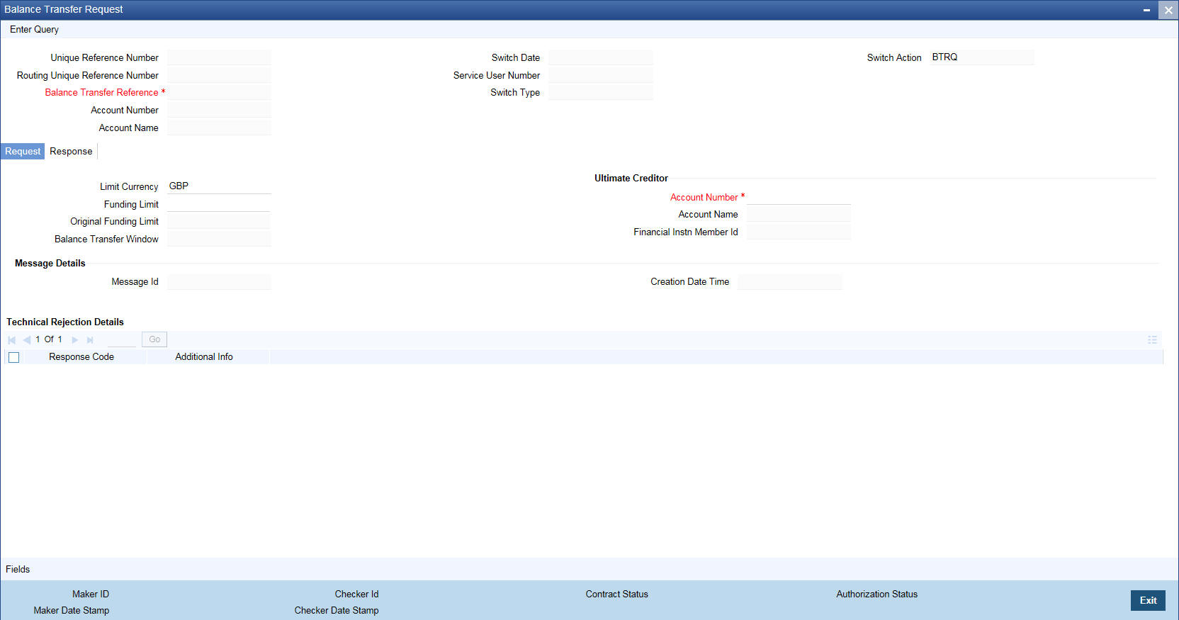

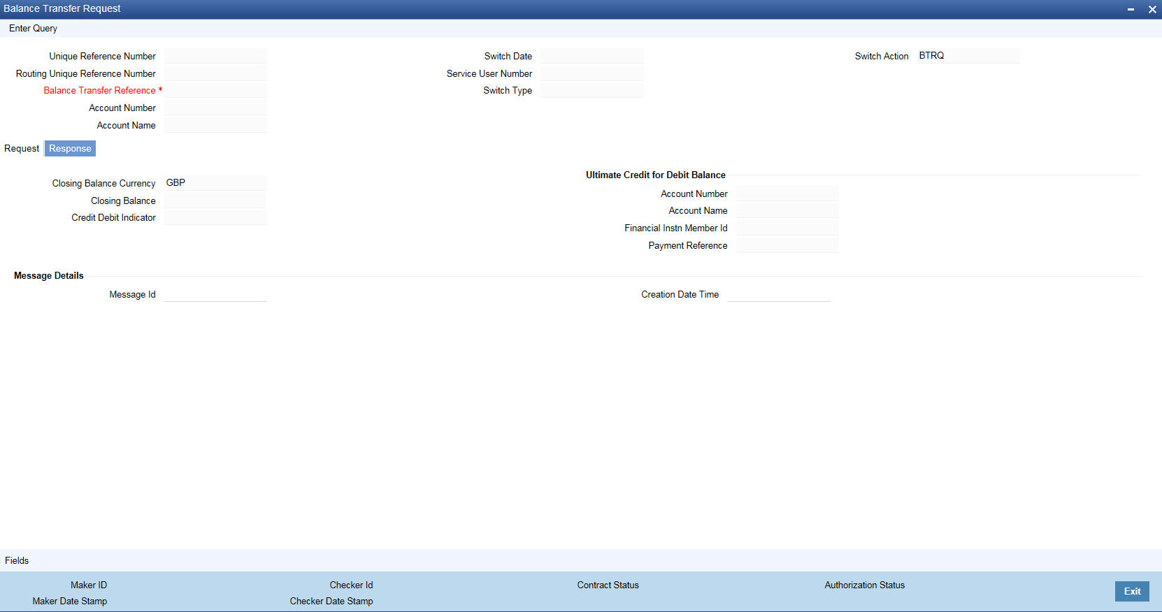

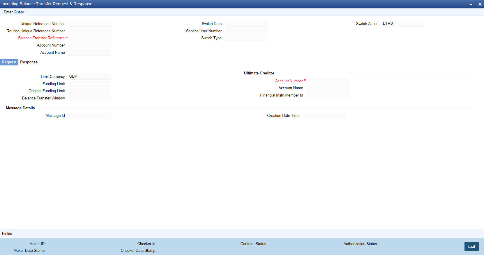

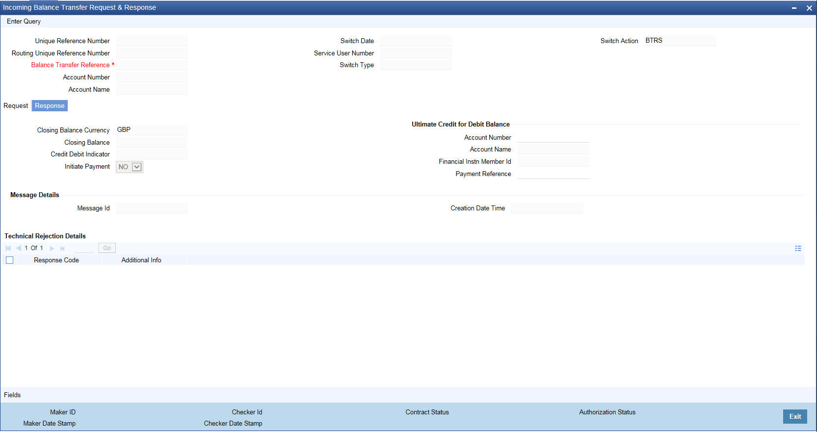

You can initiate the balance transfer request to the old bank through ‘Account Switching Balance Transfer Request’ screen. To invoke this screen type ‘STDASOBQ’ in the field at the top right corner of the application toolbar and click the adjoining arrow button.
You can view the following details in the Balance Transfer Request message:
Original Funding Limit
The system displays the original funding limit based on Account Switching Outgoing Information Request and Response screen.
Original Funding Limit Currency
The system displays the original funding limit currency.
Funding Limit
The system displays the funding limit. You can modify this. Funding limit cannot be less than the original funding limit.
The system displays the balance transfer window.
Account Number
The system displays the account number. You can modify it.
The system displays the following details:
The incoming acknowledge balance transfer message will be processed from the Account Switching Service Incoming Message Browser. The message will be decomposed and uploaded into the Account Switching Outgoing Balance Transfer Request and Response of the account branch. You can view the message data in the response tab. Click ‘Response’ tab in the Account Switching Balance Transfer Request and Response screen.
You can view the following details:
Technical Rejection Details
The system uploads the technical rejection based on the unique reference number and switch action TRJT. The next action as Balance Transfer Request will be allowed again when the Balance Transfer Request is marked as TRJT. You can then resubmit the balance Transfer request.
You can generate the outgoing balance transfer request by configuring intra day or end of day batch. All the authorized balance transfer records with ‘Switch Action’ as BTRQ will be generated through this batch process.
You can initiate acknowledgement response for Balance Transfer Request through Account Switching Incoming Balance Transfer request and Response. To invoke this screen type ‘STDASIBQ’ in the top right corner of the application toolbar and click the adjoining arrow button.
Acknowledge Balance Transfer is allowed for only FULL switch type and for previous switch actions like BTRQ and TRJT. The Incoming Balance Transfer Request and Response screen will be opened in unlock mode with switch action as BTRS. The system performs the existing account closure checks for the account number.if acknowledge balance transfer is not as part of the switch action TRJT.
You can view the following incoming balance transfer request details in this screen:
The incoming balance transfer request message is processed from the Account Switching Service Incoming Message Browser. The message will be decomposed and uploaded into the Account Switching Incoming Balance Transfer Request and Response of the account branch. You can view the following message data in the Request tab of Account Switching Incoming Balance Transfer Request and Response screen.
Click ‘Response’ tab in the Account Switching Incoming Balance Transfer Request and Response screen.
The system uploads the technical rejection on acknowledge balance transfer message based on the unique reference number and switch action ‘TRJT’. To resubmit the acknowledge balance transfer, the response action Acknowledge Balance Transfer will be allowed again when the previous acknowledge response is marked as TRJT.

You can complete the switch action from Account Switching Outgoing Request Workflow if the switch actions are ‘BTRS’ and ‘TRJT’.Switch complete action can be performed only after receiving the payment or initiating the payment. You have to update the switch action as ‘COMP’ in Account Switching Outgoing Information Request and Response (STDASORQ) screen to complete the switch action.
You can generate the outgoing switch complete message by configuring it as intra day or end of day batch. All the authorized records with ‘Switch Action’ as COMP will be generated through this batch process.
The system uploads technical rejection on Switch Complete message based on the unique reference number and switch action TRJT. To resubmit the switch complete message, the next action Switch Complete will be allowed again when the Switch Complete is marked as TRJT.
You can terminate a switch anytime after the Information Request input. If switch termination action is done before generating the Information Request message, then the system populates the switch action as ‘CANC’ indicating that the Information Request is cancelled.
If the switch termination action is done after generation of Information Request, then the system populates the switch action as ‘TERM’ and will open the Account Switching Termination screen to capture the response code. You can invoke this screen by typing ‘STDASTRM’ in the field at the top right corner of the application toolbar and click the adjoining arrow button.
The system uploads technical rejection on Switch Terminate message based on the unique reference number and switch action TRJT. To resubmit the switch terminate message, you can mark the info response as TRJT.
You can generate the outgoing switch terminate message by configuring it as intra day or end of day batch. All the authorized switch termination records with ‘Switch Action’ as TERM will be generated through this batch process.

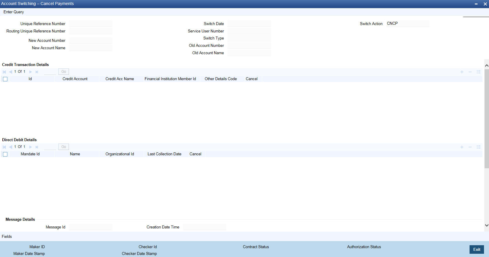

You can cancel the payment arrangements of a partial switch service through ‘Account Switching Cancel Payments’ screen.To invoke the screen type ‘STDASCNP’ in the field at top right corner of the application toolbar and click the adjoining arrow button.
The system displays the following credit transaction details:
Other Details Code
Specify the other details code for outgoing request. For incoming request, the system displays the other details code from incoming payment cancel message.
Start Date
Specify the date from which the new bank will start making the payment from the new account.
Cancel
Check this box if the payment should be cancelled by the old bank.
The system displays the following direct debit details:
Cancel
Check this box to cancel the direct debit by the old bank.
Message ID
Creation Date Time
