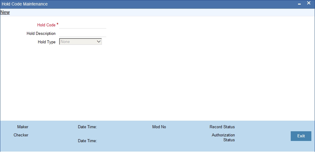

Whenever you impose an amount block (hold) on customer accounts, a valid reason can be assigned for having effected the hold. You can define these reasons using the ‘Hold Maintenance’ screen.
You can invoke this screen by typing ‘CODHOLDT’ in the field at the top right corner of the Application tool bar and clicking on the adjoining arrow button.
You can capture the following details here:
Hold Code
Specify a code for the amount block reason you are maintaining in the system.
Note
The Hold Code can be a maximum of 15 characters (alphanumeric type) in length.
Hold Description
Provide a brief description of the hold code.
Hold Type
In case you are defining amount hold reasons for automated system hold, select the hold type from the adjoining drop-down list. The available options are:
Note
Except ‘None’, for all other Hold Types mentioned above, only one Hold Code each can be maintained in the system.

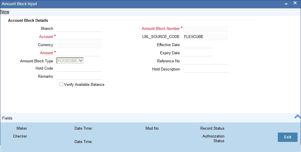

You can maintain amount blocks on individual accounts of a customer using the ‘Amount Block Input’ screen. You can invoke this screen by typing ‘CADAMBLK’ in the field at the top right corner of the Application tool bar and clicking on the adjoining arrow button.
Account Number
Specify a valid account number of the customer for which you wish to maintain an amount block. The adjoining option list displays all valid customer accounts maintained in the selected transaction branch. You can select the appropriate one.
To view the joint holder’s details of an account and the mode of operation maintained at the account level, place the cursor on the Account field and press Ctrl+J. The system displays the ‘Joint Holder’ screen.
For more information on the ‘Joint Holder’ screen refer to the section ‘Joint Holder Maintenance’ in this User Manual.
Sequence Number
The system automatically displays the amount block sequence number.
Amount
Specify the amount which has to be blocked.
Note
Effective Date
Specify the date from which the amount block is effective.
Note
For CASA amount block type, the effective date is the branch current date.
Expiry Date
Specify the date on which the amount block is released, so that it is available for withdrawal to the customer. You cannot modify the amount block after the expiry date
Note
For CASA amount block type, there is no expiry date.
Amount Block Type
Select the amount block type from the adjoining drop-down list. The available options are:
Note
The option ‘System’ indicates a system generated amount block, equivalent to the external deal amount maintained in the system. You cannot modify a ‘System’ type of amount block.
During debit transaction processing, Oracle FLEXCUBE will use ‘Mid Rate’, if the primary account currency and cover account currency are different.
Note
Note
If the amount block type is P2P, then the following transaction data is logged into ‘P2P Payment Beneficiary Registration Queue’ to track the beneficiary registration till the end date:
While processing an amount block, the amount block on the sender’s account is released and
the amount is debited from the senders account and credited to the clearing suspense GL.Remarks
Specify remarks about the amount block, if any.
Note
For structured deposit, the subscription amount will be blocked from the given CASA account automatically and this system generated block is updated with SD contract reference number in remarks field.
Reference No
The system generates a unique reference number upon saving the record.
Note
System will not allow to closing the respective customer account unless existing active amount blocks are closed.
Hold Code
Specify a valid hold code. The adjoining option list displays all valid hold codes maintained in the system. You can select the appropriate one.
Hold Description
The system displays the hold code description.
Note
For system generated amount blocks corresponding to external deals, the description maintained at Hold Code Maintenance screen for Hold Code Type ‘External Deal’ gets displayed here.
Source Code
The source from which the amount block has been initiated is displayed. When an amount block is created through a source code, the same can be modified or released by the same source code.
Verify Available Balance
Check this box to enable creation of amount block only when sufficient funds are available.For more details related to external deal maintenance, refer Core Services User Manual.

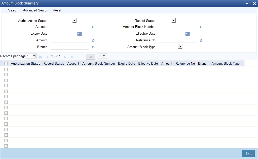

You can view a summary of Amount Blocks maintained at the ‘Amount Block Input’ level using ‘Amount Block Summary’ screen.
You can invoke the ‘Amount Block Summary’ screen by typing ‘CASAMBLK’ in the field at the top right corner of the Application tool bar and clicking the adjoining arrow button.
You can view records based on any or all of the following criteria:
Note
The system generated original transaction Reference No of Escrow amount blocks will also be displayed.
Click ‘Search’ button. The system identifies all records satisfying the specified criteria and displays the following details for each one of them:

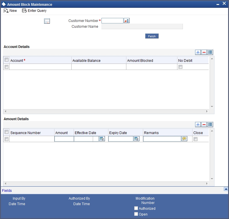

You can invoke the ‘Consolidated Amount Block Input’ screen by typing ‘CADCAMBL’ in the field at the top right corner of the Application tool bar and clicking on the adjoining arrow button.
In this table, you maintain all amount block details enforced for a customer account. Any number of amount blocks can be enforced for an account.
The following information will be available in this screen:
If you are maintaining consolidated amount blocks for the first time for a customer account, you need to select the name of the customer from the option-list provided. On selection of the customer, all accounts maintained for the customer that are available in the current branch will be displayed in the middle section of the screen along with existing amount block details, if any. Select an account to view all the individual amount blocks for the selected account in the lower half of the screen.
To create a new amount block, click add icon. The sequence number for each amount block will be automatically created by the system.
Maintain the following parameters for the amount block:
Amount
Specify the amount that you would like to block in the account. When an amount block is set for an account, the balance available for transaction would be the current balance of the account minus the blocked amount.
Whenever a customer account is debited of an amount that exceeds the available balance in the account, the system asks for an ‘override’. Note that the available funds in a blocked account will always be shown to be the current balance less the amount block.
The ‘Blocked Amount’ field in the middle section of the screen will display the sum of all the amount blocks placed on the account.
You can raise the blocked amount for an account. On authorization, the ‘Customer Accounts’ table will be updated with the modified blocked amount.
Effective Date
When defining amount blocks for an account, specify the date on which the amount block comes into effect. A future-dated amount block comes into effect when the Beginning of Day process is executed for the day (on which the amount block becomes effective).
Expiry Date
This is the day on which the amount block expires. An amount block is effective till the EOD is run on the expiry date. On expiry of an amount block, the block amount status in the ‘Customer Accounts Maintenance’ table gets updated (if no other amount block is enforced on this account). The balance available for transaction is also updated.
Remarks
Here you can enter any remark specific to this amount block. For example, you can capture the purpose for which a block has been affected.
No Debit
When defining amount blocks, you can choose to completely block the account from any kind of debits made to the account. To do this, select the option ‘No Debit’. At a later point, you can UN Cheque this option to release the full block and define partial blocks if required.
Close
As stated earlier, the amount block will remain active from the effective date till the expiry date. However, you can release a block before the expiry date. Select the ‘Close’ option to affect a forceful closure of the amount block. If you do not select this option, the amount block will be released as part of the EOD batch process executed on the expiry date.
