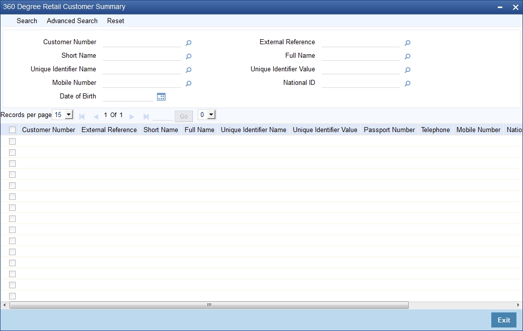

Invoke the ‘360Degree Customer View Entry Point’ screen, by typing ‘STSCUSVW’ in the field at the top right corner of the Application tool bar and clicking the adjoining arrow button.
In the above screen, you can base your queries on any or all of the following parameters and fetch records:
Select any or all of the above parameters for a query and click ‘Search’ button. The records meeting the selected criteria are displayed.
System displays the following details pertaining to the fetched records:
When you double click on the customer record, the system will launch either Retail view screen or corporate view screen depending on the type of customer.

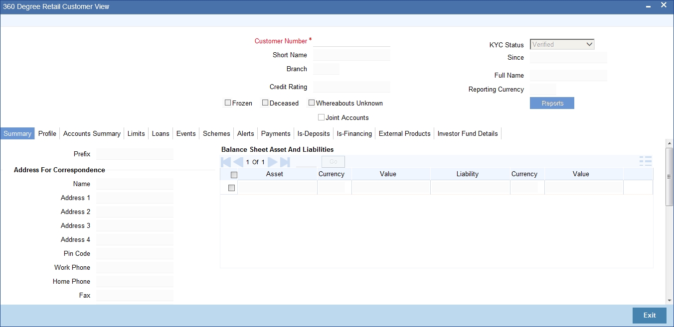

You can invoke ‘360 Degree Retail Customer View’ screen if the customer is Retail by double clicking on the customer record in the ‘360Degree Customer View Entry Point’ screen or by typing ‘STDRETVW’ in the field at the top right corner of the Application tool bar and clicking on the adjoining arrow button.
The system displays the following details:
Click the ‘Reports’ button to view the ‘360 Degree Customer Report’ screen.
The details that can be viewed in the ‘360 Degree Retail Customer View’ screen is classified into 12 broad heads.

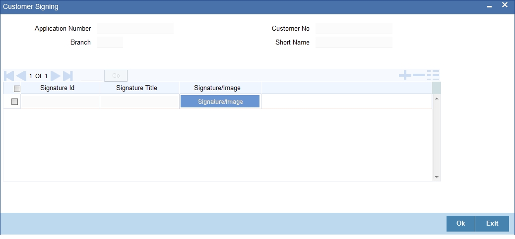

Click on the ‘Image’ button to invoke ‘Customer Signatory Details’ screen. Here you can view the signature image and photograph of the customer.
Here you can view the following details:

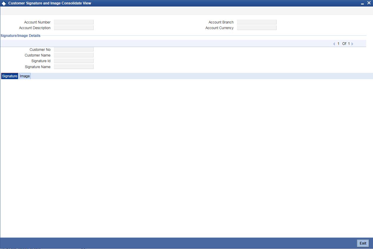

Click ‘All Signatures/Images’ button to view ‘Customer Signature/Image Consolidated View’ screen.
The ‘Signature/Image’ tab displays nine signatures/Images for a signature id in a single pane with three signatures/Images in a row.
If there is more than one signature id linked to a customer account, then they would be displayed in different pages.

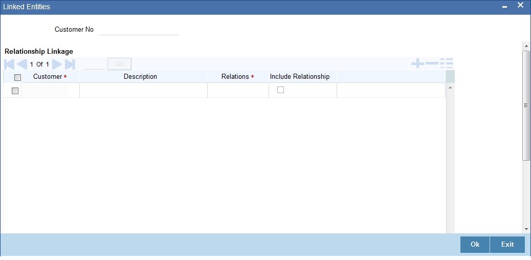

Click on the ‘Linked Customers’ button to invoke ‘Linked Entities’ screen. Here you can view other related customer details.

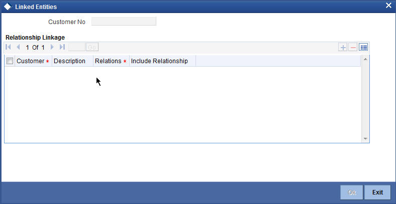

Click on the ‘Linked Entity’ button to invoke ‘Linked Entity’ screen. Here you can view details about customers who are linked to this customer, accounts for which this customer is linked, and loans which are guaranteed by this customer.

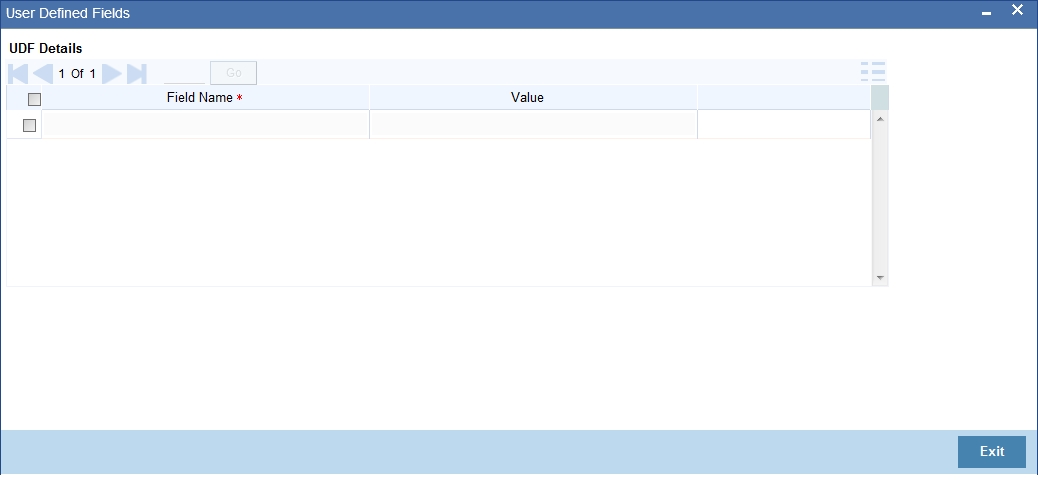

Click on the ‘Fields’ button to invoke ‘User Defined Fields’ screen. Here you can view the UDF details of the customer.
The screen is as shown below:

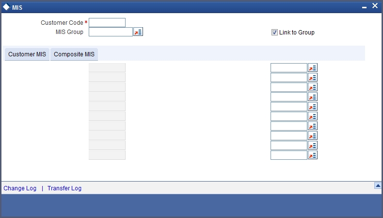

Click on the ‘MIS’ button to invoke ‘MIS’ screen. Here you can view the MIS details of the customer.

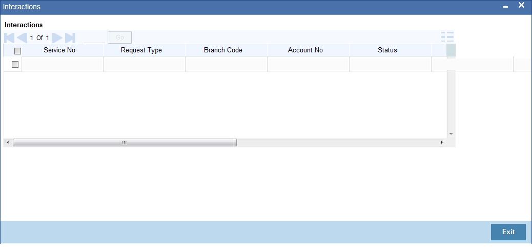

Click on 'Interactions' button to invoke 'Interactions' screen. You can view customer's interaction details here.
You can view the following details related to interactions:

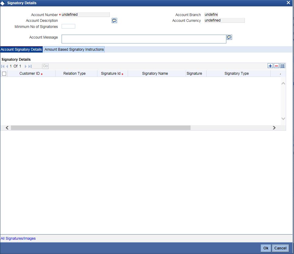

Click ‘Account Signatory’ button to view the ‘Signatory Details’ screen. In this screen, you can view the signatory details of the selected account.
You can view consolidated customer signature in the ‘Customer Signature/Image Consolidated View’ screen. To view this screen, click ‘All Signatures/Images’ button.
Refer the section ‘Specifying Account Signatory Details’ under the ‘Current and Savings Account’ module for more information.

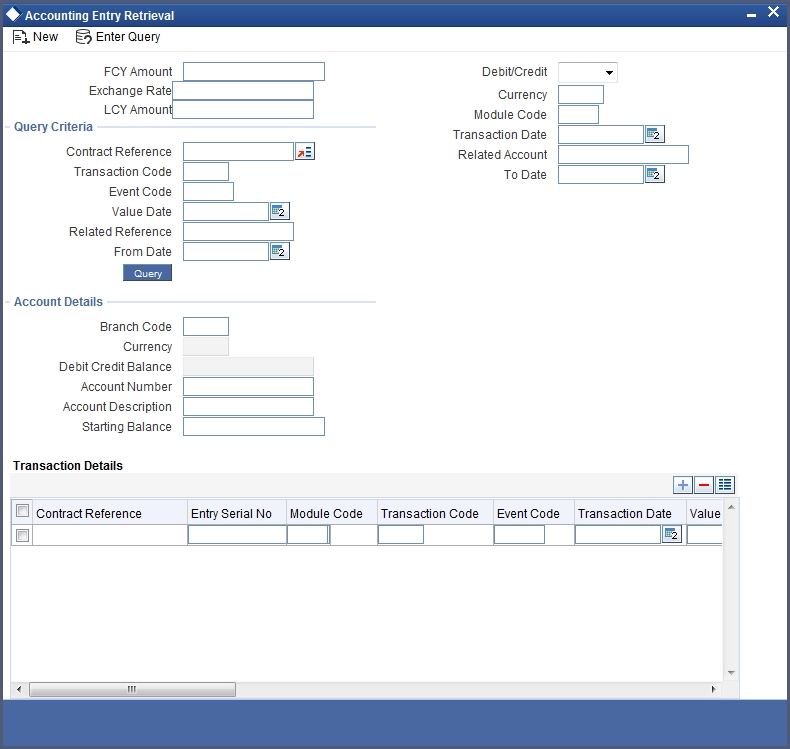

Click ‘Transactions’ button to view the ‘Customer Account Transaction Query’ screen. In this screen, you can query the transactions of an account during a given period.
Account Description
The system displays the description of the specified account number based on the details maintained at ‘Customer Account Maintenance’ level.
Refer the section ‘Querying Accounting Entries’ under ‘Core Services’ module for more information.

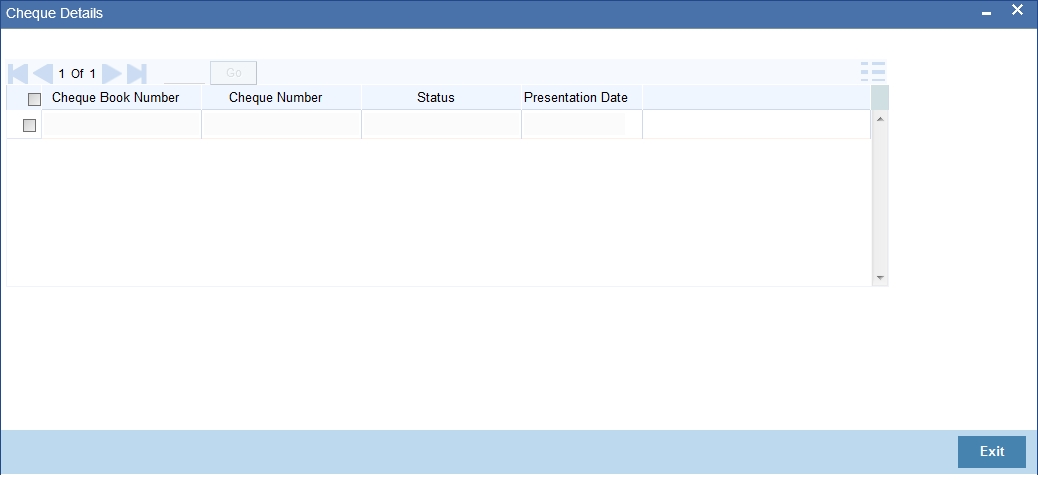

Click ‘Cheques’ button to view the ‘Cheque Details’ screen. In this screen, you can view the details of the cheques which are issued for a given period.

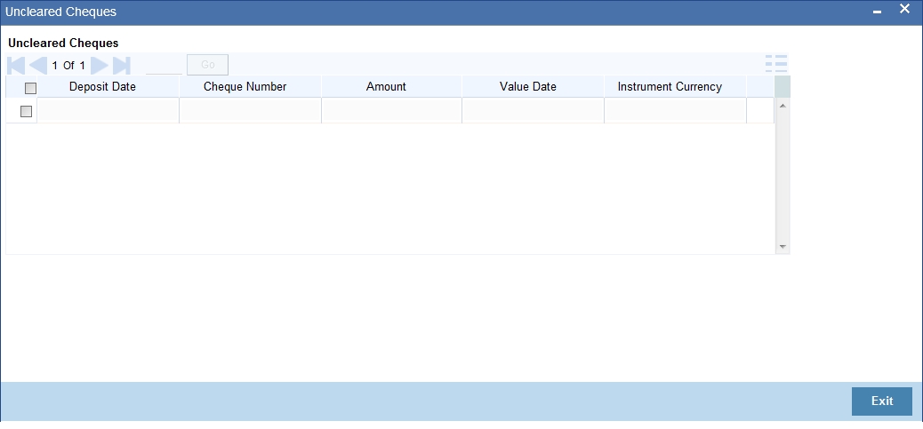

Click on 'Uncleared Cheques' button to invoke 'Uncleared Cheques' screen. You can view customer's cheques details which are uncleared in this screen.
You can view the following details related to uncleared cheques:

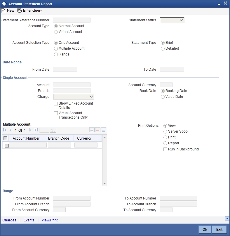

Click ‘Statement Generation’ button to view the ‘Account Statement Report’ screen. In this screen, you can generate adhoc statement for an account.
Refer the section ‘Account Statement Report’ under ‘Current and Savings Account’ module for more information.

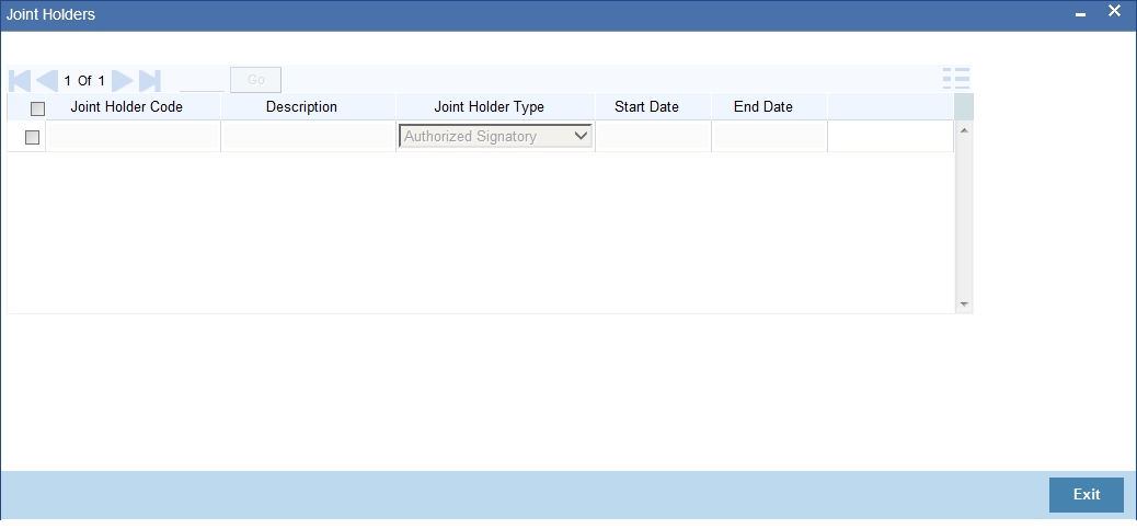

Click ‘Joint Holders’ button to view the ‘Joint Holders’ screen. In this screen, you can view the joint holders details.

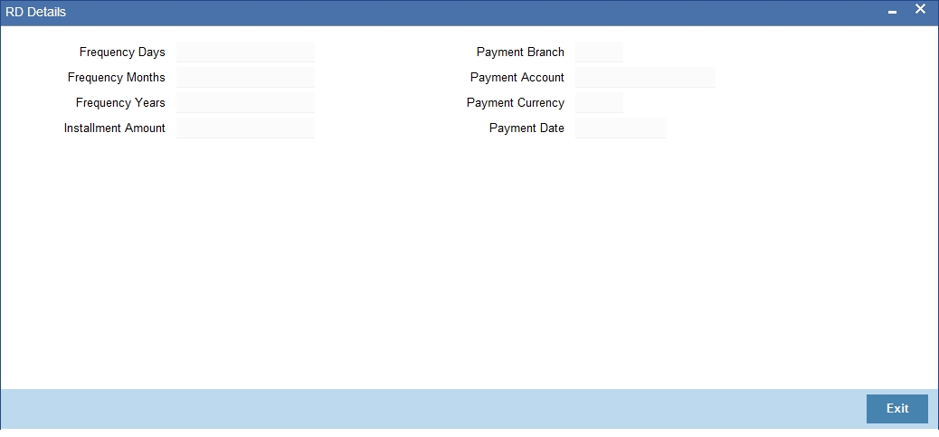

Click ‘Recurring Deposits Details’ button to view the ‘RD Details’ screen. In this screen, you can view recurring deposits if the deposit is recurring.

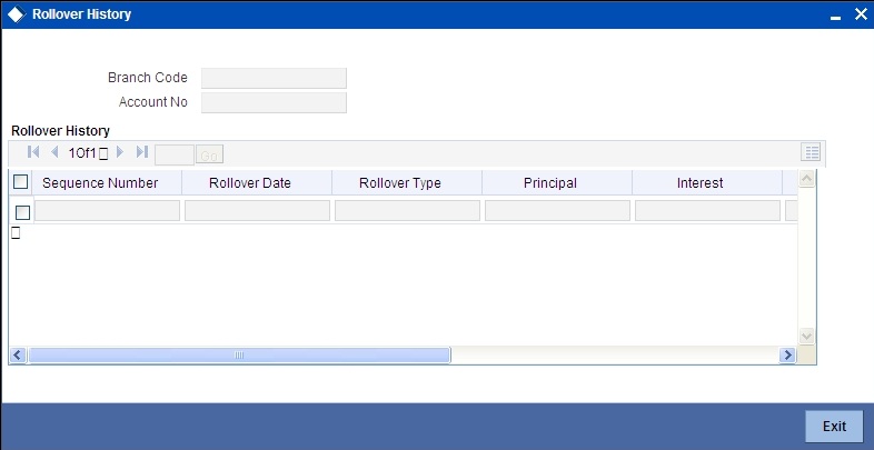

Click on ‘Rollover History’ button to view Rollover History screen.
You can view the following details here:

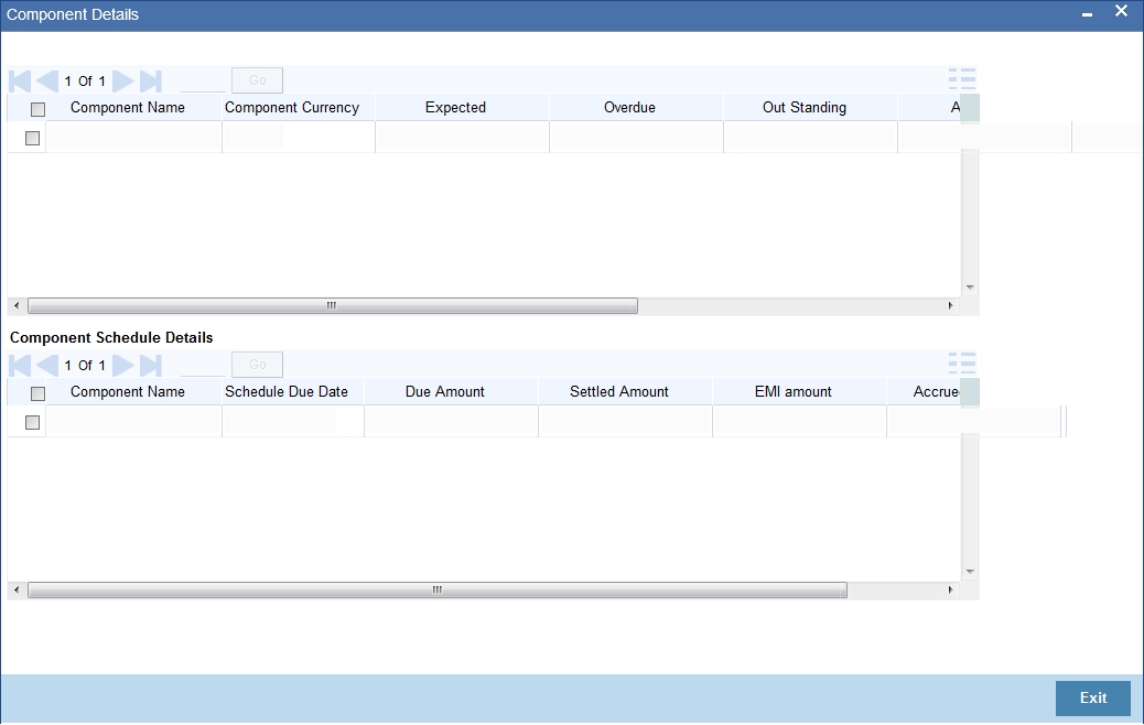

You can view details about the components linked to an account in the ‘Component Details’ screen. You can invoke this screen by clicking the ‘Component Details’ button in the ‘360 Degree Retail Customer View’ screen.
You can view the following component details:
Here you can view the following:

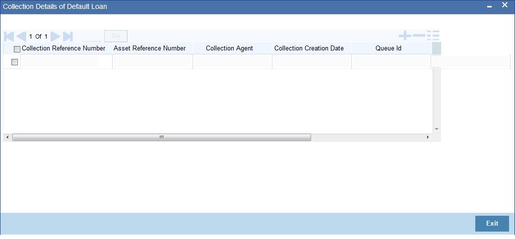

You can view the collection details of a loan in the ‘Collection Details of Default Loan’ screen. You can invoke this screen by clicking the ‘Collection Details’ button in the ‘360 Degree Retail Customer View’ screen.
Here, you can view the following details:

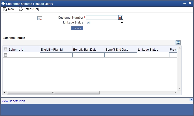

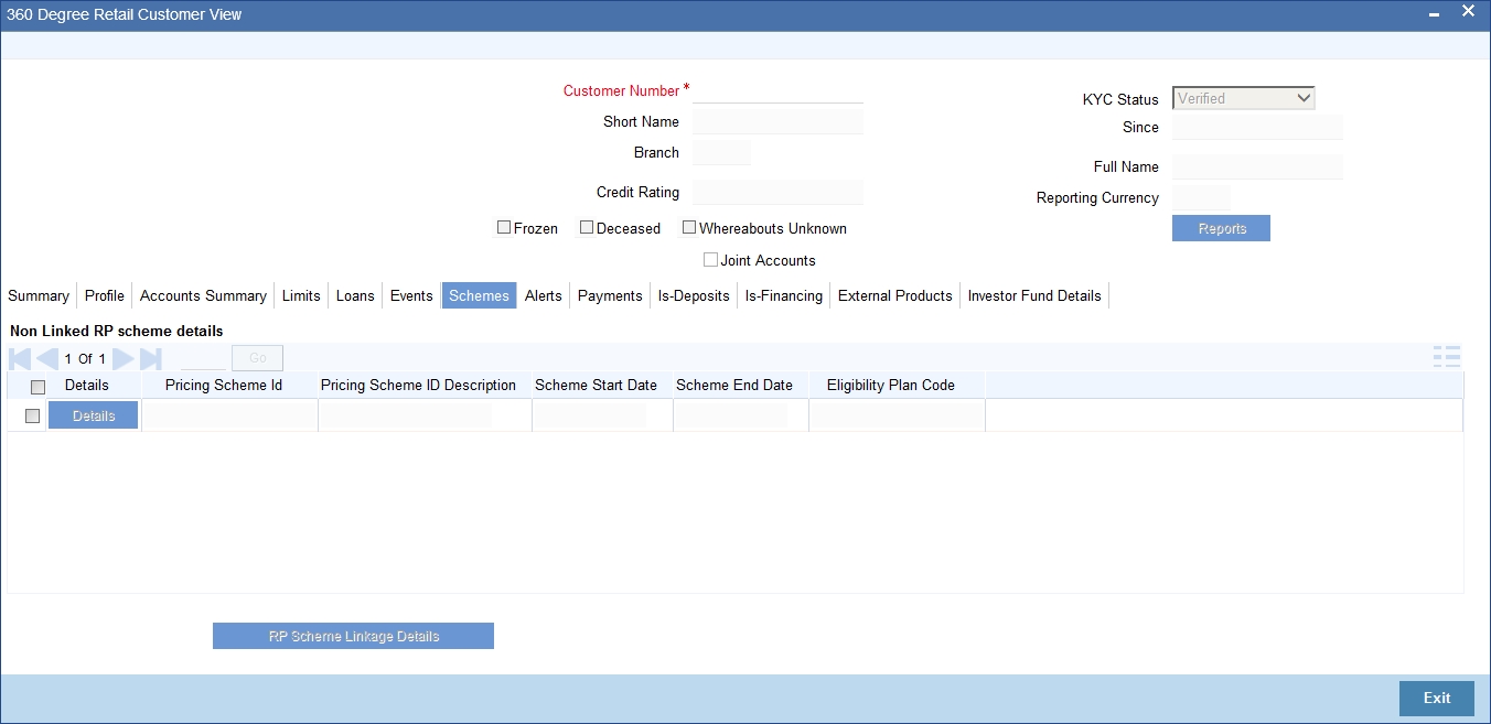

Click ‘Schemes’ tab in the ‘360 Degree Retail Customer View’ screen to view the details of the relationship schemes.
Here, you can view the relationship schemes which are not linked to the customer. The following fields are displayed:
Click ‘RP Scheme Linkage Details’ to view relationship pricing schemes linked to the customer.
Refer ‘Relationship Pricing’ module for more information about this screen.
Refer the section titled ‘Viewing Components Details’ under ‘Loans Tab’ for further details.

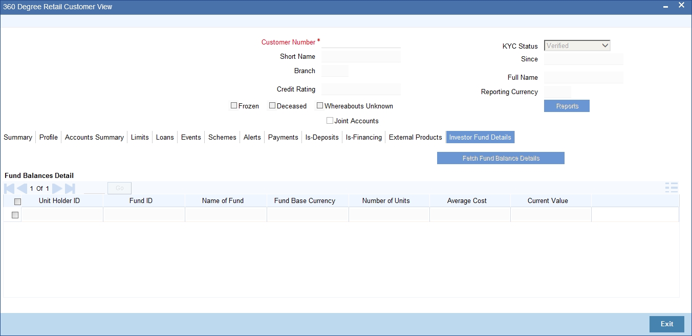

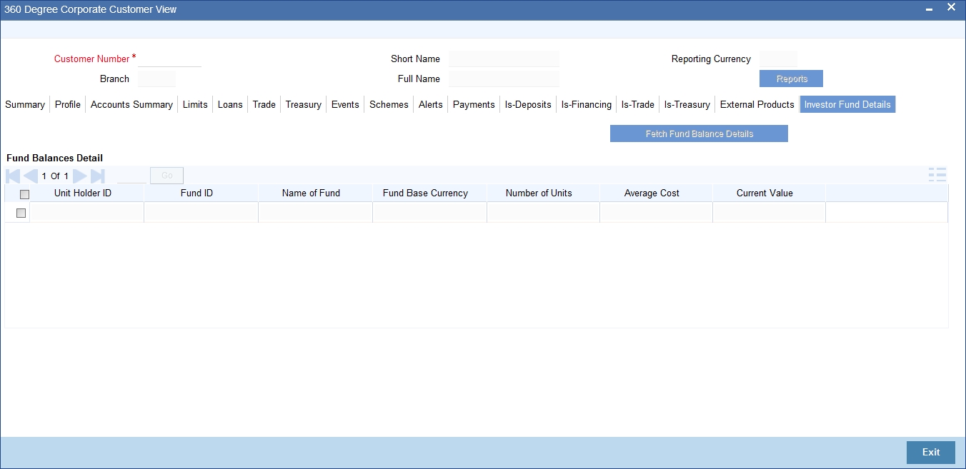

Click ‘Investor Fund Details’ tab in the ‘360 Degree Retail Customer View’ screen to view the mutual fund details. The following details relating to Mutual Fund can be viewed:
You can invoke ‘360 Degree Corporate Customer View’ screen if the customer is Corporate by double clicking on the customer record in the ‘360Degree Customer View Entry Point’ screen or by typing ‘STDCUSVW’ in the field at the top right corner of the Application tool bar and clicking on the adjoining arrow button.
The details that can be viewed in the ‘360 Degree Corporate Customer View’ screen is classified into 16 broad heads.
Field |
Description |
Summary |
You can view the address, status. Balance sheet asset and liabilities and off balance sheet asset and liabilities under the summary tab. |
Profile |
You can view the details of the customer’s profile. |
Deposits |
You can view the details of the customer deposits. |
Loans |
You can view the details of the customer’s loan. |
Trade |
You can view trade details |
Treasury |
You can view the details of Treasury. |
Events |
You can view the details of the upcoming events. |
Schemes |
You can to view the details of the relationship schemes. |
Alerts |
You can view the alerts for overdue loans, matured deposits but not renewed or liquidated, Locker Charges Overdue Details, cheques returned, amount block details and stop payment details. |
Limits |
You can view the limits and collaterals of the customer. |
Payments |
You can view the FT and PC contracts of the customer which is not liquidated. |
Is-Deposits |
You can view details about active CASA Account and Islamic Term Deposit. |
Is-Financing |
You can view details about Islamic Finance. |
Is-Trade |
You can view Islamic trade details. |
Is-Treasury |
You can the details of Islamic Treasury. |
External Products |
You can view external details about products like credit cards, insurance, and mutual fund. |
Investor Fund Details |
You can view the mutual fund details in this screen |
Refer the section titled ‘Viewing Summary Details’ under ‘Viewing 360 Degree Retail Customer Details’ for further details.
Refer the section titled ‘Viewing Signature Image and Photograph of the customer’ under ‘Viewing 360 Degree Retail Customer Details’ for further details.
Refer the section titled ‘Viewing Related Customer Details’ under ‘Viewing 360 Degree Retail Customer Details’ for further details
Refer the section titled ‘Viewing User Defined Fields’ under ‘Viewing 360 Degree Retail Customer Details’ for further details.
Refer the section titled ‘Viewing MIS Details’ under ‘Viewing 360 Degree Retail Customer Details’ for further details.
Refer the section titled ‘Viewing Cheques’ under ‘Viewing 360 Degree Retail Customer Details’ for further details.

Click ‘Account Signatory’ button to view the ‘Customer Signatory Details’ screen. In this screen, you can view the signature image and photograph of the customer.
Refer the section titled ‘Viewing Recurring Deposits Details’ under ‘Viewing 360 Degree Retail Customer Details’ for further details.

You can view the collection details of a loan in the ‘Collection Details of Default Loan’ screen. You can invoke this screen by clicking the ‘Collection Details’ button in the ‘360 Degree Corporate Customer View’ screen.
Refer the section titled ‘Viewing Collection Details’ under ‘Viewing 360 Degree Retail Customer Details’ for further details.

Click ‘Schemes’ tab in the ‘360 Degree Corporate Customer View’ screen to view the details of the relationship schemes.
Refer the section titled ‘Viewing Schemes Details’ under ‘Viewing 360 Degree Retail Customer Details’ for further details.

You can view details about the components linked to an account in the ‘Component Details’ screen. You can invoke this screen by clicking the ‘Component Details’ button in the ‘360 Degree Corporate Customer View’ screen.
Refer the section titled ‘Viewing Components Details’ under ‘Viewing Loan Details’ for further details.

Click ‘Investor Fund Details’ tab in the ‘360 Degree Corporate Customer View’ screen to view details of the mutual fund.
The following details on a mutual fund can be viewed in this screen:

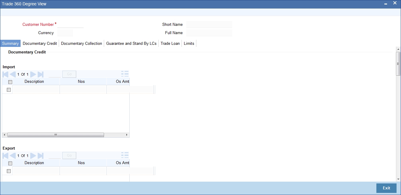

You can invoke Trade 360 degree view of the customer by typing ‘STDTRDVW’ in the field at the top right corner of the Application tool bar and clicking on the adjoining arrow button.
This facility is only supported for corporate customers.
Customer Number
Specify the customer number for which the trade summary is to be viewed.
The system displays the following:

Contract Details
Select a product type from the drop down list and click ‘Populate’ button to view the details.The options are:
Note
Only Guarantee/Stand by LC contracts in Active and Authorized status are considered for all above options
Select a record and click Details button to view the details in view mode.
Contract Details
