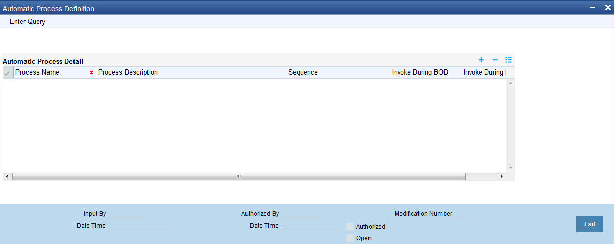

The events that are to take place automatically are triggered off during what is called the Batch Process. The batch process is an automatic function that is run as a mandatory Beginning of Day (BOD) and/or End of Day (EOD) process. During EOD, the batch process should be run after end-of-transaction-input (EOTI) has been marked for the day, and before end-of-financial-input (EOFI) has been marked for the day.
You have the facility to configure the batch processes to be executed either at EOD or BOD or both, as per the bank’s requirement. This is achieved through the ‘Automatic Process Definition’ screen. You can invoke this screen by typing ‘CLDTPROC’ in the field at the top right corner of the Application tool bar and clicking the adjoining arrow button.

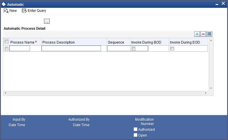

In this screen, you can amend the order of the various operations in the CL batch and choose to trigger them at EOD or BOD or both.
The default configuration is given below:

These batch processes are factory shipped for your bank. Note that you need to set the ‘UDBATEVT’ batch as a predecessor to the Islamic Financing batch ‘CIDBATCH’.

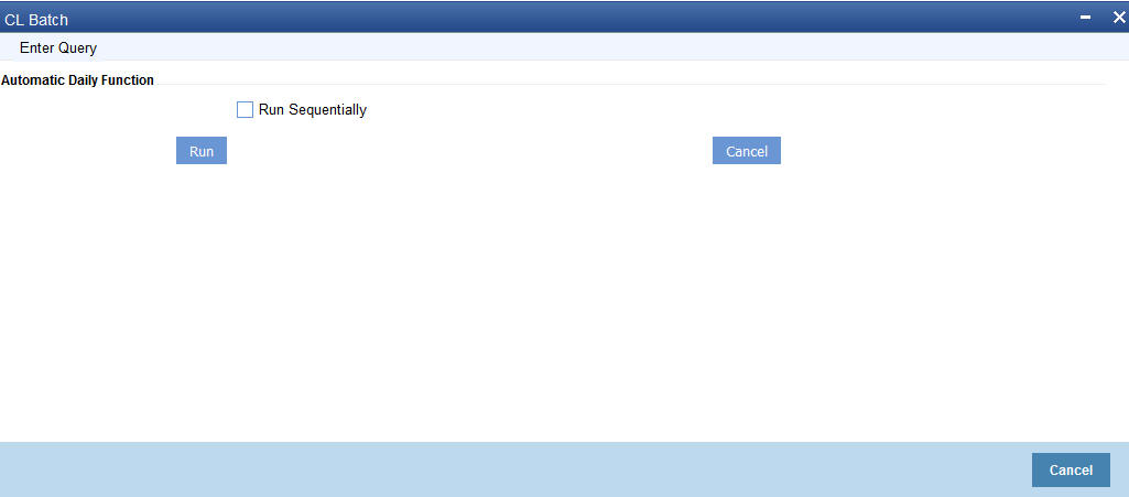

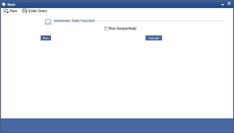

If you have opted to trigger the batch programs at EOD, the same will be executed as part of the ‘End of Cycle Operations’ after marking the ‘EOTI’ for the day. If the trigger is maintained as ‘BOD’, the programs will be executed before the start of ‘Transaction Input’. However, the programs will be triggered both at EOD and BOD if you opt to trigger it at both the instances.
You also have the option to execute the batch programs through the ‘CL Batch’ screen. Note that you can process the transactions booked under the Retail lending module too using this batch process. You can invoke this screen by typing ‘CLDBATCHC’ in the field at the top right corner of the Application tool bar and clicking the adjoining arrow button.
You can opt to execute the processes as per the sequence maintained in the ‘Automatic Process Definition’ screen. To do this, check the ‘Run Sequentially’ option.
The CL Batch process handles multi threading. The number of parallel processes and the interval between processes is maintained as part of ‘CL Branch Parameters’.

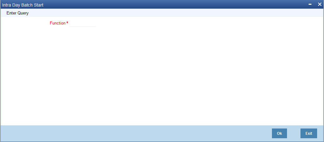

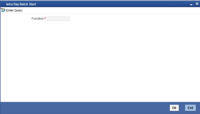

The Intra Day Accruals is a batch process that computes accruals for different kinds of investments made by funds. This batch includes processing of fixed asset depreciation. The intraday accruals / depreciation are performed only for those products for which accruals / depreciation cycle is due for the day. In case of inter-fund subscriptions, the system does not calculate the profit for the investing fund. You can invoke ‘Intra Day Batch Start’ screen by typing ‘BABIDBAT’ in the field at the top right corner of the Application tool bar and clicking the adjoining arrow button.
This is an intra day process that is applicable only to fund branches.
Intra Day Accruals work in line with the normal end of day accruals. Intra day accrual will process in the same manner as an End of Day (EOD) batch. In this module, it is processed based on the branch level accrual parameters.

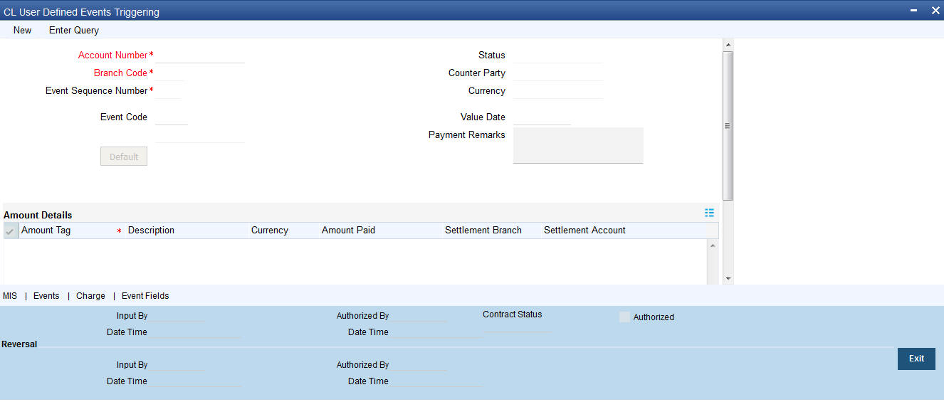

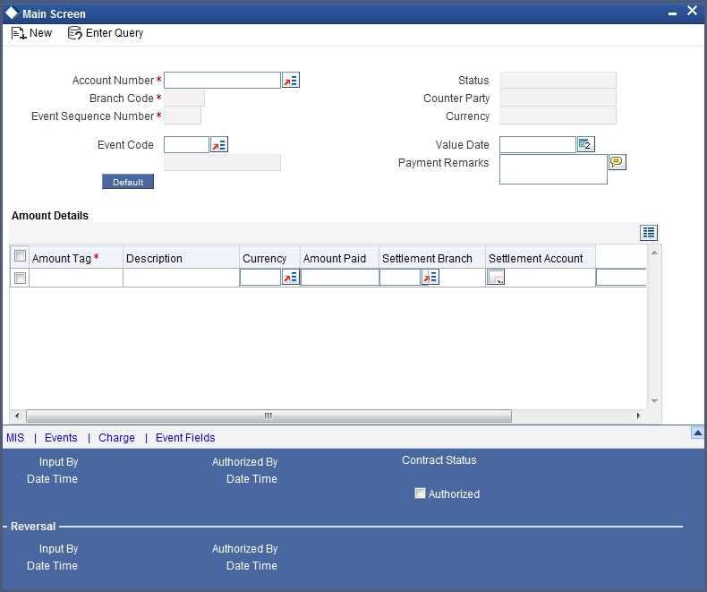

You can use the ‘CL User Defined Events Triggering’ screen to manually trigger the user defined events for Islamic Financing accounts. You can this screen by typing ‘UDDCLEVT’ in the field at the top right corner of the Application tool bar and clicking on the adjoining arrow button.
Here you need to specify the following details:
Account Number
Specify the account for which you want to trigger the user defined event. The adjoining option list displays all valid account numbers available in the system. You can select the appropriate one.
Branch Code
The system displays the code of the branch where the account resides.
Click ‘Default’ button. The system fetches values for the following fields based on the selected contract and displays them:
Event Sequence Number
The system displays the event sequence number.
Event Code
Specify the event that needs to be triggered for the selected account. The adjoining option list displays all events linked to the account. You can select the appropriate one.
Value Date
If the value date derivation rule has been maintained for the event code, the system will calculate the value date and display it here. However, you can change it.
Payment Remarks
Specify remarks pertaining to the payment on the account.
Specify the following details.
Amount Tag
The amount tag is displayed based on the product-level maintenance of the specified account.
Description
The system displays a brief description of the amount tag.
Currency
If a derivation rule has been maintained for the event code, the system will derive the currency as per the rule and display it here. However, you can change it.
Amount Paid
If a derivation rule has been maintained for the event code, the system will derive the amount as per the rule and display it here.
Settlement Branch
Specify the branch where the settlement account resides. The adjoining option list displays all valid branch codes maintained in the system. You can select the appropriate one. Alternatively, if you have specified the settlement account, the system will display the corresponding branch code here.
Settlement Account
Specify the account that should be debited or credited. The adjoining option list displays all valid accounts maintained in the system. If you have specified the settlement branch, the option list will display all accounts available in that branch. You can select the appropriate one.

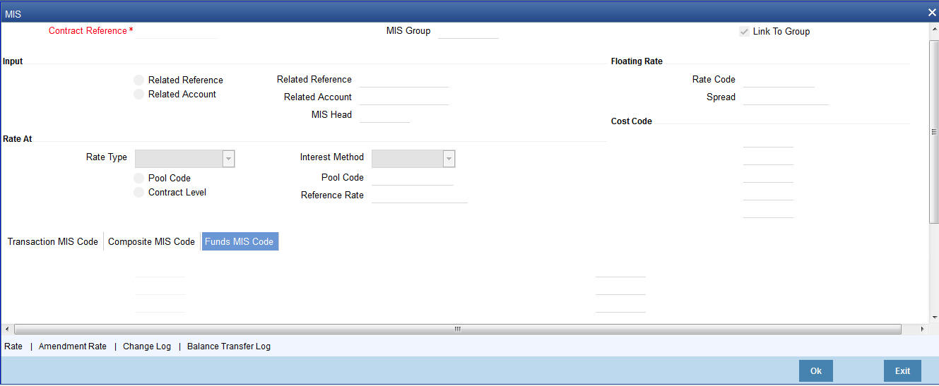

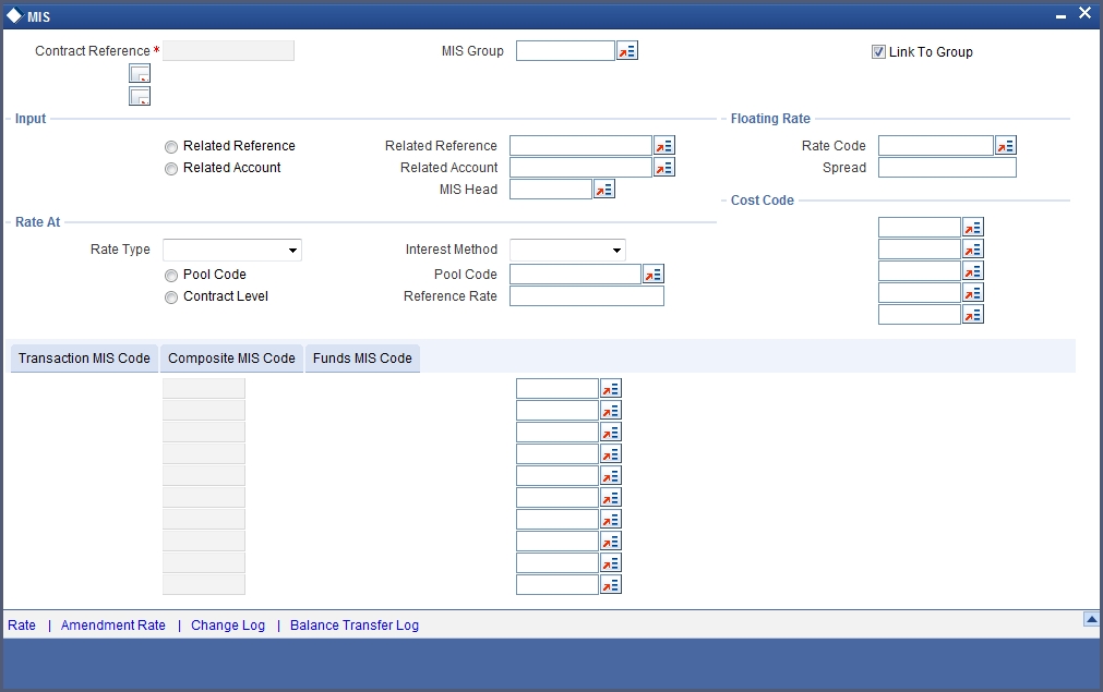

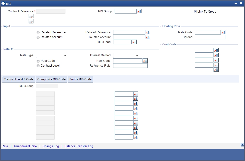

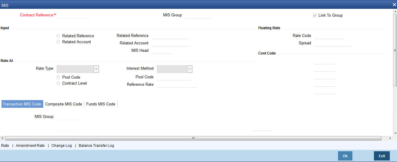

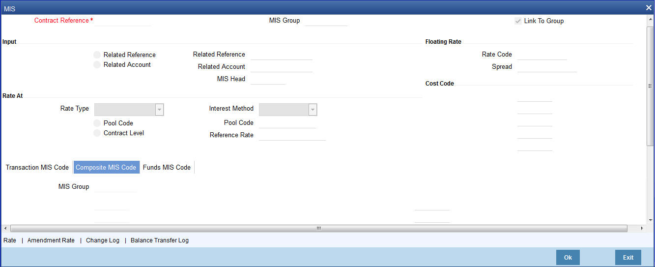

Click ‘MIS’ button the screen and invoke the ‘MIS’ screen.
You can view the following details:
The ‘Transaction MIS’ tab opens by default.
Here you can view the transaction MIS codes.
Click this tab to view composite MIS codes.
Click this tab to view fund MIS codes.
Click ‘Rate’ button on the ‘MIS’ screen and invoke the ‘Rate Details’ screen.
Here you can view the following details:
Click ‘Amendment Rate’ button and invoke the ‘Rate Details’ screen.
Click ‘Rate’ button on the ‘Rate Details’ screen and invoke the ‘Rate Details’ screen.

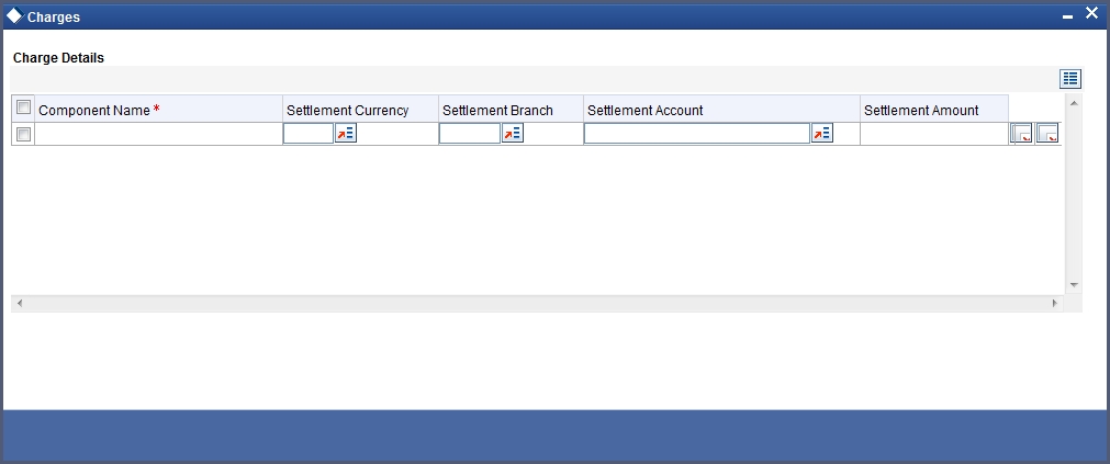

Click ‘Charge’ button on the ‘CL User Defined Events Triggering’ screen and invoke the ‘Charges’ screen.

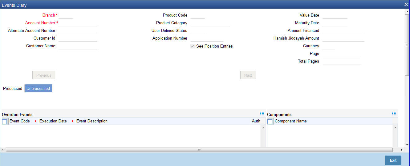

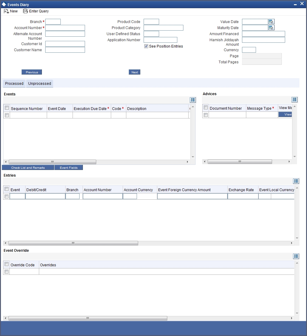

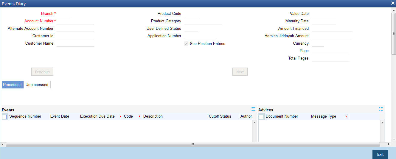

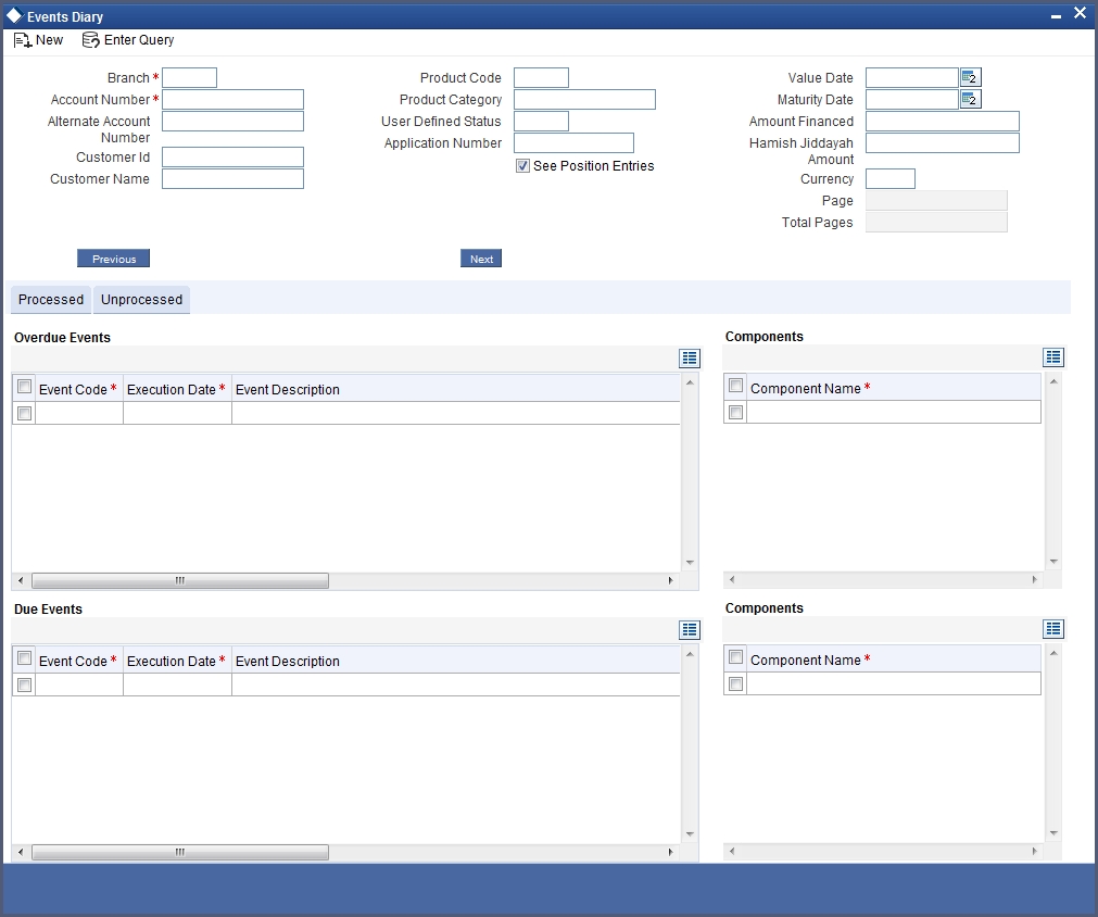

Click ‘Events’ button on the ‘CL User Defined Events Triggering’ screen and invoke the ‘Events Diary’ screen.
Click this tab to view the unprocessed event details.
Refer the section ‘Events Diary’ in the chapter titled ‘Account Creation’ in this User Manual for details about the ‘Events Diary’ screen.

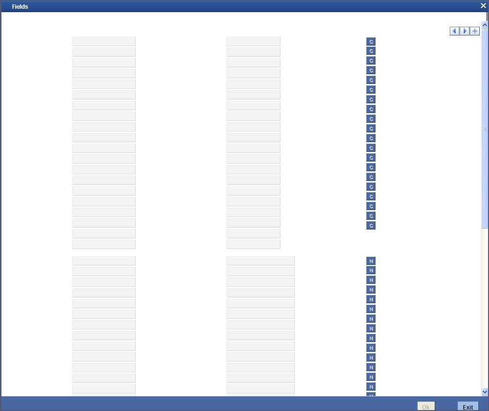

Click ‘Event Fields’ button on the ‘CL User Defined Events Triggering’ screen and invoke the ‘Fields’ screen.
Here you can view the UDFs and their values linked to the account.
Click save icon after specifying the details in order to trigger the event for the specified account. This record needs to be authorized for the event to be triggered.
Note that, you will not be able to perform any operation on the account on which there is an unauthorised event triggering record.
