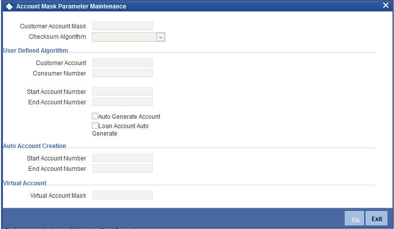

Defining Format Masks
A format mask is a structure that you can you can define for various elements that need to be entered in Oracle FLEXCUBE. You can define format masks for the following elements:
Once defined, you can modify the structure of a format mask only if no Customer or General Ledger Account has been opened using the mask. Customer Account mask is defined from the ‘Account Mask’ Button.
For more details on defining customer account mask, refer the section titled ‘Specifying Account Generation Parameters at Bank Level’.

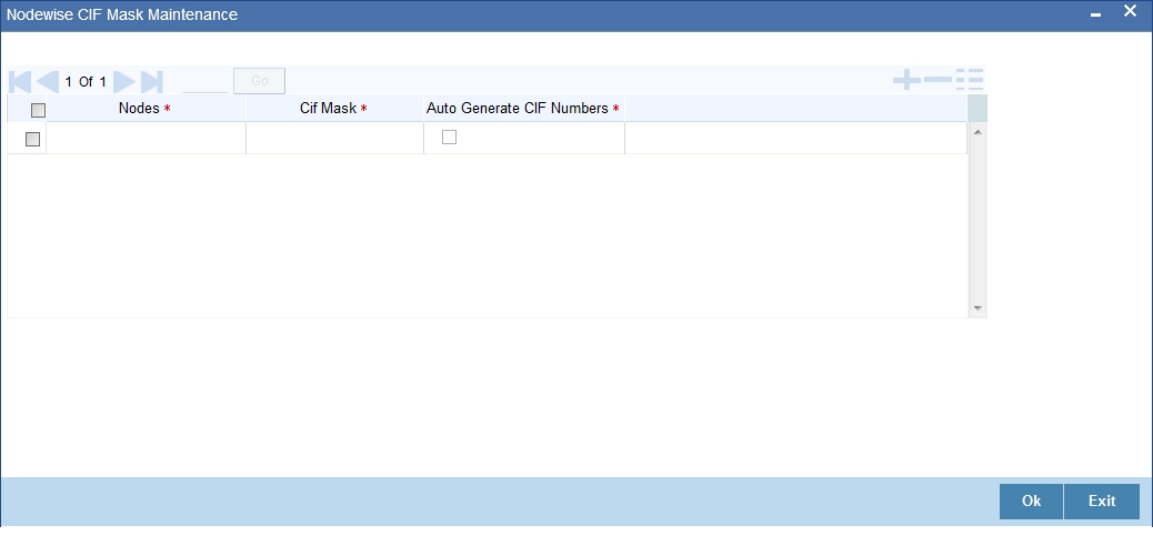

CIF Mask
You can maintain a mask for generation of identification numbers (CIF Number) for customers of your bank. During customer information maintenance, the system will automatically generate the CIF numbers based on the mask you define here and the customer number range maintained at the branch level.
A CIF mask consists of a maximum of 9 digits. The CIF mask could have only numbers or could be alpha numeric or could also have the branch code as a part of it.
For instance, you can maintain the CIF Mask as ‘bbbnnnnnn’ where ‘bbb’ represents a three-digit branch code and ‘nnnnnn’ represents a 6-digit number.

If you select ‘Node’ from the option list, you will need to maintain CIF masks at the Node level in the ‘Node-wise CIF Mask Maintenance’ screen. This would ensure that the branches maintained in different nodes/instances have different CIF masks.
Click ‘Nodewise CIF mask Maintenance’ button to access this screen. The screen appears as shown below:
You can specify the following details here:
Nodes
This indicates the node/instance for which the CIF mask is required. Select a node from the option list provided.
Customer Identification File Mask
This indicates the CIF mask for the corresponding instance/node. Select a CIF mask from the option list provided.
Autogenerate Customer Identification File Number
This indicates whether or not the CIF should be generated automatically. Check this box to indicate the CIF number needs to be generated automatically.

2.1.6 Account Mask Button
Account numbers in your bank are generated in the format of the account mask that you specify through the ‘Account Parameters’ sub-screen of the Bank-wide Parameters screen. Click ‘Account Mask’ button in the Bank-wide Parameters screen. Account Parameters screen is displayed. The screen appears as shown below:
Note
Since account level parameters are defined at the bank-level, by default these parameters will be defaulted to all the branches of your bank. However, individual branches of your bank will be allowed to change these specifications.
Specifying Customer Account Mask
Account numbers can either be generated automatically or you can choose to allocate them manually. In Oracle FLEXCUBE you have the option of maintaining three types of account masks.

Numeric Account Masks with User Defined Algorithms as Checksum Algorithm
If the check digit component within a Customer Account Number is to be generated using a method of your choice you must identify the following:
While capturing Customer Account numbers, the System checks for your specification for the checksum algorithm. If you have selected User Defined, the check digit is generated using the specified user-defined algorithm.
Since these parameters are maintained for your bank, they are defaulted to the branches of your bank. You will not be allowed to change these for a specific branch of your bank.

Specifying Auto Account Creation Parameters
You may wish the system to automatically create current accounts for customers at the time of loan initiation. These system-created current accounts are for use as settlement accounts.
Here, you need to specify the range of numbers available for such auto created accounts by mentioning a start and an end number.
If you wish to retain the facility of auto creation of current accounts at loan initiation, you will have to ensure that the account number mask does not have any user input character.

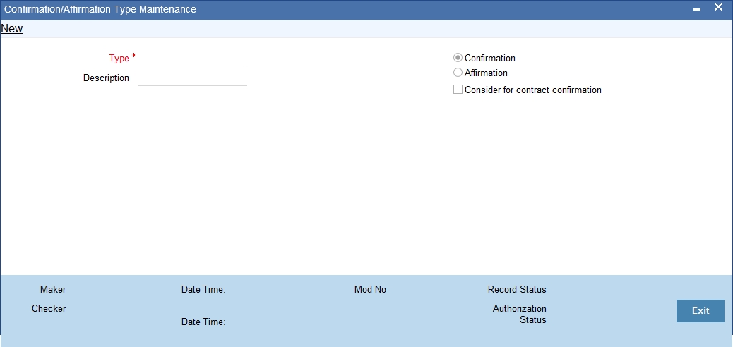

2.2.1 Invoking Confirmation/ Affirmation Type Maintenance
Manual confirmations received by FAX/telephone/Hard-copy etc. (Affirmation) need to be registered for a deal. You can maintain different Confirmation/Affirmation Types using ‘Confirmation/Affirmation Type Maintenance’ screen. You can invoke this screen by typing ‘STDCNTYP’ in the field at the top right corner of the Application tool bar and clicking the adjoining arrow button.
You can specify the following details:
Type
Specify the confirmation or affirmation type.
Type Description
Specify the description for the selected type.
Select the type of contract. The options are as follows:
Consider for Contract Confirmation
Check this box for affirmation type of contract.
If this field is checked for an affirmation type and an affirmation is done for the contract with this affirmation type, then the contract will be considered as ‘Confirmed’.

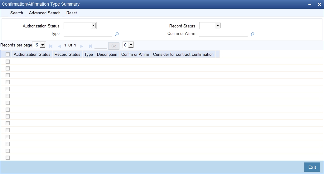

2.2.2 Viewing Confirmation/ Affirmation Type Summary Details
You can view confirmation or affirmation type details using ‘Confirmation/ Affirmation Type Summary’ screen. You can invoke this screen by typing ‘STSCNTYP’ in the field at the top right corner of the Application tool bar and clicking the adjoining arrow button.
In the above screen, you can base your queries on any or all of the following parameters and fetch records:
Select any or all of the above parameters for a query and click ‘Search’ button. The following records are displayed.:

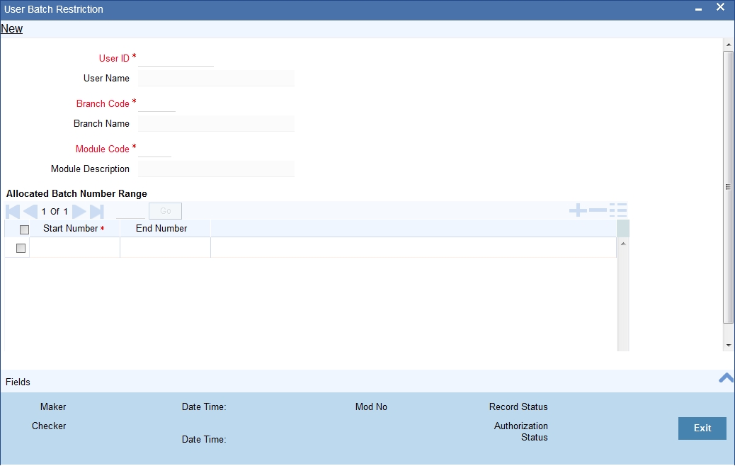

2.3 Branch Restriction Maintenance
2.3.1 Placing User Restrictions on Data Entry Batches
You can restrict the usage of batches to specific user by placing bank-wide User level batch restrictions. If you enable this option as a Bank Parameter, you need to allocate the batch number range for each user through the ‘Batch Restriction Maintenance’ screen.
The restriction on the usage of batch numbers is made applicable on data entry and PC transactions. The user will be allowed to enter only those batches reserved for the user profile. As a result, each time a user specifies a batch number; it will be validated against the ‘Allocated Batch Number Range’.
This feature is applicable only when batch generation is manual. Therefore, if you enable this option, you must ensure that the Auto Generate option has not been enabled. In a scenario where the User Restriction for Batch Number field is enabled and Auto Batch option has also been enabled, the system displays an error message as “Not a Valid Batch Number For the User”.
In case you choose to auto generate batch numbers, the System will not perform the batch restriction validation.
You can invoke the ‘Batch Restrictions Maintenance’ screen by typing ‘STDBRRES’ in the field at the top right corner of the Application tool bar and clicking the adjoining arrow button.
Specify the following details in this screen:
Note
While processing DE and PC transactions, the batch number specified by the user is val­idated against the allotted range. If the validation fails, an error message is displayed.
These validations are made applicable even during the Batch Upload operations for the following functions:
  1. Journal Online – Single Entry
  2. Multi-offset Entry
  3. Teller Transaction Input
SSO Enabled
To enable Single Sign On (SSO) for your installation check the SSO Enabled check box. This enables restricted login from external systems into Oracle FLEXCUBE.
General Ledger Purge Days
You can specify here the maximum number of working days, the average GL balance computation for which is to be retained in the System.
