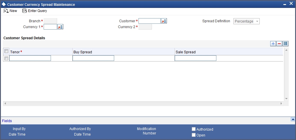

For a customer and currency pair, you can maintain tenor-wise spread details in the ‘Customer Currency Spread Maintenance’ screen.
You can invoke this screen by typing ‘CYDCUSPR’ in the field at the top right corner of the Application tool bar and clicking the adjoining arrow button.
In this screen, for a customer and currency pair, you can maintain buy and sell spreads for different tenors.
You need to maintain customer spreads in each branch. Transactions initiated in a branch will pick up the spread(s) maintained for that branch.
