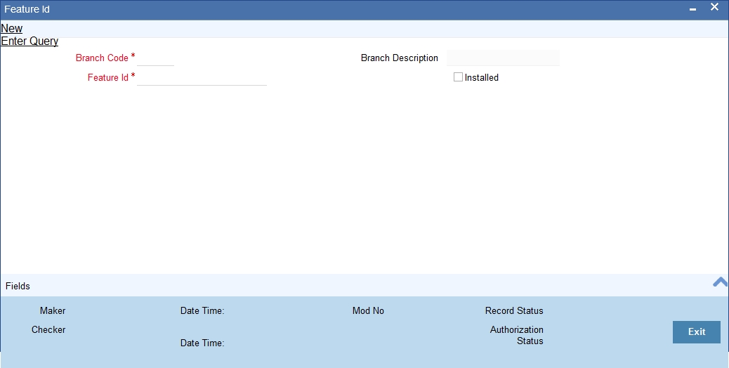

You can maintain required features using the ‘Feature ID Maintenance’ screen. You can invoke this screen by typing ‘ ‘CSDFEMNT’in the field at the top right corner of the Application tool bar and clicking the adjoining arrow button.
You can specify the following details:
Branch Code
Specify the branch where the feature needs to be installed. The adjoining option list displays all valid branch codes maintained in the system. You can select the appropriate one.
Branch Name
The branch name is displayed here based on the chosen branch code.
Feature Id
Specify the feature that should be installed in the branch. You can also choose any of the following values from the adjoining option list:

Installed
Check this box to indicate that the feature should be installed in the branch.
Click save icon in the Application tool bar to save the changes.

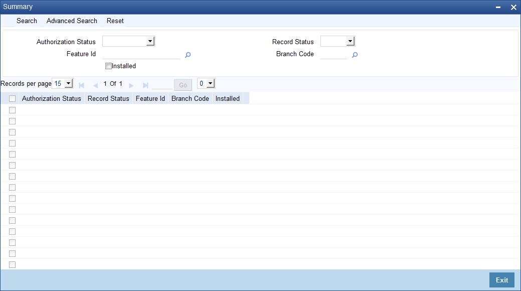

You can view summary of all feature IDs installed across branches, using the ‘Feature ID Summary’ screen. To invoke this screen, type ‘CSSFEMNT’ in the field at the top right corner of the Application tool bar and click the adjoining arrow button.
The screen is as shown below:
You can query on records based on any one or all of the following criteria:
Click ‘Search’ button. The system identifies all records satisfying the specified criteria and displays the following details for each one of them:
Double click on a record to invoke the detailed screen for that record.

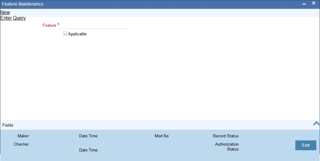

You can maintain required features using the ‘Feature Maintenance’ screen. You can invoke this screen by typing ‘CSDFTRMN’ in the field at the top right corner of the Application tool bar and clicking the adjoining arrow button.
Specify the following details:
Feature
Specify the feature that you need to query.
Applicable
The system defaults this check box when you execute the query with the feature name.
All User Defined Fields (UDFs) linked to the function ID ‘CSDFTRMN’ are displayed in the ‘User Defined Fields’ screen. Invoke this screen by clicking ‘Fields’ button on the ‘Feature Maintenance’ screen.
For more information on UDF refer to the ‘User Defined Field’ User manual

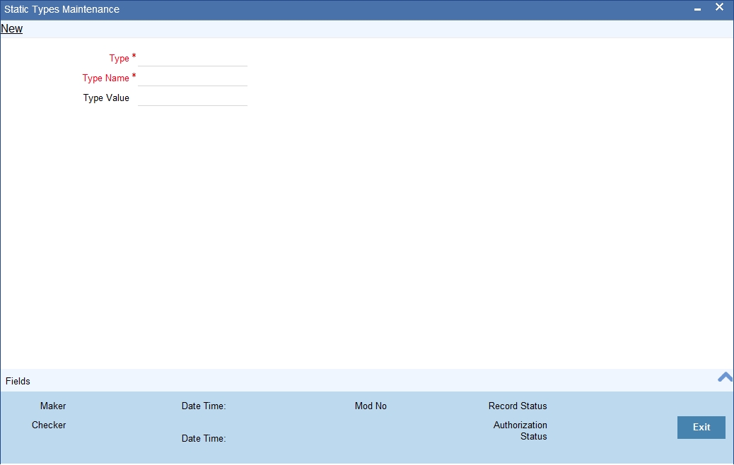

You can maintain different type of channels in the ‘Static Type Maintenance’ screen. You can invoke the ‘Static Type Maintenance’ screen by typing ‘CODTYPES’ in the field at the top right corner of the Application tool bar and clicking on the adjoining arrow button.
The ‘Static Type Maintenance’ screen is shown below:
You can specify the following here:
Type
Specify the static type.
Type Name
Specify the type name.
Type Value
Specify the type value.
After entering the details, click the ’Save’ button.

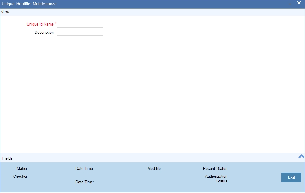

You can maintain the unique identifier details in the ‘Unique Identifier Maintenance’ screen. You can invoke this screen by typing ‘CODUIDN’ in the field at the top right corner of the Application tool bar and clicking on the adjoining arrow button.
The ‘Unique Identifier Maintenance’ screen is shown below:
Unique ID Name
Specify the Unique ID name.
Description
Enter a brief description for the Unique ID.

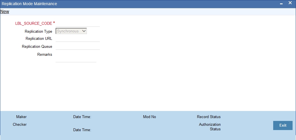

You can invoke the ‘Replication Mode Maintenance’ screen by typing ‘CODELREP’ in the field at the top right corner of the Application tool bar and clicking on the adjoining arrow button.
The ‘Replication Mode Maintenance’ screen is shown below:
Click the Enter Query button to enter the following query criteria.
Source Code
Specify the source code for which you are maintaining the replication mode. Select the appropriate one from the option list
Replication Type
Select the replication type. Select one of the following:
Replication URL
Specify the replication URL.
Replication Queue
Specify the replication queue.
Remarks
Enter the remarks, if any.
