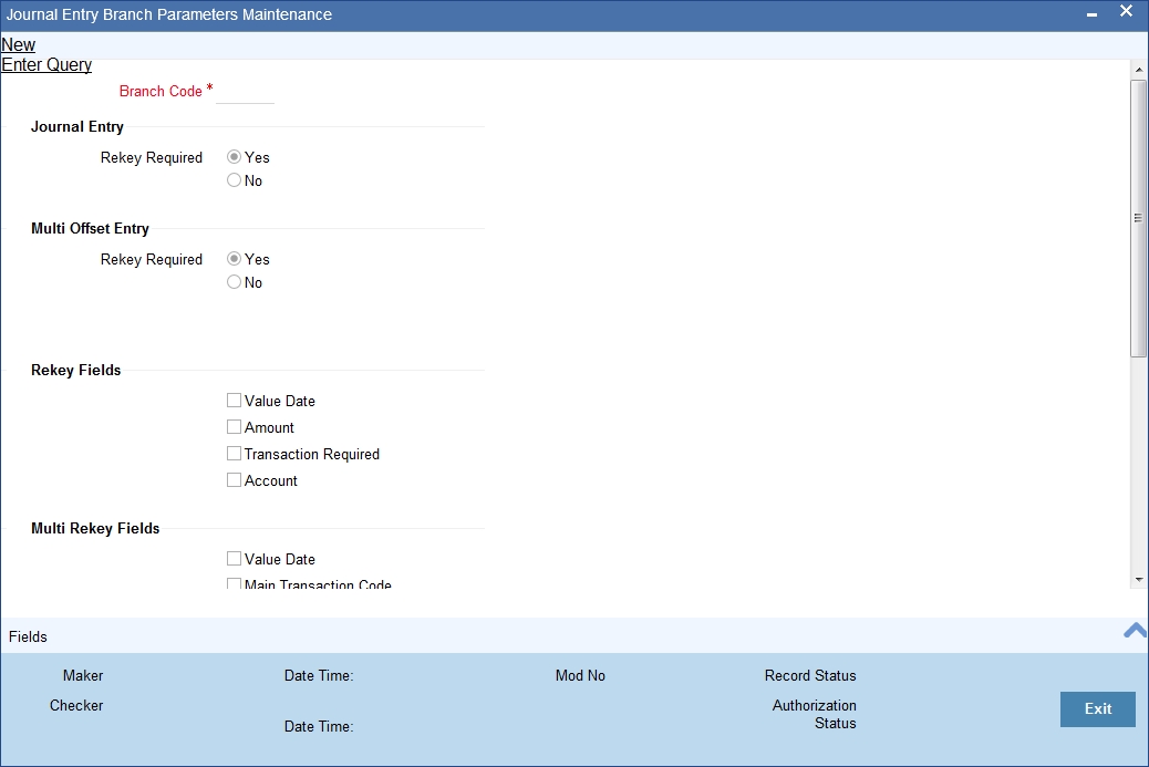

You can invoke the ‘Journal Entry Branch Parameters Maintenance’ screen by typing ‘DEDBRCON’ in the field at the top right corner of the Application tool bar and clicking the adjoining arrow button.
Click new icon. You can now maintain the branch conditions for your branch.
Branch Code
Select the branch for which you are maintaining the parameters.
You can specify the values that the authorizer of a transaction has to rekey when authorizing it.
All operations on a transaction (input, modification, etc.,) have to be authorized:
When you invoke a transaction for authorization—as a cross-checking mechanism to ensure that you are calling the right transaction—you can specify that the values of certain fields should be entered before the other details are displayed. The complete details of the transaction will be displayed only after the values to these fields are entered. This is called the ‘re-key’ option. The fields for which the values have to be given are called the ‘re-key’ fields.
If no re-key fields have been defined, the details of the transaction will be displayed immediately when the authorizer calls the transaction for authorization. The re-key option also serves as a means of ensuring the accuracy of inputs.
You can specify the values of Journal and Multi-offset transactions that the authorizer should rekey in this screen.
Under Journal Entry (on the top left corner) and Multi-Offset Entry (top right corner), you will find the following option: Rekey Required Under this option you will see two buttons against ‘Yes’ and ‘No’ respectively.
Click on the button against Yes if you want the authorizer of journal transactions to rekey values. Similarly, click on the button against Yes if you want the authorizer of multi offset transactions to rekey important fields.
Click on the button against No, in these fields, if you do not want the authorizer to rekey values at the time of authorization.
Under Journal Entry and Multi Offset Entry respectively, you will see a list of re- key fields. Check against the fields that you want to be re-keyed at the time of authorizing for Journal and Multi Offset entries.
The fields that can be re-keyed for journal entries are:
The fields that can be re-keyed for multi offset entries are:
The advantages
The ‘Rekey at authorization’ facility is a cross-checking mechanism, which has been provided in Oracle FLEXCUBE. By rekeying the values of a transaction the authorizer can ensure that a transaction is error free.
For instance, you have debited a sum of $100 USD from a customer account. The account number of the customer is USDUS100003D. The Value Date of the transaction is 20/12/99.
The authorizer of the above transaction will have to rekey, for example, the Account Number of the customer; the Amount of the transaction; and the Value Date of the transaction if you have indicated that these values have to be rekeyed at the time of authorization.
By doing so the authorizer can ensure that the transaction is error free.

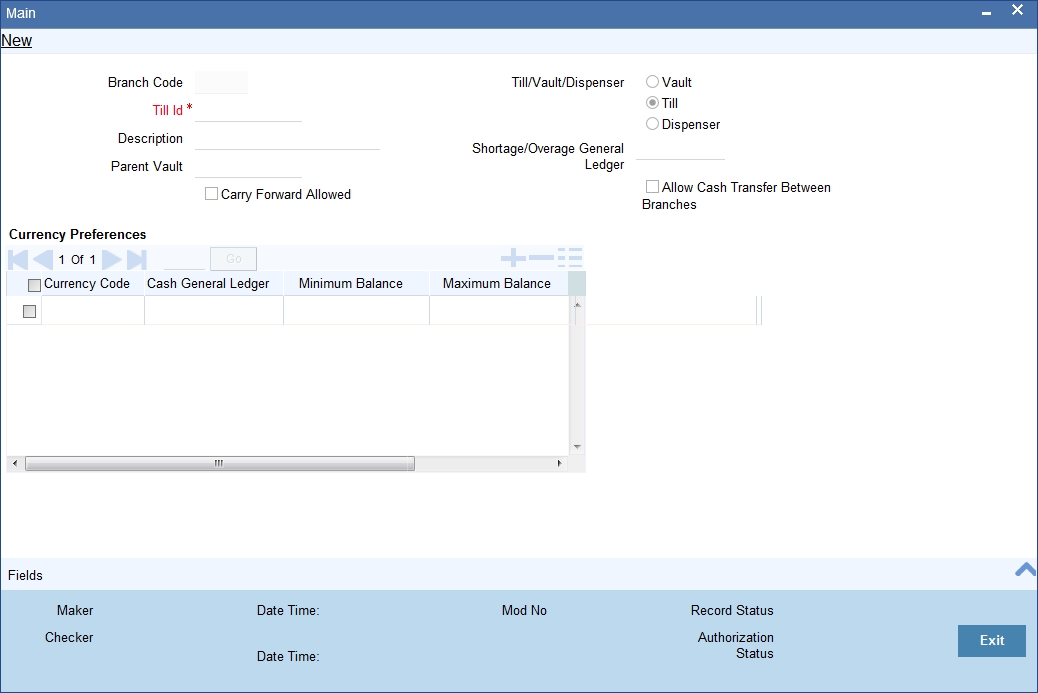

You can maintain Till or Vault details in the ‘Till/Vault Maintenance’ screen. In the ‘Till/Vault/Dispenser Maintenance’ screen click new icon in the Application tool bar.
You can invoke the ‘Till & Vault Parameter Maintenance’ screen by typing ‘DEDTVSET’ in the field at the top right corner of the Application tool bar and clicking the adjoining arrow button.
You can specify the following details:
Branch Code
The system displays the code of the branch through which you have logged in this screen.
Specify whether you are maintaining a Till/Vault/Dispenser. . The options are:
Till Id
Specify a unique code to identify the Till/Vault you are maintaining.
Description
Specify a brief description of the Till/Vault for future reference.
Parent Vault
Specify the parent vault of the Till. Alternatively, you select the vault from the option list. The list displays all the vault maintained in the system.
Parent Vault is a vault being maintained in the same function having the type as ‘Vault’. All tills (and only tills) must be linked to any vault. And in currency preferences for the till, only currency maintained for the parent vault can be maintained.
You should link the Till you are maintaining to a valid Parent Vault. The option list displays a list of the Vaults that you have maintained in your bank. From the option list, choose the Parent Vault to which you want to link the Till.
Carry Forward Allowed
Check this box to allow carry forward of cash or TC balances to Vault before performing Till Batch closure. By default this box is checked.
If you select this check box:
If you do not select this check box, the system checks for the error code maintenance and performs the following:
The system displays the following error messages:
In this case, you have to transfer the cash balance to other Till or Vault and proceed to Till Batch Closure.
Shortage/Overage General Ledger
Specify the Shortage/Overage GL for every Till that you create. Alternatively, you select the shortage or overage general ledger from the option list. The list displays all the ledger details maintained in the system.
This GL is used in Teller transactions for posting the difference between the actual transaction amount and the amount of denominations available.
Note
The ‘Shortage/Overage GL’ field is used only for corporate teller transactions.
Allow Cash Transfer Between Branches
Check this box to perform cash transfer to another branch from this vault.
Currency preferences are mandatory for all till/Vault/Dispenser for corporate teller. It is not mandatory for retail teller.
Currency Code
Specify the currency code.Alternatively, you select the currency code from the option list. The list displays all the currency codes maintained in the system.
If the type is Vault, and if the Vault is being used as a parent vault for another till, then the same currencies have to be maintained in the child till also. This is applicable only to corporate teller.
Based on the type of Till/Vault/Dispenser, the parameters are maintained for the currencies.
Cash General Ledger
Specify the cash general ledger for the currency. Alternatively, you select the cash general ledger from the option list. The list displays all the ledger details maintained in the system.
Every currency that you have maintained for a Till/Vault should be linked to a Cash GL. While defining a product, if you specify ‘TILL’ as the Accounting Head, all accounting entries that are generated for Teller type transactions (involving the product) will be posted to the Cash GL that you specify for the currency.
Note
For a Vault, you can only maintain the Cash GL. You cannot define a maximum and a minimum currency balance.
Minimum Balance
Specify the minimum amount in each currency that the Till can contain.
Maximum Balance
Specify the maximum amount in each currency that the Till can contain.
Minimum and maximum balance validations are applicable to corporate teller and Retail Teller..
Minimum Dispensable amount
Specify the currency specific minimum amount that can be either dispensed by or deposited into the dispenser. This will be the lowest denomination available in the dispenser for the specific currency. This will be applicable only for Dispenser maintenance and not for Till or Vault maintenance.

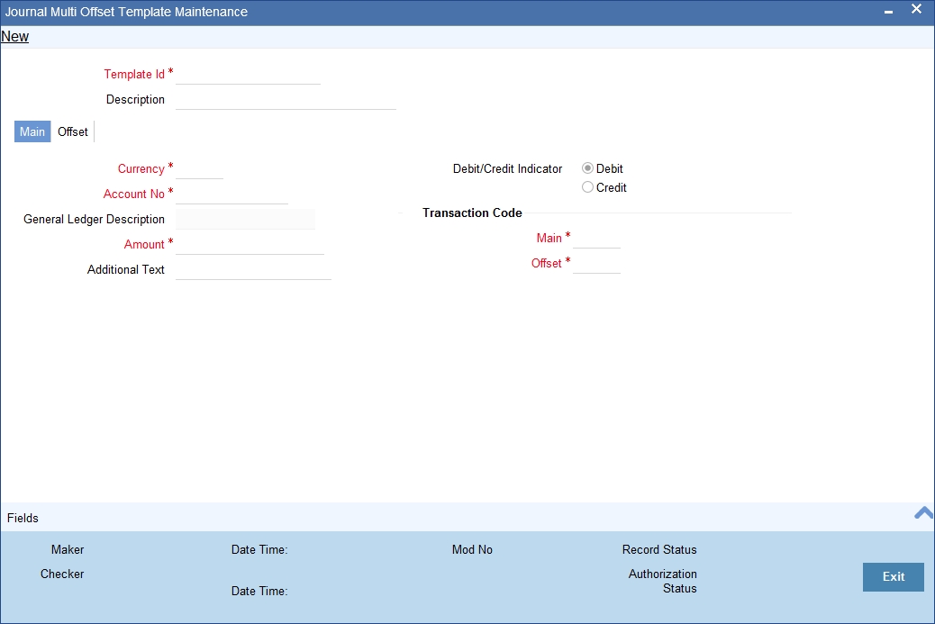

If a transaction involves one debit entry and multiple credit entries (or one credit entry and multiple debit entries), it may be referred to as a multi-offset entry transaction. In other words, a multi-offset transaction is one in which multiple accounting entries are passed (to the offset accounts) to balance a single entry
You can maintain templates that can be used for processing multi-offset transactions. The attributes of the templates will be defaulted to the transaction thereby minimizing the time and effort required to process such transactions.
You can invoke the ‘Journal Multi Offset Template Maintenance’ screen by typing ‘DEDMJTMT’ in the field at the top right corner of the Application tool bar and clicking the adjoining arrow button.
Specify the following details:
Template Identification and Description
Specify a unique id to identify the template throughout the system. You can also capture a brief description of the template being maintained.
Account Number and Description
Select the account number and the description for the template. All the account numbers that are maintained in the branch are available in the option-list provided. The entry passed to this account will represent the main leg of the multi-offset transaction.
On selection of the account number, the associated description is displayed in the next field.
Currency
The currency of the account number that you have entered (in case of a customer account) is displayed here. However, you are allowed to maintain a different currency. All the valid currencies in the branch are available in the option-list provided. You can select the appropriate currency from the list.
Amount
In this field, enter the amount of the transaction. The amount that you enter here will be considered to be in the currency that you select in the previous field.
You must also indicate whether the amount is to be credited to the account or debited from the account. To do this, you must select either ‘Dr’ or ‘Cr’, depending on the nature of the entry.
Additional Text
You can capture any additional remarks regarding the template in this field. This is a free format text and is used only for information purposes.
Debit/Credit Indicator
Debit Credit Indicator defines if the template is being maintained for Debit or Credit. In the Main Tab you can give an Account, from that account if you mark as Debit, the amount will be debited. Under the Offset tab those are the accounts which you credit for this debit in main account.
A transaction code is used to identify the nature of the entries that are passed. You can specify a transaction code for the main leg of the transaction as well as for the offset entry.
An option-list consisting of all the valid transactions maintained in your branch is provided for each field (Main and Offset). You can select the appropriate transaction codes from this list.

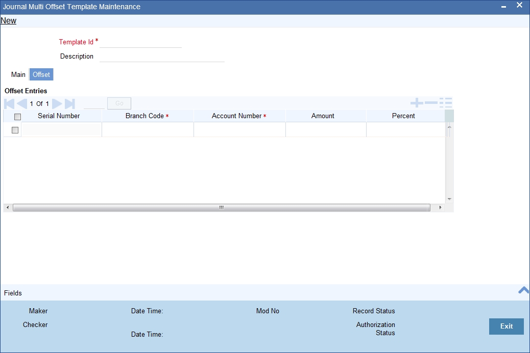

The details of the offset leg of the transaction are captured in the ‘OFFSET’ tab of the screen:
For the offset leg of the transaction, you can select multiple accounts that belong to different branches of your bank. The option list provided for the ‘Account’ field gets populated with the relevant accounts, depending on the branch code selected.
Serial Number
The system displays the serial number on selection of an offset account.
Branch Code
Specify the branch code.
Account Number
Specify the account number of the customer.
Amount and Percent
For each account that is selected, you can specify either the amount or the percentage of the amount.
If you specify the amount, the percentage is automatically calculated with respect to the amount that you specify for the main leg of the transaction (in the ‘MAIN’ tab). Similarly, the amount is automatically calculated if you decide to specify the percentage for each offset account.
The sum total of all the amounts specified for each offset account must be equal to the amount of the main leg. So also, the total of the percentages should not exceed 100%.
At the time of processing multi-offset transactions, you can associate a template with the transaction. The details from the template will get defaulted to the transaction.

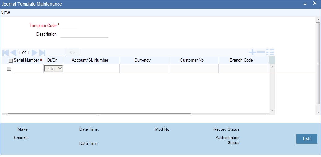

The journal entry template for multiple debits to multiple credits can be maintained in the ‘Journal Entry Template Definition’ screen. You can invoke this screen by typing ‘DEDJNLPR’ in the field at the top right corner of the Application tool bar and clicking the adjoining arrow button.
In this screen, you can enter the following details:
Template Code
Enter a unique journal template code.
Description
Enter a brief description about journal template.
Sl No
By default the system generates the serial number, starting from 1.
Dr / Cr
You can indicate whether the amounts entered in the online screen is debited or credited by selecting one of the option given below:
Account/GL Number
Specify the account/GL number for which the template is defined. The adjoining option list displays all valid accounts and internal leaf GL codes available in the system. You can select the appropriate one.
Transaction code
Specify the transaction code for the entry. The adjoining option list displays all valid transaction codes available in the system. You can select the appropriate one.

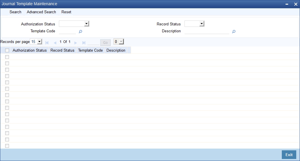

You can view the summary of all journal templates created, using the ‘Journal Template Maintenance’ screen. You can invoke this screen by typing ‘DESJNLPR’ in the field at the top right corner of the Application tool bar and clicking the adjoining arrow button. You can search based on the Template code, authorization status, and Record status.
In the above screen, you can base your queries on any or all of the following parameters and fetch records:
Select any or all of the above parameters for a query and click ‘Search’ button. The records meeting the selected criteria are displayed.
System displays the following details pertaining to the fetched records:
